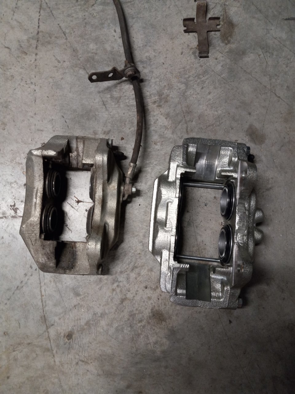

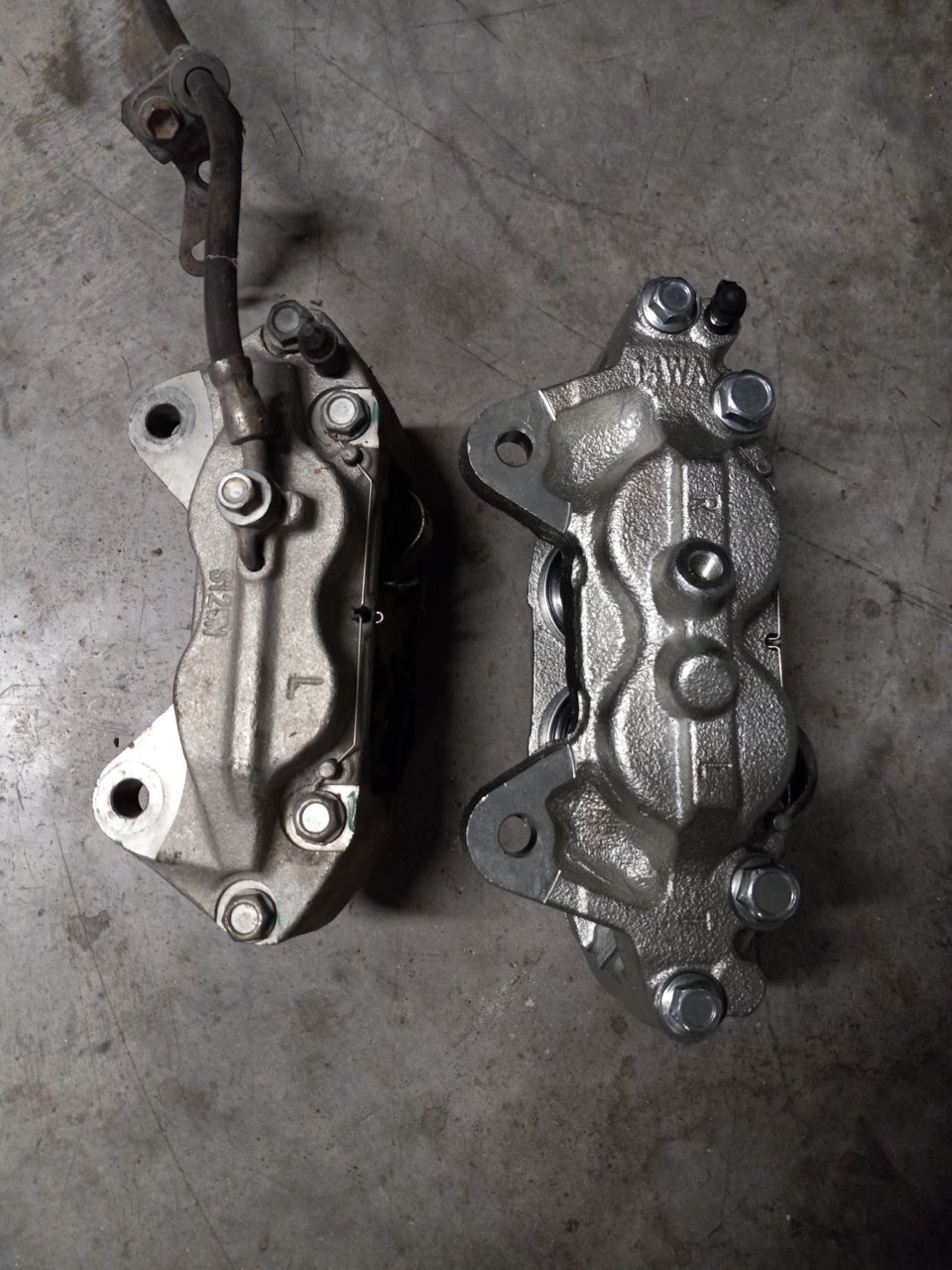

    $400 is the price for the product, with shipping, and insurance, via usps
    You're going to need 17 inch wheels to clear the calipers
    You can retain the original brake line setup but you will need a shorter banjo bolt or cut the original one down than fix the threads with a file... not a big deal
    I only have 4 pairs, dm for additional questions or inquiries
    You will need to supply your own pads and rotors (meant for a 2012 toyota 4 runner) to complete the upgrade

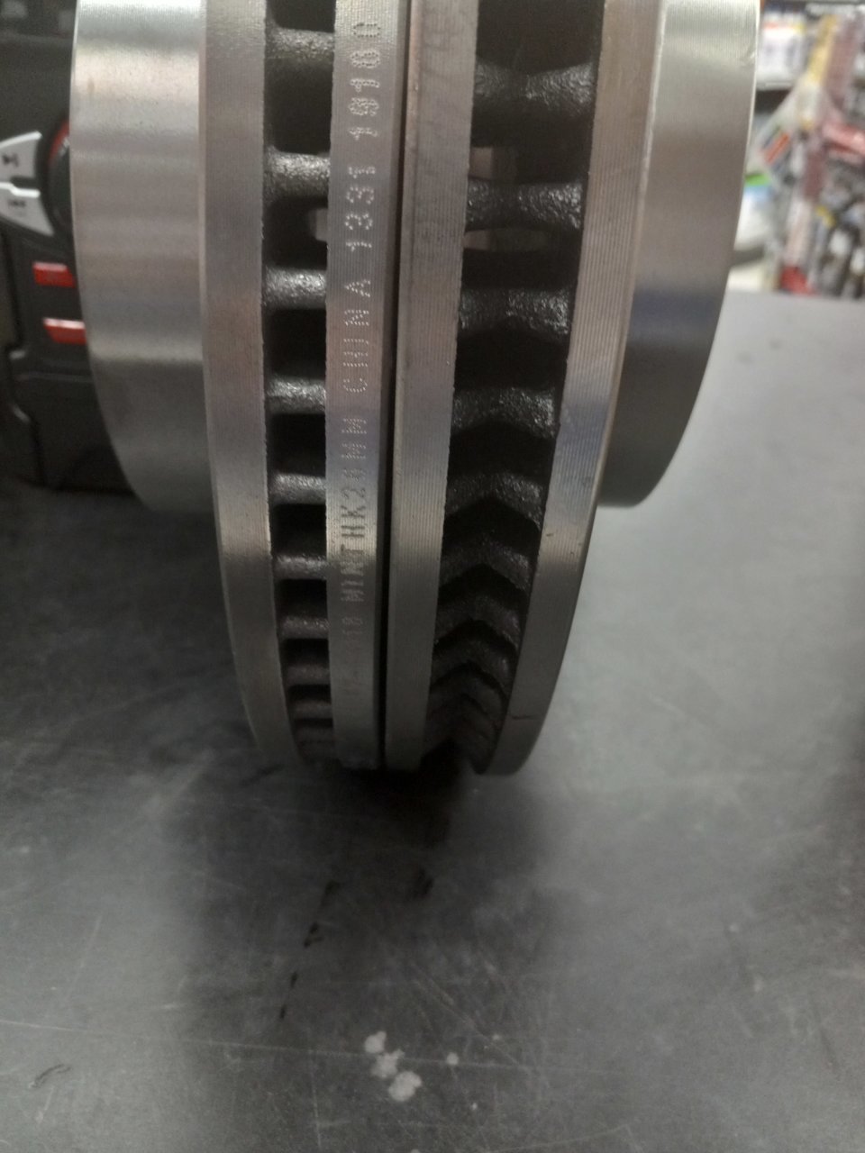

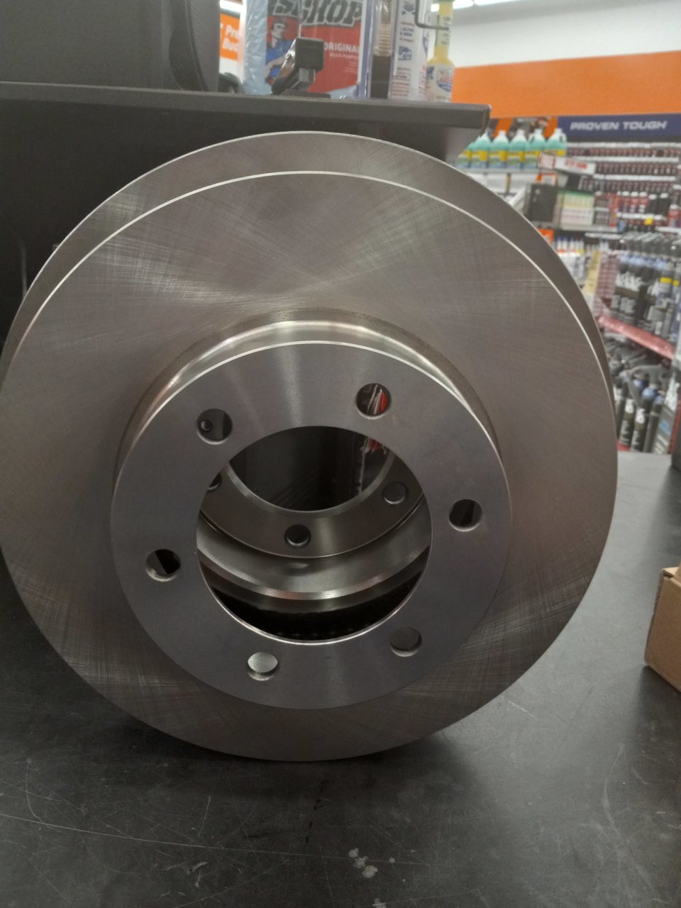

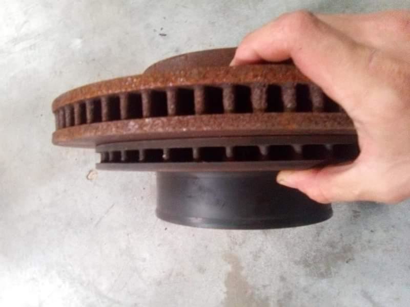

    Larger these are
    The ones that have been done for years are 13wl calipers
    I can get some photos comparing the 14wa caliper vs the 13wl caliper but don't have the 14wa rotors or pads on hand right now
    The 14wa rotor is larger in diameter and significantly thicker than the 13wl
  5. May 26, 2022 at 4:59 PM

    13wl left, 14wa right
    13wl front, 14wa back

    What was modified? curious they bolt up to 2nd gens without changes. Did you need to modify the mounts? I’m not as familiar with the first gen setup.
    Running Board Man[OP] likes this.
  12. May 27, 2022 at 8:16 AM
    Running Board Man
    Running Board Man [OP] Well-Known Member
    Feb 19, 2017
    #211024
    8,757
    Dint come at me with pitchforks and torches it they dont
    But they should bolt up to 2nd gens no probleno

    The rotors have more ventilation so they shed heat faster, great for towing, bigger tires, stopping downhill... or a combination
    The caliper pistons are larger so a greater area of the pad is receiving clamping force
    That being said the ratio of pedal travel and brake force is technically skewed but I did the swap on my tundra whose booster and master are meant for 13wls and I notice no problem
