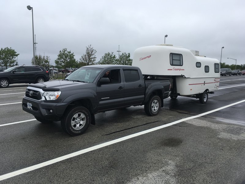

    The link I provided has a classifieds section but https://www.fiberglass-rv-4sale.com/ is the best site I've found for used molded fiberglass trailers. Be aware, these things hold their value much better than campers of any other construction and they usually sell quickly. Condition is much more important than age as Scamp doesn't change much from year to year - my 01 looks pretty much like a current model.

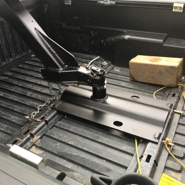

    I finally got my Hitch done after i decide to get rid of the Scamp factories Hitch cause it was not possible to get my trailer level whit it. I also like the point that i can get my quad in my box without braking my back evrytime by removing that heavy hitch. IMG_1156.jpg IMG_1188.jpg

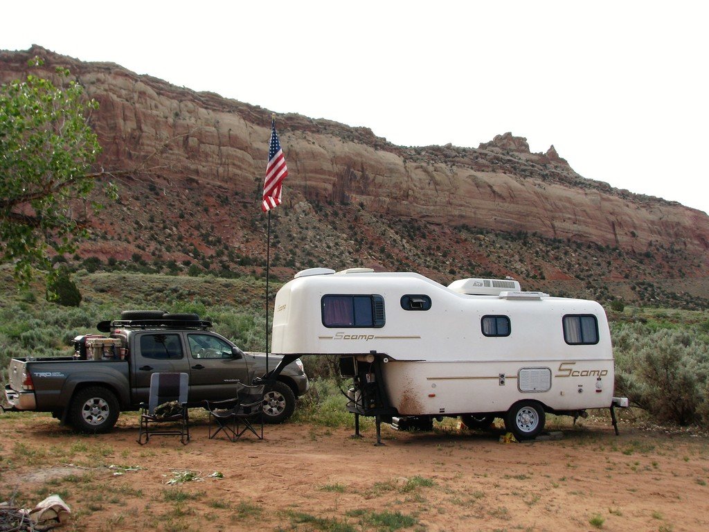

    Clean looking install. Tacoma & Scamp fiver make a great combination. How long have you had your trailer and where's home?
    We just returned to NC after a five week trip to southern Utah and saw only one other 19' Scamp the entire time. Anyone who lives in the Four Corners area is indeed fortunate. We mostly boondocked in the National Forests and on BLM lands and had a great time. Incredible scenery, trails and wildlife.

    I made it my self from a gooseneck hitch plate i bought on eBay and did some little mod on it.

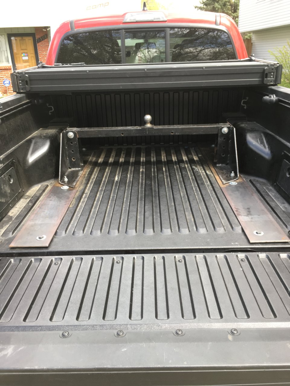

    Hi folks. I'm new to this forum....sure do appreciate the information out here. I have a 2004 19 ft Scamp. My current tow vehicle is a 2006 Dakota but I am transitioning to a 2016 Tacoma TRD Sport. The Tacoma's bed sides are just about 4 inches higher than the Dakota.
    Because of this, and because the axle was 15 years old, with 13 inch wheels, I went up to Backus and had Scamp put in a new axle with 3 inches of lift and 15 inch wheels. Parts, labor, three new wheels and tires were just about 1200 dollars.
    I was able to tow the camper home with the existing tow vehicle. The front of the camper tilted down a bit but no problem. Now I'm in the process of setting up the hitch in the Tacoma. I want to use the same setup that Al (huachuca) has. (Very good pictures and descriptions by the way. Thank you Al.)
    I have a question though. Are the bed bolts long enough to connect solidly since you are now going through that flat stock....I'm guessing that adds about an inch. ? Or removes about an inch of connection. Hope that question makes sense. Did you have to get longer bed bolts are did you reuse the stock bolts?
    Thanks in advance!
    Al in Nebraska (obviously, my name is also Al)

    Al, good choice on camper and tow. Thanks for the good words - glad to be of some help. I used the stock bed bolts in the front and center. IIRC, the threads on these extended below the mounting tabs even after installing the flat stock so no worries. I did go aftermarket on the rear though, Mcmaster-Carr I think. I couldn't find a longer bolt with a torx head and had to settle for hex there. Sorry, I don't recall the diameter or pitch - I pulled one out and took it to Lowe's to get those dimensions. Note, this applies to my 05 and 12 - not sure if the same in 16.
    Good price on the axle/tire/lift upgrade. I've found the folks at Scamp to be very competitive on pricing - just have to watch them on shipping charges. I don't have a lift but trimmed out the wheel wells a bit to get 205/14's on. Will probably go the same route as you when I replace the axle in the not too distant future. Where's home in Nebraska if you don't mind my asking?

    Hi Al, sorry to be late responding. The story about the young lady in Lincoln touches a heart string. Hope it all worked out for you. I went off on a senior trip to Germany (Army) about that time. Came back, married my girl, and we ended up in Lincoln a few times over the years. My boy is there now.
    Anyway, on the hitch. Thank you for the pictures! Very helpful. I repeat. Very helpful.
    I had to modify an original Scamp hitch that someone else had already modified. I didn't realize how much. Whew. My goal was to try to keep as much of what they had done as possible. It just caused me heartache. I ended up cutting and sanding and getting back to original and copying your template. With a few exceptions.
    I used 1/4 inch flat stock rather than 3/8 ths. Grade 8 bolts. It became complicated when I discovered that the previous fabricator had shortened the cross piece with the ball on it. Man, getting the holes to match was a true headache. But they did in the end. Along the way I almost went to a welder but my gut said bolts.
    Getting those bolt heads to drop in between the high ridges on the bed....well, I had to think about that. But they did.
    Going to test it all out tomorrow. I'll give you a status report then.

    Did my test drive today. Worked like a champ. I'll pull it out and disassemble in a few days and paint it up. Thanks again to Al for the idea. 2016 Tacoma pulling a 2004 Scamp fifth wheel.

    Hope those are grade 8 bolts or better!

    Toyko Joe, yes on the grade 8's. Fastenal was a good resource. We have a local outlet but I had to special order.
