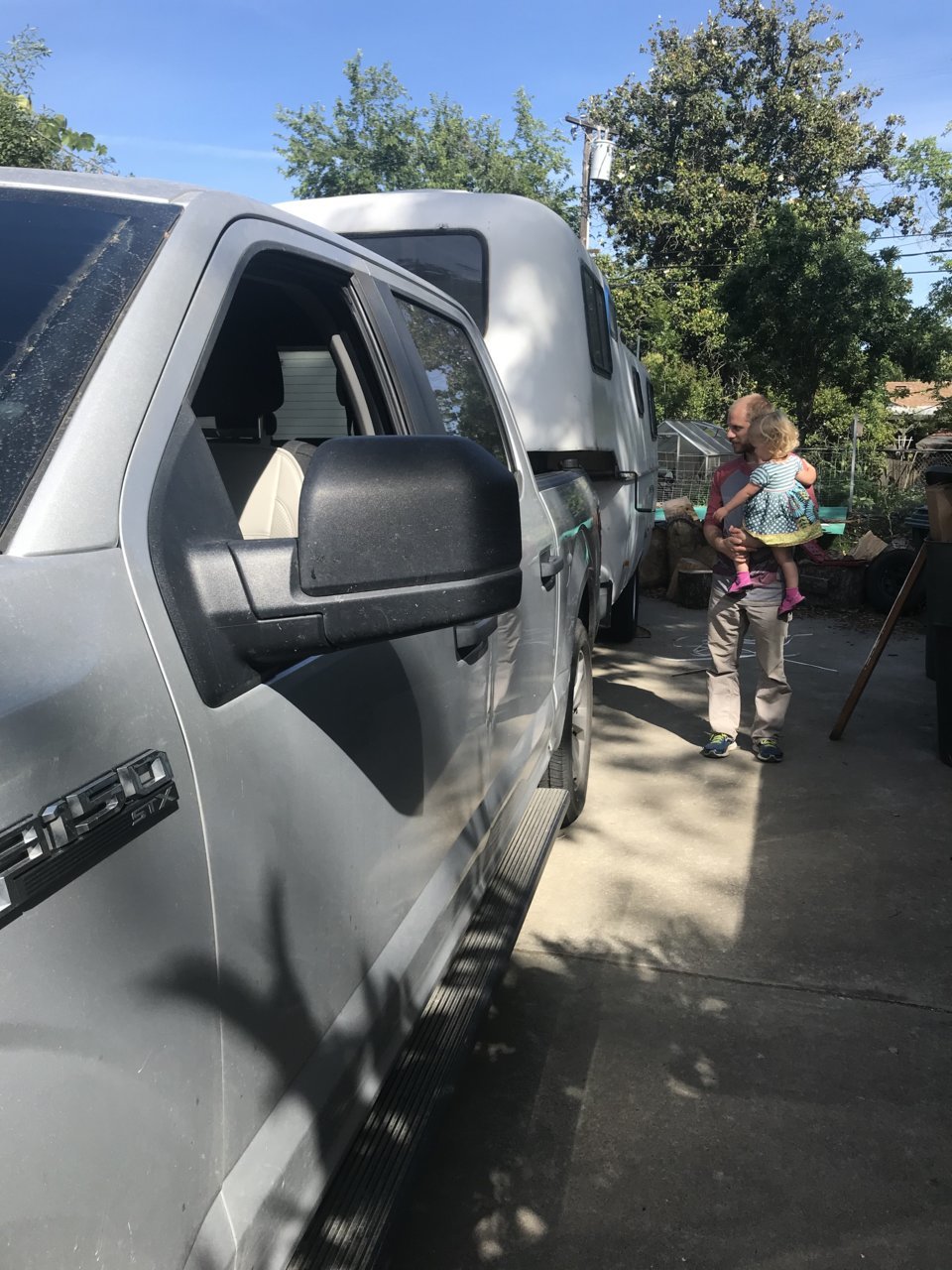

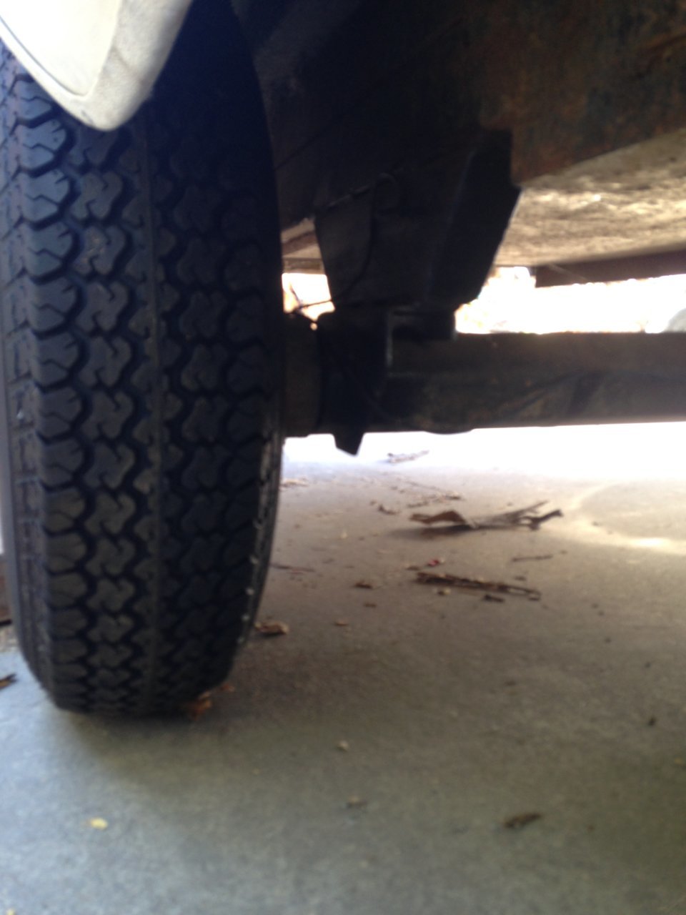

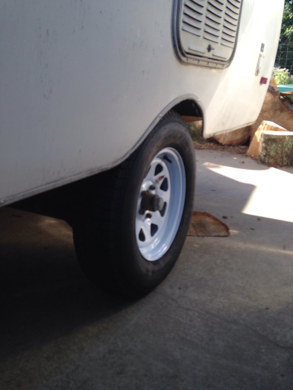

    Have two kids now so we needed a little more space and are in a 2wheel drive supercrew F150 now. Decided to go with a gooseneck underbed instead of a fifth wheel with modified top plate and ball. We are using a curt 4" offset and riser. Trailer is now on 205/r15" tires and we only have 2-3" of clearance from the trailer to the bedsides. Not sure how much further I want to mess around with heights etc. if I get a blowout on the trailer I'm almost certain the truck bed will get damaged.
