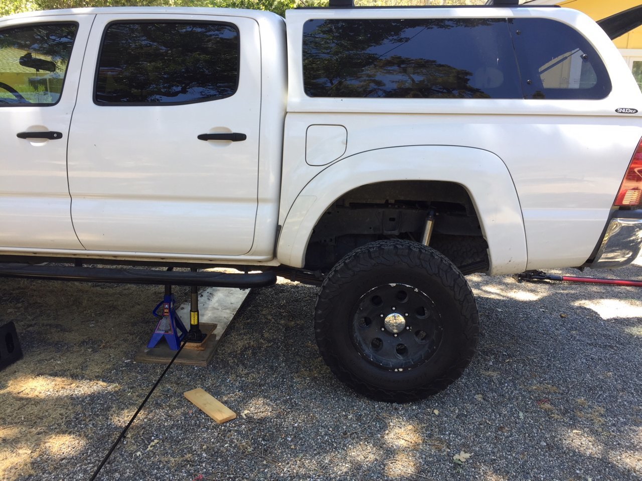

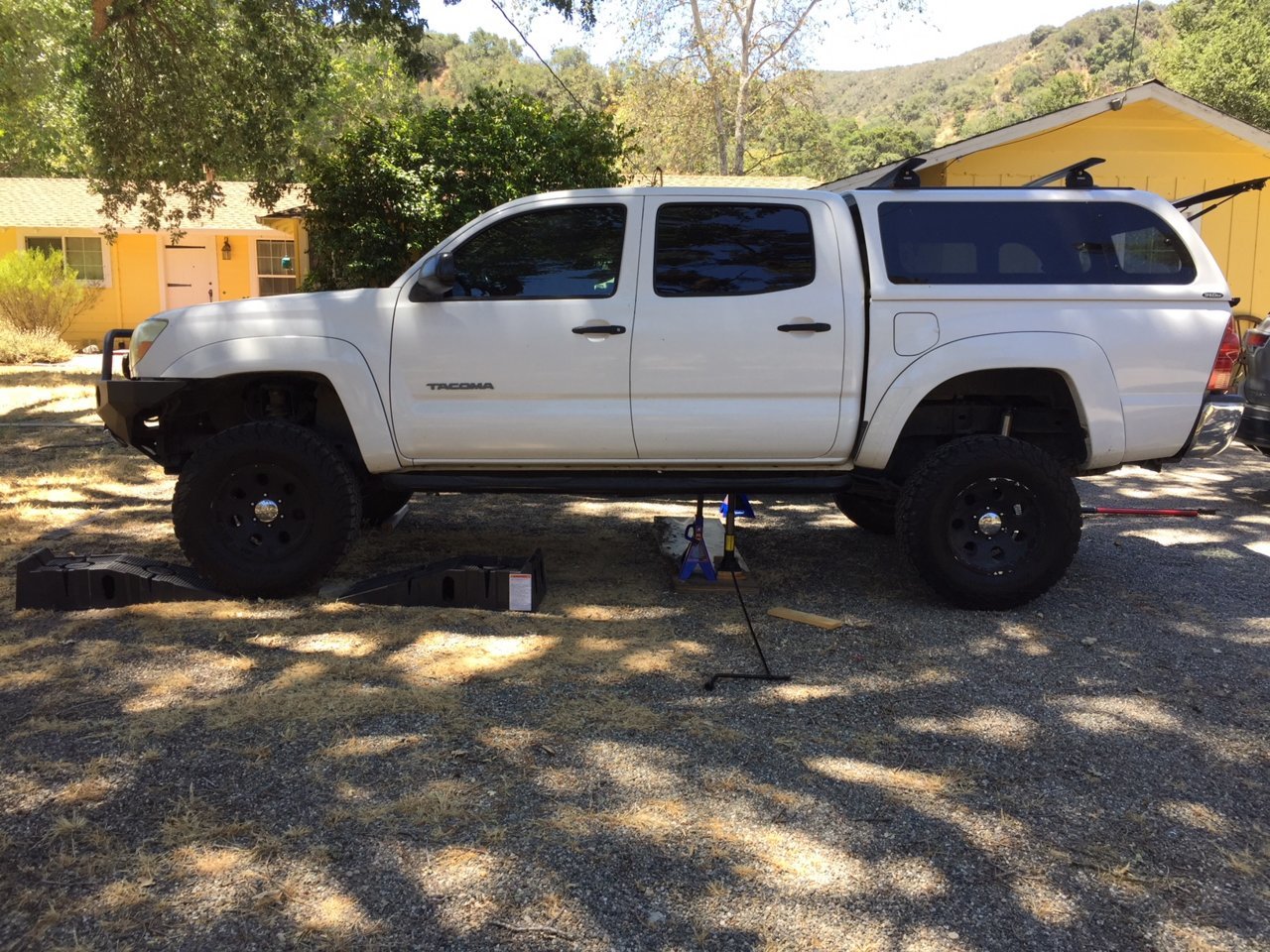

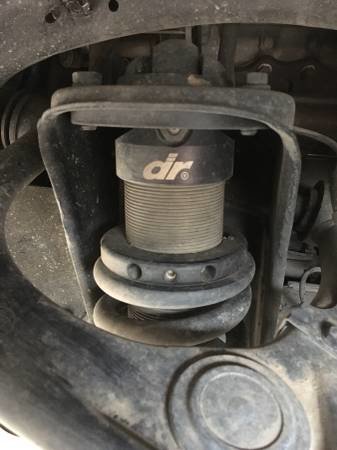

    So thanks to some forum members here, I now know that my 2nd gen Tacoma V6 DCSB TRD OR has been highly modified in the rear suspension department (and my front too, with some Donahue Racing coilovers, now called ICON I believe). I got this truck to be bulletproof ( :rolleyes: ) offroading to reach hunting spots and to be my daily driver and household towing/load-carrying vehicle (within the limits of a stock Tacoma). I now know that I have a progressive leaf spring pack (someone suggested it was Deaver J66, which seems right from the placement of the sticker on them, which has been spray painted on mine) which seem to be sagging as they are now almost level at rest with no load. For shocks, I appear to have Fox 2.0 Air Shocks mounted onto modified eye mounts (not stud, see pic below). Fox technician and forum members both have wtf'ed over this setup saying that air shocks aren't usually used with springs and usually serve as a poor man's coilover.
    Now here's the kicker: my passenger rear air shock is rapidly leaking oil. It's a mess and there's a puddle under it when I park on cement. I cleaned it and verified it's leaking. So, I need to do something. I could:
    A.) Remove the air shock, and have it rebuilt if Fox will repair my 10 year old air shock, or
    B.) Replace both my leaf springs and shocks (and whatever else needs to be swapped with this)
    Additional info: I just had my u-joints replaced, center bearing replaced, and driveshaft rebalanced since my center bearing bushing had failed and was allowing the driveshaft to flop.
    Should I buy a new setup? If so, what would be sufficient to achieve my aforementioned goals, and if not, do you think there's any risk my shock will quickly fail again (assuming it could be my leaf springs sagging that caused it? I don't know) due to this incorrect setup?
    I've been reading up a storm, but man is this a lot to learn to get my truck back on the road in short order. Thanks for all of your help TW.

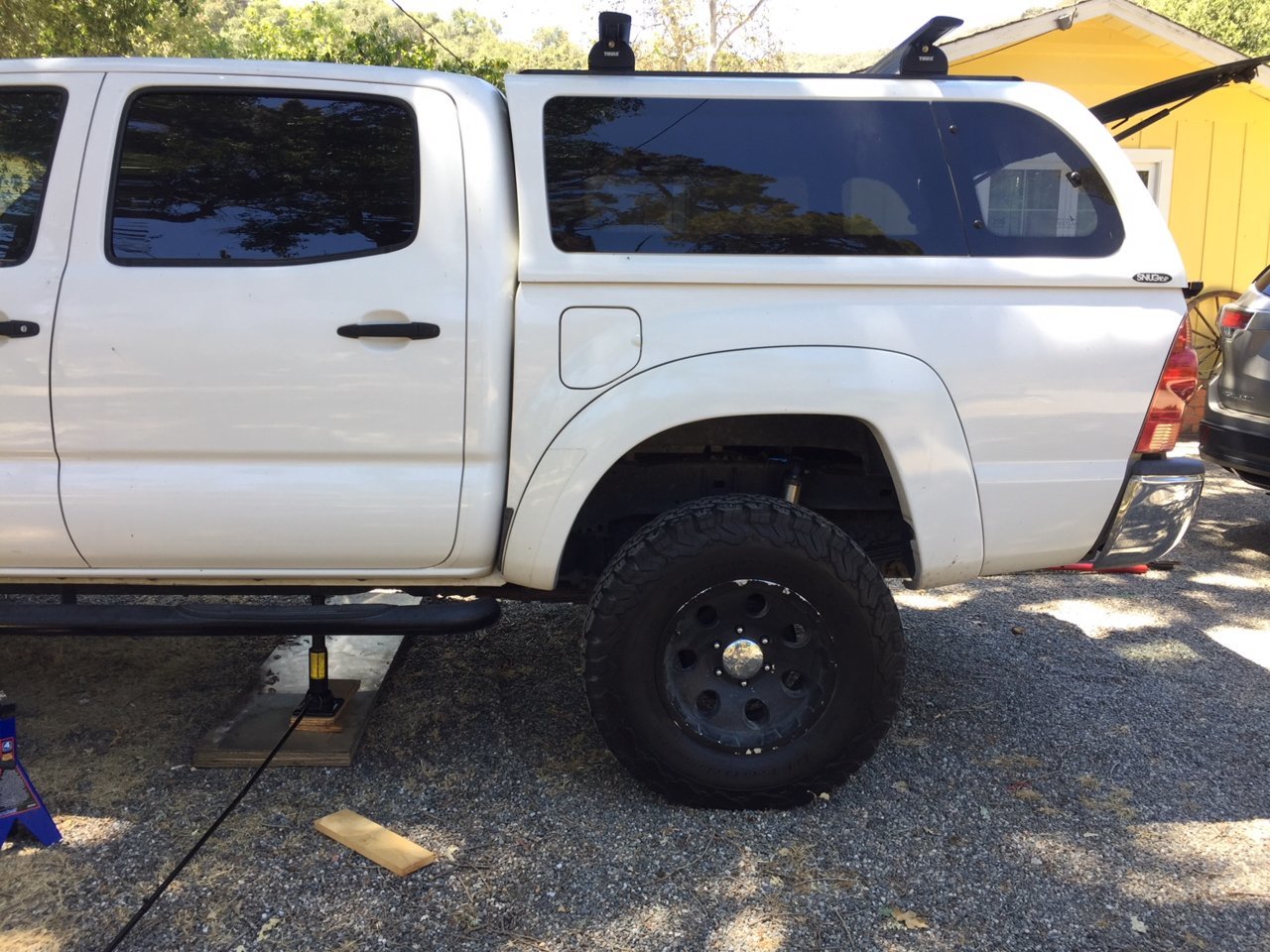

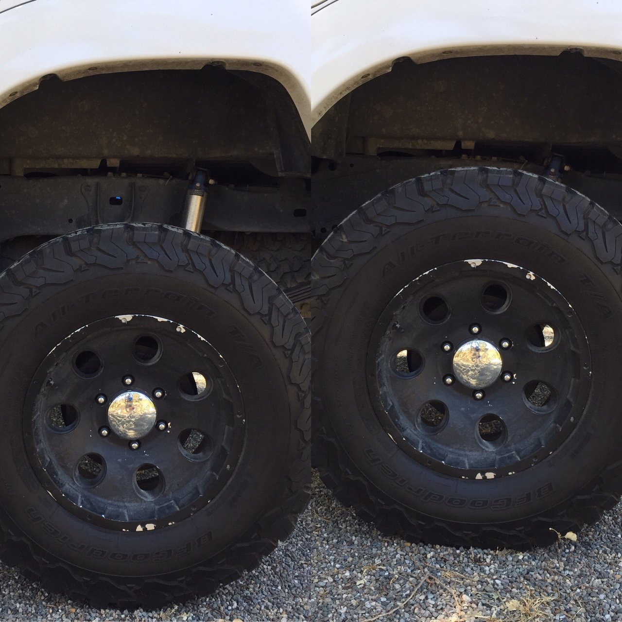

    Fronts:

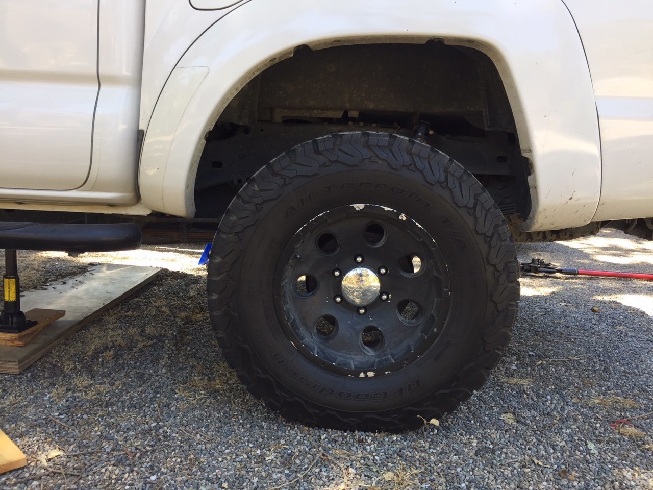

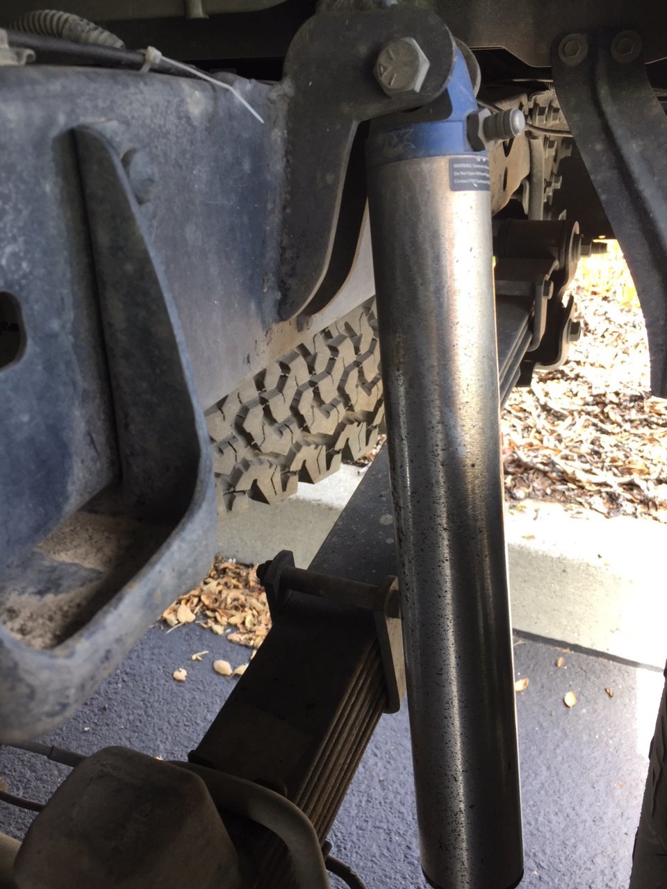

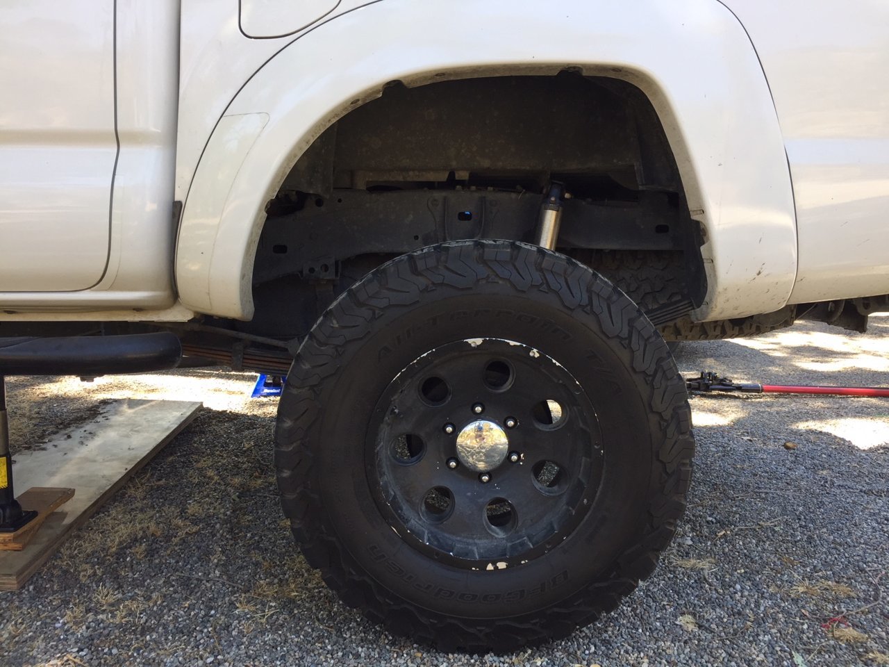

    Rear shocks and leafs:
    At rest:
    And lifted where you see the bottle jack:

    Measure the shock length (as best as you can) with the truck resting. You want to measure from the "eye to eye" or center of the mounting bolt to the opposite end mounting bolt. Next, remove the shock then jack up the truck and take measurements from the upper and lower mounting points. Measure the width of the upper and lower shock mount. Repeat for the other side.
    These measurements are your "Extended" and "collapsed" length and will provide you a baseline for what shock size you need. Talk to Down South Motorsports or any other vendor and see if they can hook you up with a set of universal 2.0 shocks that can bolt in with similar dimensions. Saves you the hassle of redoing the mounts. It almost looks like you could fit a 10" shock in there.
    The OME Dakar leaf pack is your standard leaf upgrade from stock. Provides about 3" lift and has much more weight capacity. You will also be able to ditch the air shocks and properly support extra weight. The J66 springs are a lighter weight option that only provide about 1-1.5" lift. Previous owner was using the air shocks as a crutch for height and capacity.

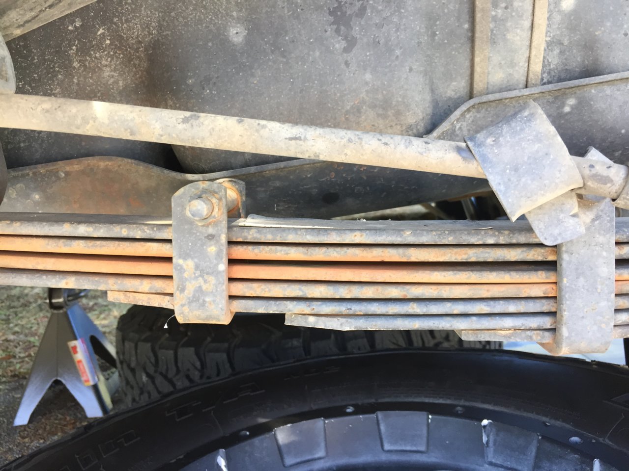

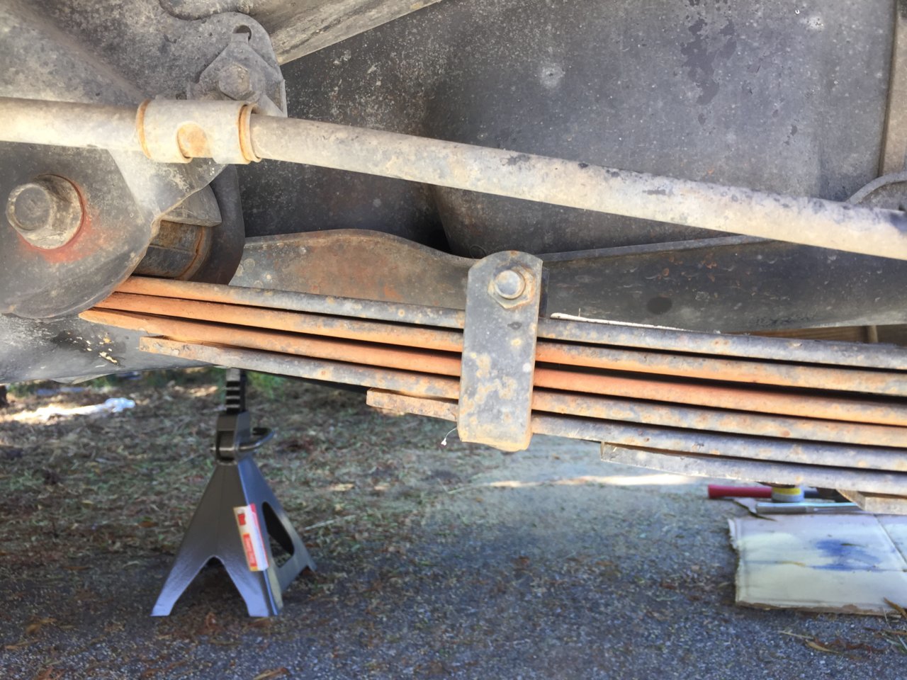

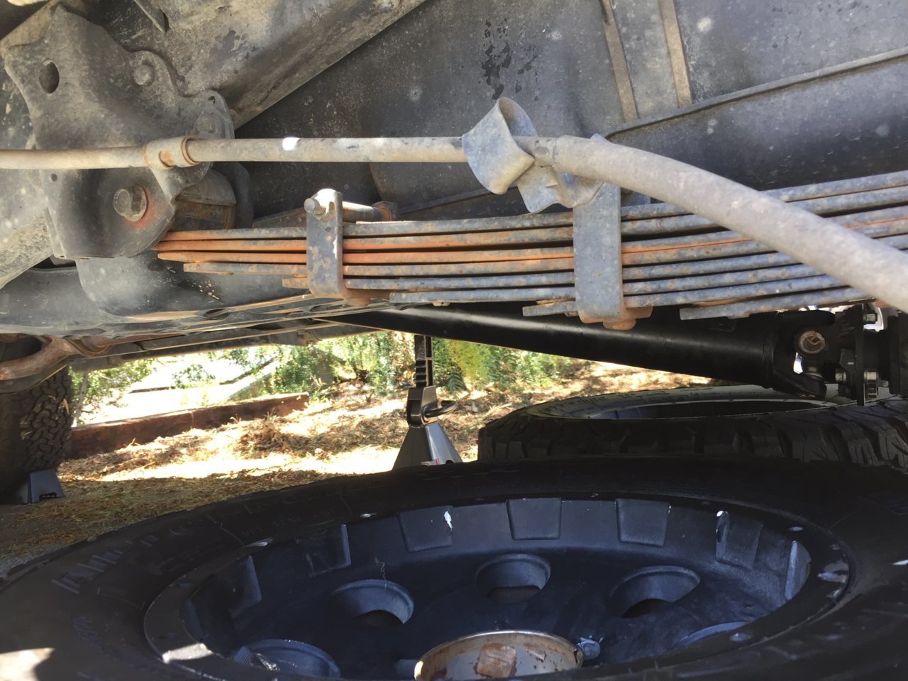

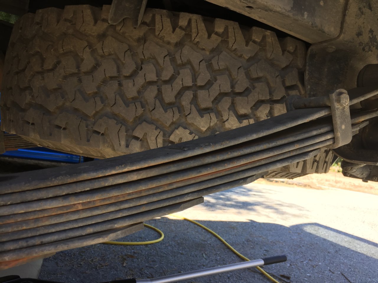

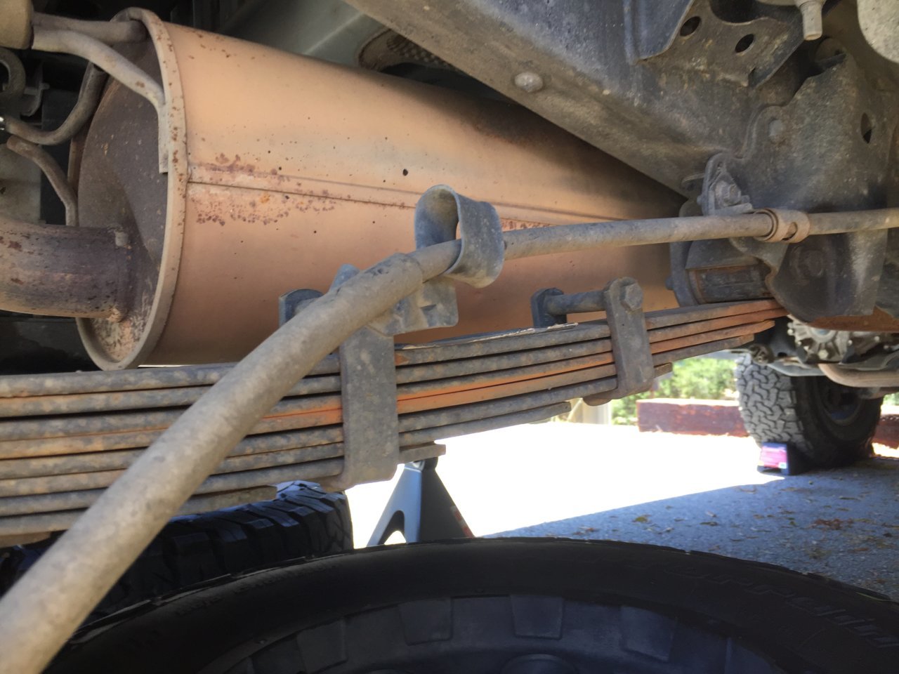

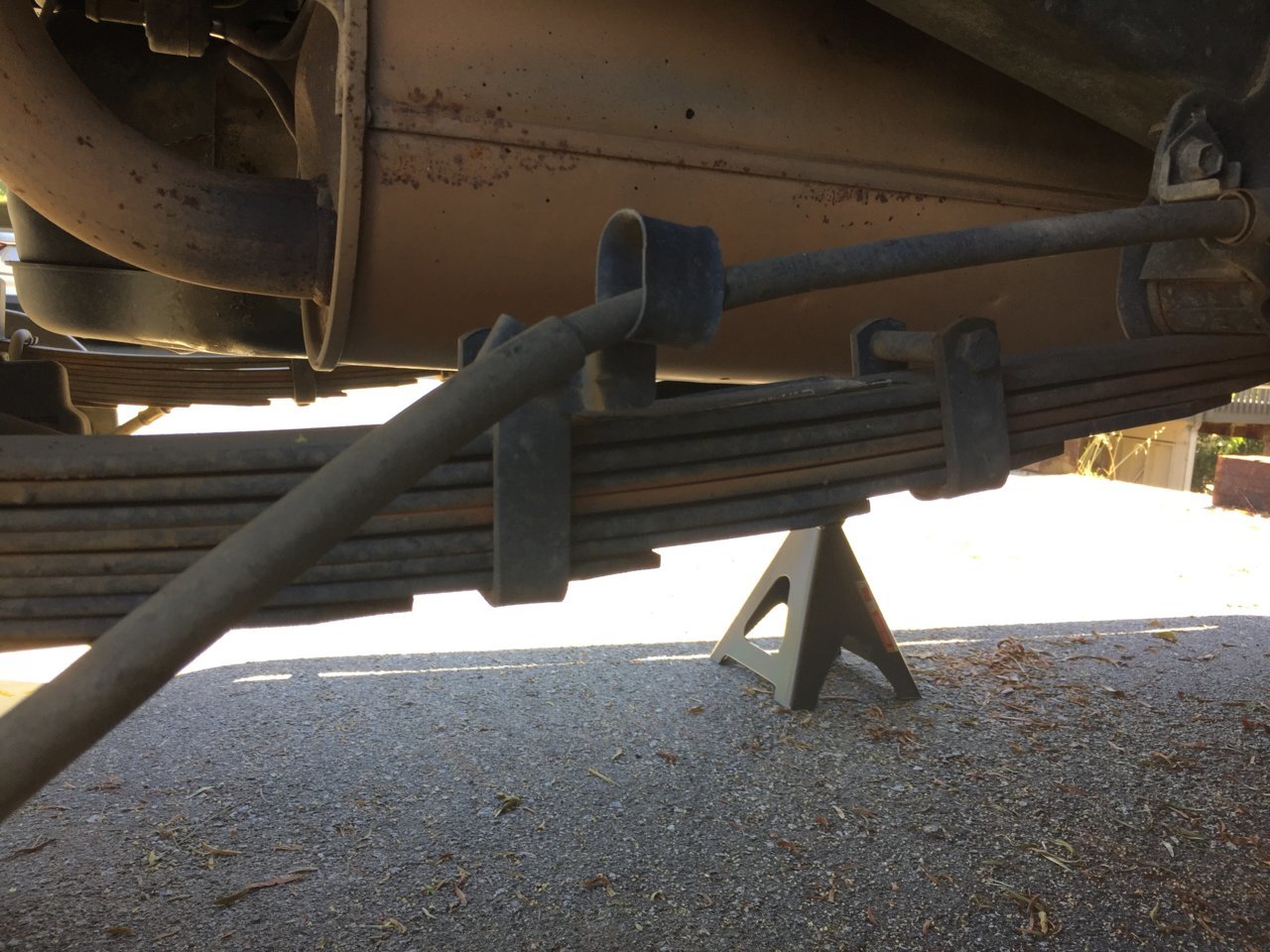

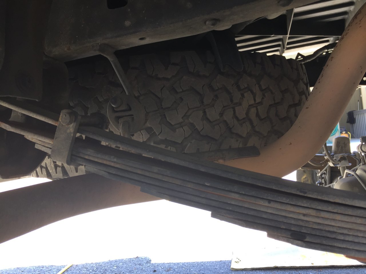

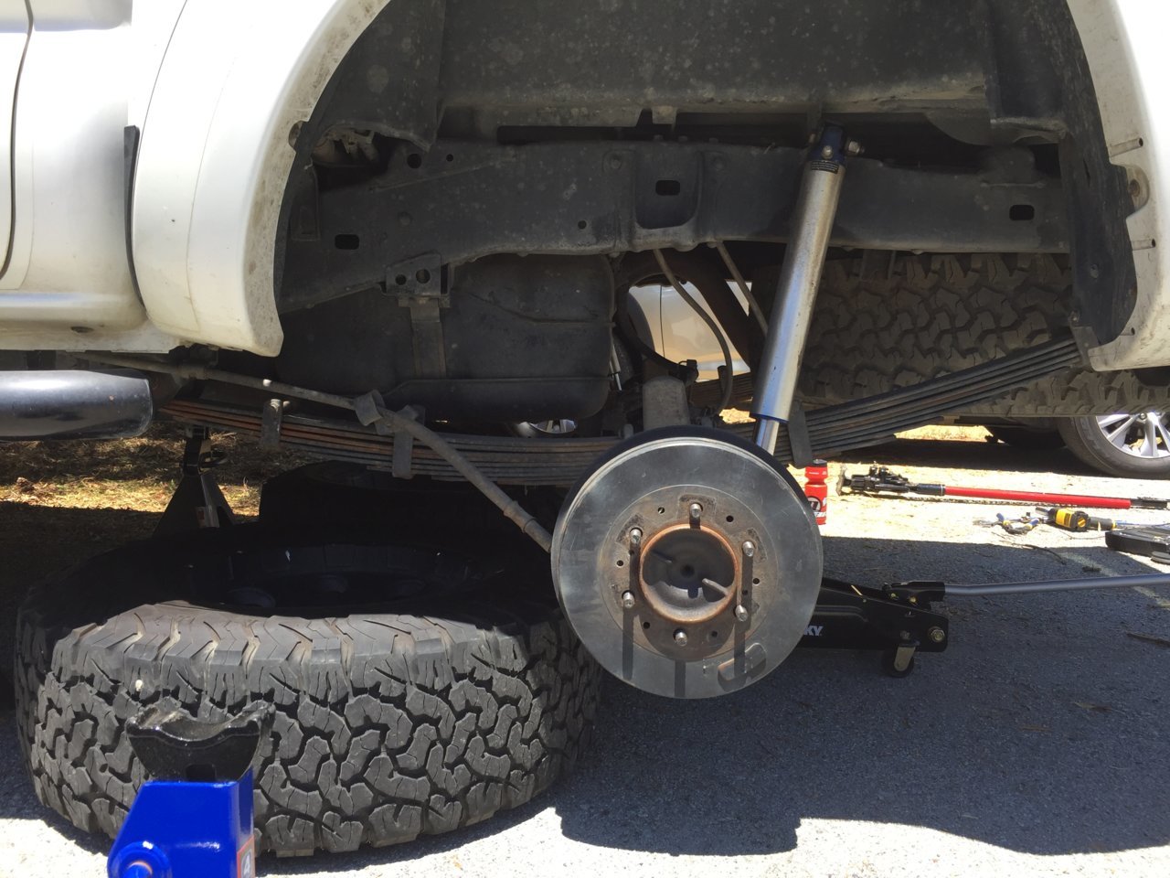

    Got a buddy with an asphalt driveway to let me break down in his yard, since mine was dirt and here's what we have. Got all the shocks off, called Downsouth Motorsports who told me to go figure out if I need to replace my leaf springs first, and then call him to find what shocks I want which makes sense.
    I wasn't sure if these leaf springs are still good after all. It does appear to be an 11 spring pack and has stickers in the spot that makes it look like Deavers though the PO spray painted over the sticker. I'm leaning towards tossing the leaf springs and getting an OME Dakar pack with some Bilstein or Fox 2.0's (depending on total cost perhaps between the two) since I don't like what I'm seeing on the leaf springs with the weird gaps and separation points seen below.
    2018-07-15 Tacoma Springs 011.jpg 2018-07-15 Tacoma Springs 014.jpg 2018-07-15 Tacoma Springs 022.jpg 2018-07-15 Tacoma Springs 029.jpg 2018-07-15 Tacoma Springs 032.jpg 2018-07-15 Tacoma Springs 034.jpg 2018-07-15 Tacoma Springs 036.jpg 2018-07-15 Tacoma Springs 038.jpg
  9. Jul 16, 2018 at 8:06 AM
    anthony250f
    anthony250f Well-Known Member
    Feb 18, 2012
    #73066
    16,760
    Anthony
    San Diego, CA
    2008 dcsb trd offroad 4wd
    Buy ome Springs and replacement shocks of the correct length. Those shocks looks really short.

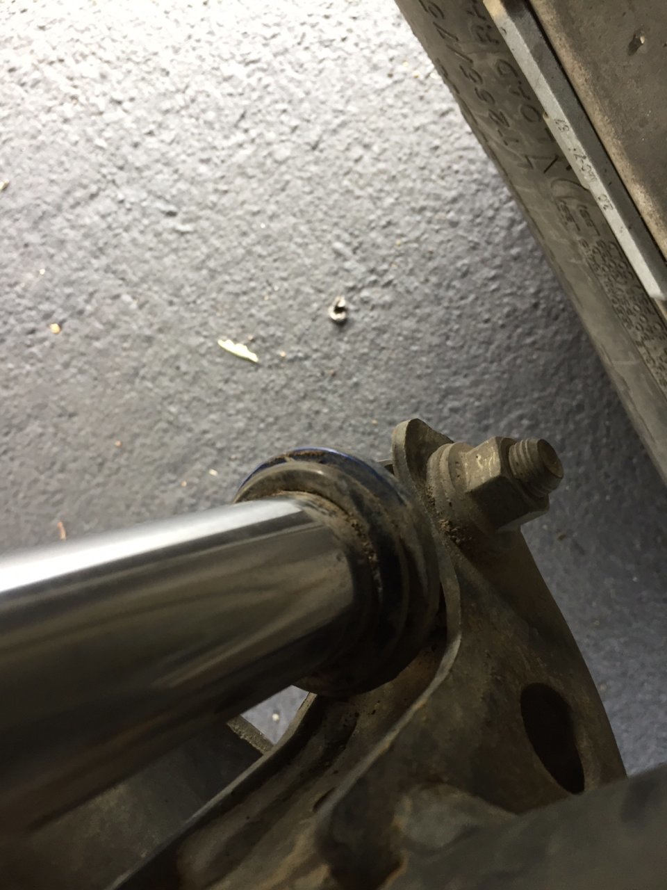

    Welp... another road block. The shocks I received are 1.5" eyelet mounts top and bottom with bushings and inner sleeve. My mounts are 1.25" top and bottom. I previously had bearing mounts with two reducers (one on either side of the rotatable bearing) on 1/2" bolts. The shop suggests I grind them down and is sending some bushings and sleeves that are smaller though they told me the smallest they had was on the order of 1.3XX" (I forget the lower digits).
    Would you guys just grind down the sleeve and outer part of the bushing and/or bend the mount tabs out, or would you look at getting a bearing mount that I can put into the Fox shocks I got? I ended up with these fox shocks:
    Fox 980-24-032
    https://smile.amazon.com/Fox-980-24-032-Eyelet-Body-Cap/dp/B009X1TN6O
    I half wonder if I shouldn't switch the bushing out for this: http://performancelifts.com/fox-racing-shock-mount-bearing-001-00-004-a.html
    That's basically what was on there before. Says they wear out when driven as a daily which I do. Would hate to swap these every 1k miles..... Maybe I need to just bite the bullet and replace my shock mounts with 1.5" mounts...:crazy:.
