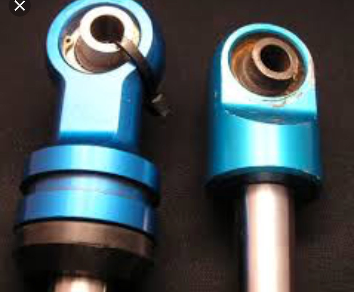

    Just to verify, what you're saying is that under the bushings I have on my new Fox shocks are spherical bearings/Heim bearings or whatever they call them, like the picture above? And if I remove my bushings, I will find a bearing like that? The sleeve in my bushing seems one piece, though, and doesn't allow for articulation, so are you sure that's what it looks like under there?
  8. Jul 28, 2018 at 2:56 PM
    #28
    anthony250f
    anthony250f Well-Known Member
    Feb 18, 2012
    #73066
    16,788
    Anthony
    San Diego, CA
    2008 dcsb trd offroad 4wd
    It should be...remove the bushings to confirm

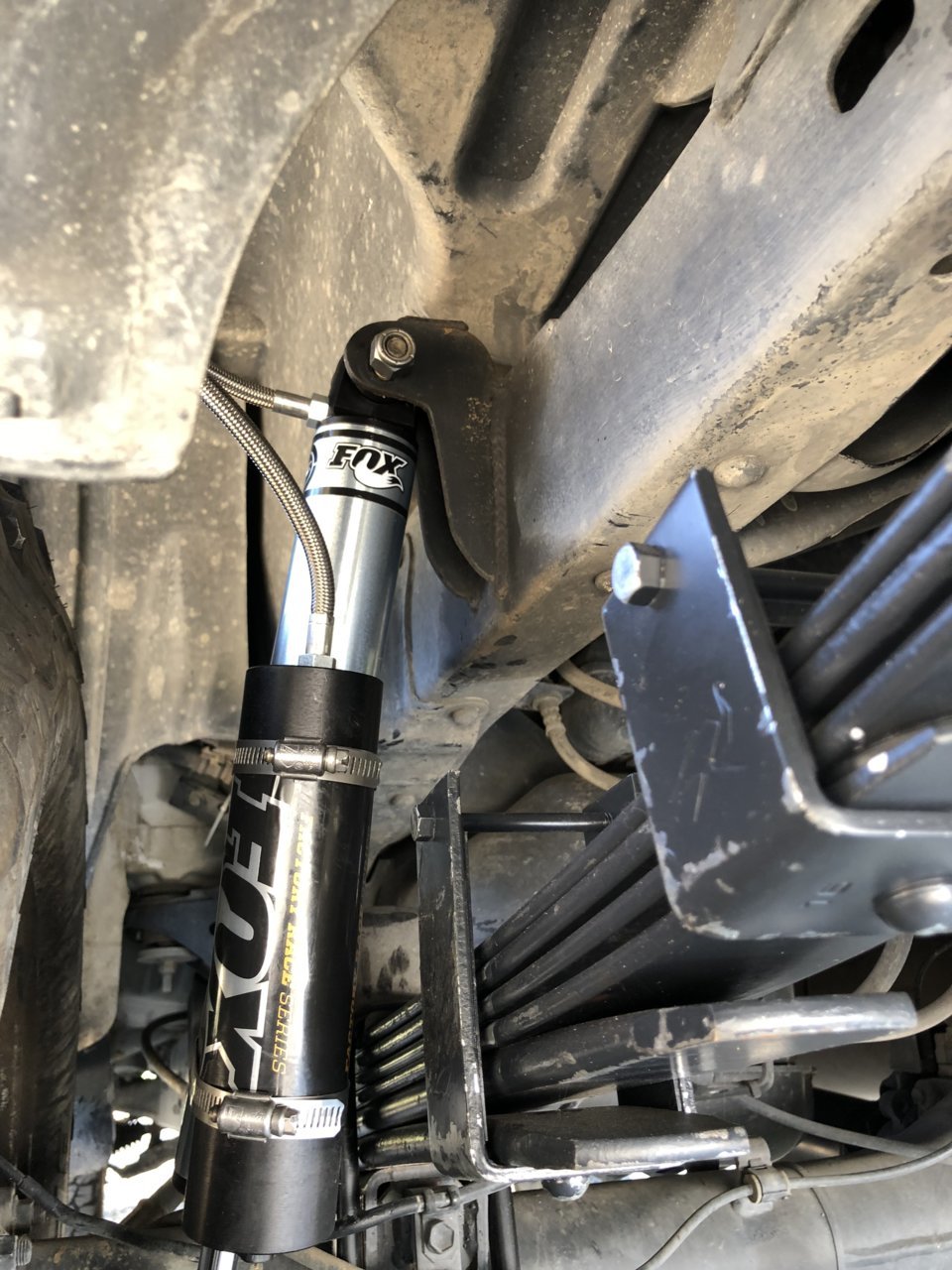

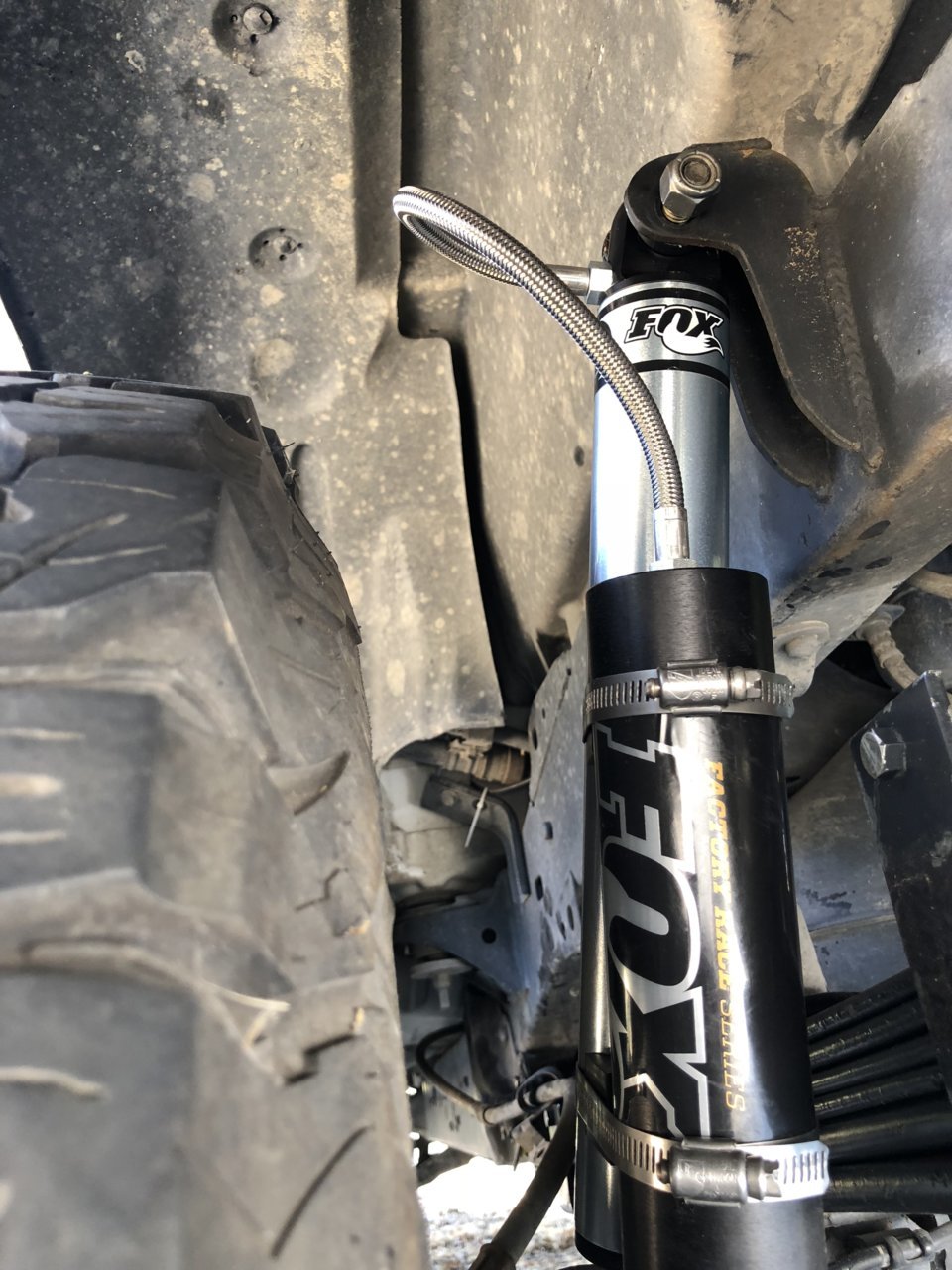

    Everything is remounted. Had some health issues slow me down for a while but I’m back baby. Got my bushings and sleeves ground down to 1.22” and slipped em in there and tightened it up. Had to compress the bushing a little bit to get to even 40 ft-lbs. not happy with that. They seem to give too easy. What torque would you guys go to?
    Unfortunately I somehow missed that the old hardware was junk. The PO must have used whatever he had on hand. What would you guys recommend buying for the eyelet mounts? I have the old stuff in there but don’t much like it. Uneven number of washers etc and one locknut and one not. These would be your typical 1/2” bolts for a 1.25” inner mount. I forget the outer dimension.
    Also the reservoir tube has a straight connector instead of a 90 degree and so it sticks straight towards my damn tire. Not happy with that suspension shop whatsoever. You guys think this is a danger? Have to run the truck up on an incline to see what happens when I flex one side.
    8540B879-1455-47E5-92AF-D4609C4F5696.jpg A57C45A9-C994-4327-9790-71458A0C9D99.jpg
    Thanks all for your help getting me set straight.

    Anyone have any suggestions on hardware and reservoir tube placement?
