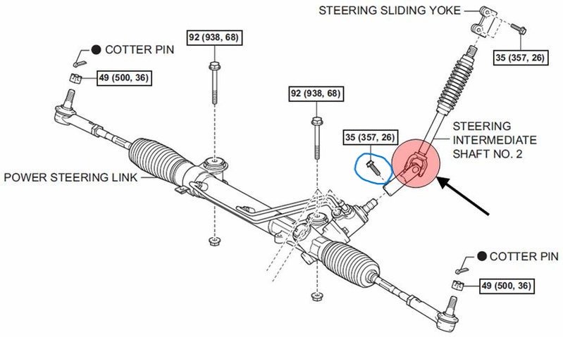

    Edit: Solved part # 90080‐11555.
    Anyone happen to have the part # or the thread pitch of the bolt (circled in blue) that tightens the steering shaft to the splines on the rack? In the process of swapping in my tundra rack and mine has left the chat lol

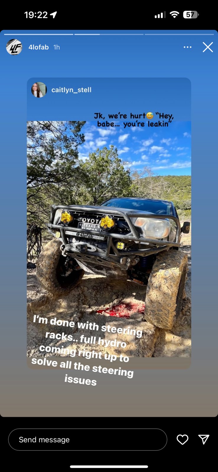

    Second rack I’ve seen blow it’s seals.
    Other than animal abuse, any idea what’s going wrong?

    I would venture to guess it's people treating these almost like they have a full hydro setup. On top of that still have cooling and pump issues with the stock steering system when on very oversized tires. Would love to hear @Basikbiker thoughts on these racks blowing like this.

    The two that I know if both blew seals soon after install.
    Now this one posted today has a very similar story.
    Good to hear that y'all aren't having issues, but he seems to have a lot of quality problems that he's not resolving.
