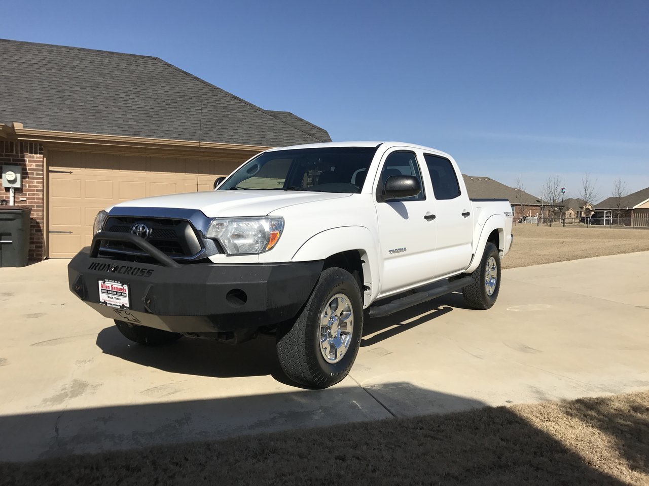

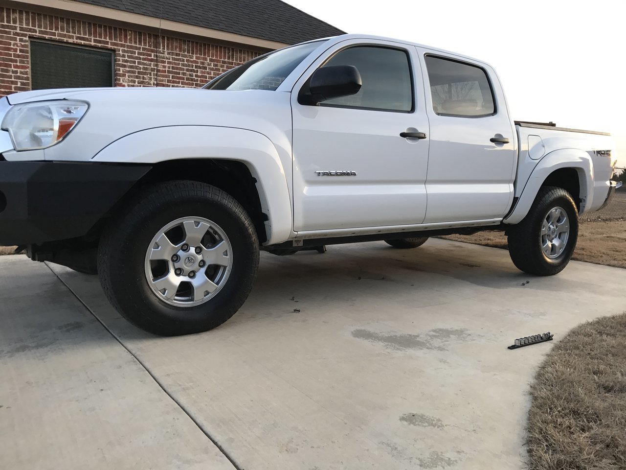

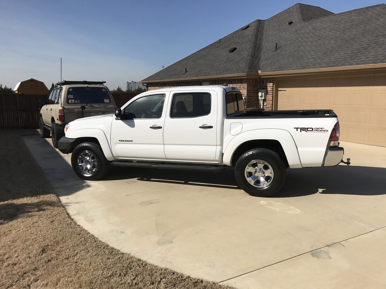

    I bought a 2012 DCSB TRD OR & got it yesterday. I'll update w/pic's of the progress & random questions. I hope someone gets some useful info out of this thread & y'all enjoy reading along & following the progress!
    Pic's of how I received it from the dealership:
    Right off the bat I removed the nerf bars (for sale), the chrome hubcaps (threw in the trash), & the dealership emblem they put on it:
    The front bumper (for sale) will be changed out for something more favorable for mild rock crawling.
    Today I ordered Fox Stage 2 kit from @HeadStrong Off-Road that consisted of Fox 2.5" ext. travel C/O's, Fox 2.0 rear RR shocks, Dakar medium leaf pack, LR UCA's & some other little items. I also ordered 1.25" spacers for the front & WeatherTech floor liners front & rear.
    I'll be running the stock 16" wheels that are in the pic's above w/ 285/75r16 tires.

    Welcome, nice 80 series in the background

    Thanks! That is THE Texas Lexus. That's been my passion for the last 4 years. Got her all finished & now she's sold.:crapstorm:

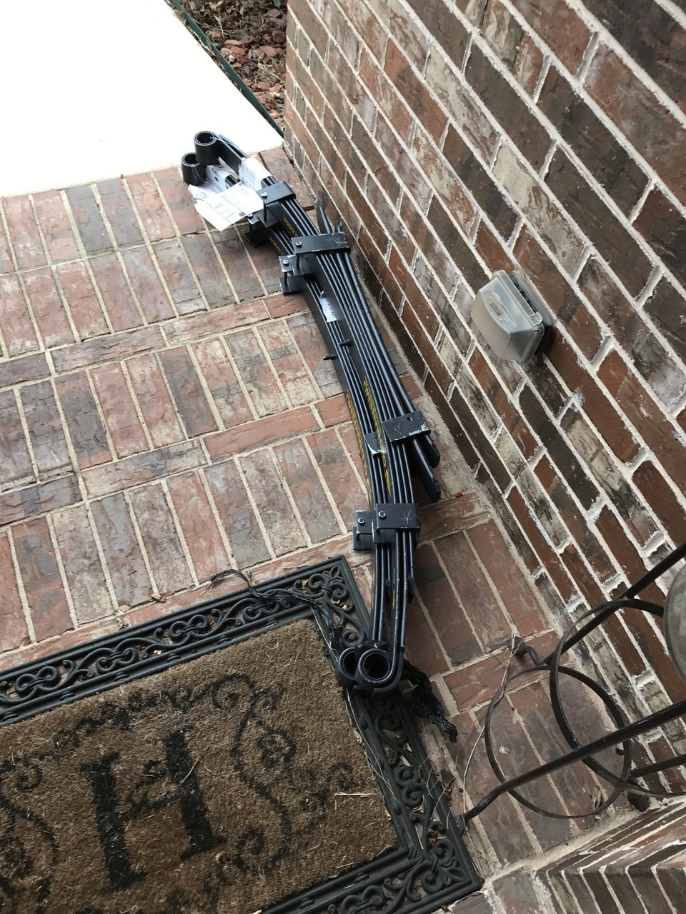

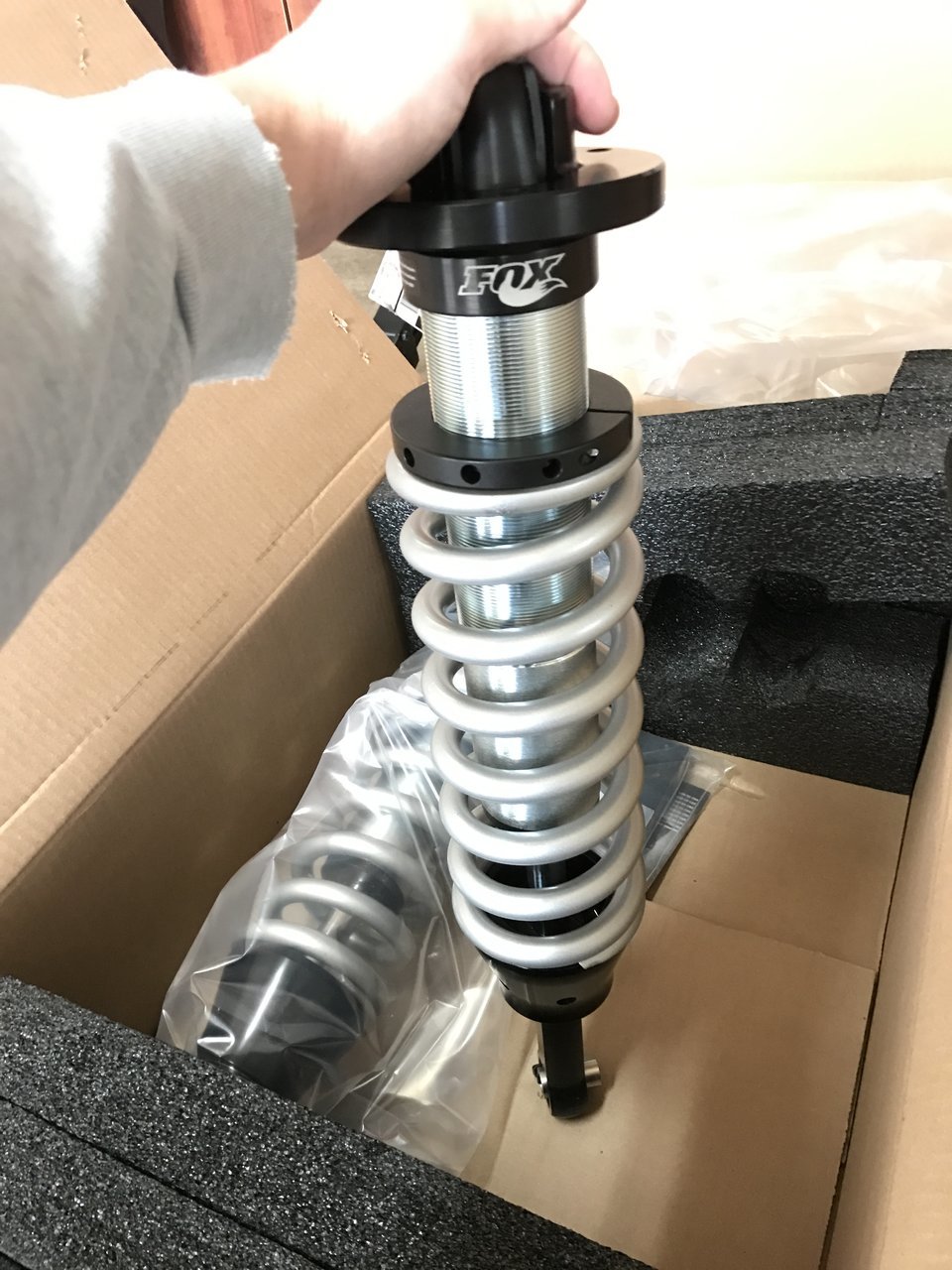

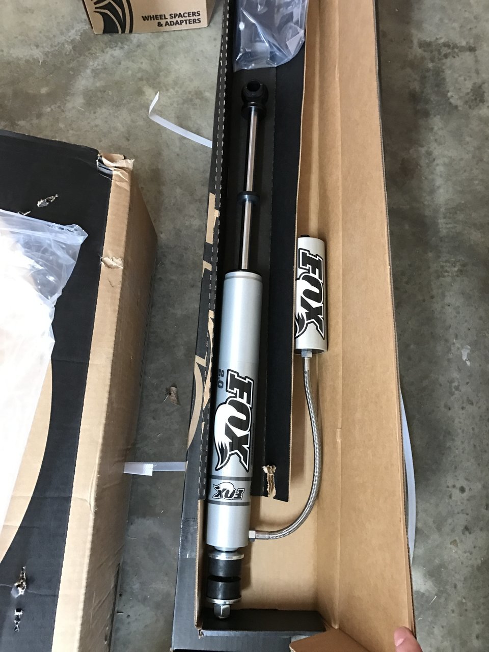

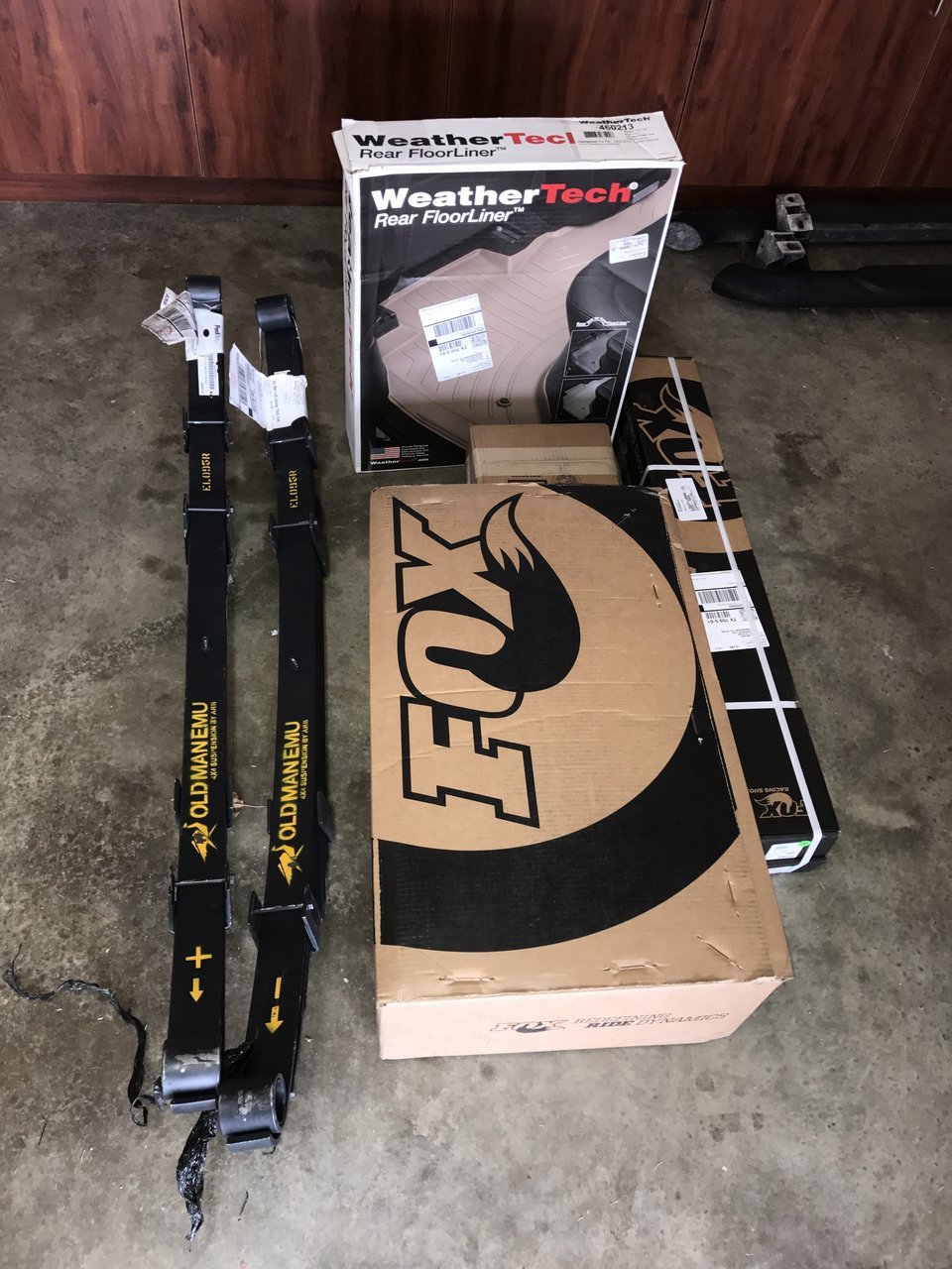

    Opened the front door to this!
    I ordered this past Friday so it took less than 72hrs to get all this! Very impressive!
    Still waiting for the bushings/hardware for the leafs, rear ext. brake lines, carrier bearing drop kit, UCA's and front mats.
    So far my experience ordering with @HeadStrong Off-Road has been stellar!!
    I'll order tires later this week and get this all installed next week. Can't wait to get the new set-up out on the trails!
