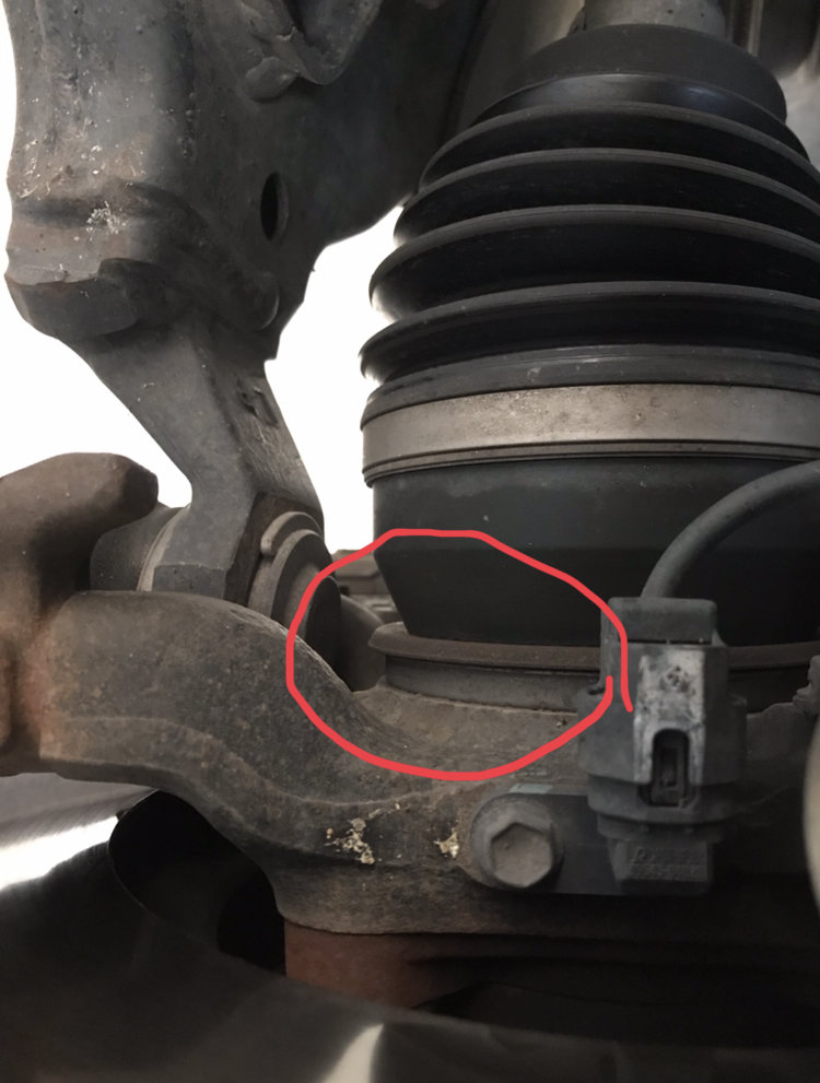

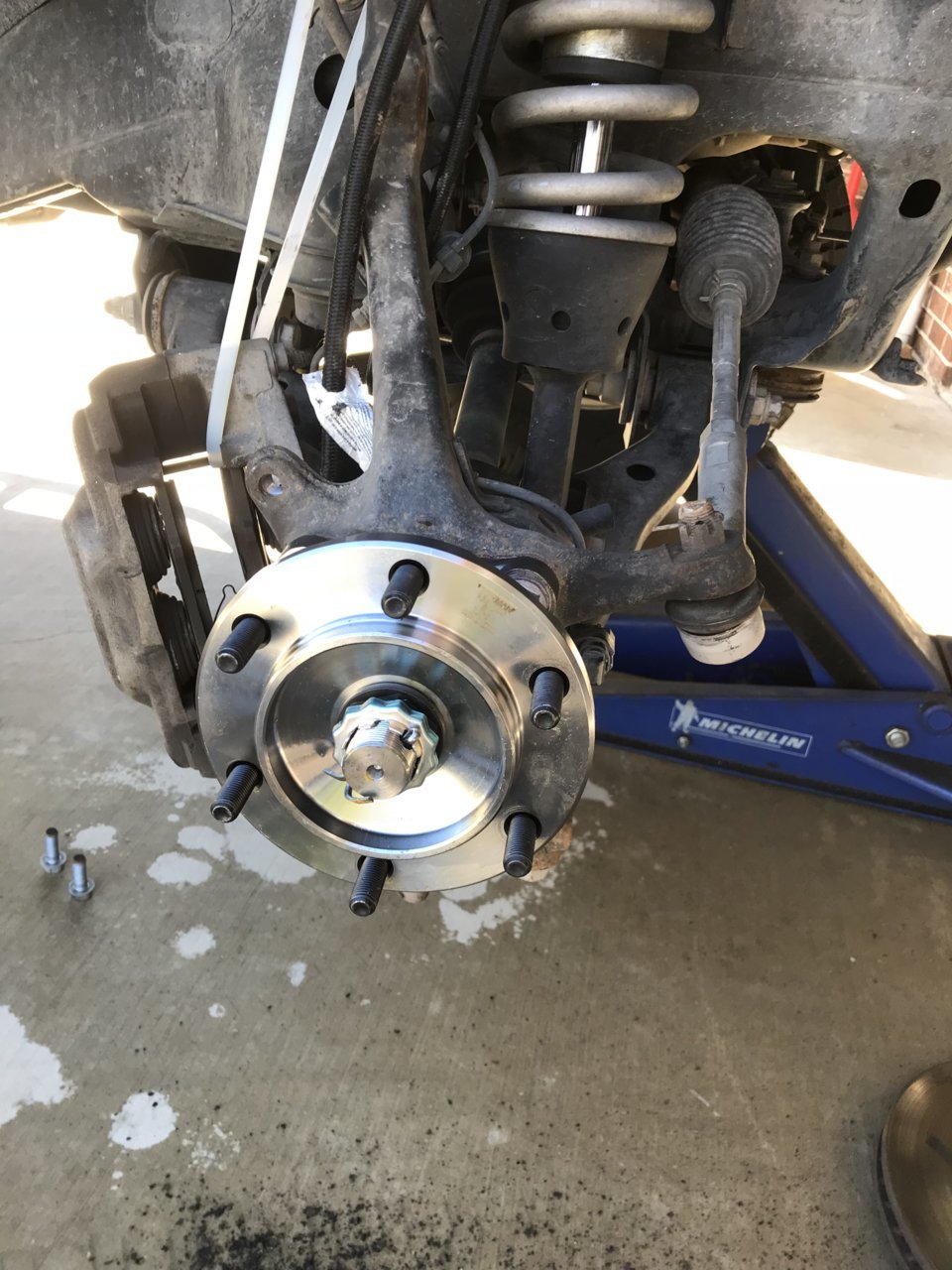

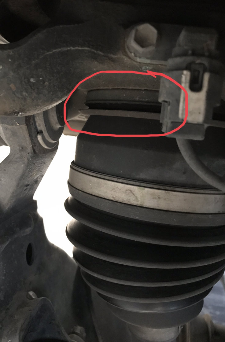

    One, or both, of my hubs only lasted 1 year. I believe it’s the PS that’s howling now. So pissed. Is this gap on the PS normal?
    DS:
    PS:
