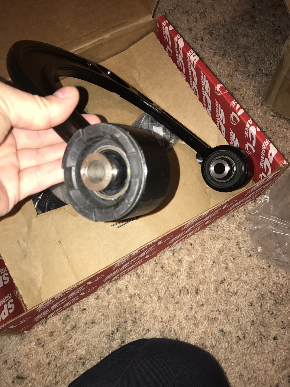

    These bad boys came in yesterday. These are the newest style SPC LR UCA's. Seems like a quality unit especially for the price. 80* of articulation!

    I've read on these rigs you want as much caster as possible so should I start with the caster washer set at the max, which is +2* on the washer which will provide +4* caster (in theory but probably won't in actuality)?

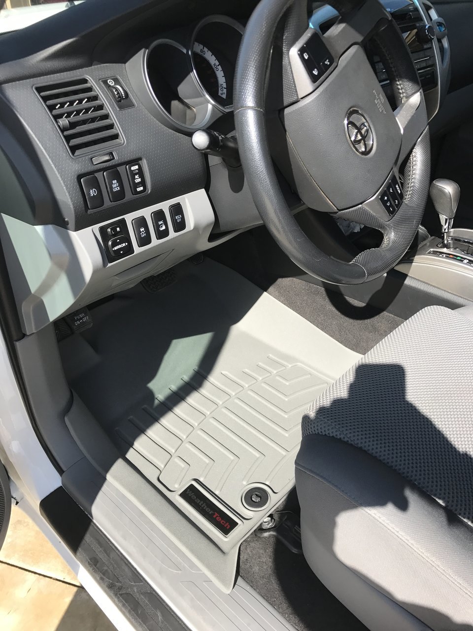

    Front WeatherTechs came in today. This makes my 5th vehicle with them. Best there is!

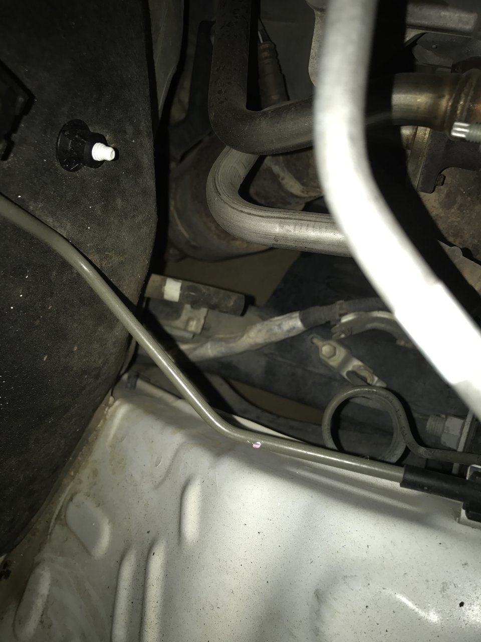

    I found this hose not connected on one end. Passenger side firewall. Is this just a drain line for the AC?

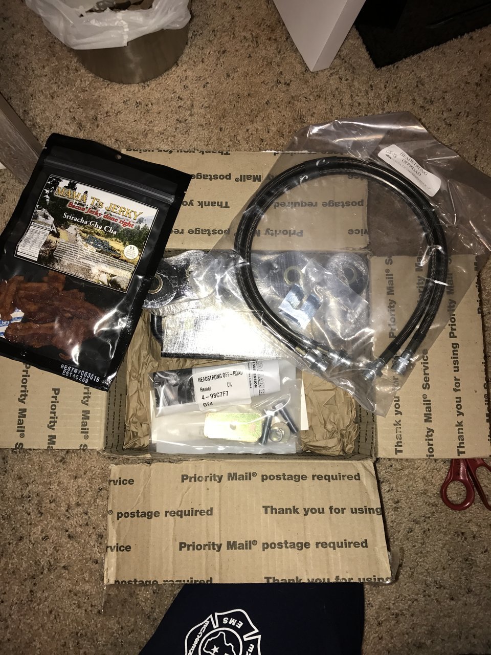

    Last set of goodies came in. Extended rear brake lines, center carrier bearing drop, leaf bushings and u bolts.
    I love bacon. I also love jerky. When I opened this box and saw they sent me not only jerky but bacon jerky, it made me realize I might be in love with @HeadStrong Off-Road !!!!!

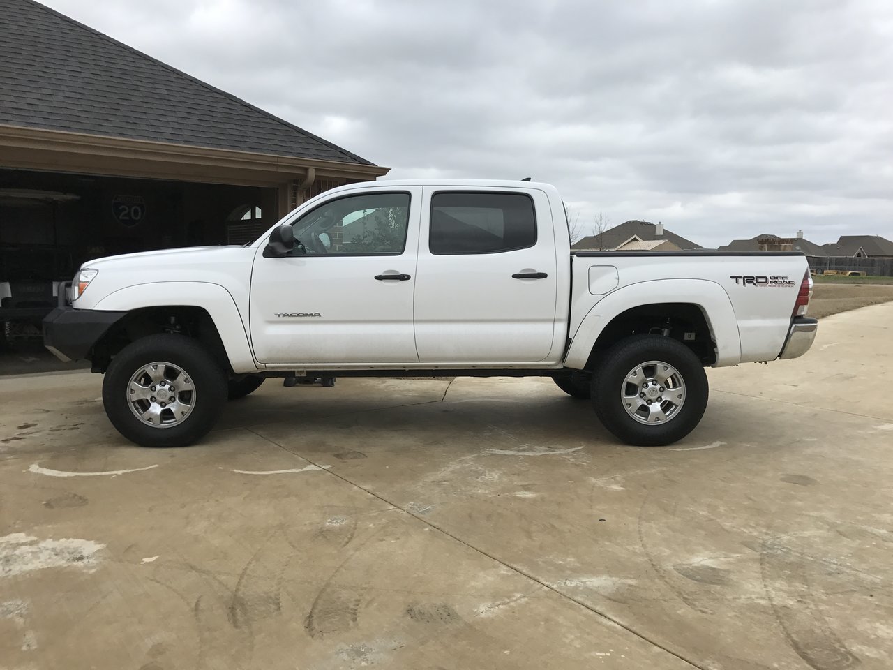

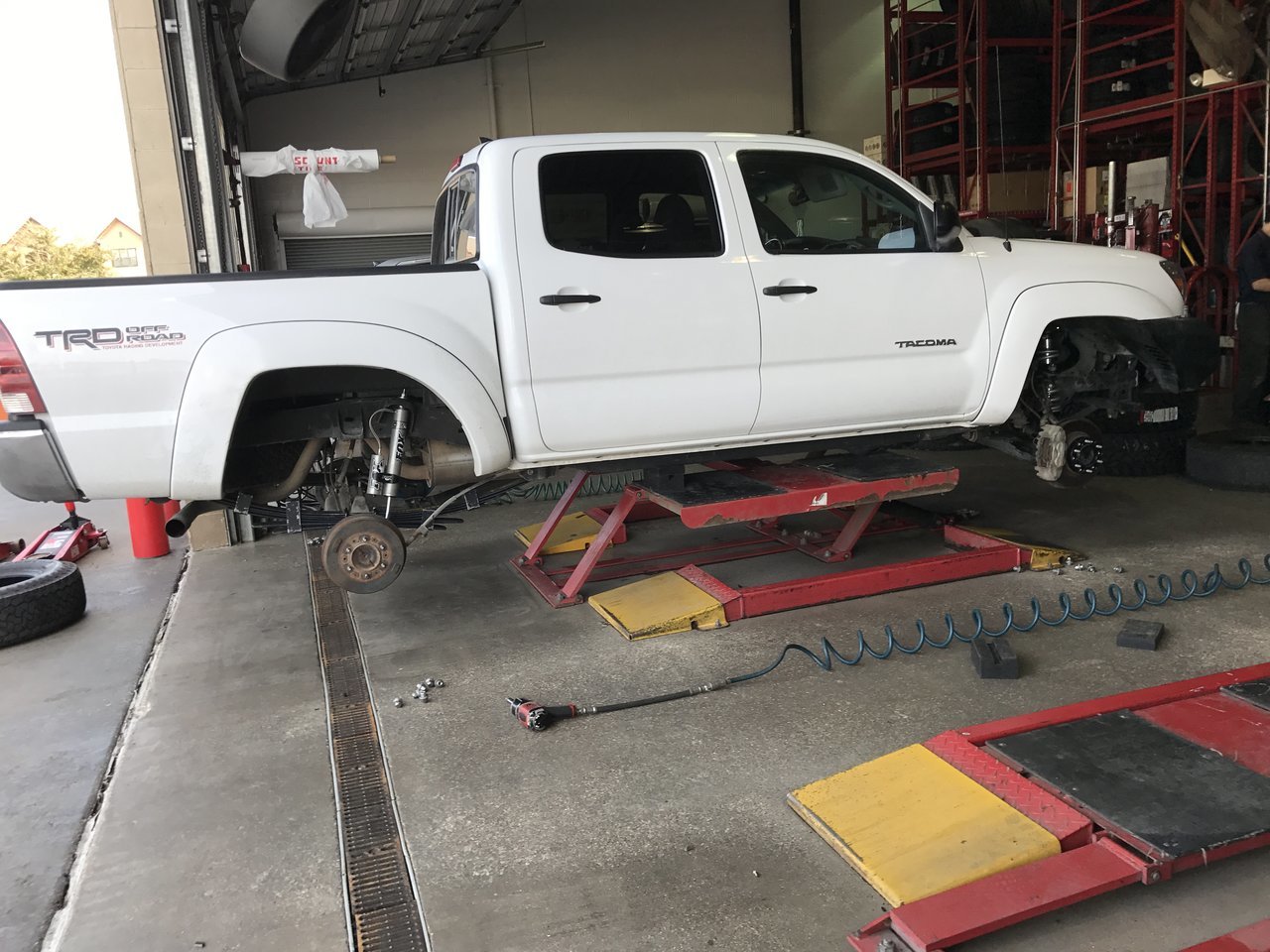

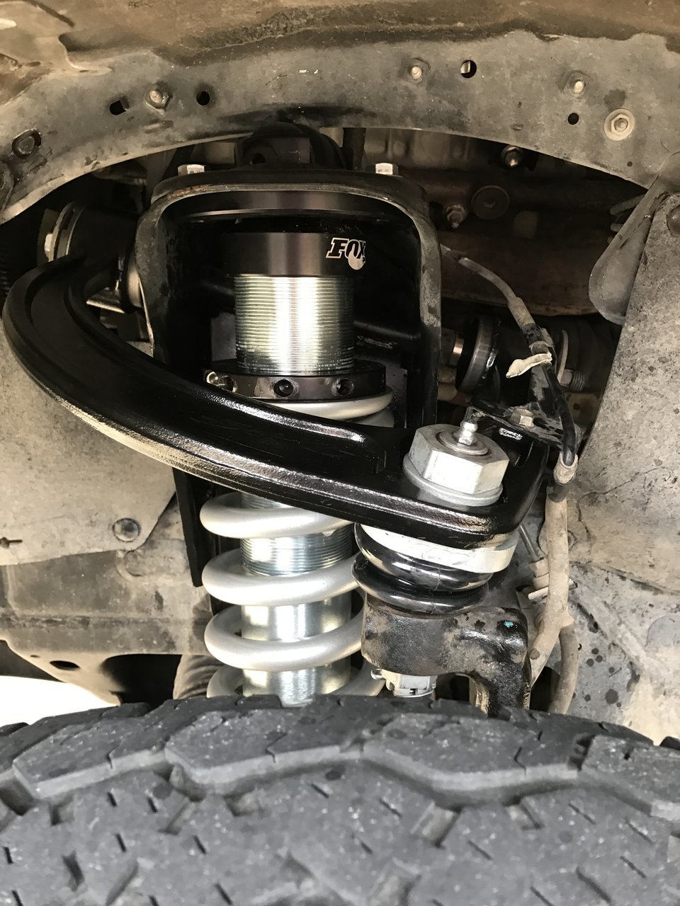

    Put the lift on yesterday, finally. Waited for 6 days to get a helpful response email from Fox, that finally came today. I took a bunch of measurements for future reference.
    With the extended travel shocks, they come @ their max height, which measures 1.925" from the inside of the collar to the inside of the tophat. They couldn't give me any other answers on measurements what-so-ever. 7 emails & I finally got this tidbit of info.
    Since they hadn't answered me on how high 27 threads/2" of threads I had to rely on other threads. I ended up adjusting them down & now I'm @ 1.8" DS & 1.6" PS (these are thread measurements, NOT actual lift measurements). I'm going to let it settle a bit & then check measurements again & go from there. Right now my drive axle boots are as tweaked as I'm willing to run them. New tires will be going on tomorrow. Anyways, here's the pics!
    ChadsPride and desertrunner24 like this.

    I forgot to add, I have a mild vibration from take-off to about 15mph then it tapers off as I speed up. Going to give the rear springs a couple hundred miles to settle in. I added the center carrier drop but might have to add 3* shims.
    One weird thing I've noticed is when I come to a complete stop, either abruptly or ever so gently, the truck rocks back & forth. It's not rolling, just rocking forward & backward, so much that my keys tap the wheel & dash slightly as they sway forward & backward. It's like hauling a huge container of water that doesn't have baffles so it sloshes forward/backward when you stop. Weird.
    ChadsPride likes this.

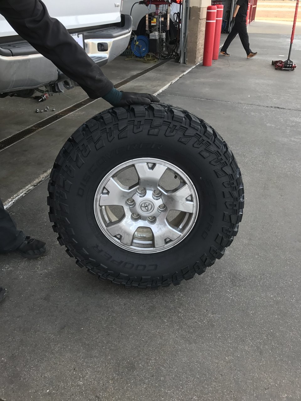

    Getting new shoes for the ol' girl. Cooper STT Pro in 285/75r16.
