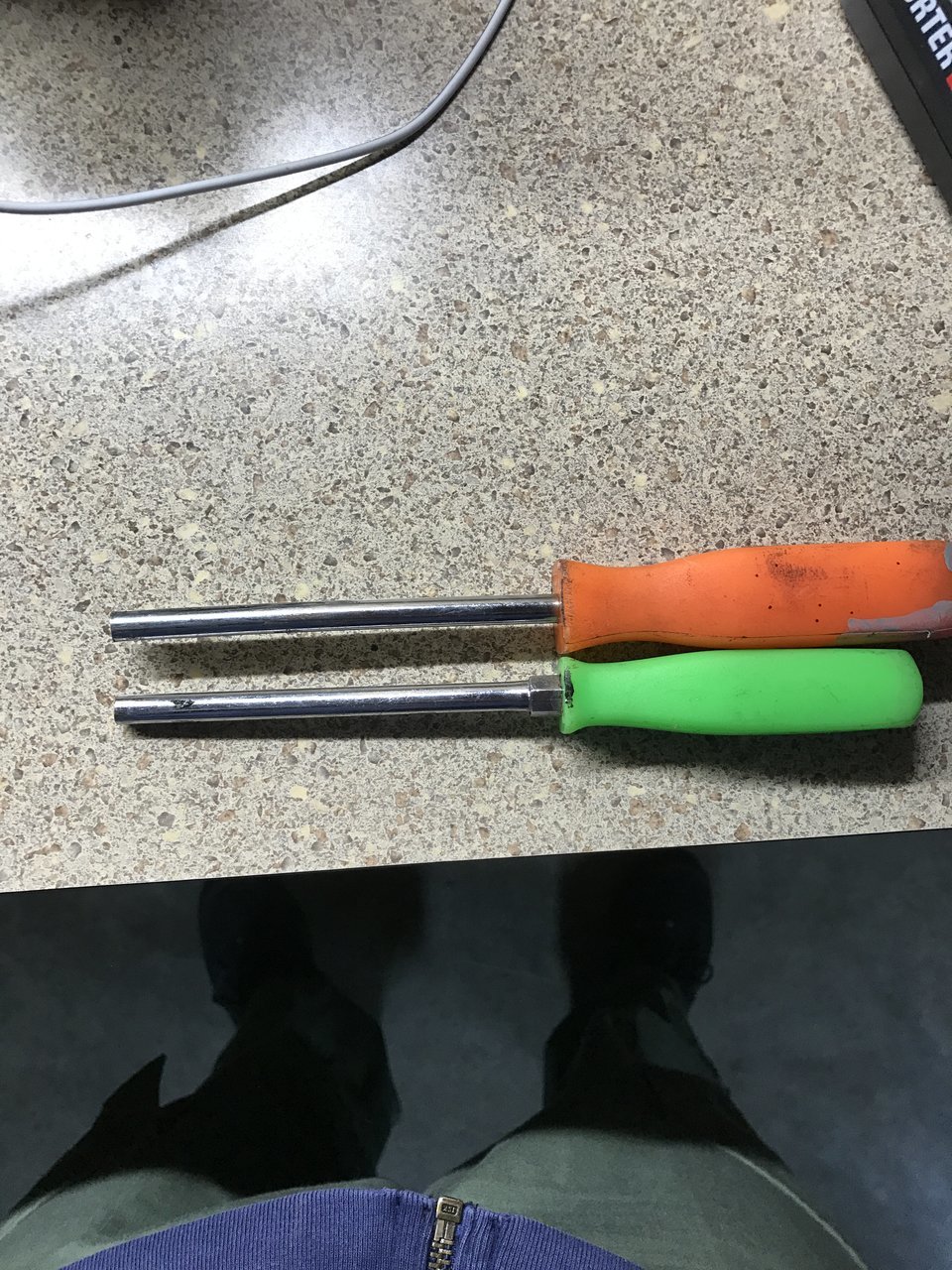

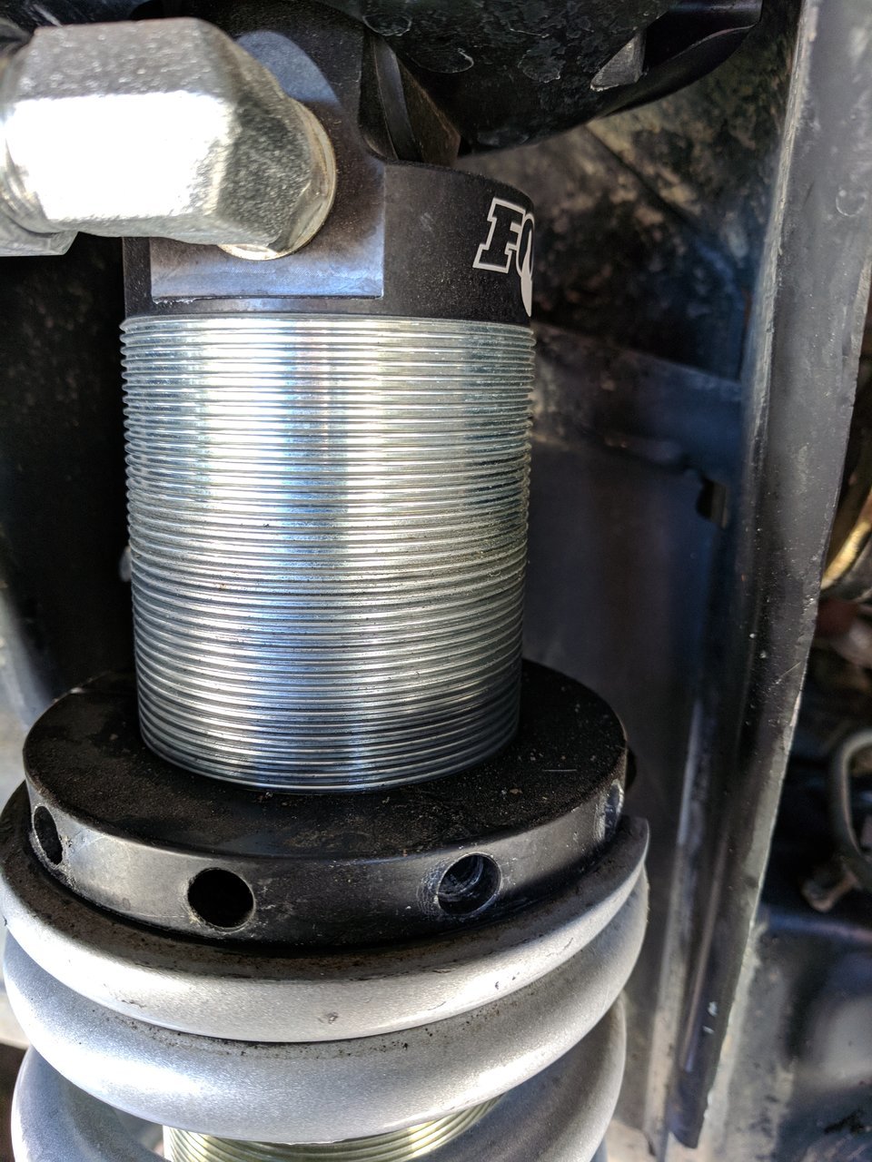

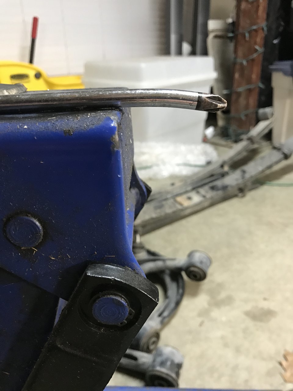

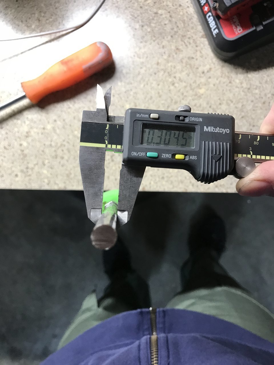

    It took me 6 days to get a response from Fox on how high of a lift these C/O's were set at that they sent me and I could only wait 5 days. I installed them and it seemed way high and the drive Axle boots were in a bad way so I lowered it. After driving it a bit it settled and now it's too low. Having adjusted them with a cheap ass Chinese screwdriver I had, because the 5/16" punch wouldn't fit, the holes got wallered out a bit. I decided to chop a couple screwdrivers that were an exact fit, after I bent the shit out of the first one. These fit exact to the Fox holes (I thinks it's really close to 8mm but smaller than 5/16" everyone else said fit). I need to crank it back up to where Fox originally had them:
    27 threads exposed = 1.925" = 3" lift.
    I ended up setting them @:
    DS - 1.925" of exposed threads
    PS - 1.775" of exposed threads

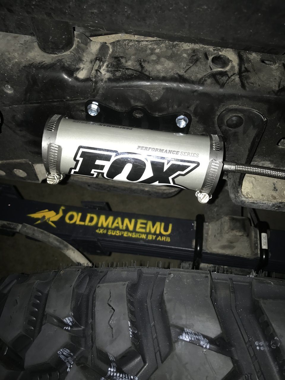

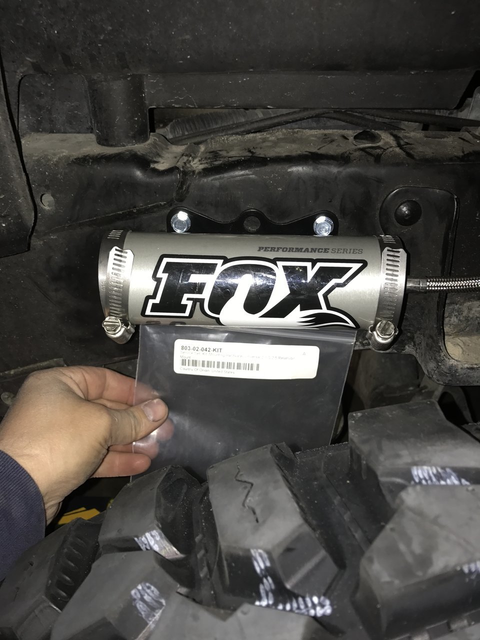

    The Fox RR frame mounting kit is BS. Here's the part number and the reservoir mounted. The bracket slots for the hose clamps is 1/2" too wide, at a minimum. The reservoir is barely clamped! Picture is crooked but mount is level.

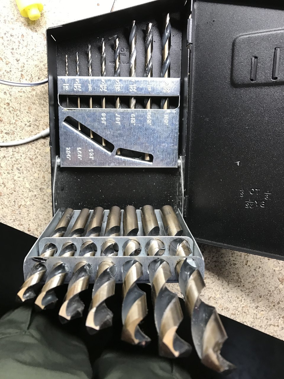

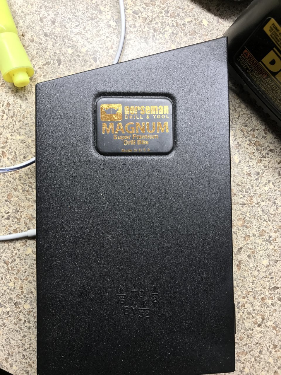

    I can't recommend these drill bits enough. With just a bit of cutting oil and the right speed they just eat right thru the frame. Good shit!
    Buy once, cry once!!!

    Those look huge!!! Home Depot, smaller hose clamps!!!

    The hose clamp length isn't the issue. It's the width of the the mounting bracket. It's at least 1/2" too wide. The bracket has slots on the outboard side that the hose clamps have to go thru. IMG_0984.jpg
    I could've made better fitting clamps myself and saved $40. On the plus side, I ordered them and the rooster tails yesterday evening and I received them today. Crazy shit got from Cali to Texas in less than 24 hours!

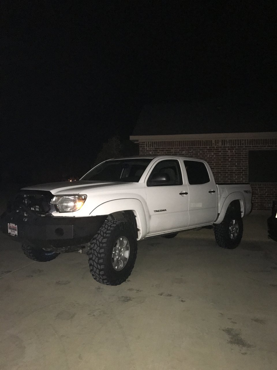

    Here's how she sits tonight. Its 0153 here, im tired and drunk. Good night America.

    Ahhh, gottcha, misunderstood in the first one!! That sucks, don't have mine on yet. Looks like they could be ground to move those clamps in a bit, but does suck they don't fit right... Swear, need to get a plasma cutter and just Fab my own parts!!!

    In the future I'll take them off to ground the slots the clamps go thru to make it where I can get them further inboard. I hear you about a plasma cutter!
