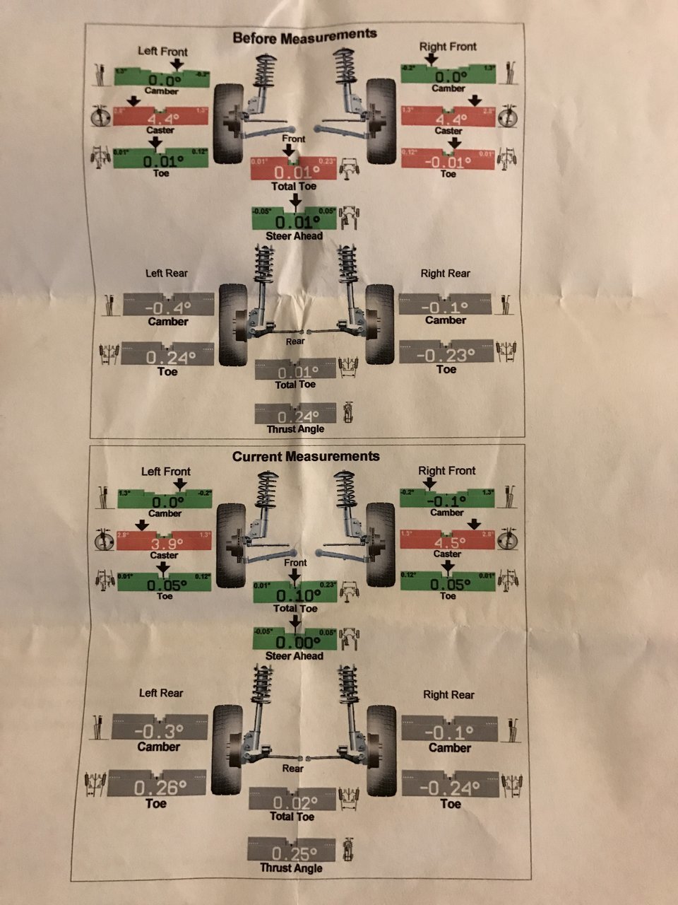

    Getting alignment done now. Tech said I had it adjusted better than most shops! I had it at:
    Camber
    DS .0
    PS .0
    Toe
    DS +.1
    PS -.1
    Caster
    DS 4.4
    PS 4.4
    This is with lower cams adjusted for max caster and LR UCA's set at neutral (+2). He's going to adjust cam bolts to try and get:
    Camber 0 (stays the same)
    Toe 0
    Caster
    DS 3.5
    PS 4

    Before and after alignment:

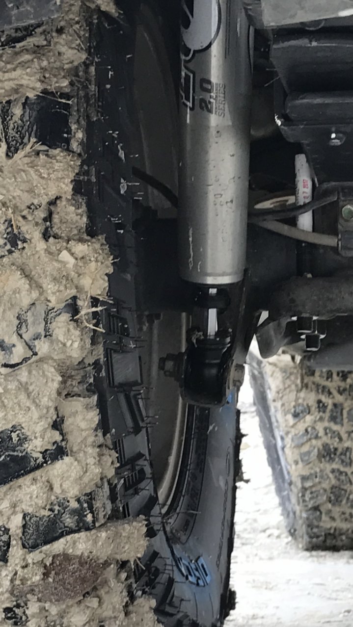

    Last night I replaced the rear brakelines w/4+ ext. The retainer clips were a PITA until I undid the upper bracket & was able to get a better angle on the upper ends. Bleeding them was super easy w/the OR electronic brake system. Took about 30 seconds!
    I need to go flex it out & make sure they're GTG & measure for rear bump stop extensions. From my math, I need just +1".
    **Question** By manually, w/your hands or whatever:
    On the Fox rear 2.0 resi's does the shock compress completely to the bottom mount?
    Or do they bottom out internally before the shock body hits the lower mount?
    Ordered SOS rock rails last week. Once I get this front bumper sold I'll be ordering front/rear bumpers & a winch. Trying to bang all this out before a Big Bend trip we have coming up in April.

  14. Feb 19, 2018 at 11:06 AM
    #74
    MolonLabeTaco
    MolonLabeTaco [OP] Well-Known Member
    Jan 30, 2018
    #242953
    2,786
    Dude
    N. Texas
    '12 DC 4x4 OR
    Just went & tested it a bit but had my daughter doing some driving so I completely forgot to llok @ the bump stops but snapped this pic of how close the shock was to bottoming out on the bottom mount. I had the rubber ring on the shaft pushed tight up to the shock body so I could see how far it'd push it (how much compression).
    I guess the shock body will collapse all the way to the bottom mount???
    Sub_Par and ChadsPride like this.

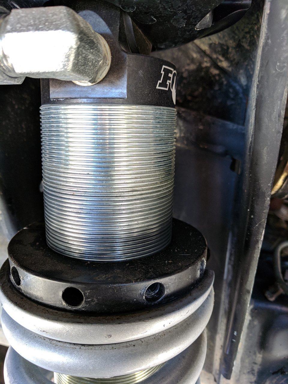

    I did the front DS only .175" of exposed threads higher (1.925 vs. 1.75), which is @ the max Fox recommends of 1.925" of exposed threads. I may crank the DS up just a bit more seeing as it has that heavy bumper on it & it's causing the whole front to sag pretty hard. DS is only lifted 2" & PS only 2.5". Drive axles look like they can handle a bit more & the front ride is plush. I need to check the droop @ this height & make sure it's not suffering. It drooped 3.5" prior to lift & I'd like to keep it close to that.

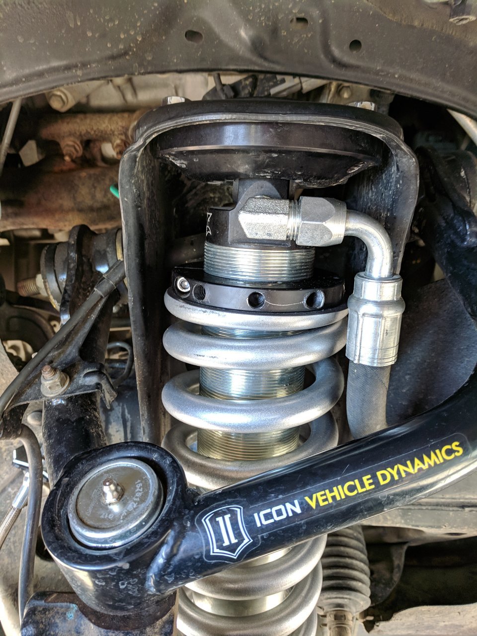

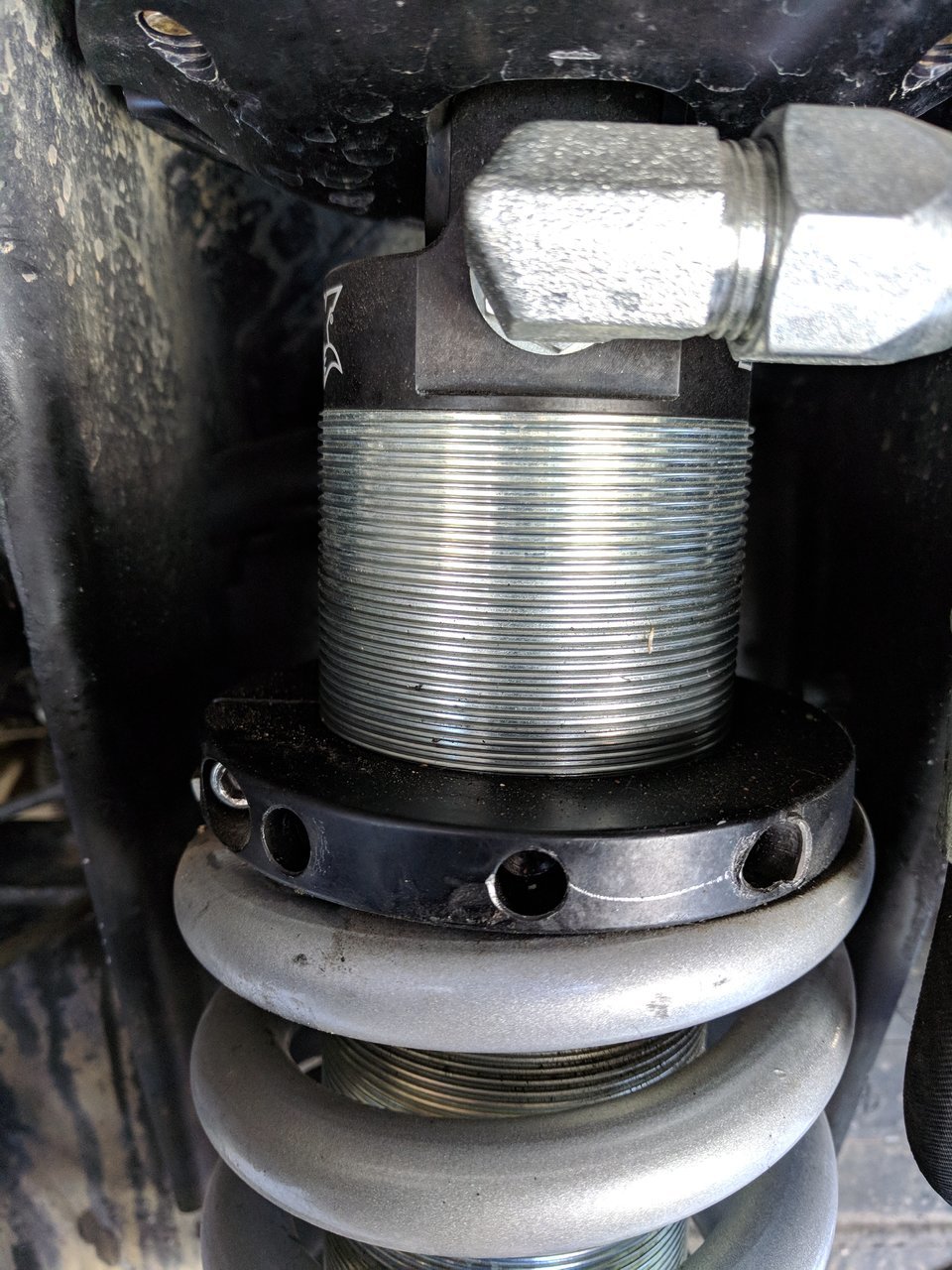

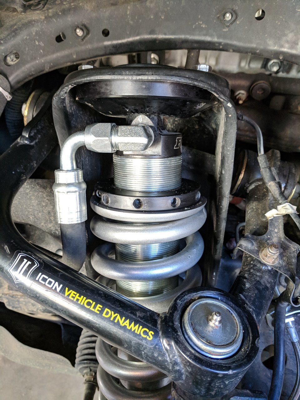

    Don't mean to jack your thread again, I just put the 14 inch 650lb eibachs on my foxes!!! Way less preload, smoother more planted ride!!! Running at 23.5 driver and passenger. Preload before was 2.5 inches Driver 2.25 inches pass, now D 1 P 5/8ths inch! First two pics are old springs!!!!

    Buffalo NY
    2011 TRD Off Road
    I’m curious to see what your cvs look like at 3.5” of lift.
