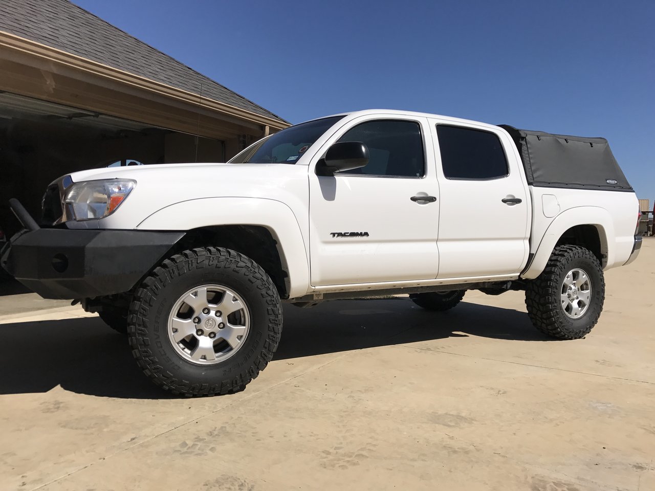

    Removed some more stuff:
    V6 on tailgate
    Toyota on tailgate
    TRD Off Road on both sides. Used a hair dryer and it made it a 3 minute job. I tried Goo Gone to remove the remaining residue but it did nothing so I tried Goo Gone Extreme and it worked like magic! Truck is filthy from all the rain but you get the picture.
    Put a hose clamp on tailgate to help slow down a thief from stealing it.
    Also trimmed the front fenders and inner liners to stop what little rubbing I've experienced. I'll know what more needs to be done when it finally quotes raining and I can go out and play a little. We've gotten over 8" of rain in the last 5-6 days so everywhere I can go is flooded out.

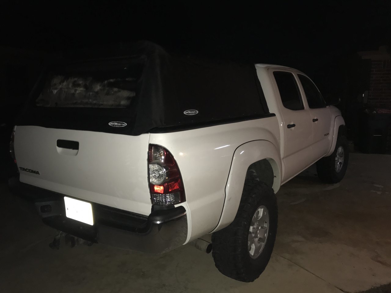

    MolonLabeTaco
    MolonLabeTaco [OP] Well-Known Member
    Jan 30, 2018
    #242953
    2,786
    Dude
    N. Texas
    '12 DC 4x4 OR
    Got a new to me Softopper today. @TexasTacoma713 hooked me up with the shipment from Houston. Great dude. Thanks again!!!
    Pic sucks so I'll post some more tomorrow in the light. Need to do some fine tuning of the adjustment but install was a breeze.

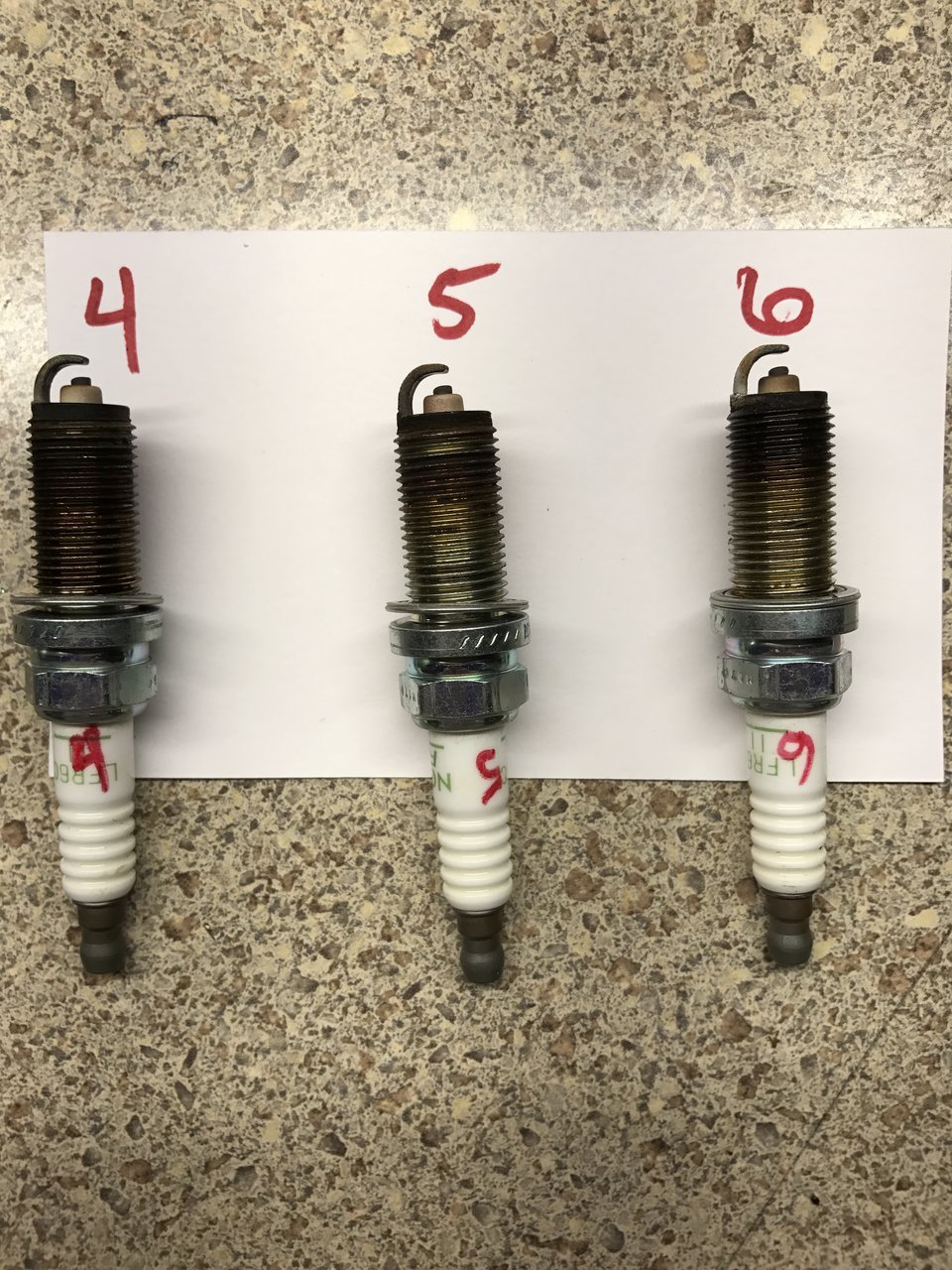

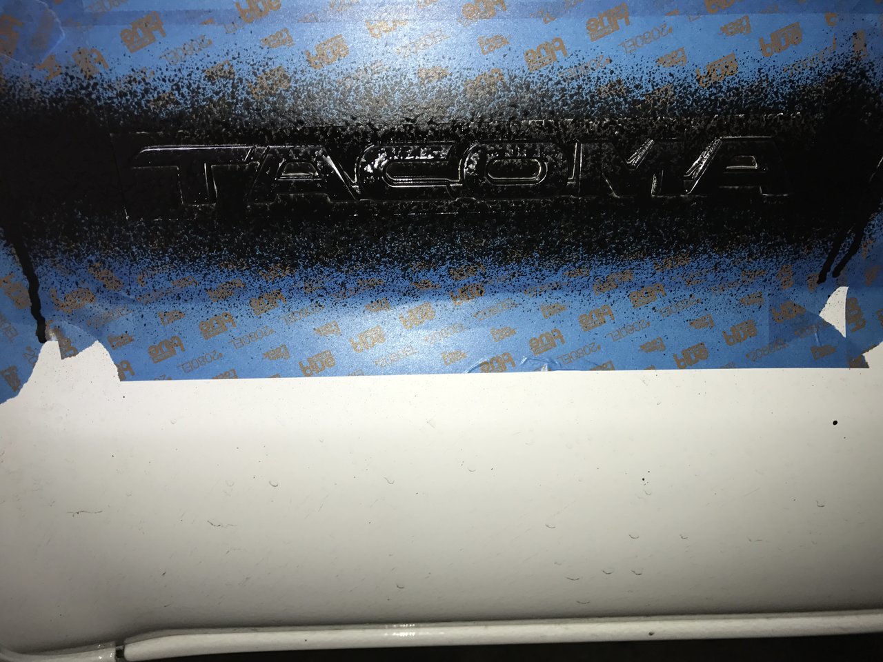

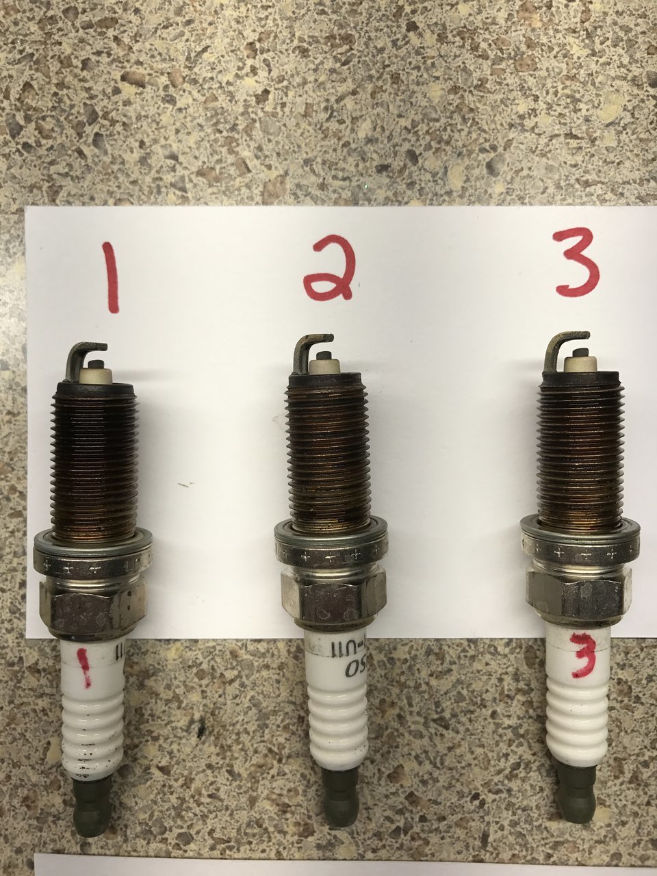

    2,786
    Dude
    N. Texas
    '12 DC 4x4 OR
    I bought this truck on Jan. 30th & even though it came w/a good history report of maint., I didn't see anything in it that pointed towards the spark plugs being changed. I'm rather anal on maint. so I wanted to change these just in case. Come to find out they were factory (Denso on PS, NGK on DS) w/79K miles. Here they are. The numbers aren't necessarily the proper firing order, as IDK what that is yet. #1 is back PS & they go counter-clockwise from there end in back DS. Took about an hour causally drinking cold beer as I did it. They were all over .045".
    I also tried to plastidip my emblems. It must've been too cold because it looks like total shit. The plastidip came out like sludge. It was 51°.
    Just went and checked the plastidip job out. Looks like ass. I'm just going to remove the Tacoma emblems and be done with it!

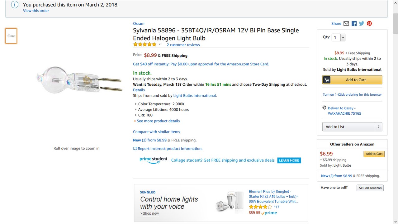

    Installed Gy6.35 HIR reverse lights because w/the factory reverse lights I couldn't hardly see anything using the back-up camera. I followed the write-up on TW on which to buy & how to adjust the legs.

    2012 FJ Cruiser
    Bilstein 5100 all around, first clip front. AVS window visors, BFG AT KO2s. JBL.
    Hey on the plastidip try letting your cans warm up in hot water for 15 mins before spraying. That's how mine looked before I did my bumper, after warming spray was much finer and looked right. That stuff is great, but sensitive to temp!!
    MolonLabeTaco[OP] likes this.

    Where did you buy your Gy6.35 HIR lights?

    Amazon.<I didn't hyper-link the word to the left. This site does that I guess, IDK.

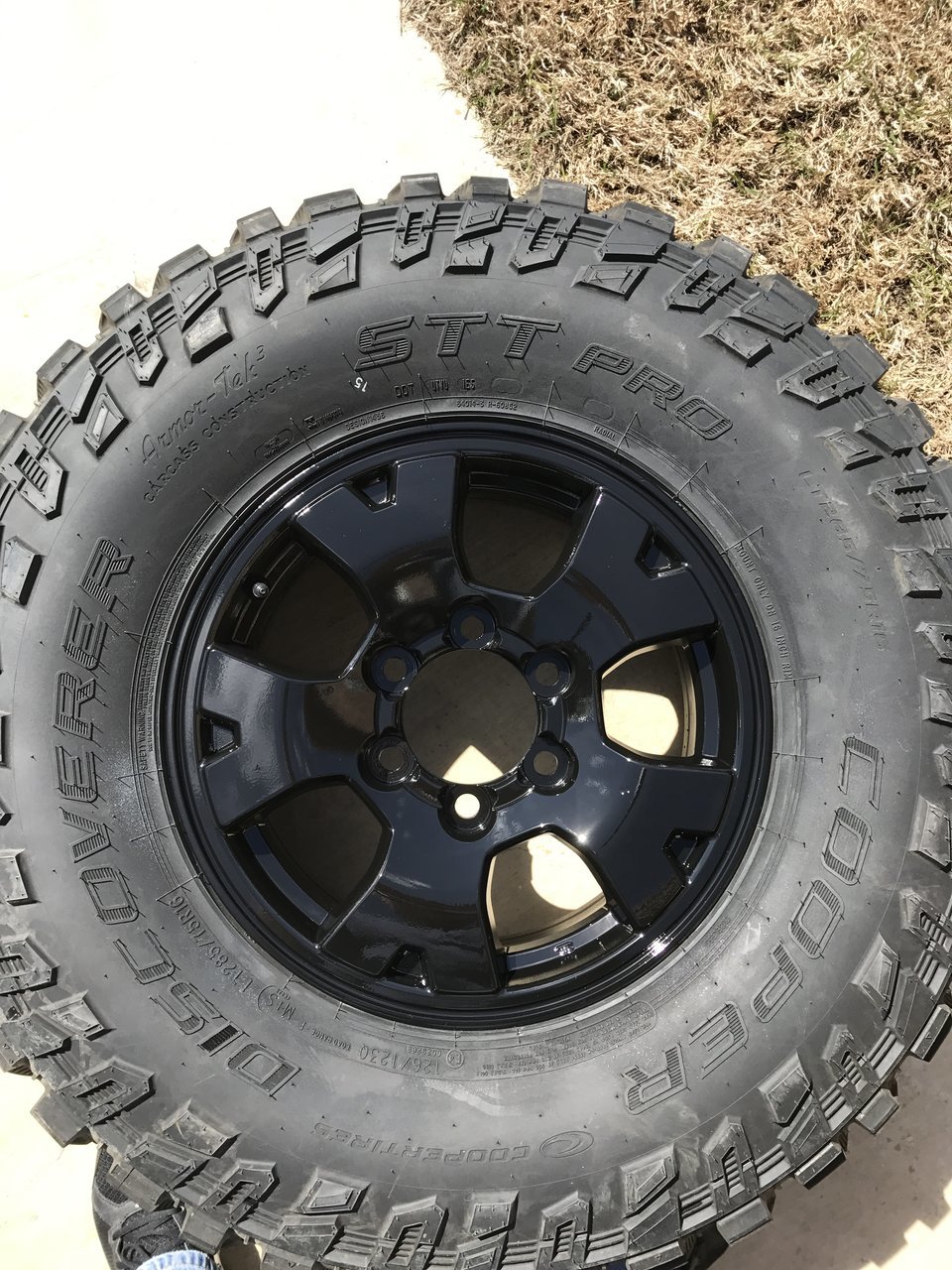

    Jan 30, 2018
    #242953
    2,786
    Dude
    N. Texas
    '12 DC 4x4 OR

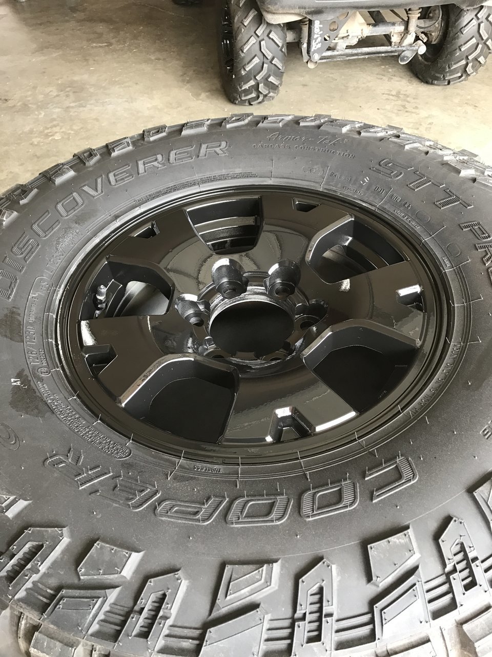

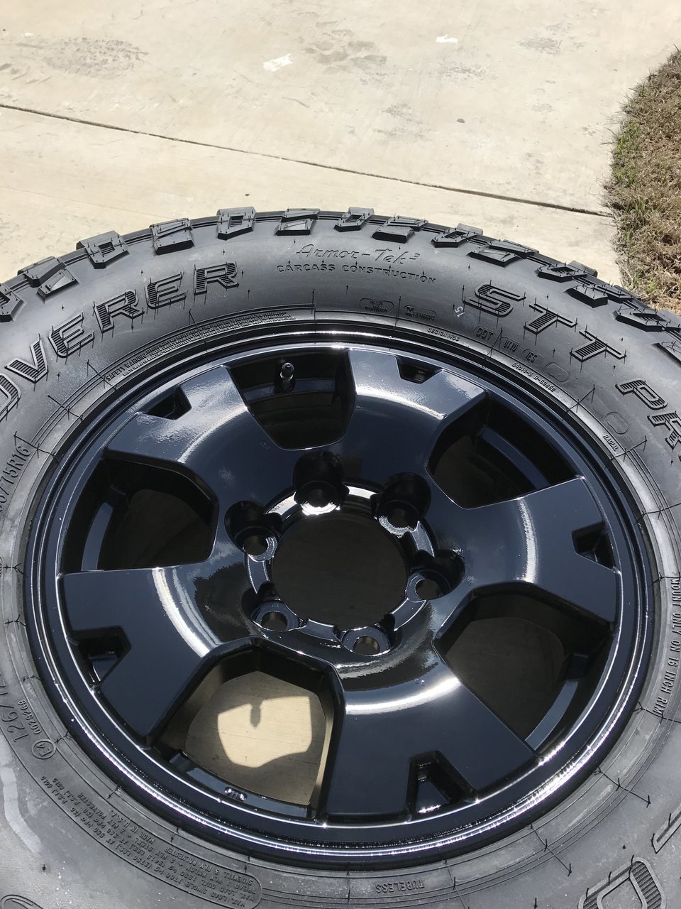

    Painting my wheels black. I'm hoping this works out well!

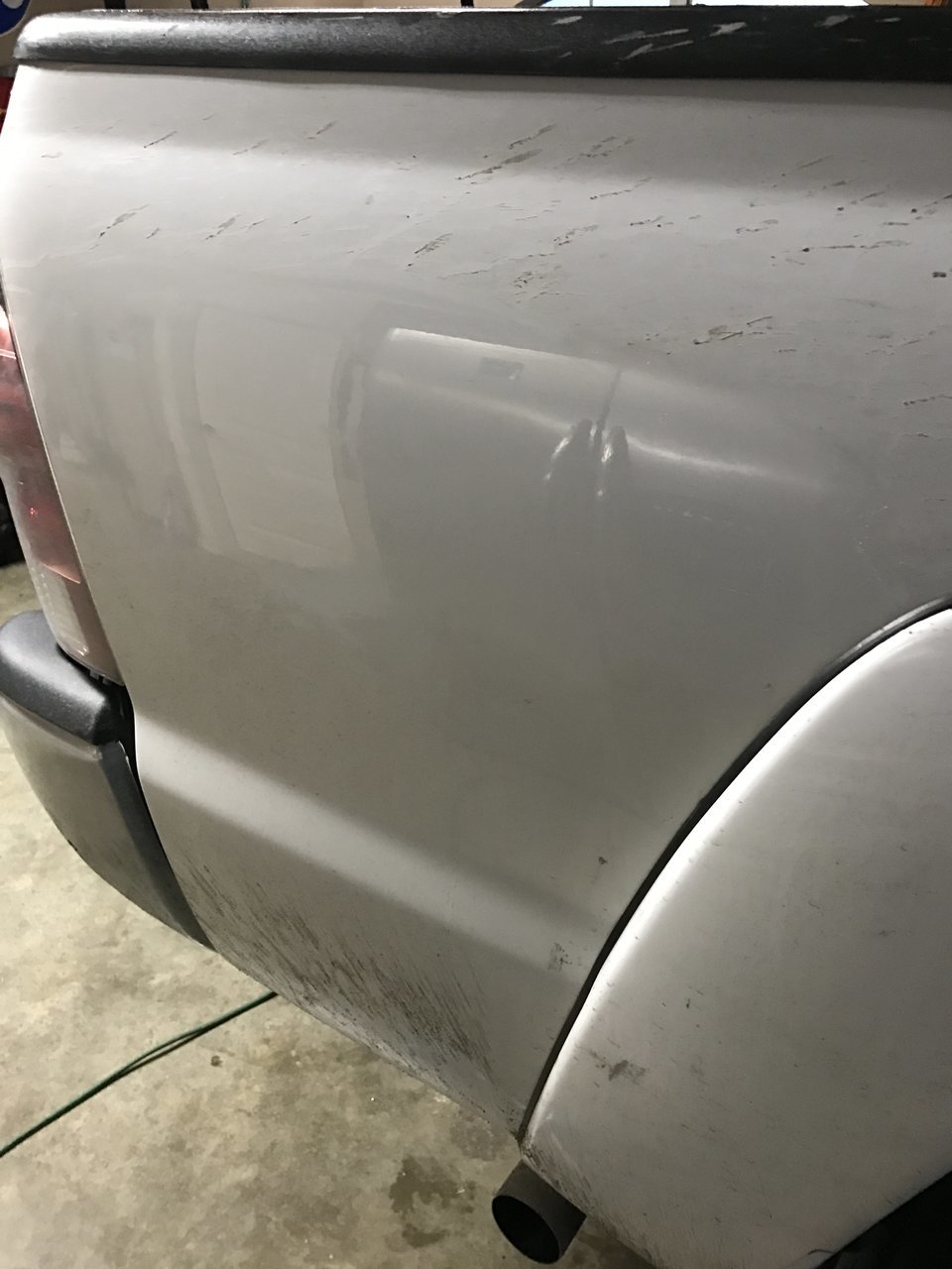

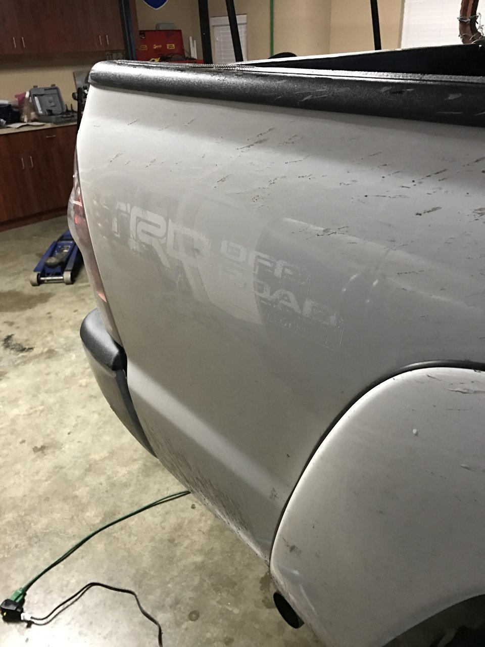

    Whoa!!! Something was left behind after cleaning!!!
  19. Mar 10, 2018 at 7:11 PM
    #99
    MolonLabeTaco
    Jan 30, 2018
    #242953
    2,786
    Dude
    N. Texas
    '12 DC 4x4 OR
    That's what I'd think but I did them all the EXACT same. Weird deal. Luckily they're small!
