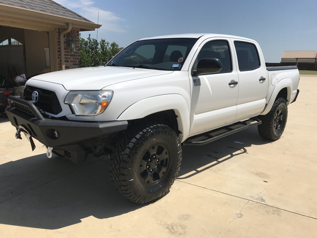

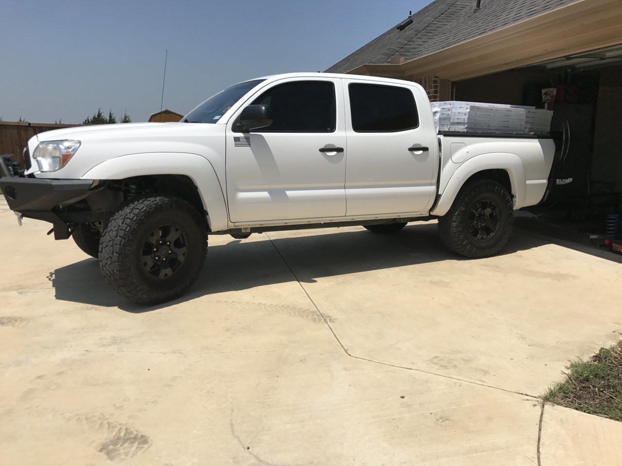

    Just noticed from this pic the car wash jacked up my front license plate. They're so cheap since they changed to putting the letters/numbers on w/paint & don't actually stamp them out anymore. Easy fix, though.

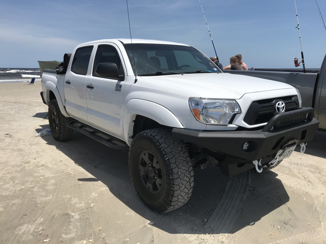

    Just drove 2,375 miles from Texas to Smoky Mountains NP over to Myrlte Beach, SC & back in 6 days. Man what a drive!!! Over 40hrs in the drivers seat. Truck did great but after that amount of drive time my back hurts from the seat. I guess that's to be expected!

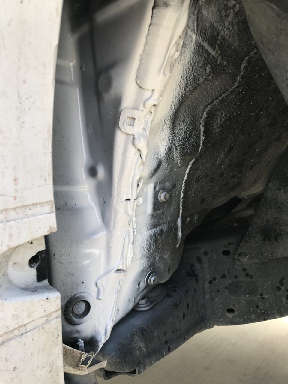

    Hammered down the front fender inner pinch welds. I make 3 small cuts on each one to make it easier to bend them over. The actual cutting & hammering part took <10 minutes w/a 4lb sledge. I didn't try to make the paint look good, just super think. I put the inner liner back on so you can't even see the paint.

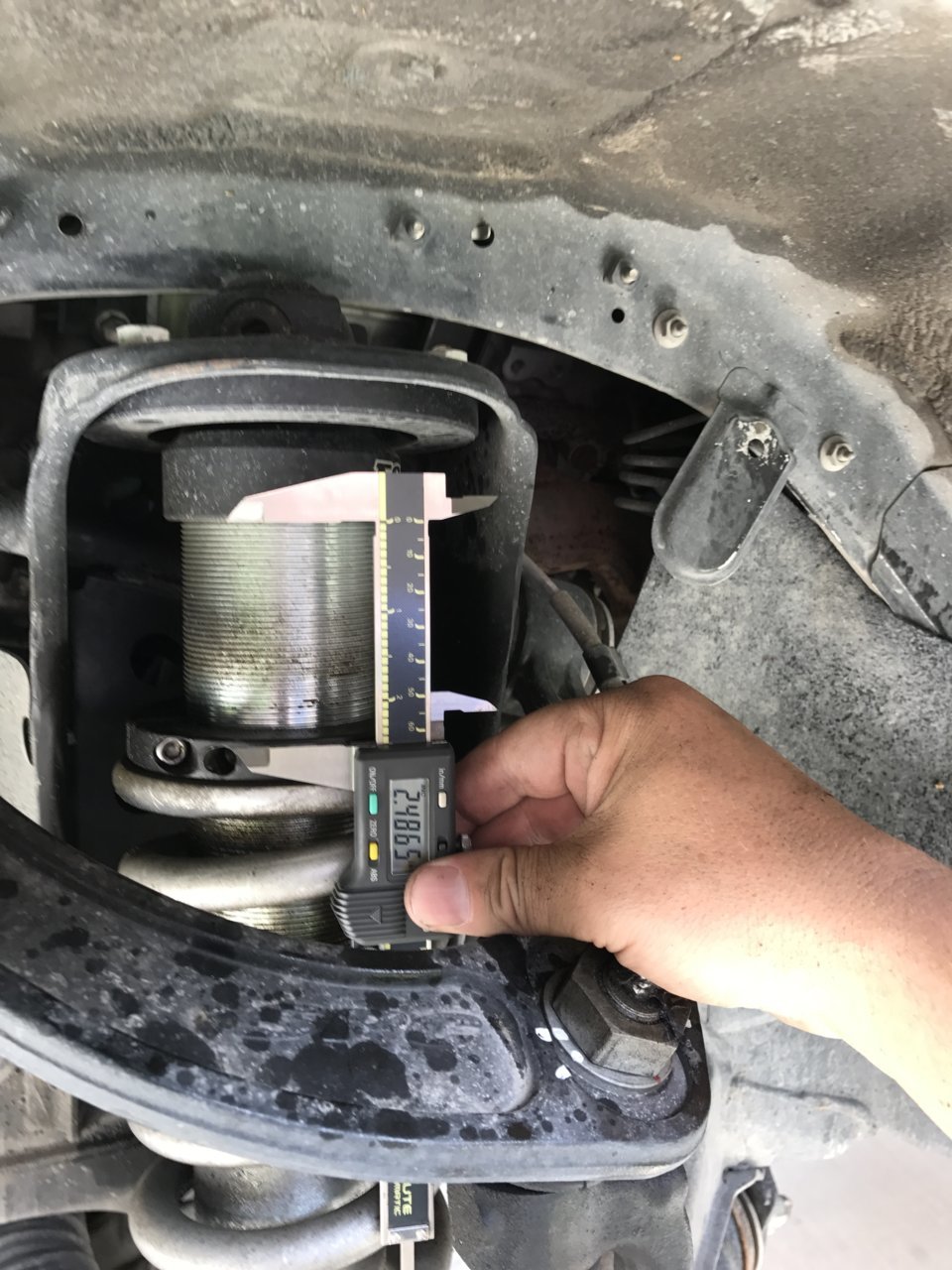

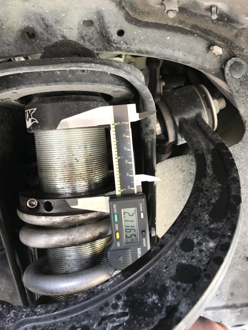

    I also adjusted the front C/O's. Again. I added 3 full turns to the PS & 4 turns to the DS, so now the DS has 4 more full turns than the PS & it's still lower. Even w/them pre-loaded this damn much, I only have 2.5" lift PS (22.5") & DS (22.25") w/PS being 1/4" taller w/an empty fuel tank on no driver. I still have just over 3" droop. I won't be adjusting them any higher before I swap to the 650lb 14" King's I have.
    PS:
    DS:

  10. Jul 10, 2018 at 11:00 AM
    #150
    Biscuits
    Biscuits Thorny Crown of Entropy
    Aug 8, 2010
    #41397
    15,577
    Swiggity swangin' biggity bangin'
    @MolonLabeTaco
    How is the ride with the preload/height you have now?

  11. Jul 10, 2018 at 2:04 PM
    #151
    MolonLabeTaco
    MolonLabeTaco [OP] Well-Known Member
    Jan 30, 2018
    #242953
    2,786
    Dude
    N. Texas
    '12 DC 4x4 OR
    I just did it this morning & have only put ~25 miles since I did it. Thus far, I feel no difference.

  12. Jul 10, 2018 at 2:07 PM
    #152
    abqnurse80
    abqnurse80 Well-Known Member
    Mar 27, 2017
    #214544
    987
    Nic
    ABQ, NM
    2012 FJ Cruiser
    Bilstein 5100 all around, first clip front. AVS window visors, BFG AT KO2s. JBL.
    Man I'm sorry your having these problems.. hope you remember me from earlier threads. Not a fan of the fox front springs at all. Had the same preload to get the same lift your getting. My shocks are current at accutune for a revalve. Hope that'll help the rear end!! As for the front, 14 inch at least 650lb springs. These being advertised for 1-3 inches of lift is rediculous....
  13. Jul 10, 2018 at 2:15 PM
    #153
    MolonLabeTaco
    Jan 30, 2018
    #242953
    2,786
    Dude
    N. Texas
    '12 DC 4x4 OR
    Yes, I remember you! I've been crazy busy & haven't had time to strip the blue paint off the Kings so I can paint them then get them swapped out. It's become a PITA, to say the least. I thought by spending the coin I did, I'd be good to go. Uh, nope. I saw you're getting yours revalved. That's awesome!

  14. Jul 10, 2018 at 2:24 PM
    #154
    abqnurse80
    Mar 27, 2017
    #214544
    987
    Nic
    ABQ, NM
    2012 FJ Cruiser
    I hope so, just keep thowing money at it until I like them.... Still right now cause of the group by I'm about even with retail.. Just rediculous, don't think I'm searching for a mid travel setup that'll perform like a LT, but for God's sake fox.... Hopefully the revalve will smooth my rear end our, and the bigger springs in the front will get me my lift back minus all the preload.. I shudder to think what it would be like running a steel bumper and winch with the stock fox coils. Yeah, life happens, hope the springs work out for you!
  15. Jul 10, 2018 at 2:27 PM
    #155
    MolonLabeTaco
    Jan 30, 2018
    #242953
    2,786
    Dude
    N. Texas
    '12 DC 4x4 OR
    The ride is pretty damn good but I wanted 3" of lift, w/out pre-loading the shit out of it. I'll get there one way or another!
    Biscuits and abqnurse80 like this.

  17. Jul 10, 2018 at 5:03 PM
    #157
    Broheim
    Broheim Well-Known Member
    Feb 16, 2016
    #178360
    630
    John
    San Antonio, TX
    2023 TRD Pro
    Very strange that you're having these kinda issues on a 2nd gen.
    I just looked through your first few pages of thread...
    The front bumper is the issue. Too much weight for the og springs the Fox l2 comes with.
    I'm on a 3rd gen, but no extra accessories or weight and I'm at 2.7" of thread showing with 2.5" of lift..exactly 100% level.
    My setup is just like yours except I'm on HS 3leaf aal (overload left in) and TC UCAs.
    The overload really raised the height of the rear to the max so to level it out I really had to crank up the coilovers. If I had taken the overload out, preload would be less to get it level.
    My ride is pretty awesome and I drive the shit out of my truck. No weird bounces or strange road behaviour.
    I bet it's the weight of that bumper. 2nd gens are lighter so it must be nose heavy.
  18. Jul 10, 2018 at 5:32 PM
    #158
    ItalynStylion
    ItalynStylion Sounds Gooooood
    Jun 15, 2009
    #18467
    5,926
    Steven
    DFW, Tx.
    09 Double Cab TRD Sport 4x4
    Sounds like you should have gone with a 14" spring or a higher spring rate. Not saying you should have known better, just saying that's likely the best solution for you. The longer spring or higher spring rate would allow you to not need as much pre-load. I actually just landed on a set of Fox 2.5s and I went with a 14" 650 coil. :D

  20. Jul 11, 2018 at 12:45 PM
    #160
    Sub_Par
    Sub_Par Well-Known Member
    Nov 17, 2015
    #169939
    4,074
    Steve
    Buffalo NY
    2011 TRD Off Road
    Higher spring rate would have less preload but same rate but longer will have the same preload to achieve the same height. The answer here is only higher spring rate, which he has waiting to go on.
