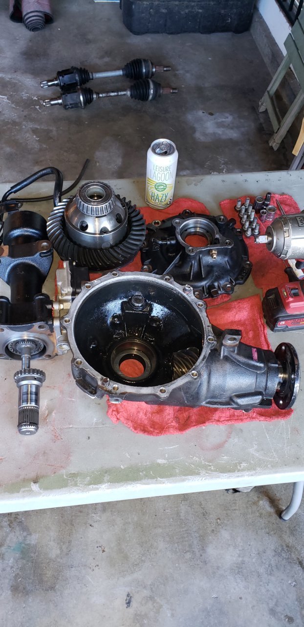

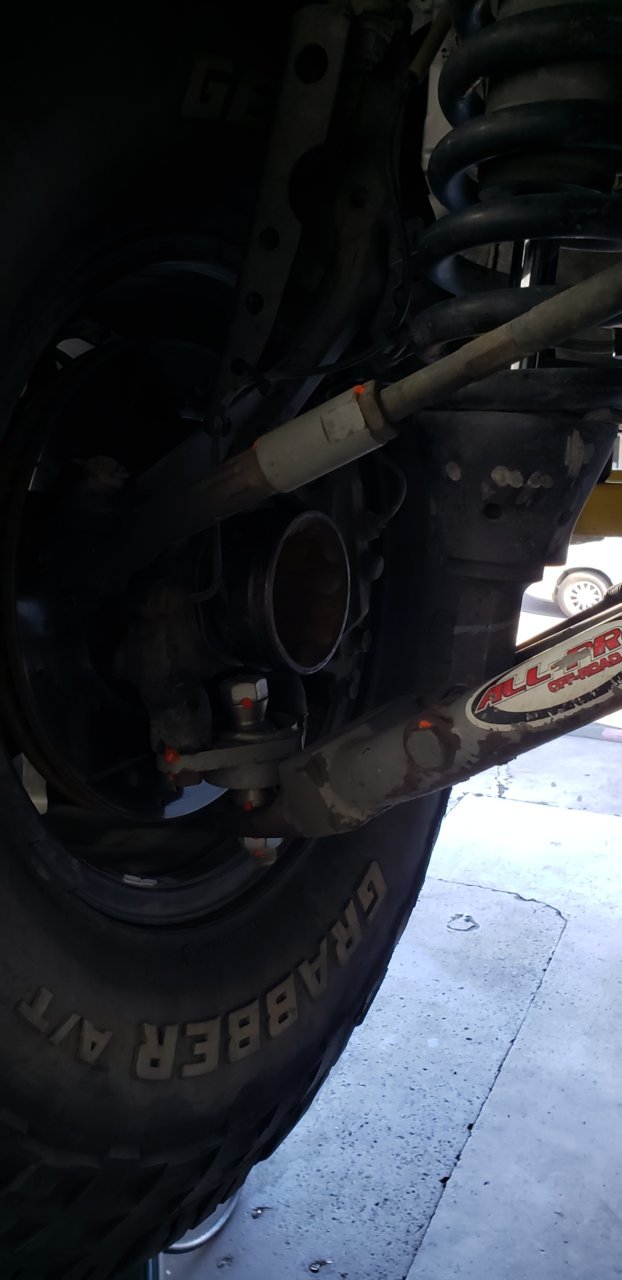

    End of October of this Pandemic Year we did a quick weekend trip to Death Valley's most Southern Western edge along the Panamint Range. During this trip there was a very slight noise heard from the front when I engaged into 4H, wasn't enough to be concerned about. Just enough to make you think to yourself.."huh" but it kinda went away. A few weeks later I spent the day doing trails in the snow with some close friends and had a blast. During this trip is when the noise quickly became an actual concern that needed to be addressed sooner than never. The slight noise quickly became a very loud grinding noise that started instantly when engaged into 4wd. First thing I did on Monday was to put it up on the hoist (I'm a mechanic so I have access to racks and hoists) to hear where the noise is coming from. Well, the front differential pinion bearing decided to call it quiets..Fuck
    The noisy pinion bearing..
    https://youtu.be/9U0EnIODRCA
    The removal:

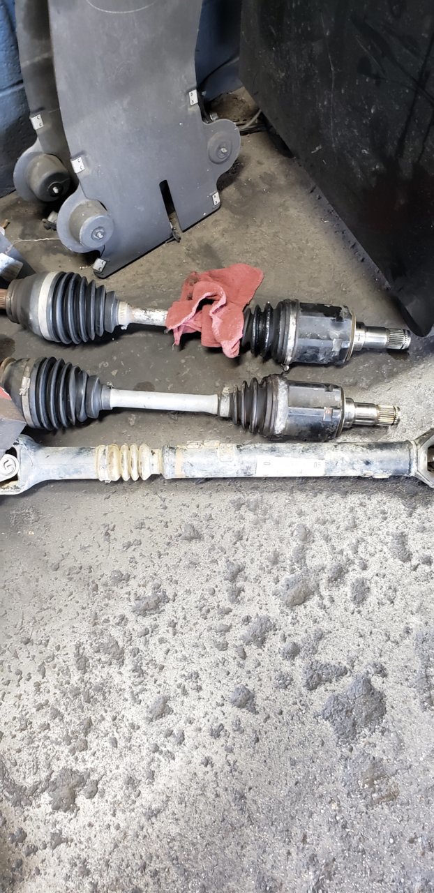

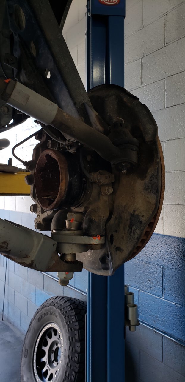

    Frankenstied the front wheel bearings with outer CV's that I usually carry as spares while on the trail. Doing so allowed me to still drive my junk in 2wd without worrying about the front wheel bearing assemblies imploding on themselves:

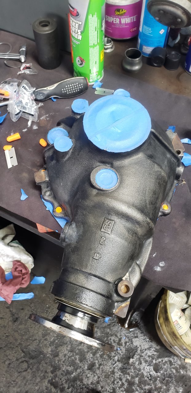

    The Front 8" Clamshell Differential with already installed 4.56 gears and ARB Air Locker Tear Down:

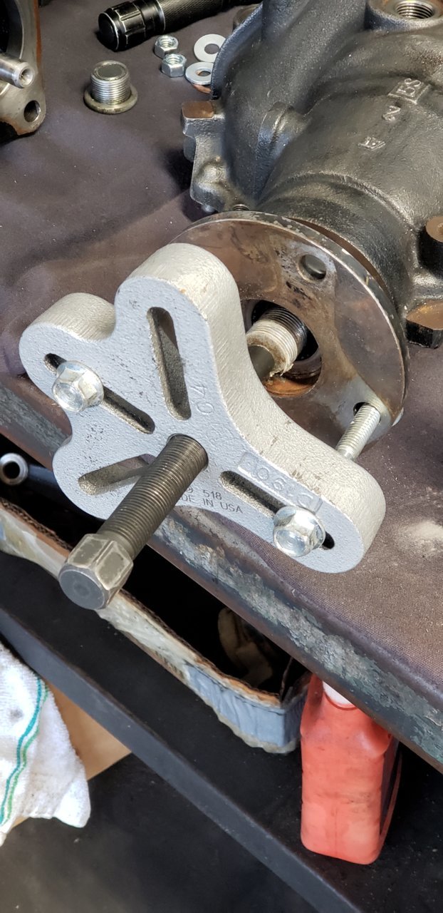

    Removing the flange:

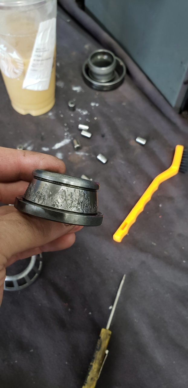

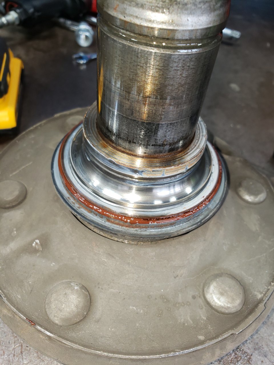

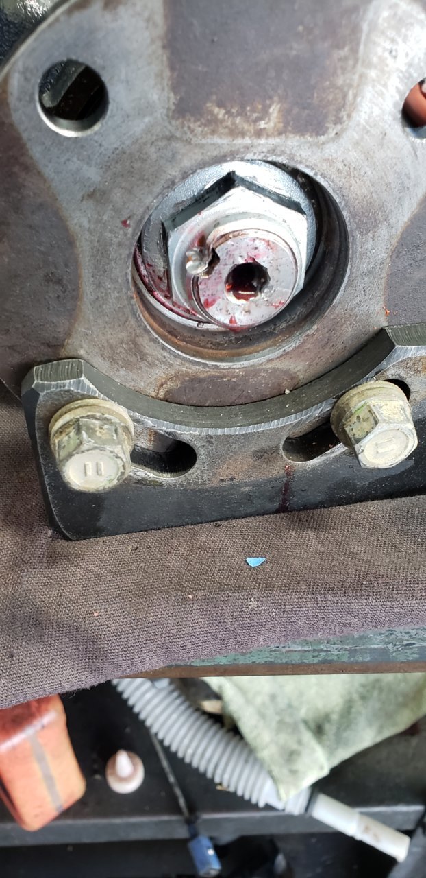

    Used an air hammer to drive the pinion gear past the pressed on flange side pinion bearing. I didn't take a picture of this process.

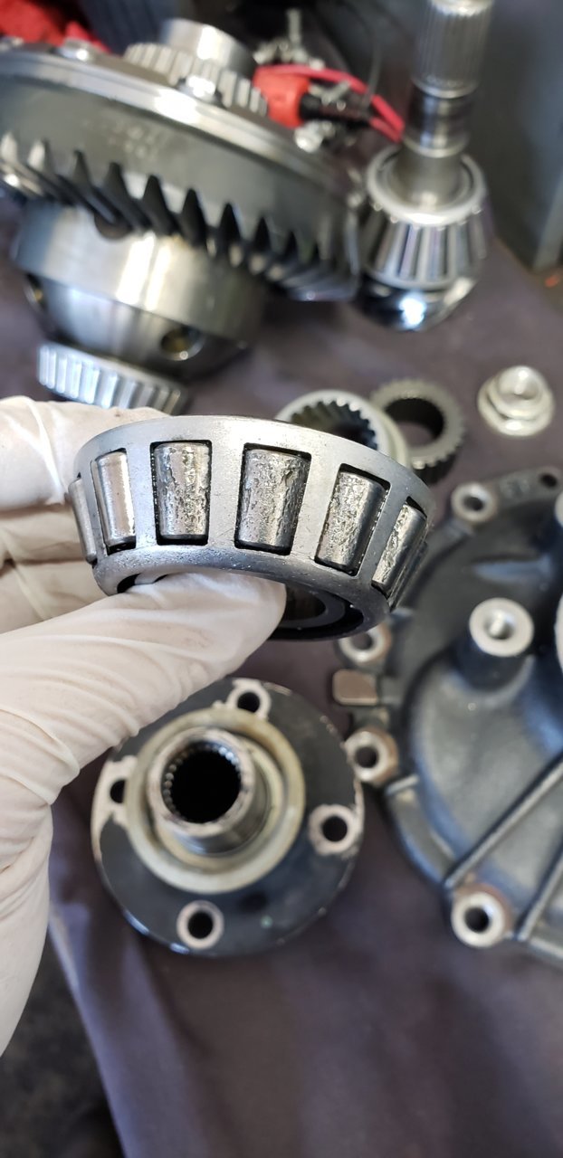

    Here's the failed flange side pinion bearing and race:

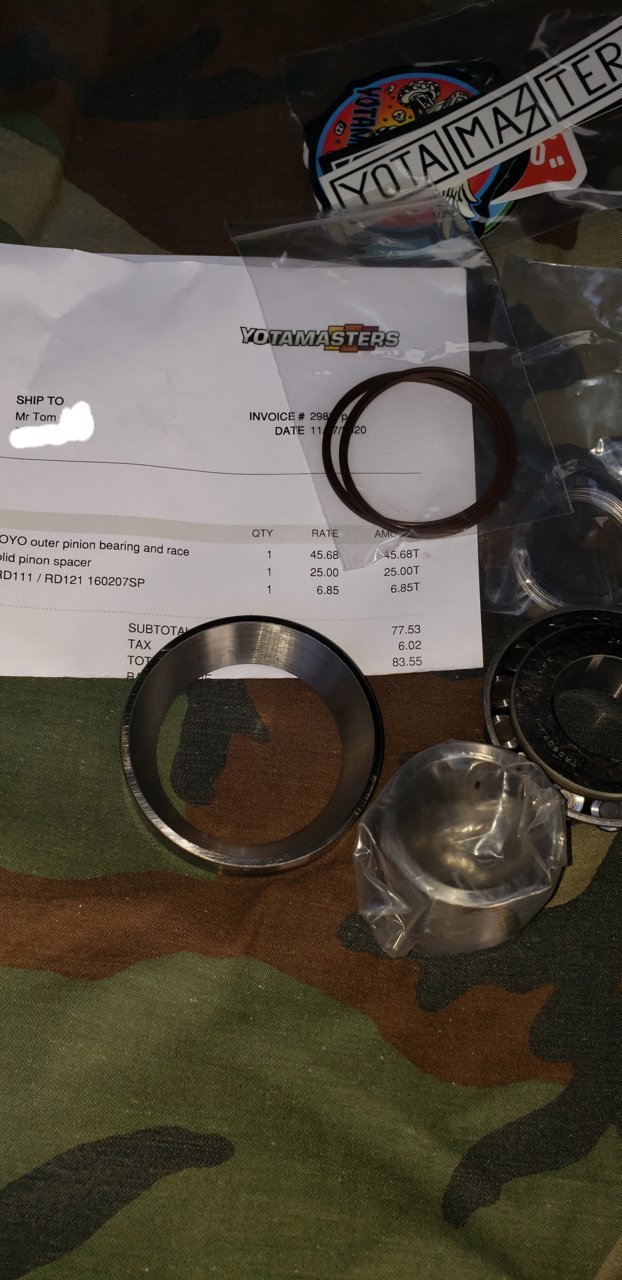

    A quick trip down the street to Yotamasters to pick their brain about my front differential, and to grab what I needed to throw it all back together myself. I also brought to differential in pieces with me to get a second opinion rather or not I needed a complete bearing kit, or just the pinion bearing. Luckily, everyone agreed that the diff only needed the flange side pinion bearing and race. Complete bearing kits are pricey. Those guys at Yotamasters took the time to answer all of my questions about me rebuilding my diff, and also gave me their own tips and advice on how to rebuild it correctly. Yotamasters customer service has always been top notch. So, on my way home with pinion bearing and race, a solid spacer, 2 ARB Air Locker Seals and a pretty sweet sticker pack.

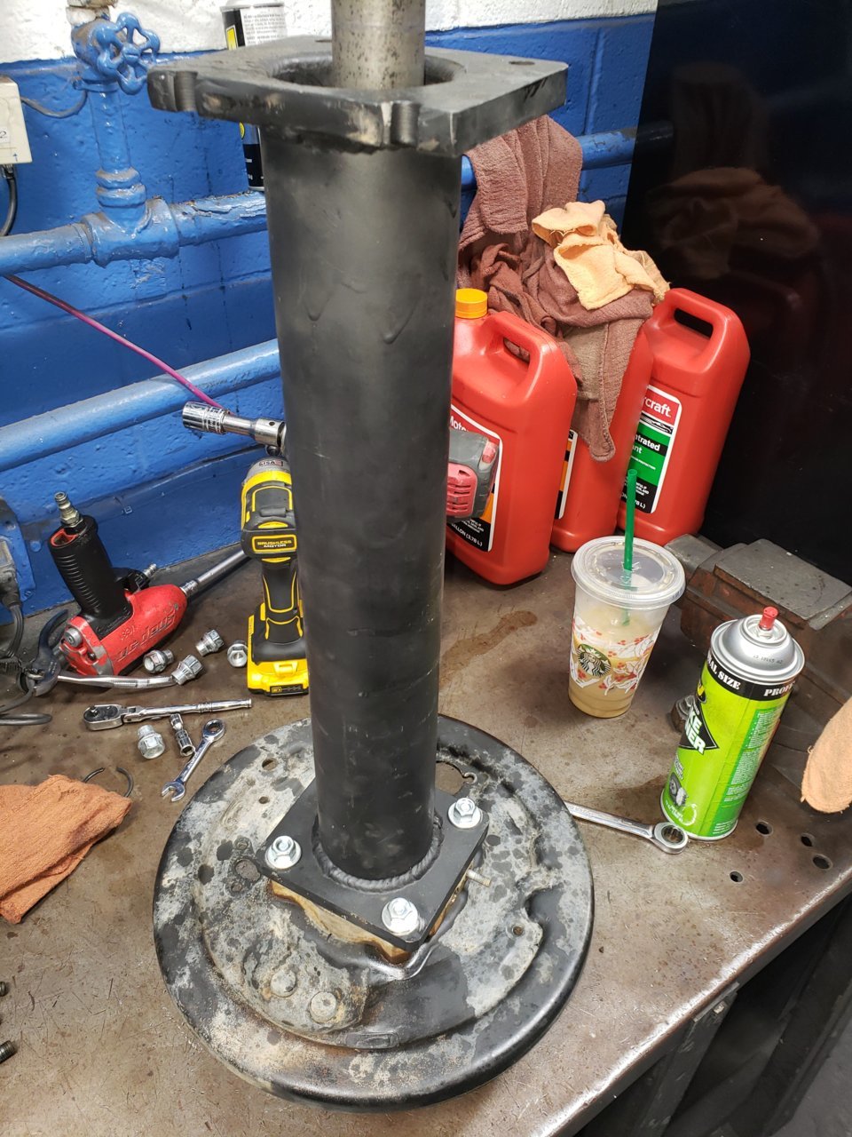

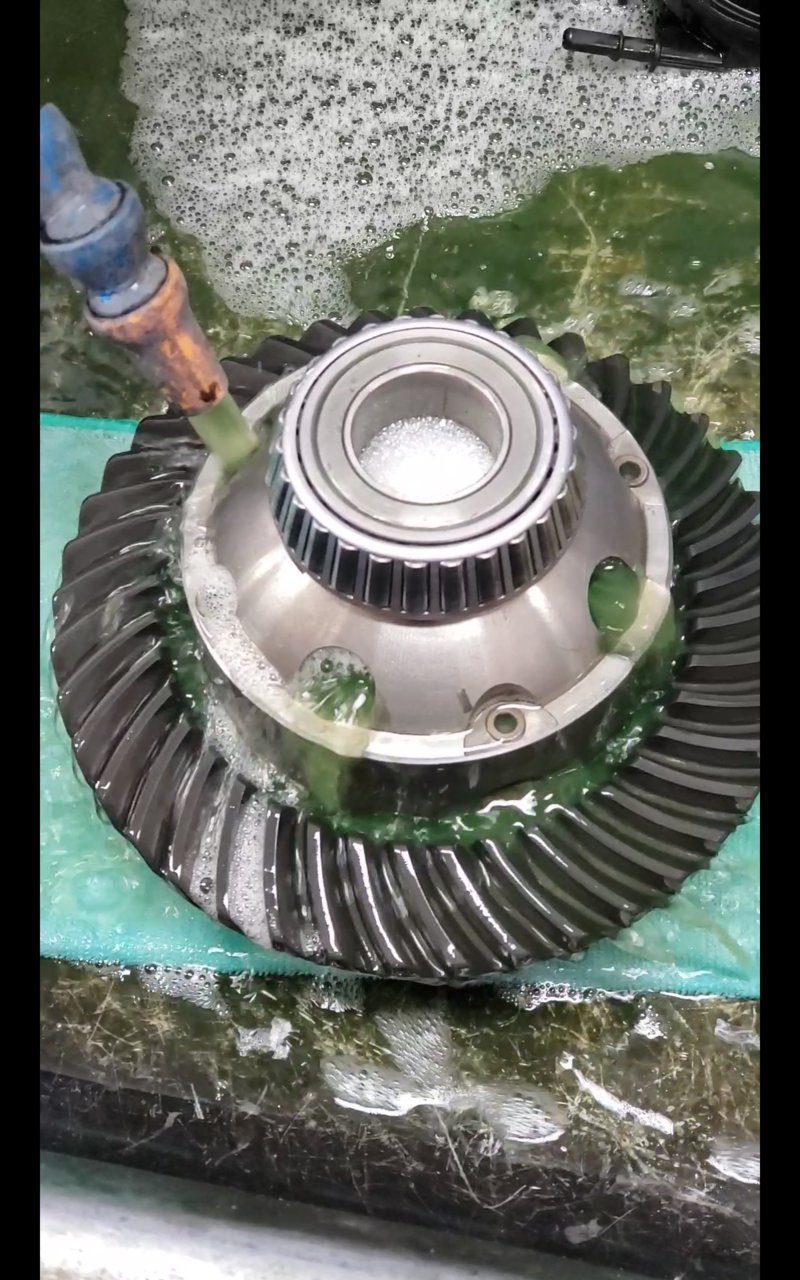

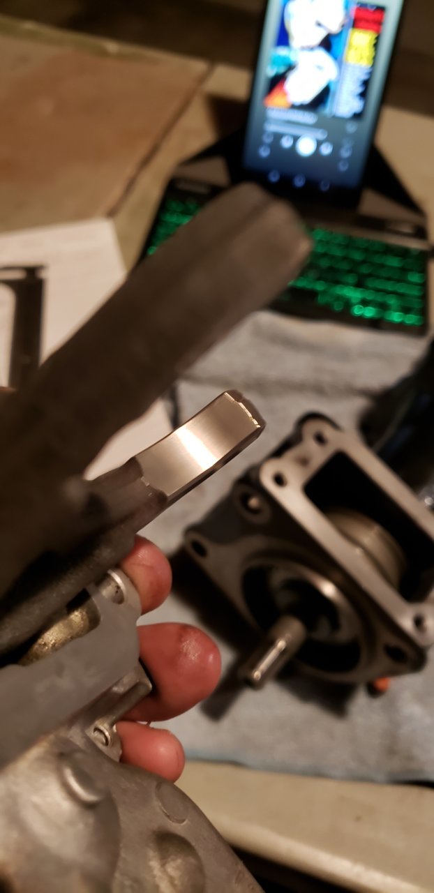

    Bearing material was found everywhere inside, including the ADD extension Tube. And it all had to be cleaned out.

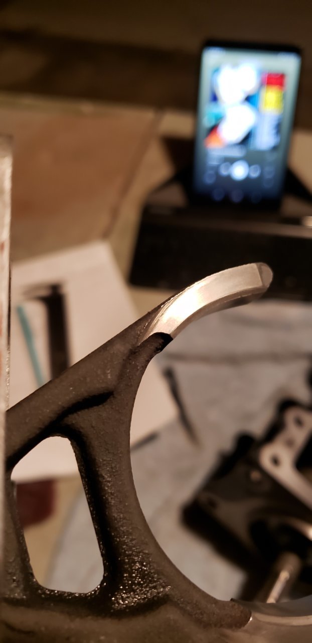

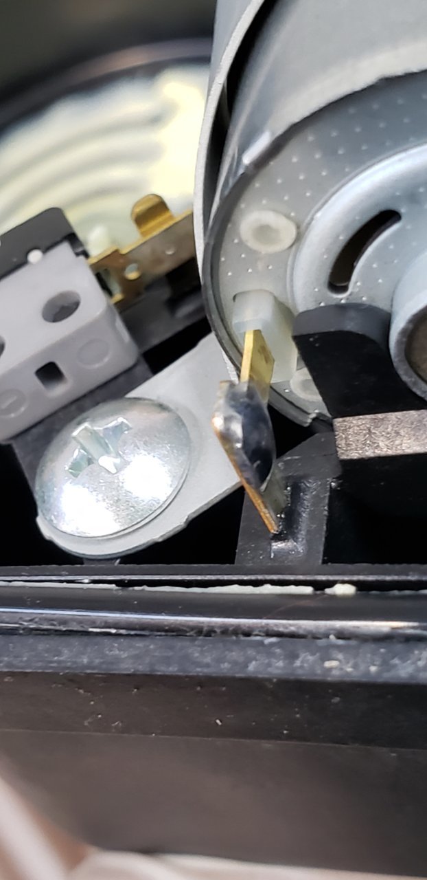

    And since I had the ADD Tube mostly disassembled for cleaning, I went ahead and polished the shift fork with fine sandpaper and some WD-40:
    Soldered the connectors on the ADD actuator motor to make that solid connection, and to prevent any corrosion that may hamper on the fly engagement. 9 times out of 10 it is corrosion in between the connectors that causes the error when trying to engage/disengage 4wd.
    before solder:
    after solder:
    The Assembly:

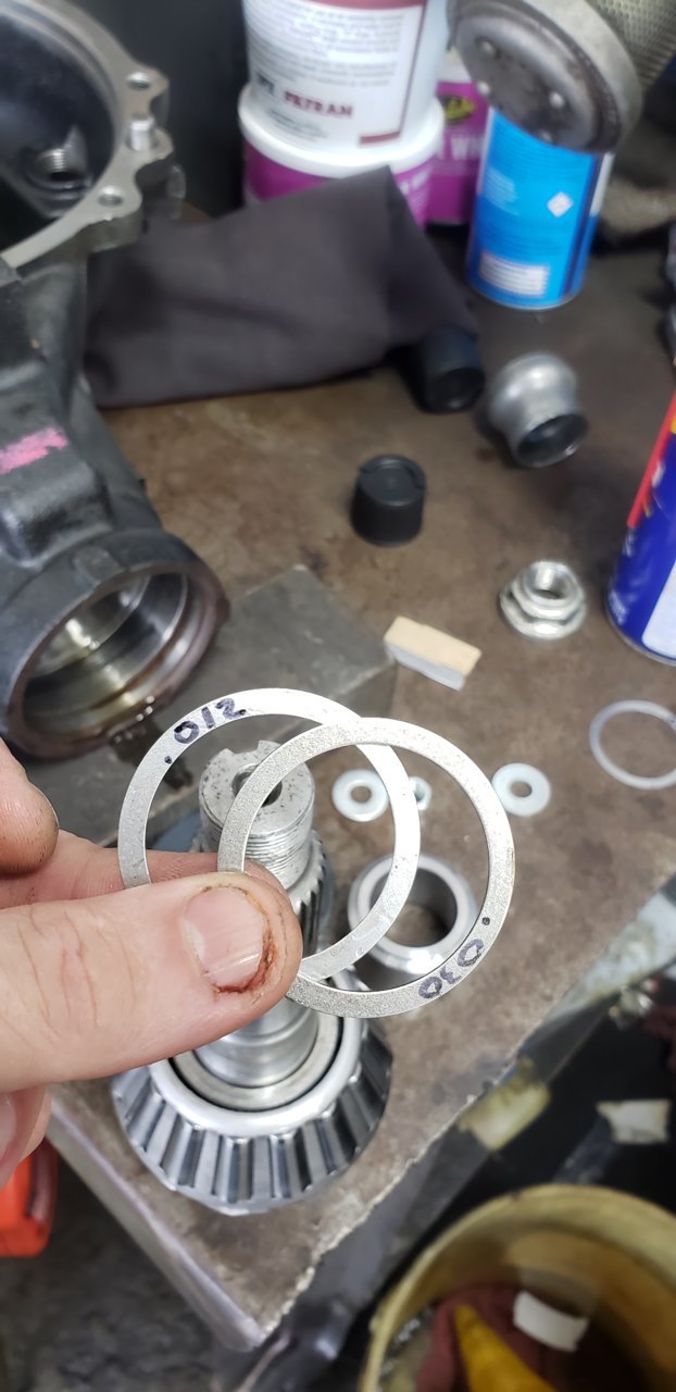

    There's shims that go between flange side pinion bearing and solid spacer or crush sleeve. The shims help achieve the proper bearing preload.
    My goal was to match the length of the old crush sleeve and shims to the length of the new solid spacer to obtain the desired preload value. It took several tries to find the right combination. Have to take into consideration that the new bearing and race will have slight variances in dimensions compared to the old bearing. It took several attempts installing/removing the pinion gear and bearing before finding the right combination of shims for the bearing preload
    The goal was to get the bearing preload between 8 and 10 inch lbs. I got it right in the middle at 9.

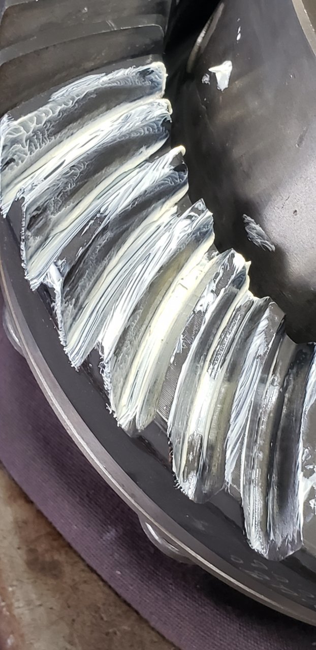

    A check of the gear pattern was spot on, It's really hard to see in the picture as it doesn't show. I also didn't have any gear marking compound available. I didn't expect the pattern to change since it was only the flange side bearing that was replaced. The pattern would have changed and would have to be corrected of a pinion side bearing was replaced.

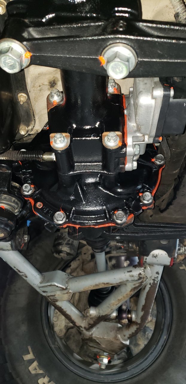

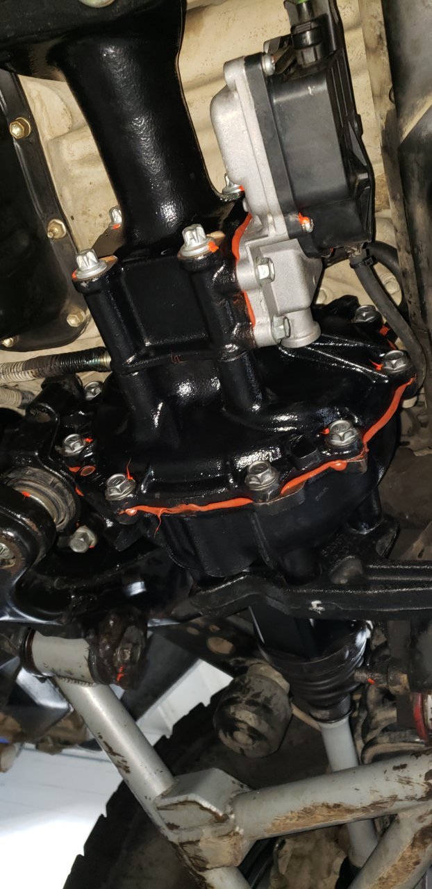

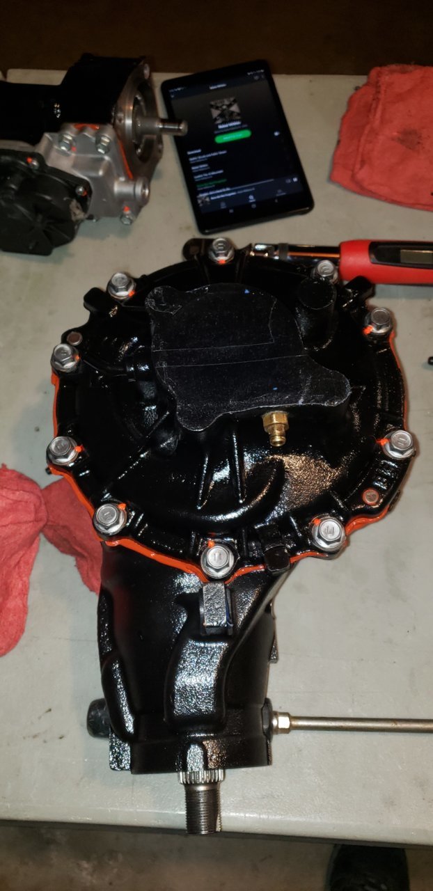

    Prepping the housing for a very shiny coat of glossy black. I've always liked using Krylon because it dries pretty fast.

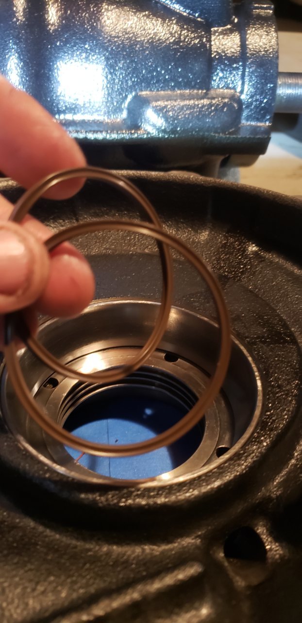

    Installing the 2 new ARB Air Locker Seals. getting close to being done. It is recommended to replace them whenever the diff is taking a part.
    Enjoying a Carnitas Torta (it's a SoCal thing) and Margarita to go while assembling the housing.
    Final notes before closing the lid:
    The 10 bolts torqued to 51 ft.lbs per FSM and marked with orange Torque Seal
    Pinion Seal set at the proper depth per FSM, I forgot to take a picture.

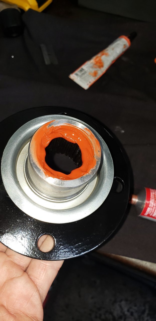

    Red ATV applied on the flange:
    Red Lock-Tite applied to the pinion nut and torqued to 250 ft.lbs. plus one extra tug past the click on the torque wrench. The FSM states that the pinion nut should be torqued up 275 ft.lbs but my torque wrench only goes up to 250. I'm sure it will be fine with the red Lock-Tite and the extra pull I gave it.
    Pinion nut properly staked. Front differential is ready to go back on!!

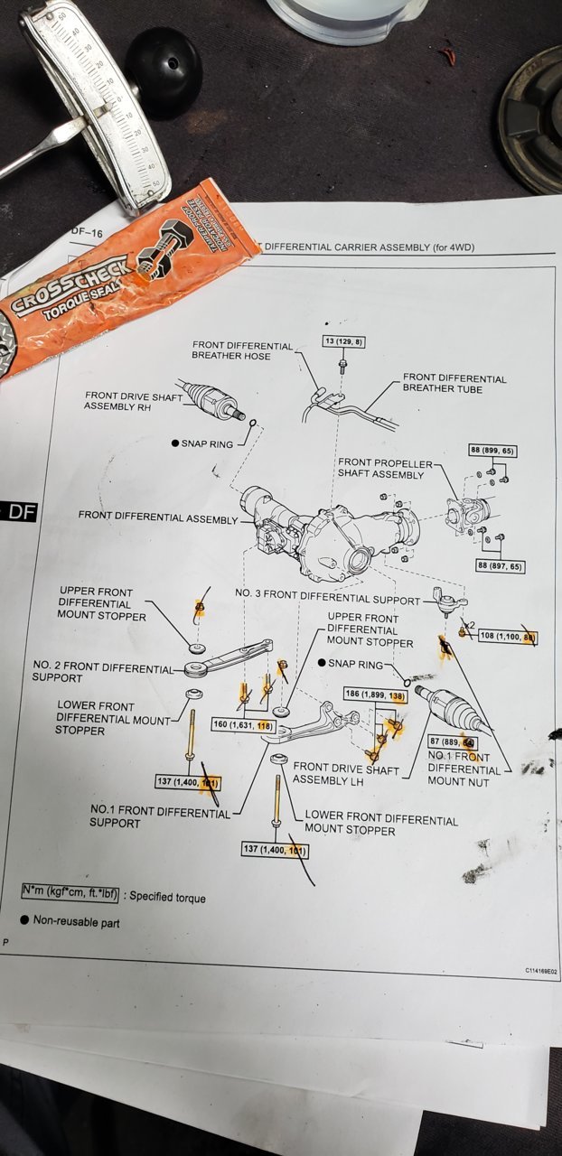

    Front differential back where it's supposed to be. Everything is torqued to the recommended FSM specifications.
    Ain't it pretty looking? Almost ready for the next adventure.

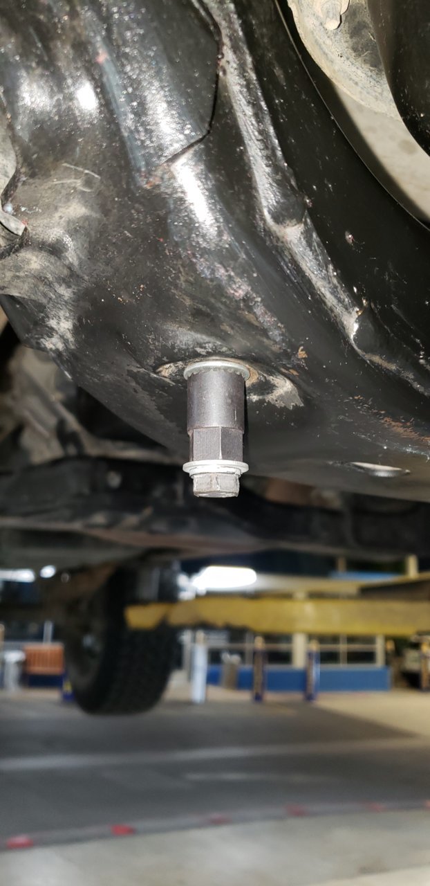

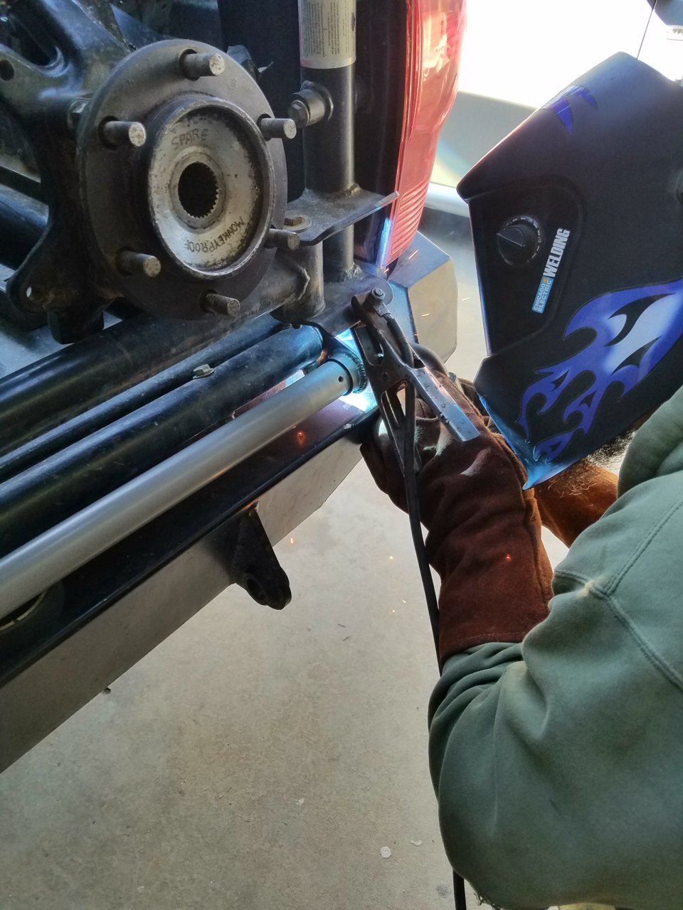

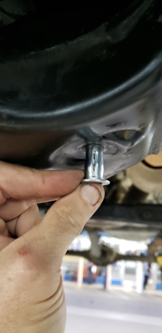

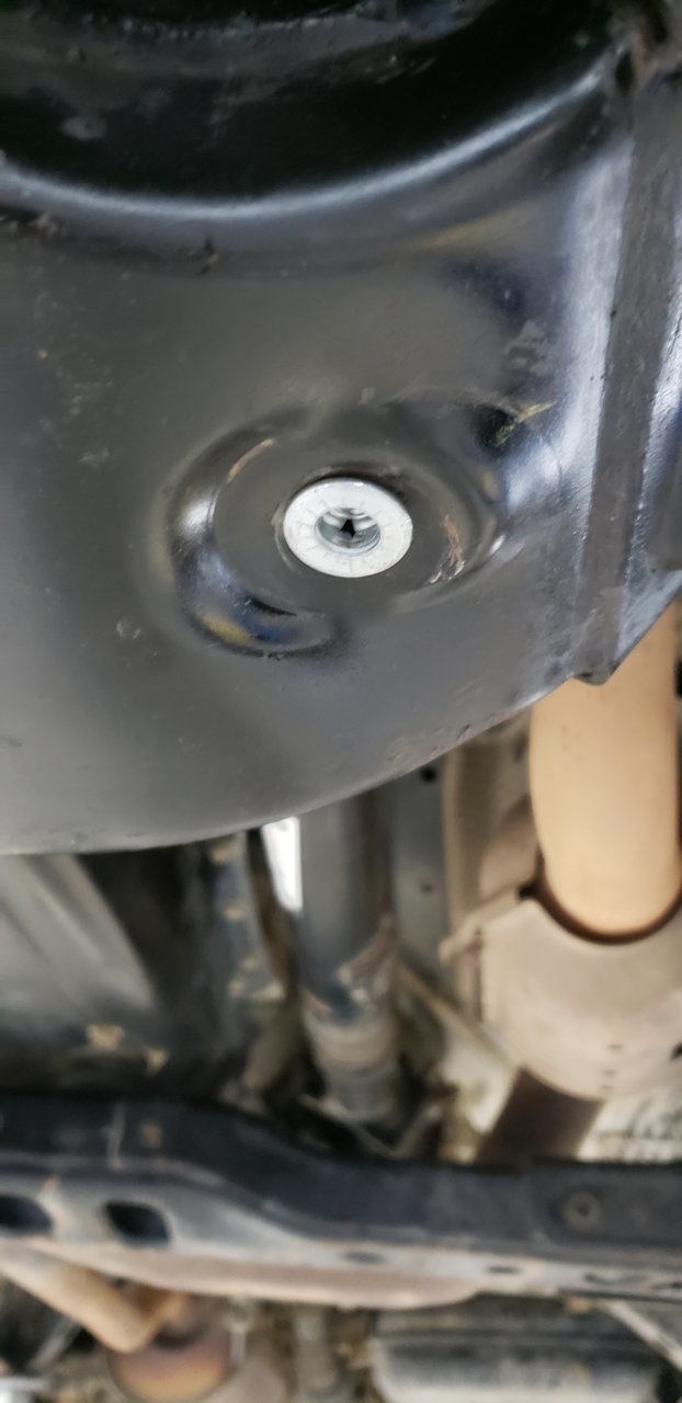

    Skid plate rear mount threads were stripped, so they needed to be to repaired. Easy Peasy with these things. They have held up well in other applications on my Tacoma, let's see how well they'll hold up on a very tweaked skid plate.
    Got the front diff and skid plate repaired and installed just in time for a week long trip to Death Valley during Thanksgiving..

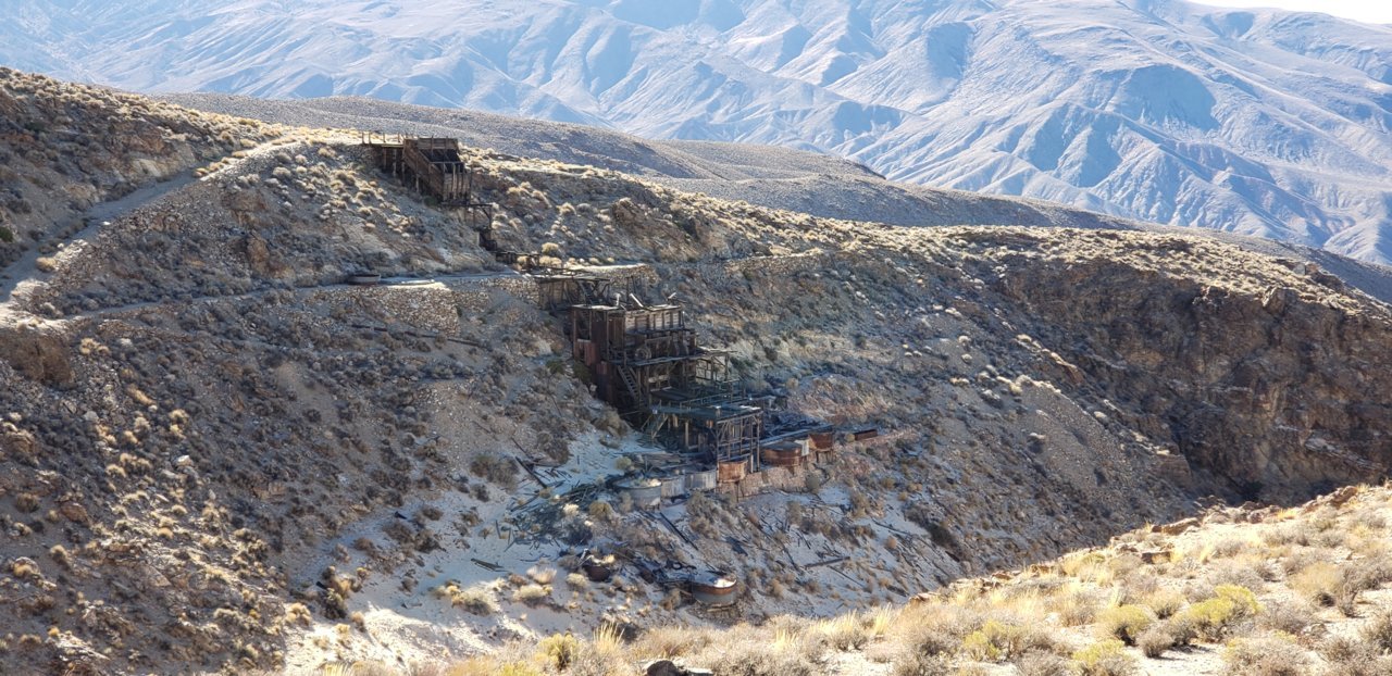

    Charcoal Kilns

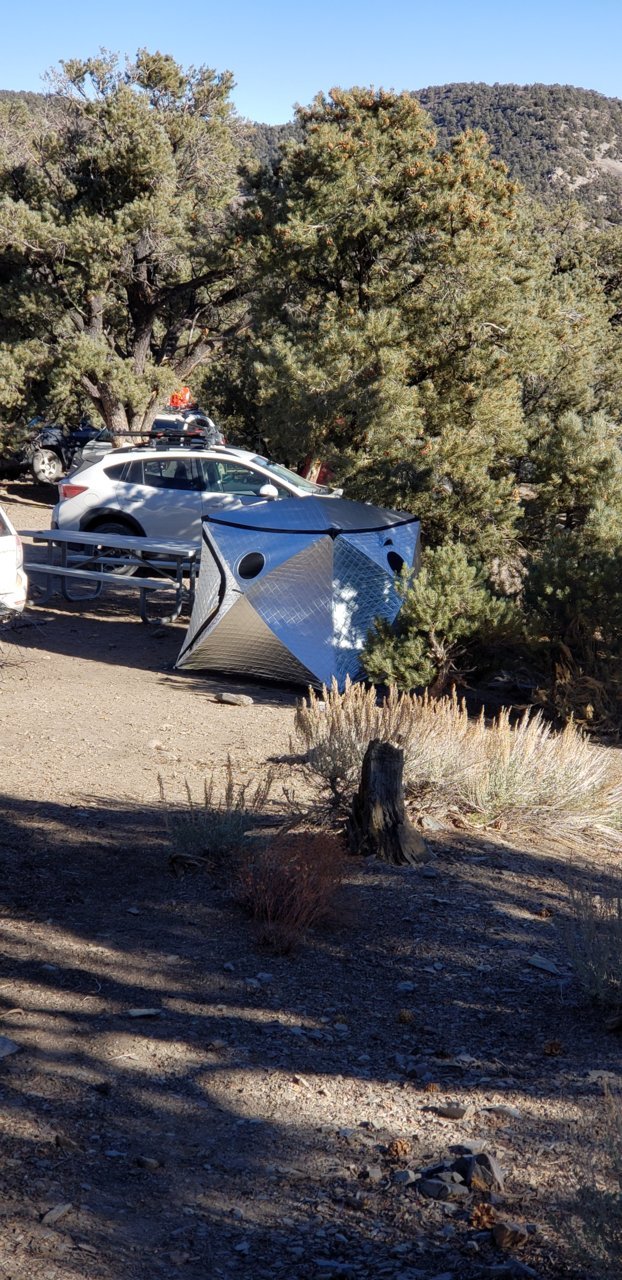

    A group of Subaru guys spent some trying to get this tent up. Which provided some good entertainment.

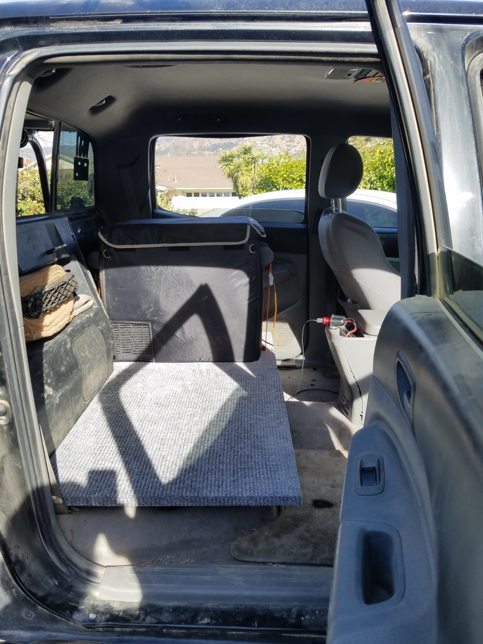

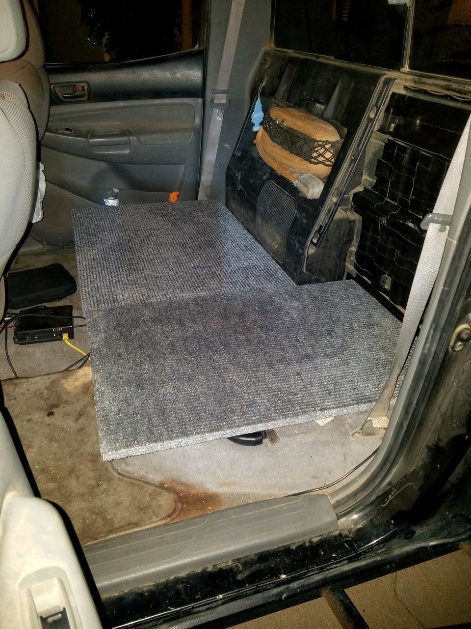

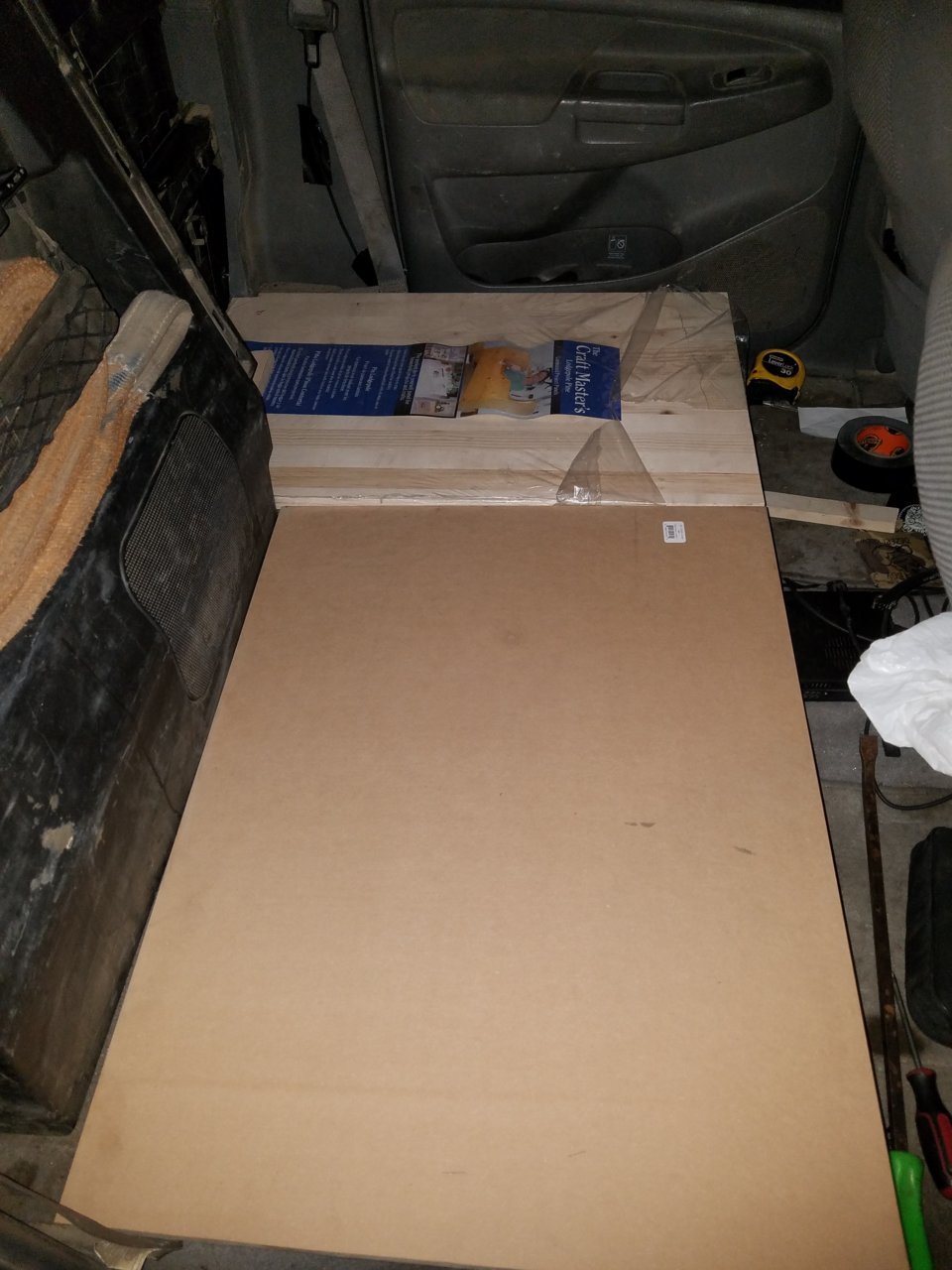

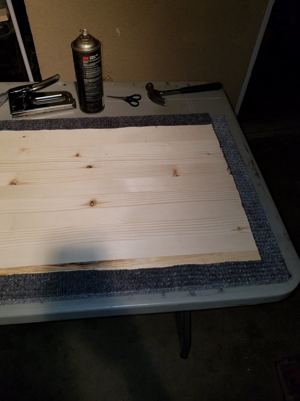

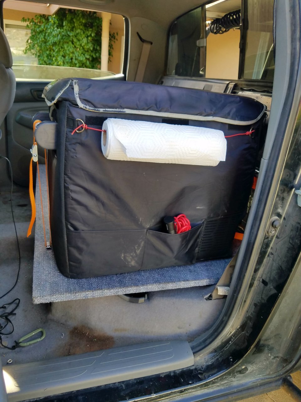

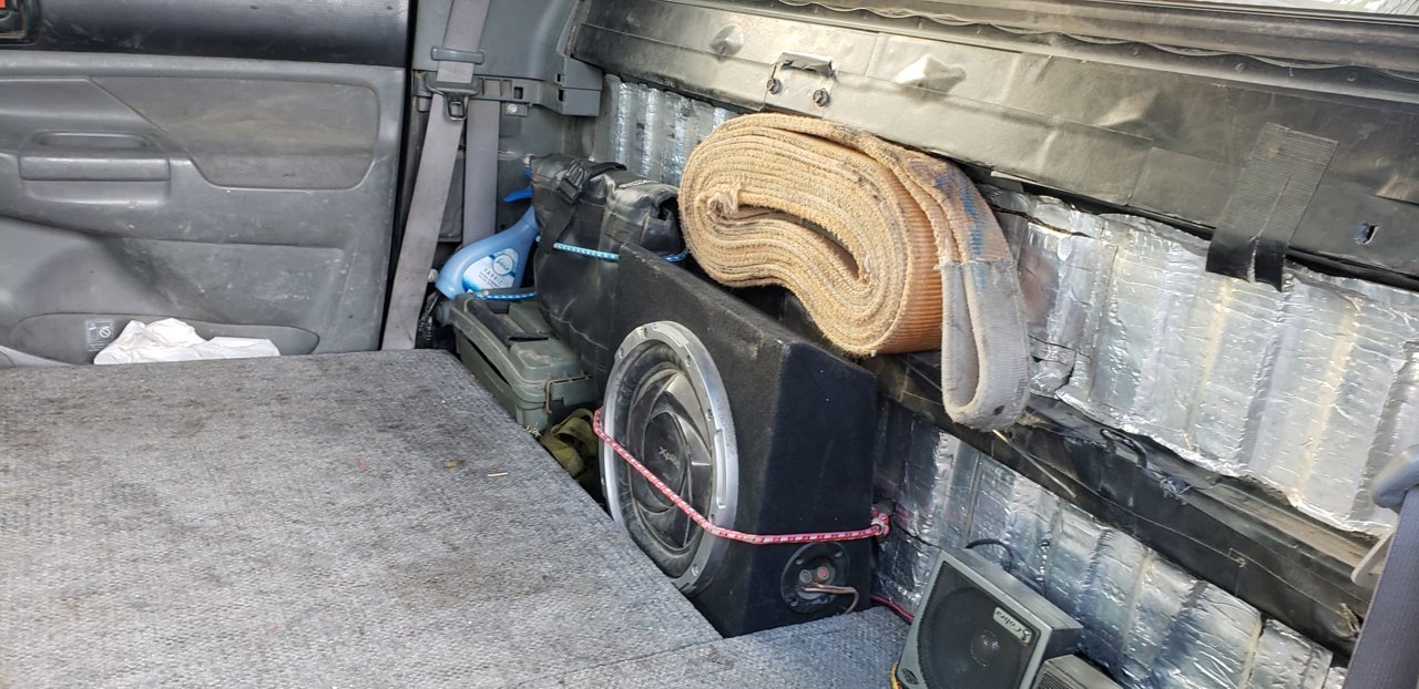

    Just a few short years ago I bought a used 12v fridge from @wheeleveryweekend for some stupid price. Later on they they told they regretted selling the fridge. Its a beast and it works well.
    My desires for the fridge was for to be mounted somewhere inside, and in the back passenger seat area. I didn't want it outside in the bed exposed to the elements. So I removed the seats and made a two piece modular cargo platform that could either be quickly removed, or a combination of platform and seat.
    Scored some upholstery material at the local fabric store that was in the discount section.
    Nylon Footmans Loop for 1" wide lashing straps to secure the fridge in place.
    Fridge is mounted solid!

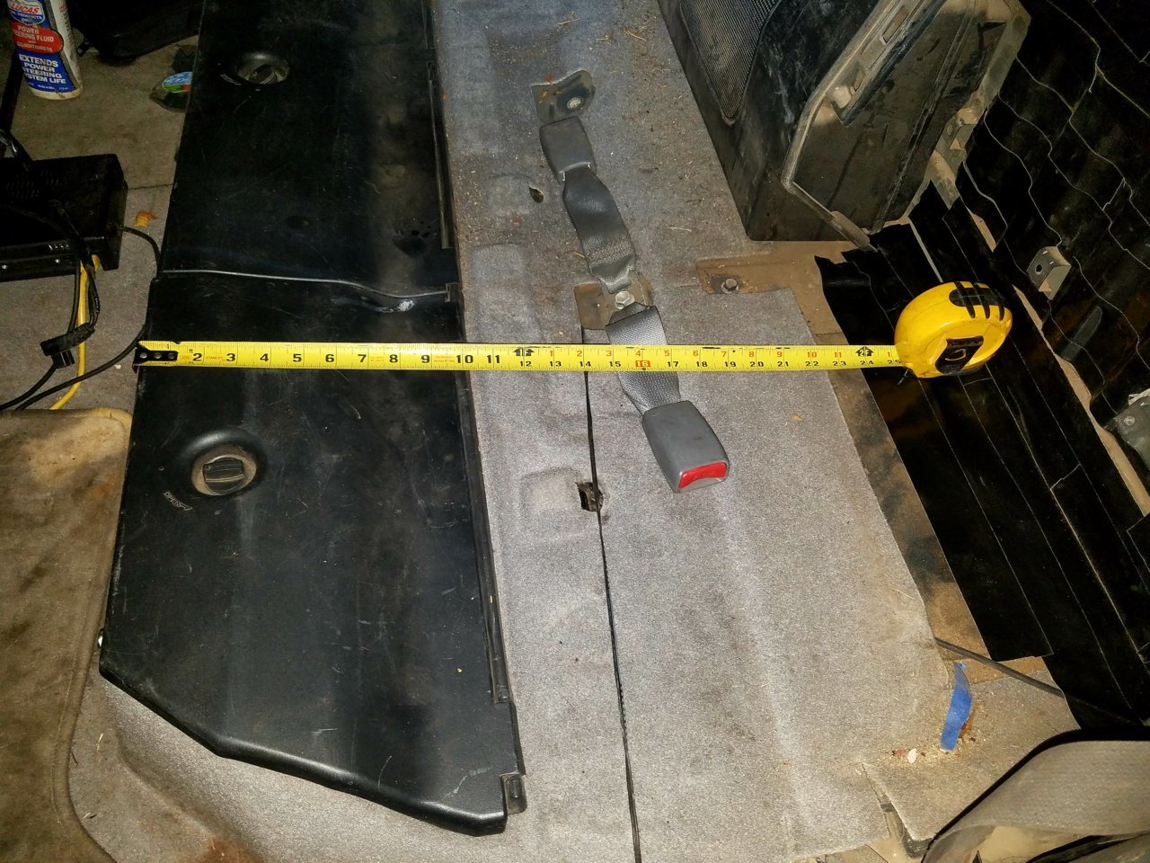

    Fast forward to the current configuration after removing the JBL Subwoofer and Amplifier which has gained even more precious cargo space.
    The Platform is doggy approved!!

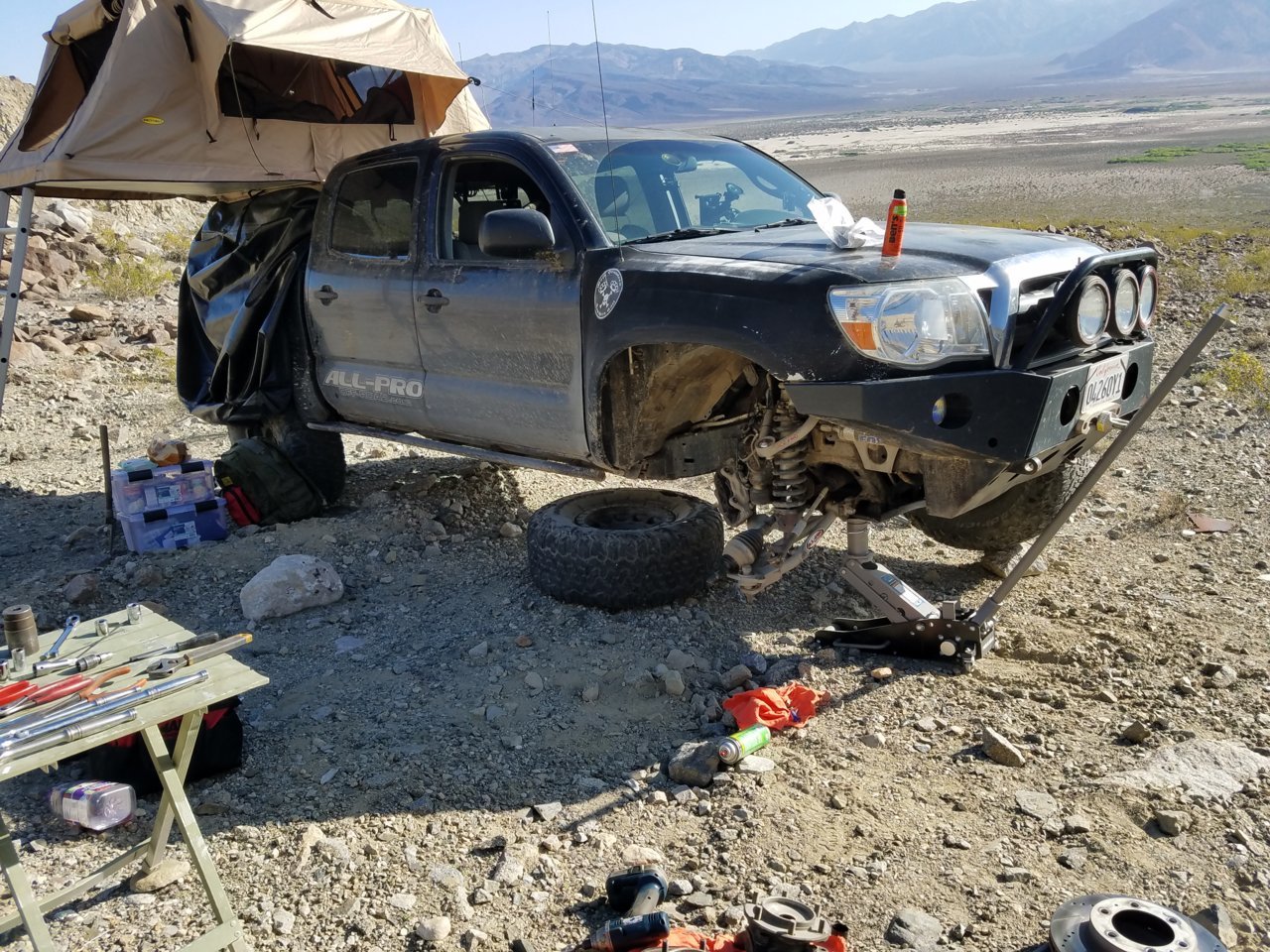

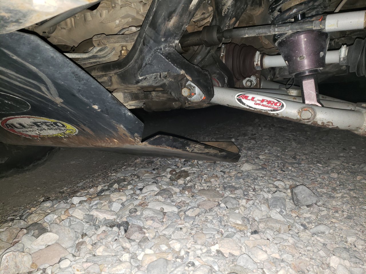

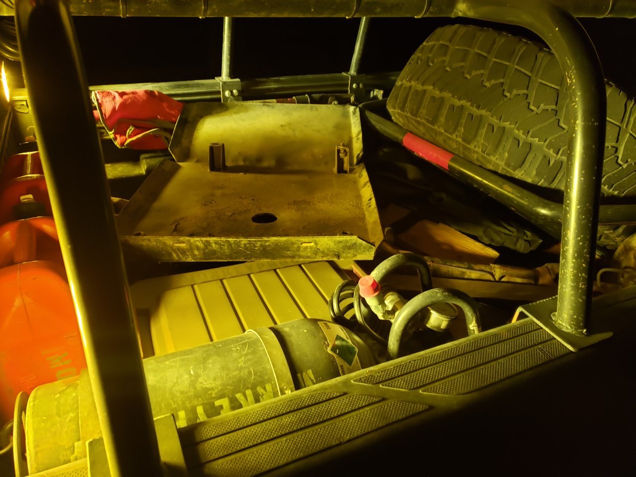

    That one time when my skid plate tried to leave while coming down Steel Pass in Death ValleyI guess it just had it with my prior shenanigans. The noise it made sounded like the undercarriage had exploded.
    Had to remove it while on the trail that night, and it was 33° outside so that wasn't much fun. Into the bed it goes for the rest of the trip.

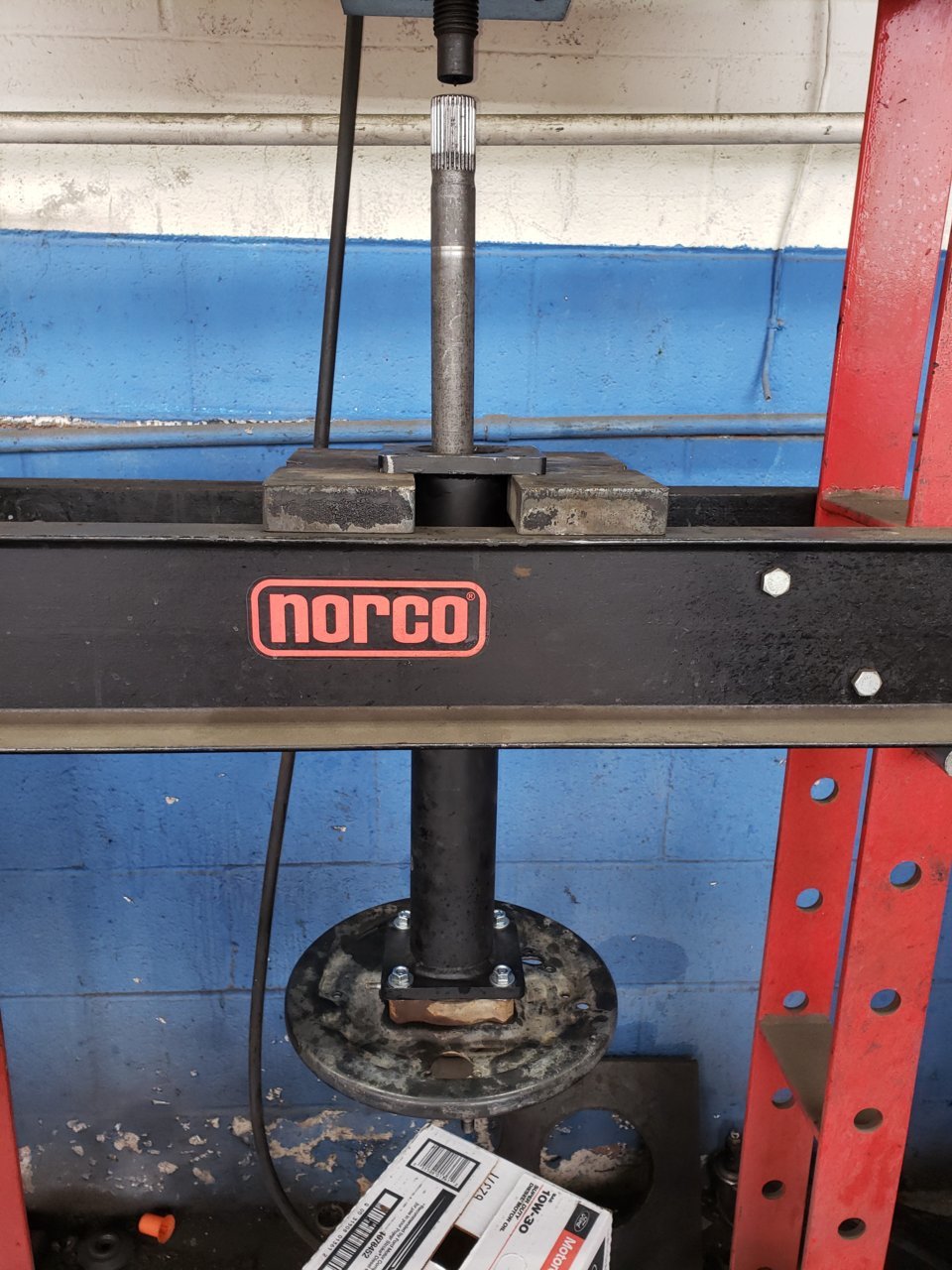

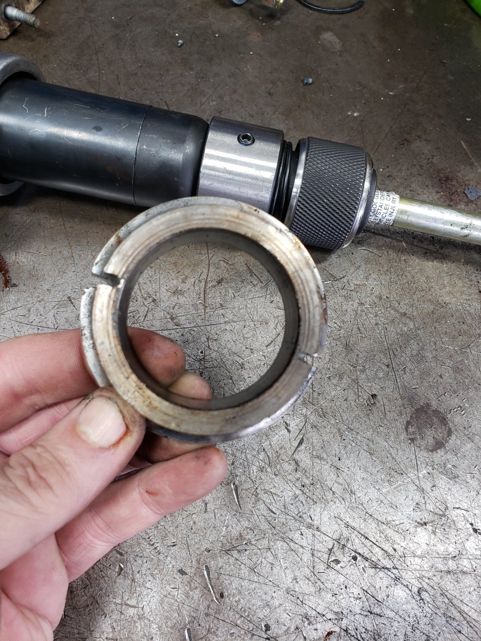

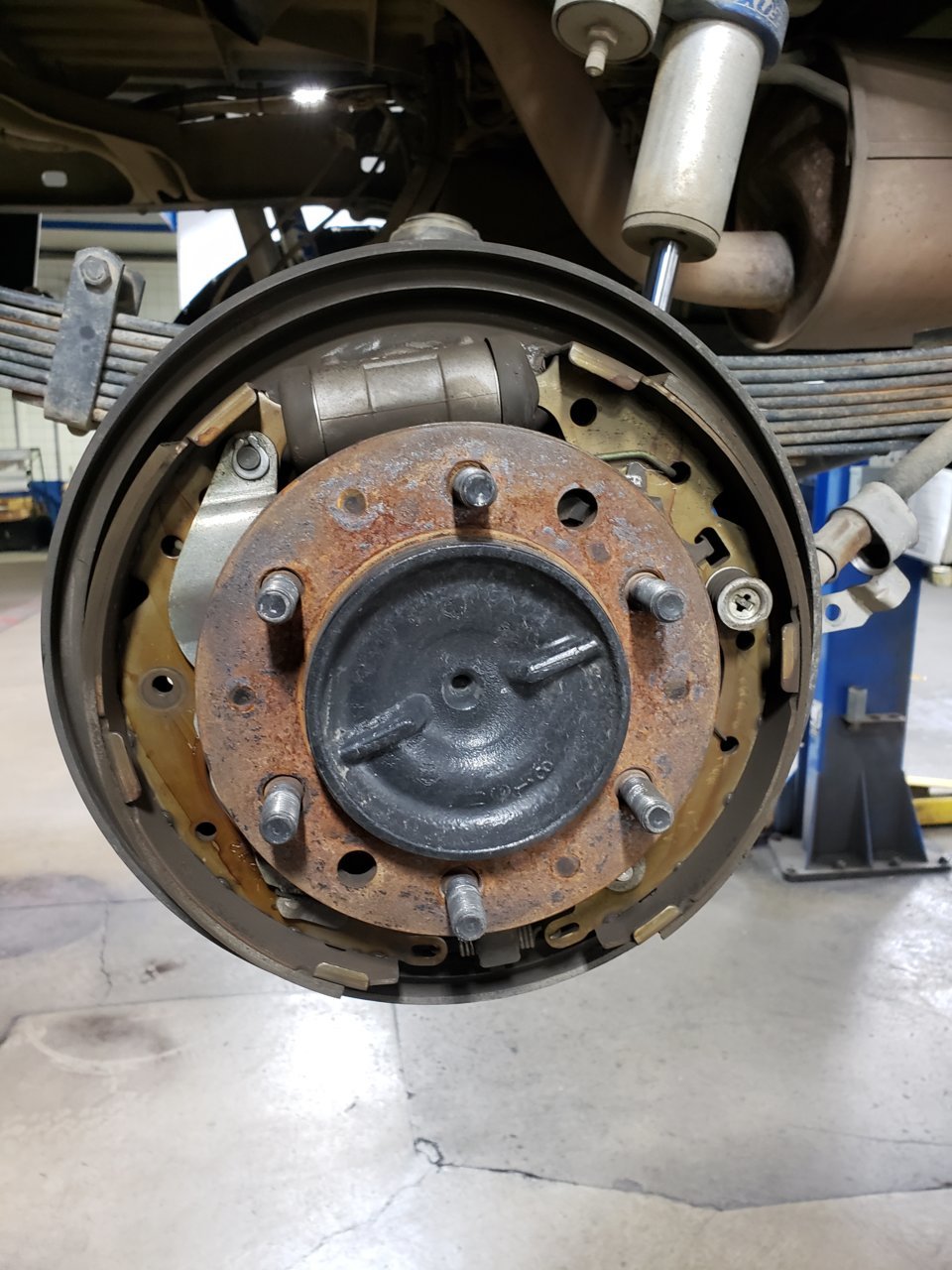

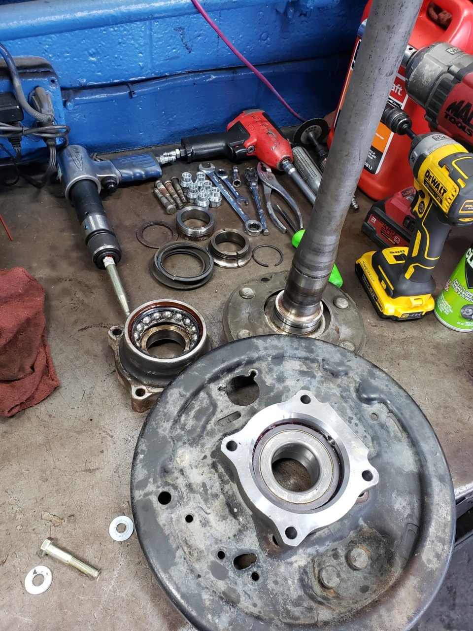

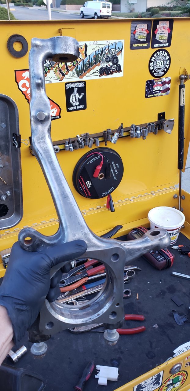

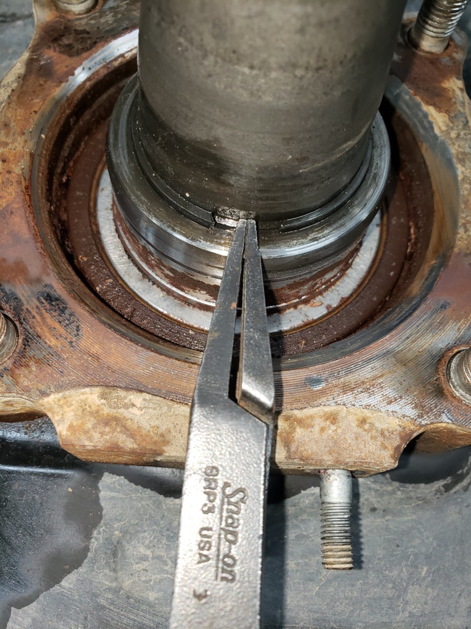

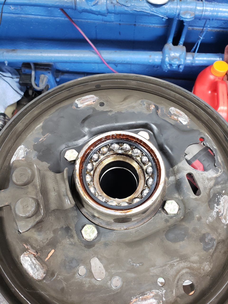

    The second time replacing the passenger side wheel bearing. It was crunchy sounding from inside the cab when driving. Thanks to @Airdog for the use of his homemade bearing removal tool.
    Removing the snap ring to allow the bearing retaining collar to be pressed off.
    Installing @Airdog's bearing removal tool
    Ready for the hydraulic press.
    The bearing race has to be grooved/notched with a cutoff wheel, and then chiseled off with the use of an air hammer.
    The remaining grease that was found inside the bearing was in poor condition.
    I didn't take any pictures of installing the new bearing. Really though, not much to it other than pressing the new bearing onto the axle shift. I also imspectedthe axle shaft and splines for straightness before pressing on the bearing assembly.

    Here's a pic of the axle getting pressed into the bearing to complete your how to...

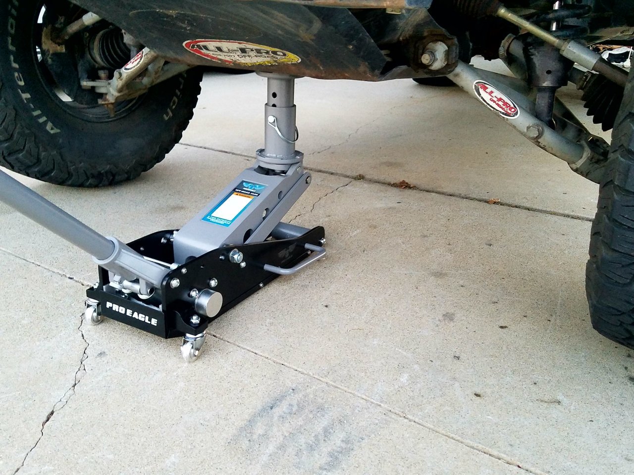

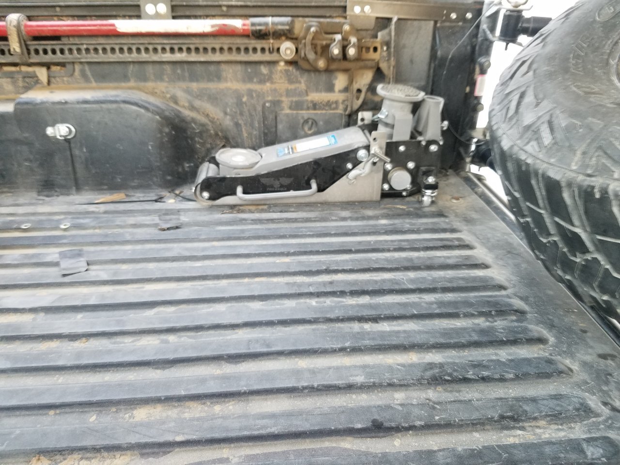

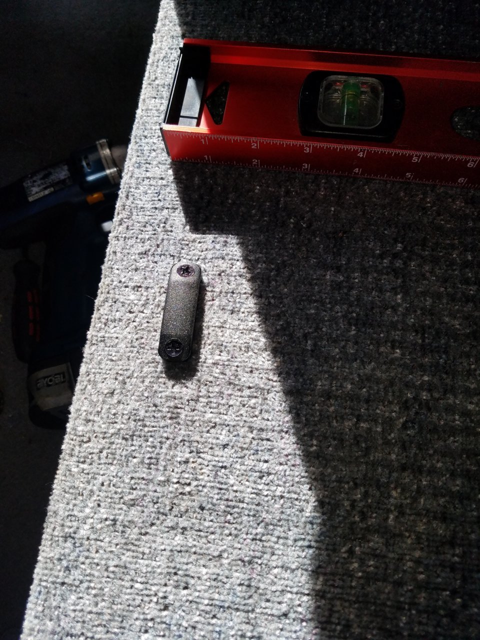

    I bought a Pro Eagle Jack and holder that I mounted on the bed, on the passenger side. I also bought a very cool spring loaded Jack Handle Mount from Solo Motorsports. Luckily for me, Solo Motorsports is just down the street from me. The good people at Solo asked me to bring the Pro Eagle Jack Handle with me because they wanted to ensure proper fit. It's a good thing too because the diameter of the handle was way too large for the spring loaded end. But that was a quick fix by taking some material off the handle with a lathe. 5 minutes later it was a perfect fit! The customer service at Solo Motorsports was excellent.
    The SoloMotorsport Spring Loaded Jack Handle Holder.
    The Jack Handler best fitted without taking up any room along the rear of my AllPro rear bumper.
    Perfect Fit!
    And of course I ended up breaking in the Pro Eagle Jack the very next weekend out in Death Valley when I had a near catastrophic passenger side spindle failure.

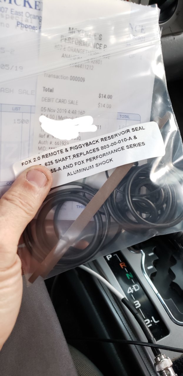

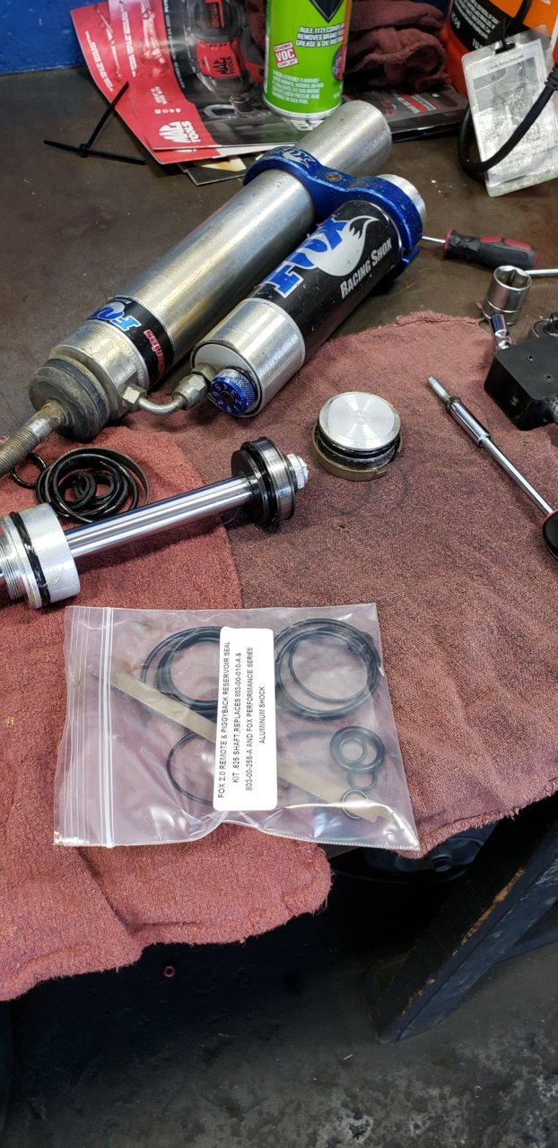

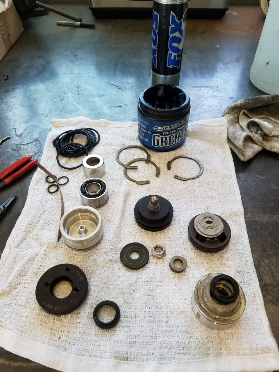

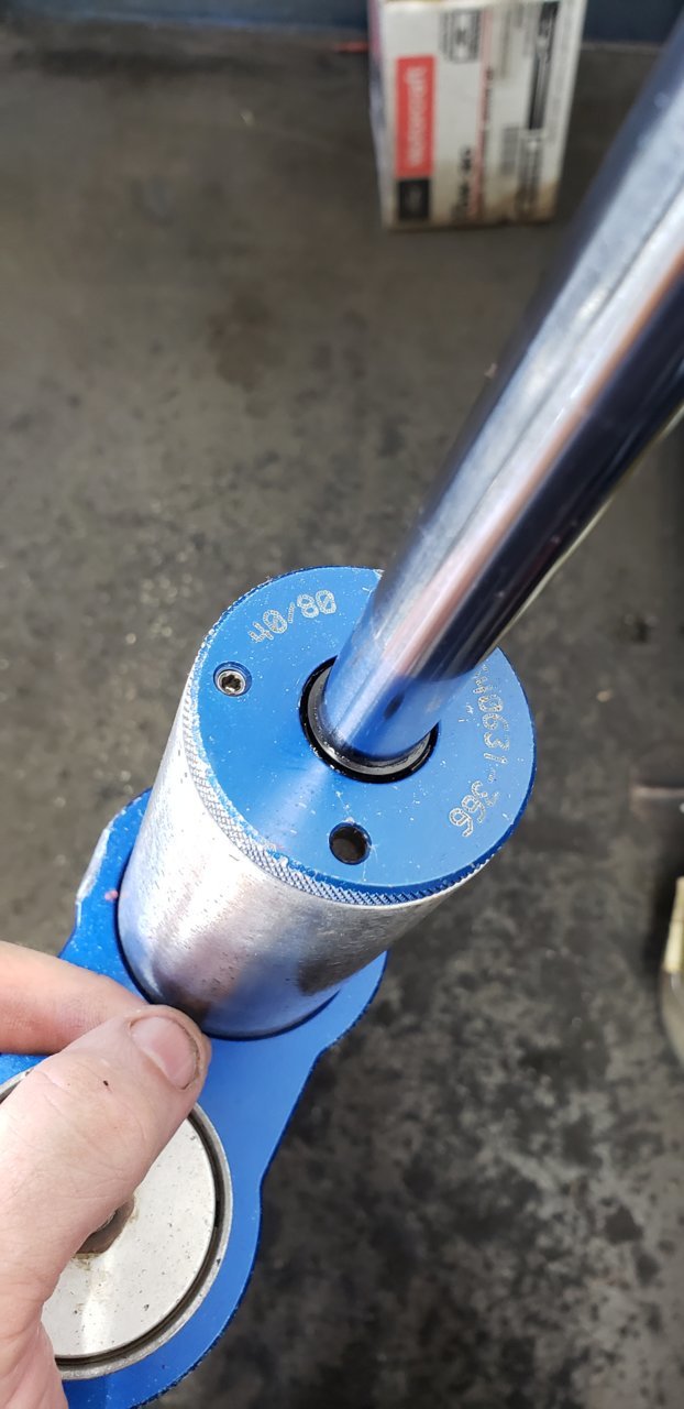

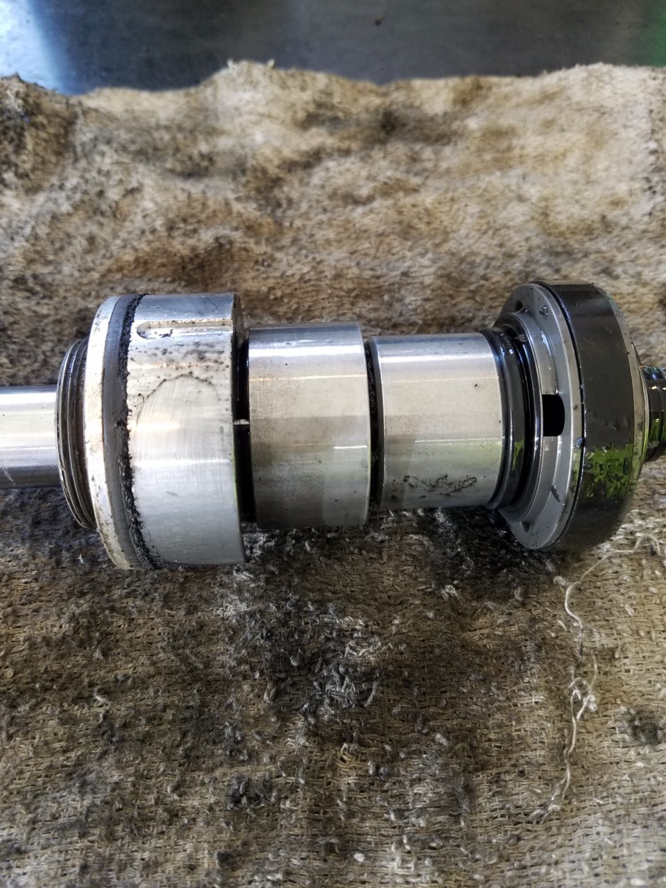

    I bought my rear Fox 2.0 shocks with adjusters used from AllPro. And I got them really cheap at an offering I couldn't refuse. They were said to be one of the first prototypes for the FJ Cruiser. The original valving wasn't ideal for the Tacoma and especially with all of the crap that I carry with me while on the trail. So I sent them to Down South Motorsports for a revalve. I wanted more compression and less rebound, they did a good job.
    But since the bodies are only 2.0's, the shock oil gets hot enough that every once in a while a main seal will blow and leak oil. I've learned to rebuild my own shocks. I think when I need to rebuild the rear shocks again, I'm going to add some shims on the rebound to slow it down a little.
    It's really not much to a rebuild, just match up the o-rings. Biggest thing is having nitrogen to recharge the reservoir. Fox recommends 200psi

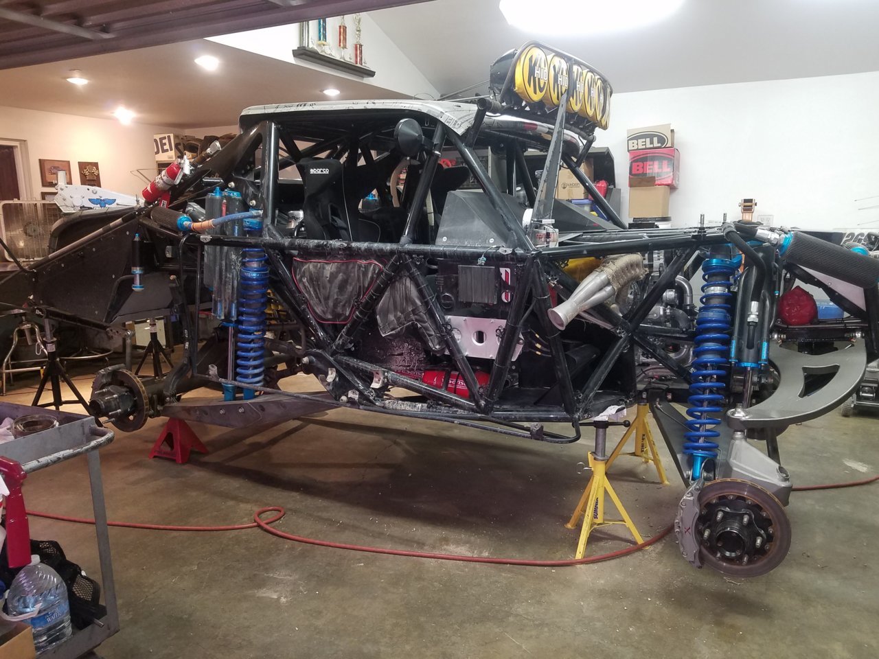

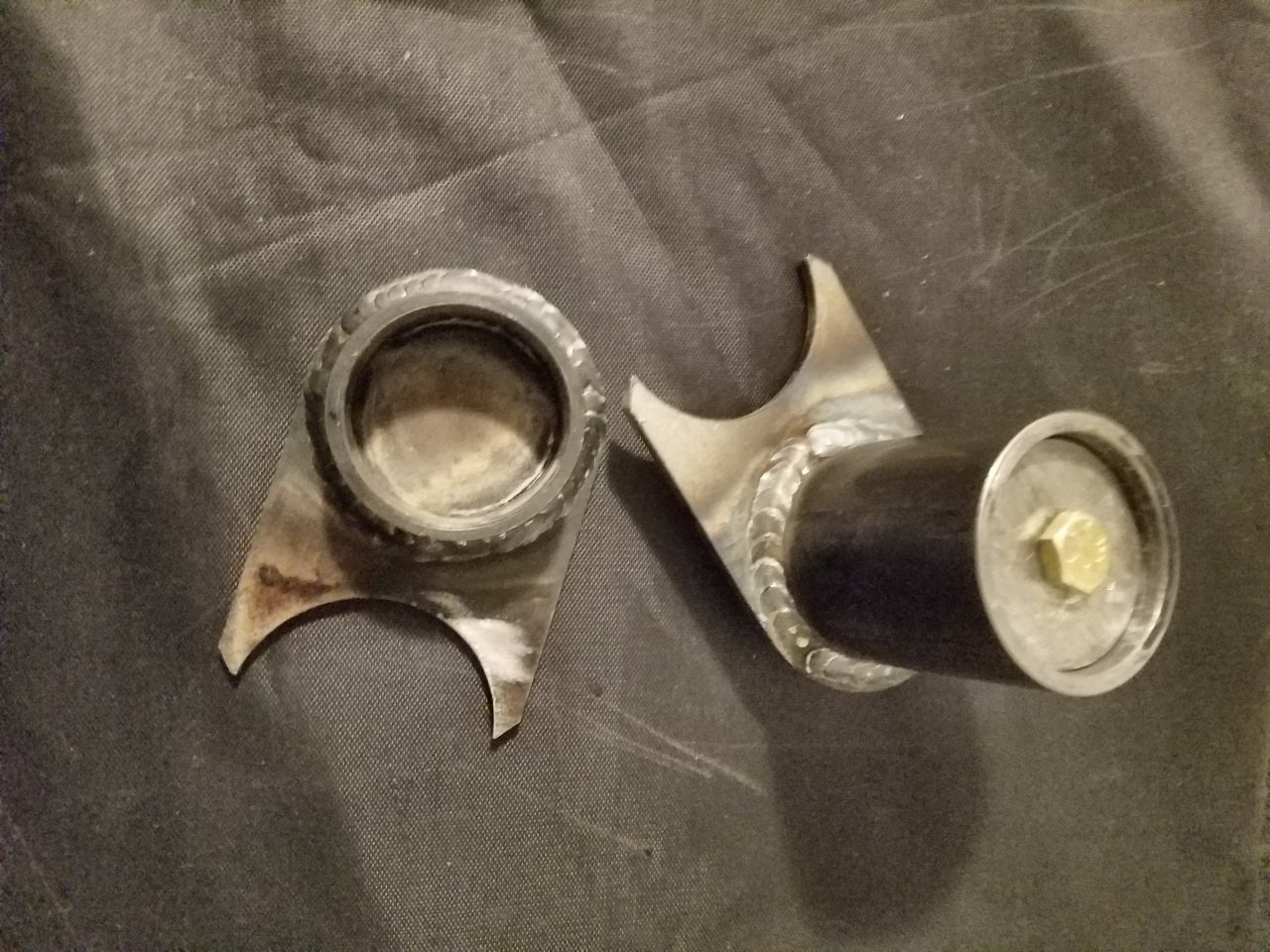

    This weeks project will be prepping for this weekends project. A complete front end makeover that will include new upper and lower control arm bushings, upper uniballs and new spindles.
    Prepping a new pair of spindles for a pair of JD Fabrication Gussets and Heimed Steering Double Sheer Tab Kit.

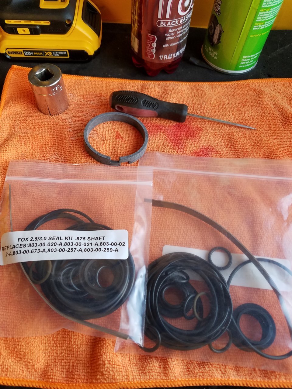

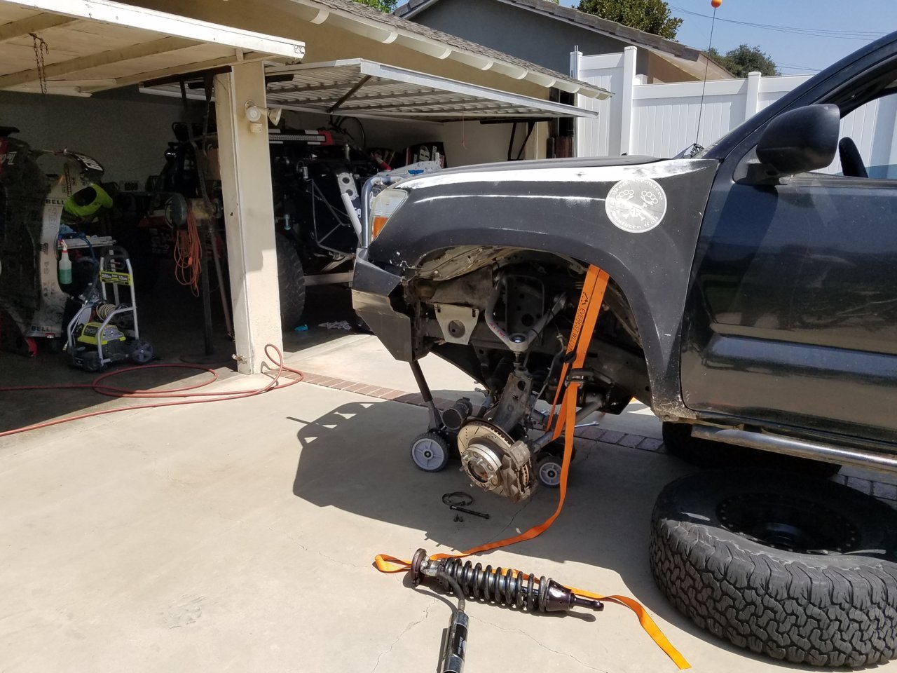

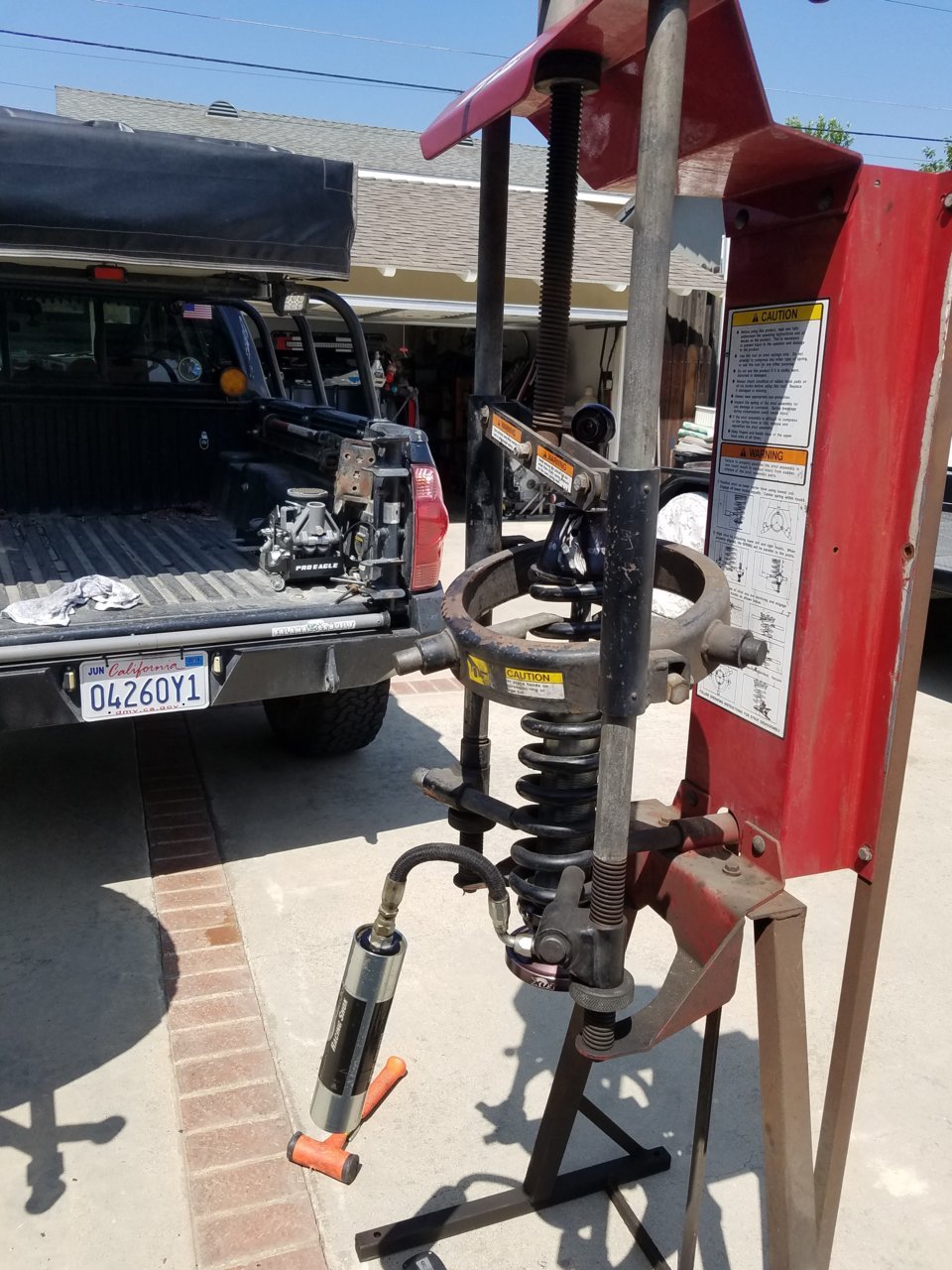

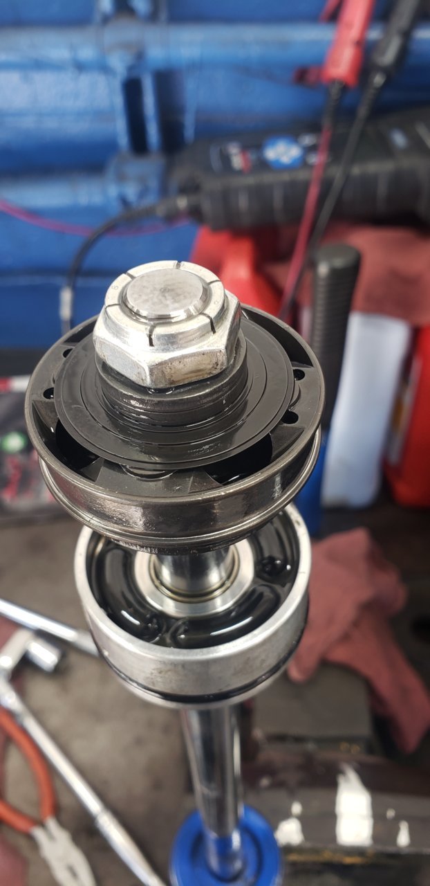

    At least once a year I'll go and recharge the front coilovers and shocks with nitrogen for maintenance purposes. Two years ago while doing so I made a pretty dumb mistake without realizing it, the next morning there was a nice pool of shock oil on the ground. I somehow managed to twist the end cap with the hose fitting just enough to make it leak shock oil and the nitrogen.
    So, time to rebuild the front Coil Overs with new seals and shock oil. Fox Red shock oil is the preferred shock oil used in shock rebuilds and that's what I used.
    Fox 2.5 Coil Over seal kit and part number.

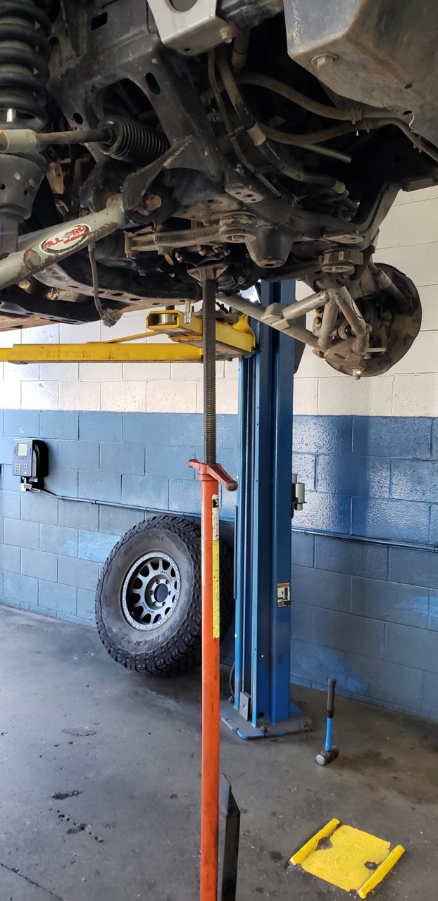

    Removing the Coil Overs.
    Having the right tools always makes the job easier, a proper spring remover.
    Lots of nasty inside, Fox Blue shock oil.
    The innards of a Coil Over.

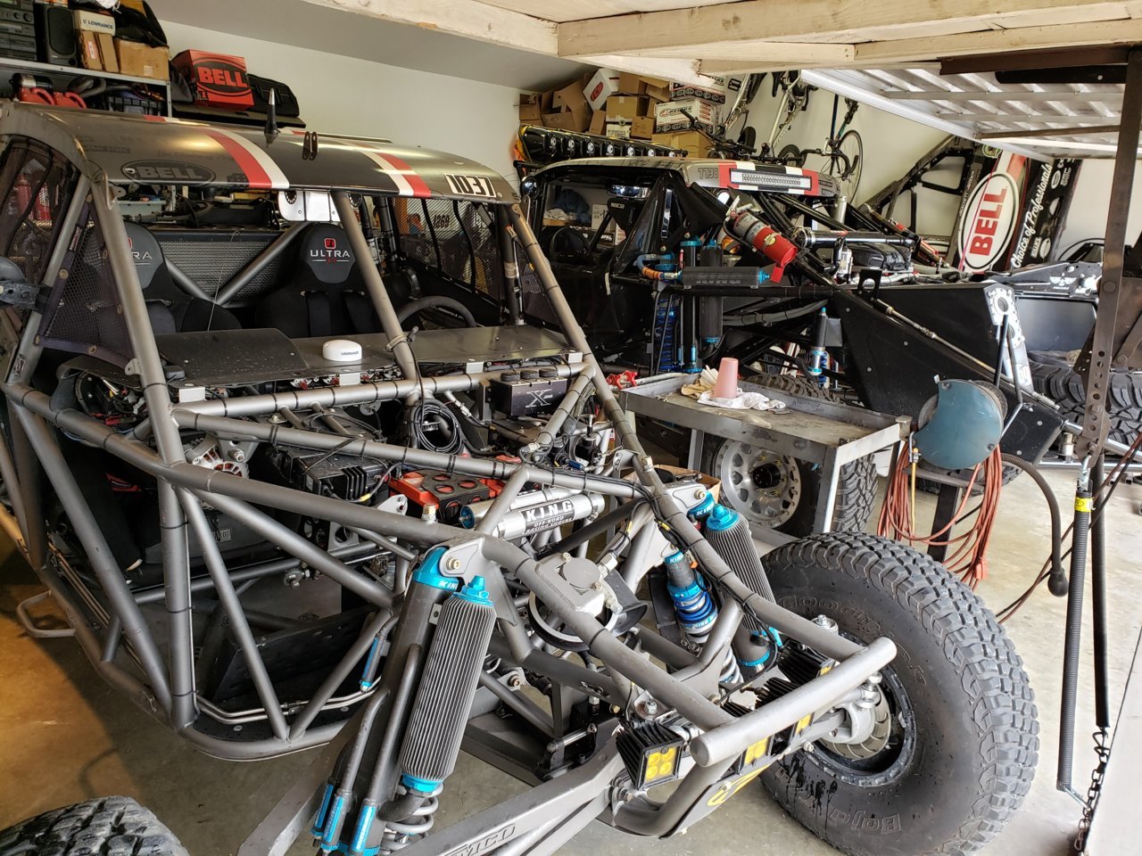

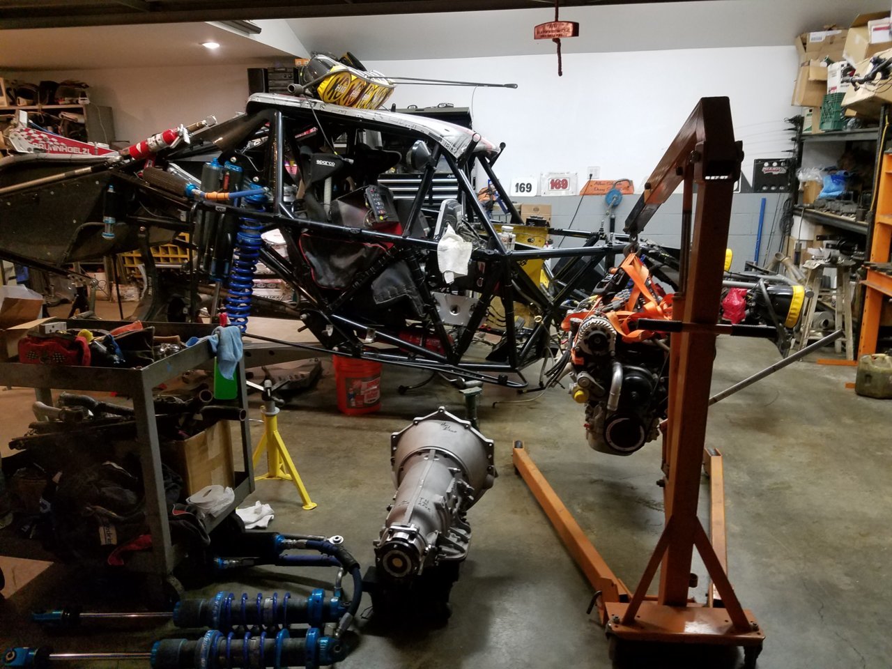

    Luckily for me, we do our own race prep on our 6100 truck and 10 car
    , so I have easy access whenever
    A new motor from Turn Key gets replaced every other race. Leaded high octane race fuel makes the aluminum block soft. And since our class (6100) has a sealed motor rule, rebuilding a motor is not an option. The motor has to be ordered directly from General Motors and shipped directly to Turn Key Motors in San Diego
