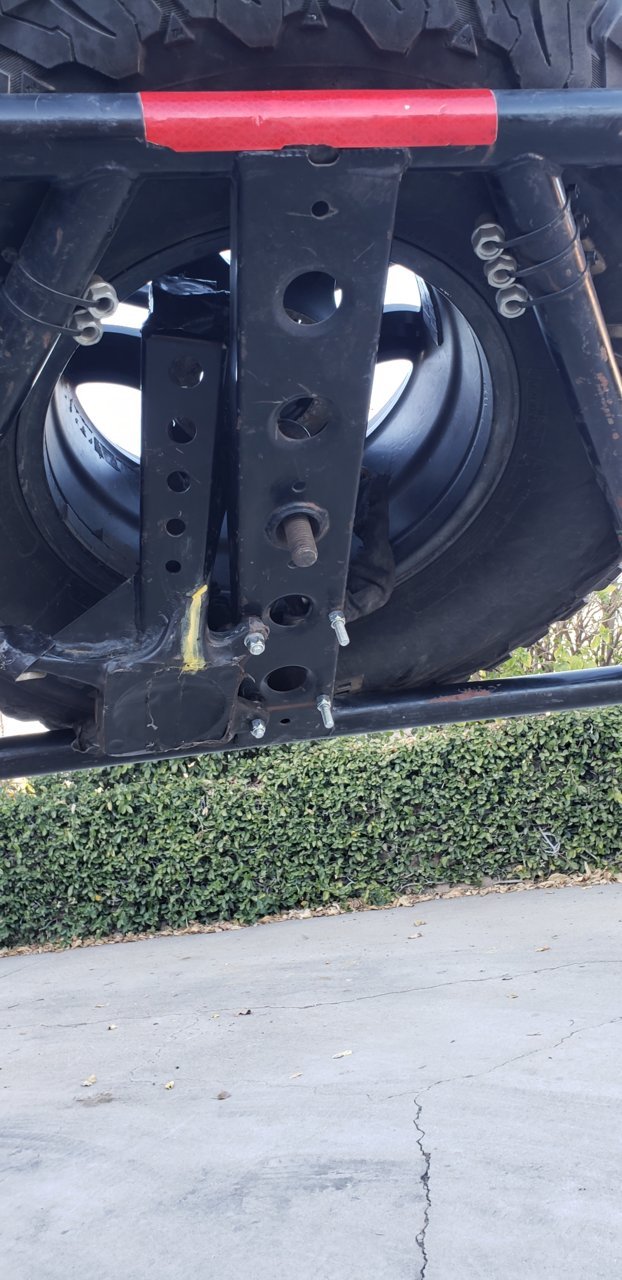

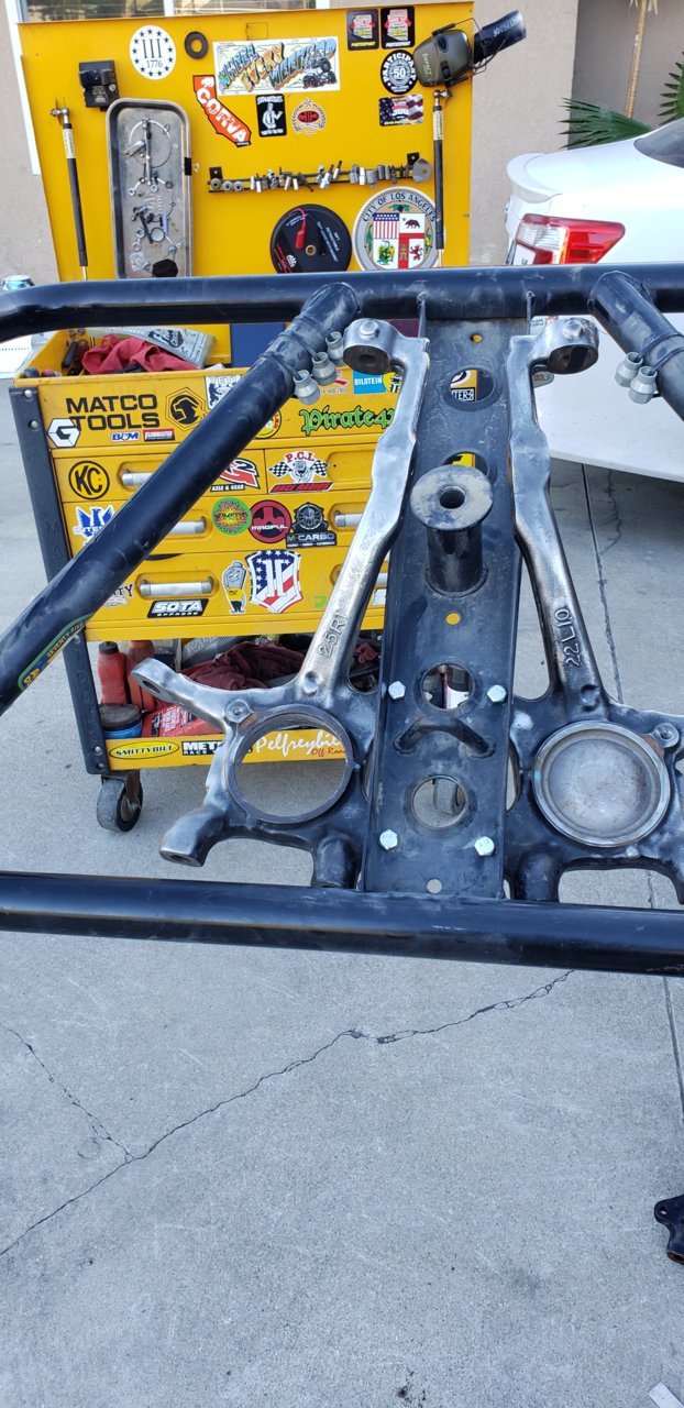

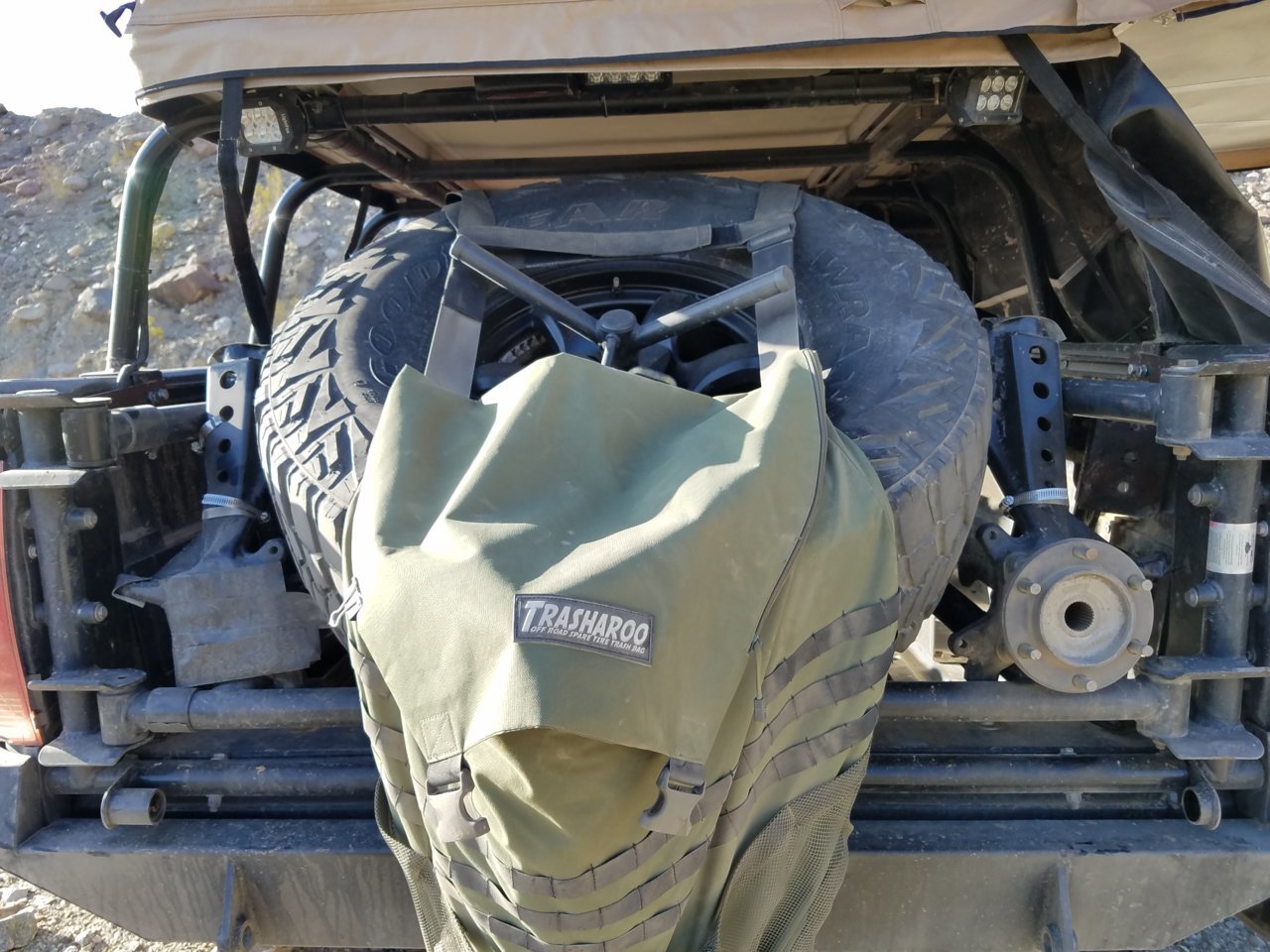

    I carry a ton of spare parts while on the trail, a full set of spindles and a front wheel bearing is one of my bulkier items.
    I never really had a permanent spot for the pair of spindles. How I previously attached them was with hose clamps to my spare tire carrier, which wasn't ever a great way to attach them in the first place. But it worked, and it was a good location for them that didn't take away precious cargo space else where on the truck.
    I finally got around in finding a new home for them that locates them in a much better spot, and out of sight. But still remaining on the spare tire carrier.

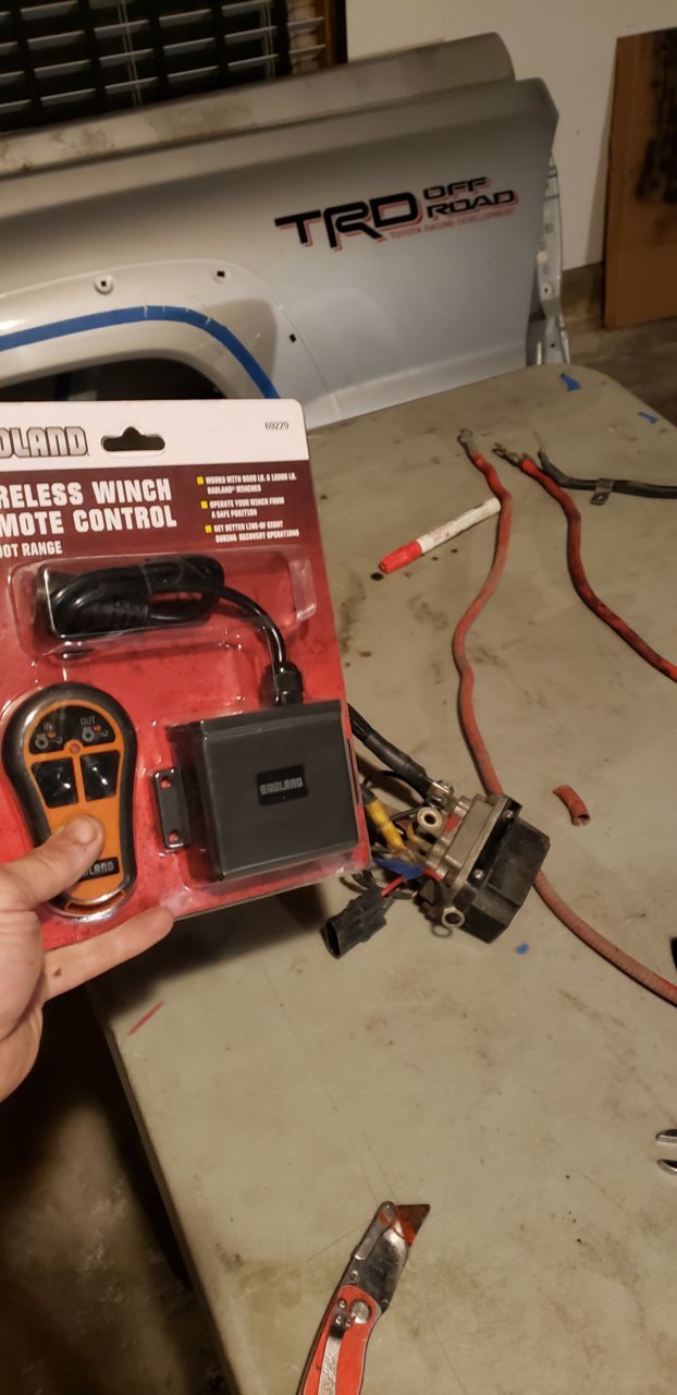

    Tonight's project, wiring a Harbor Frieght BadLand Wireless Winch Controler thingy to work with my 1st Gen. Smittybilt Winch ..

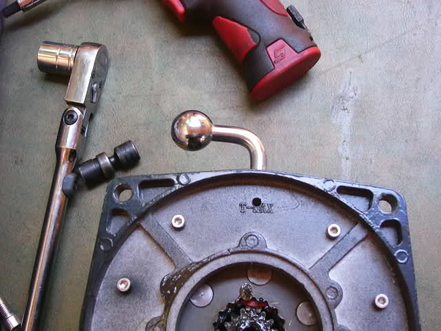

    Back in 2009 when I bought my 1st Gen. XRC10 Smittybilt Winch, I removed the end cap so that I could reclock the free spool lever to better fit inside my bumper. There was a surprise in finding a T-Max casting inside the cap. The Smittybilt Winch is actually a T-Max Winch just rebranded for Smittybilt. Some of you who don't know, T-Max is one of the bigger Australian OffRoad Accessory Companies next to ARB.

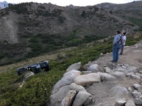

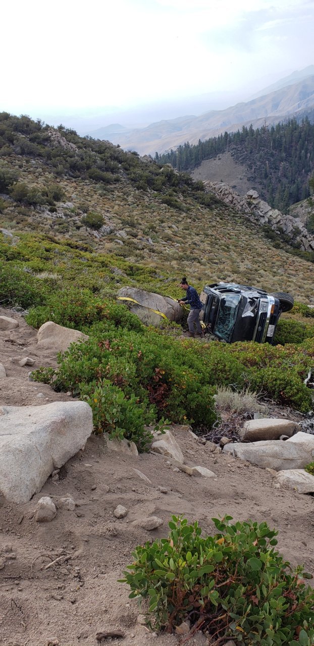

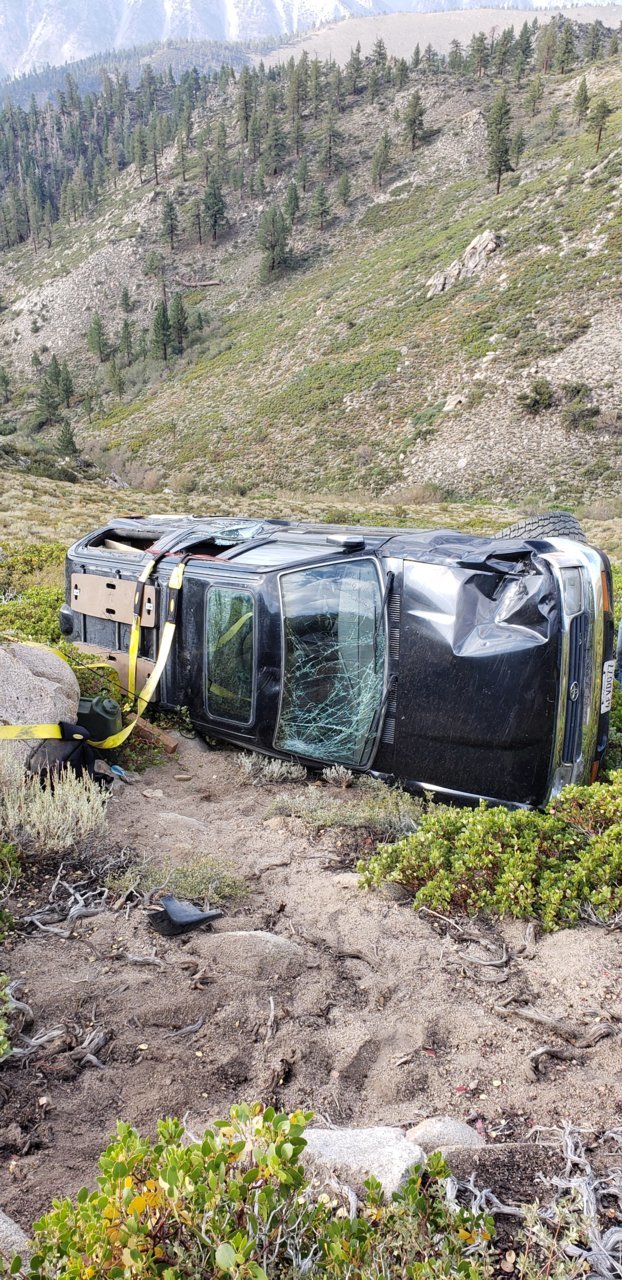

    And finally, the T4R and the actual recovery..
    The plan we came up with was to use a strap around the door and sunroof attached to @theesotericone winch line while attempting to push over the 4Runner far enough that will allow the winch line to gently get it back onto all 4's. My winch line was used to help stabilize and anchor in place the 4Runner to keep it from sliding down the mountain side any further. Surprisingly, it took very little effort to push the 4Runner far enough to let @theesotericone winch line do the rest of the work. Unfortunately nobody was able to take
    pictures of us all pushing on the 4Runner.

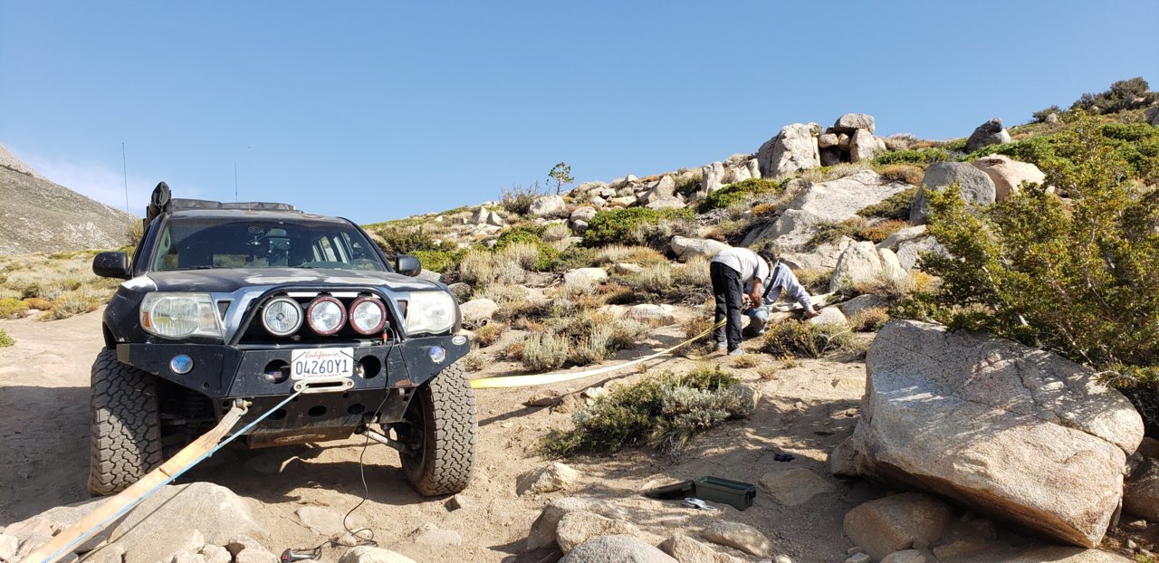

    First order of business was to setup proper rigging to @theesotericone 4Runner and my Tacoma to keep our vehicles firmly anchored in place.

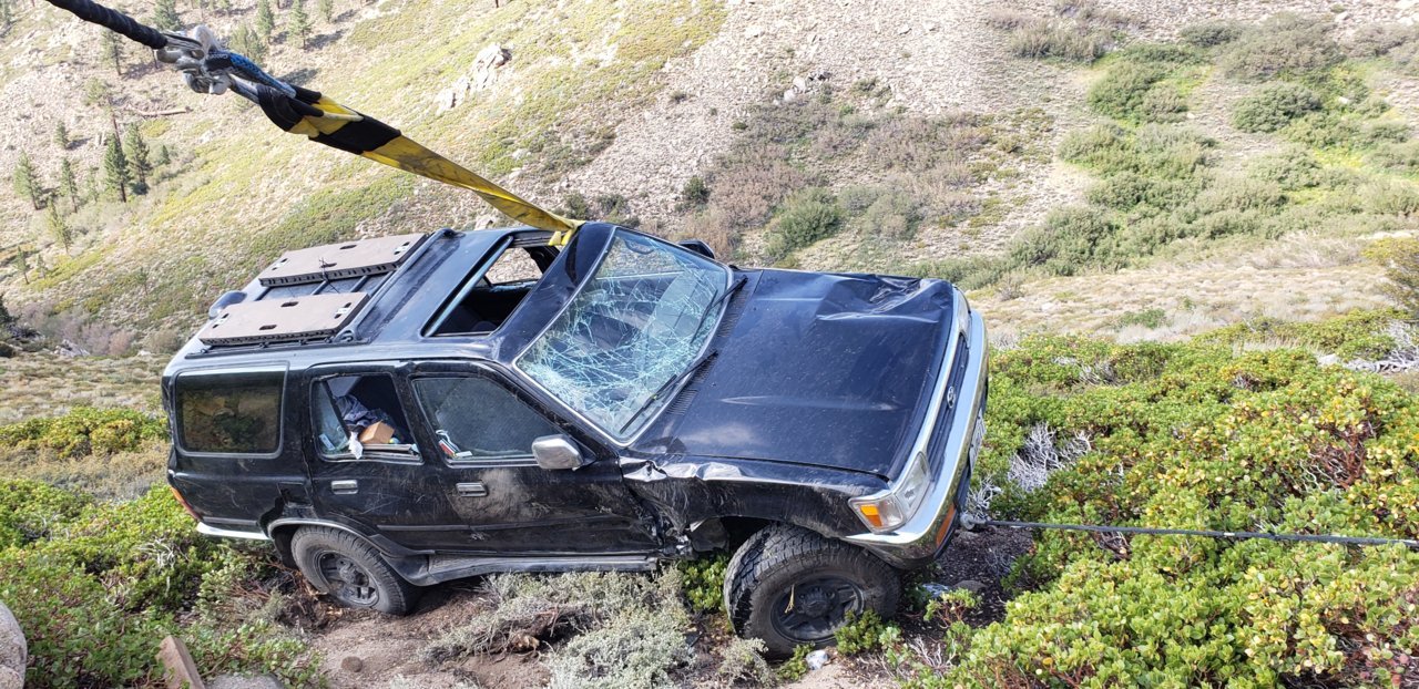

    Now that it's all back on all 4's, the plan was to see if we get the 4Runner to run which will help with the rest of the recovery.
    Ian removed all of the spark plugs to blow out whatever motor oil that may have leaked into the cylinders. After that was done and replacing a blown EFI fuse, the 4runner fired up with no problems.

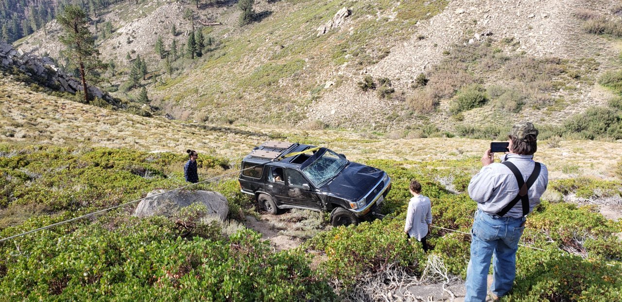

    Now it's time for the hard part with this recovery, Getting the 4Runner safely back up to the trail. Time for my winch to do the work..
    Ian behind the wheel helping to lesson the load during the winch operation.
    Pretty close to the top. And this is where my Tacoma had to be repositioned for a better winch line angle and approach for the 4Runner.

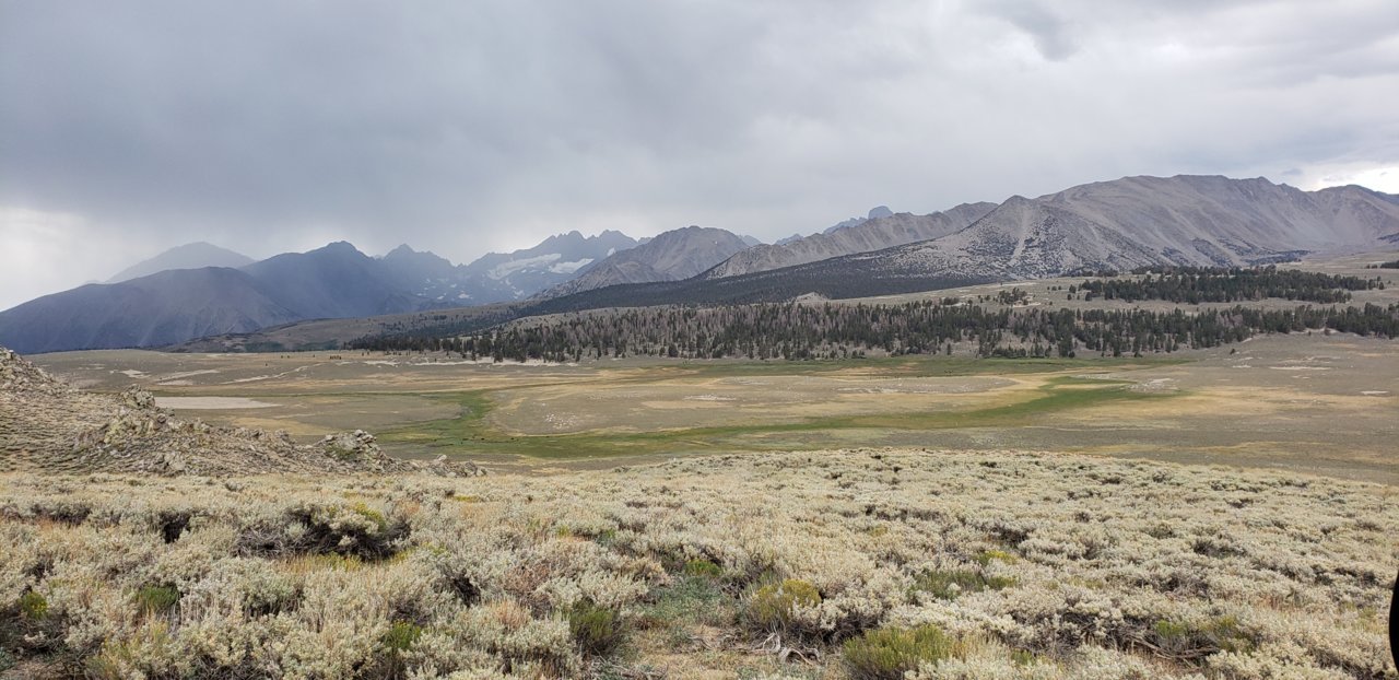

    To think, that down at the bottom of the trail in Owen's Valley was triple digit numbers because of the heatwave. We experienced a thunderstorm with strong winds, lightning, hail, rain and temps down in the low 50's on our way down to the bottom. All in all, the recovery ended up being pretty easy and only took a few hours. That largely was in part being with a group of awesome people who all worked together extremely well.20200818_131358.jpg

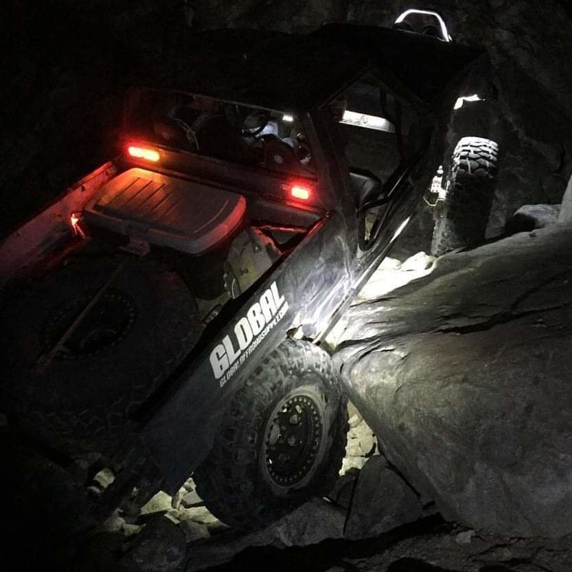

    This is my line right here that gets me up at one shot everytime. And I swear, everytime we start the trail its daylight. But dark when we get to the plaque. One year we had to leave two rigs on their sides overnight to come back with parts and a better plan for recovery lmao
