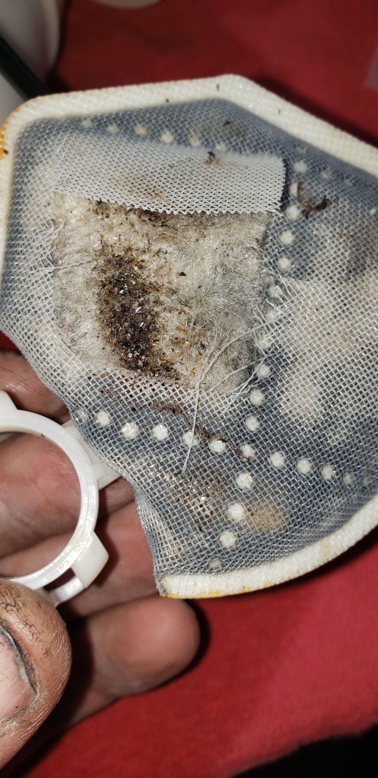

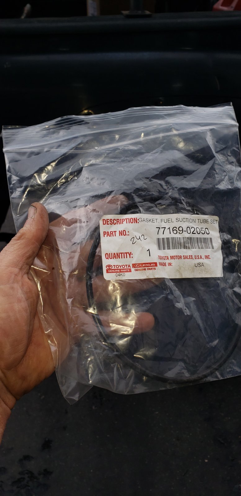

    After running out of gas for like the 10th time, I finally installed a new Fuel Pump and Gas Guage Level Sending Unit. The Pump was replaced for maintenance because at 400k I don't want to be stranded with a bad pump.
    Inside the Tank was prestine, no sediment or any kind of crap. All of the crap was trapped inside the filter/strainer and and the canister that housed everything.

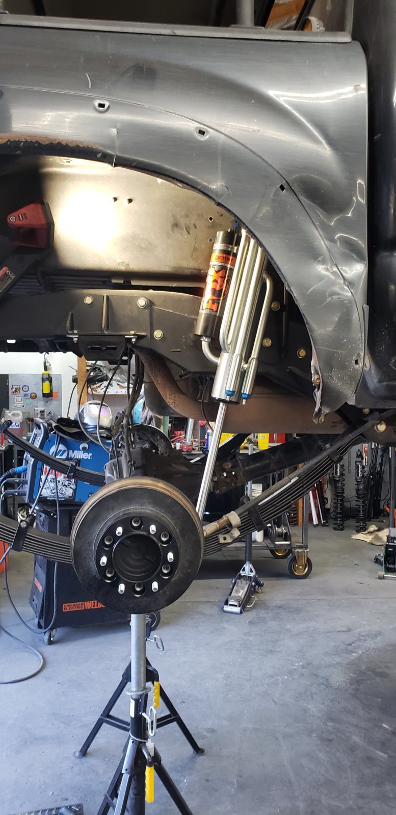

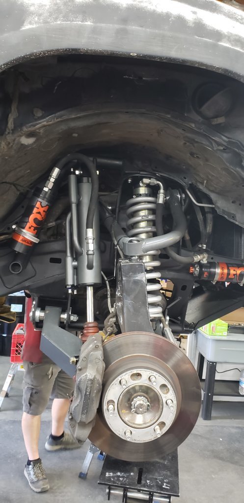

    A bit of shock dampening upgrades happening on the front end, still some work left to do..

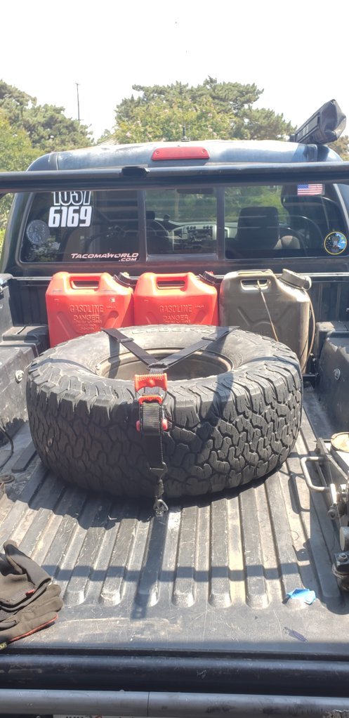

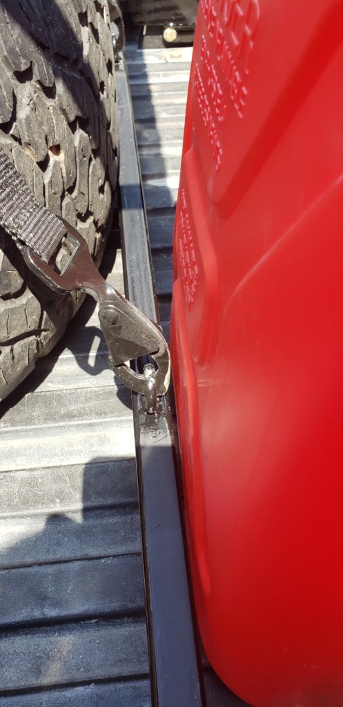

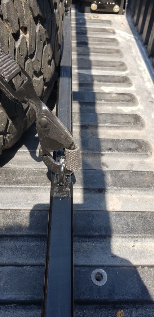

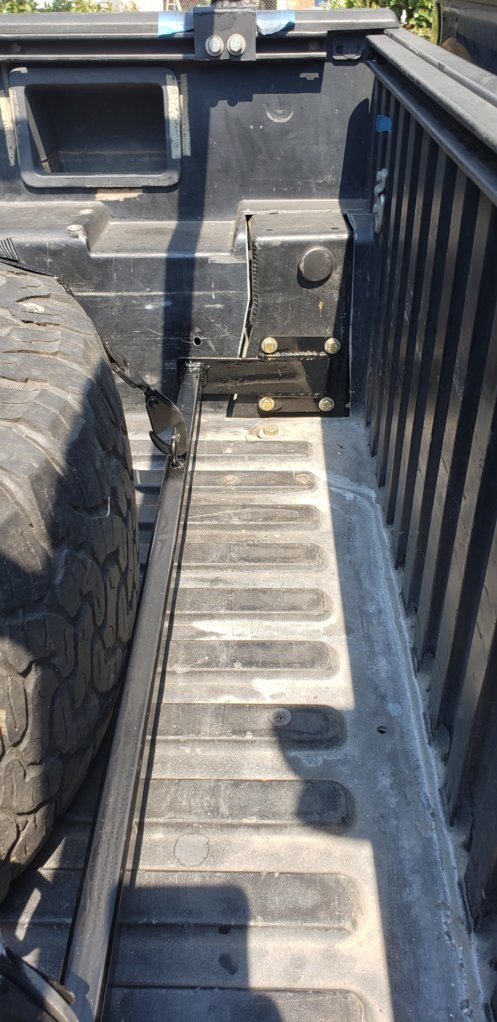

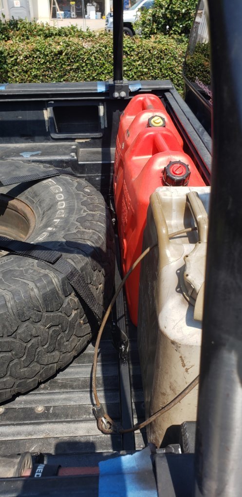

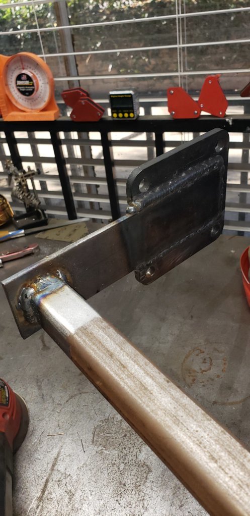

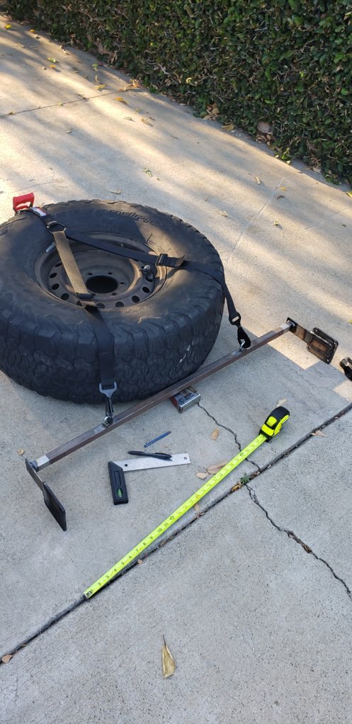

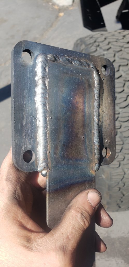

    The Rear Shock Tower/2nd. Spare Tire Carrier.
    Tied in both Left and Right side brackets with 1" square
    Didn't take pictures of the Eye Hooks. I drilled straight through for the threaded part of the Eye Hook, fastened and torqued the nuts on the bottom. And welded the Eye Hook at the top.
    Something that I didn't take into consideration was the thickness of the Tire Strap Hook, I needed to take some material off for clearance.
    A couple of hours of watching YouTube im now a welder and fabricator lmao...The finished project!!
