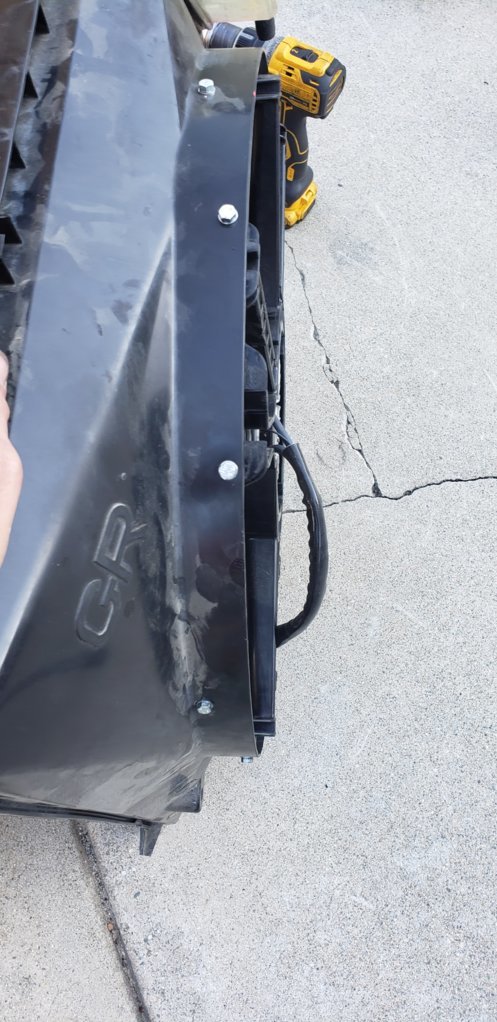

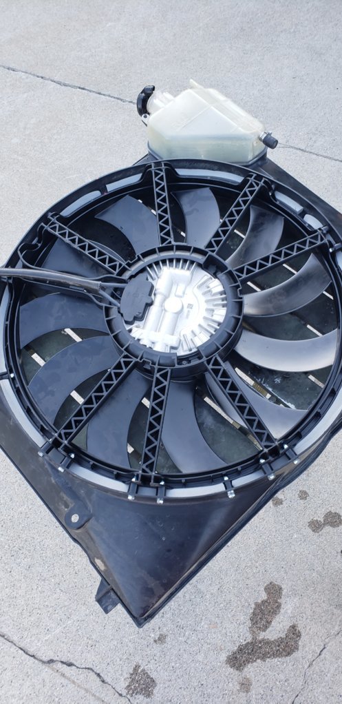

    Meso's arms seemed to be well built and should be worry free. The DEO arms would have me nervous everytime my junk saw dirt.
    The fan and shroud are tied in solid with the way I mounted everything together. It was a little time consuming making sure the holes I made in the OEM shroud lined up with the holes I made E-Fan shroud.
