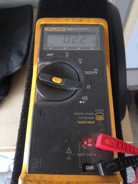

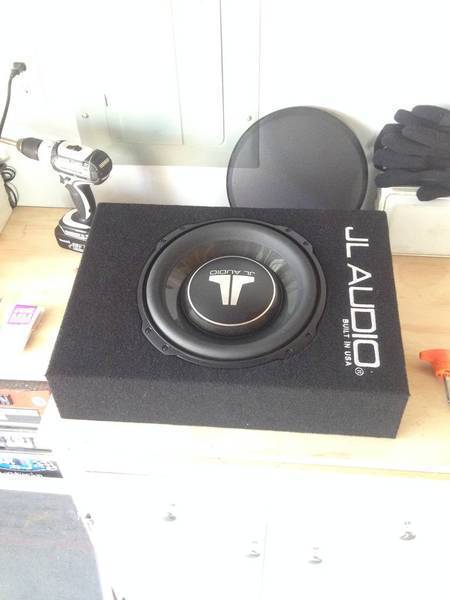

    Your 10TW3 will thank you for the extra oomph. I have the 12TW3 and am running it off the sub channel of my PDX-V9 Alpine. The certificate that came with the amp stated as tested RMS output of 564W.
    Had it running a stealthbox - sold it and picked this up:
    Same power handling as the 10TW3 -
    It LOVES the 500+ RMS the Alpine is feeding it - they are power hungry little buggers.
    Measured the impedance at the terminals at:
    I'd strongly recommend the 500/1 vs. the 300/1. If you install your gear properly and have gain structure set correctly you will very likely NEVER have a problem with your sub. Unless you listen to exaggerated bass music for literally hours on end you will very likely not heat the voice coil to the point of failure (which is where the recommended power ratings/warranty stuff comes into play).
    My 12w6v2-D2 served faithfully for a solid 10 years with excess of 800RMS going to it and never, ever had so much as hiccup. I'd still be using it were it not for the space constraints of the truck :)
    Happy listening - you're going to LOVE that sub.....:D
