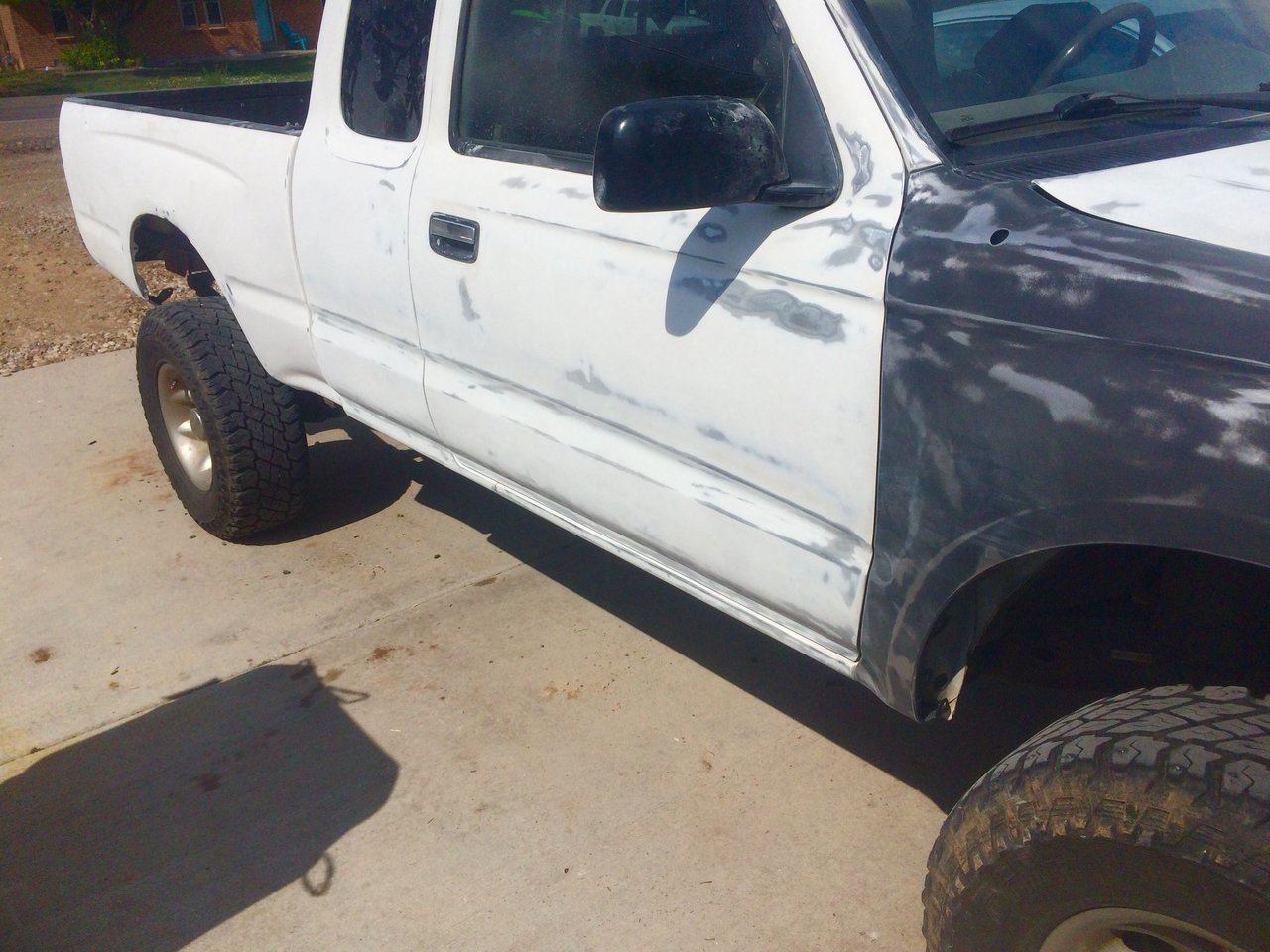

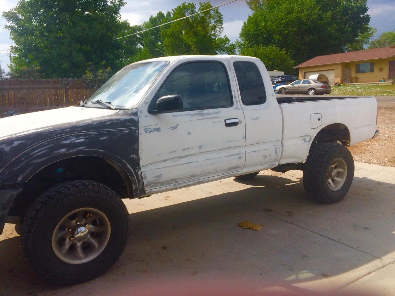

    Last week I started prepping to roll on Monstaliner. I replaced The front fenders because they were damaged by trails and LBJ failure. IMG_1301.jpg

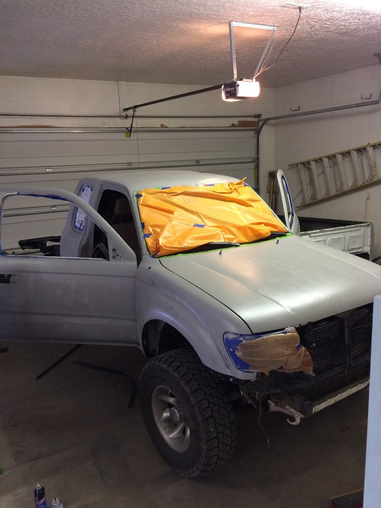

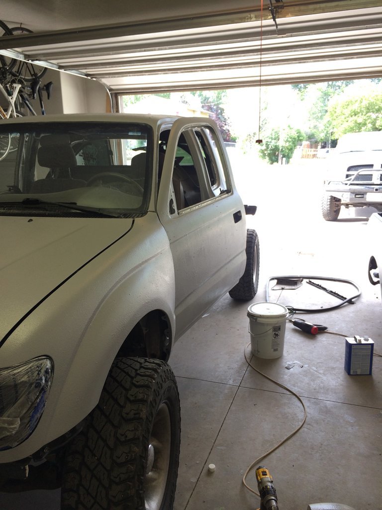

    Anyway, scuffing/ sanding is pretty terrible, i might have gone overboard or maybe not enough depends on who you ask. I used a orbital disc sander and went through 25- 150 grit and 25- 100 grit discs to get the done done to what I thought was good enough. And then I still did more after I took everything off, like the mirrors, handles, back windows, seals and molding and stuff. IMG_1333.jpg
    After this I wiped it done with the MEK stuff they tell you to use, I did like a gallon of water and like 4 seconds and a splash of MEK, like mixing drinks.

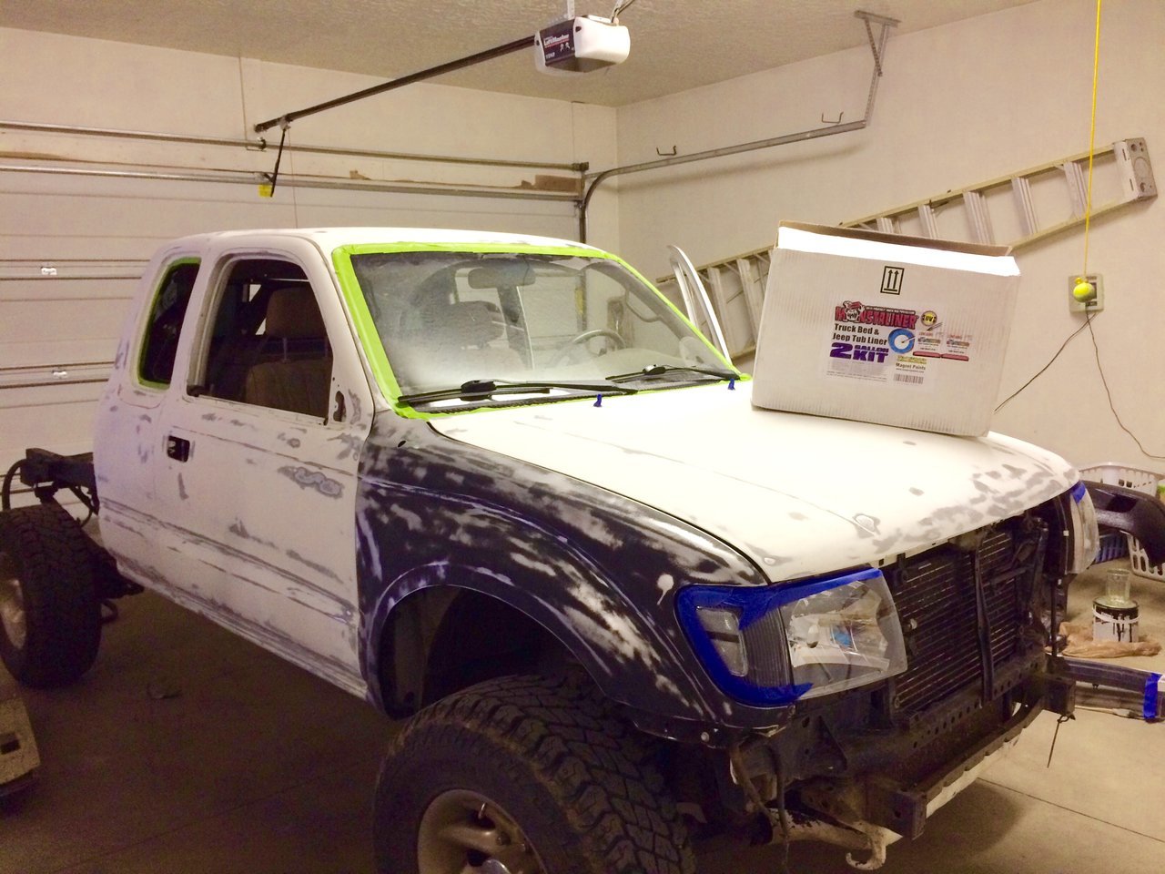

    Next came the taping off, taking your time is good when doing this because you want stuff to look nice obviously. I was givin the tip to cover my lights, windsheild and back window cause the rollers like to throw the stuff a little.
    And then I wiped it down a few more times.
