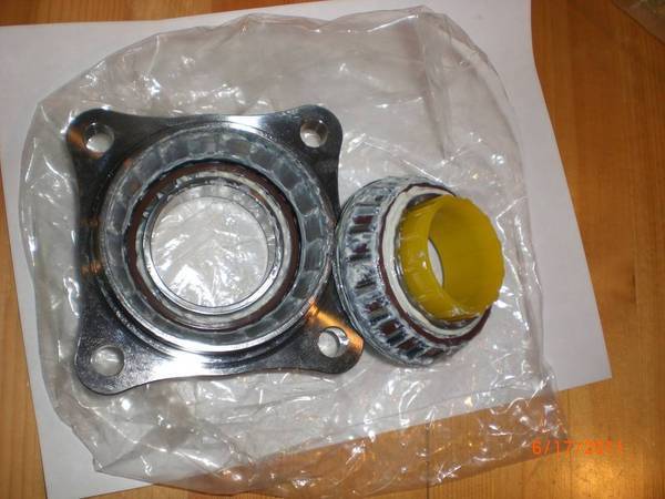

    Well, after a week of wait my Koyo bearings arrived. Unfortunately they have also plastic cage. WTF...
    I check and my LC outters are the same so one can replace cage with rollers but I would have to buy 4 more bearings just to get That thing right. Atleast they put little more grease although it is still the crappy Lithium No2. :rolleyes:
    Oh well I guess I am installing them anyway, I will just pack them full of Mobil synthethic grease.
    If you reinstalling your bearings you may as well go with some cheap bearings because it does not matter. Get them cheap and pack them with good grease.

    Metal cage or plastic ?
    pic of my Koyo, you can see plastic cage. It is stupid because as soon as any dirt gets there that cage will be in pieces with rollers just flapping :rolleyes:
    Very disappointing..:mad:

    here are mine CRS $35
    not much grease in them at all...its ozzing out now cuz it like a 100 in here.....
    only imagine at driving temp

    If it is like this
    Thats not synthethic. Thats Biodegradable Lithium No2

    Looks like that needs to spend some time in the parts washer then get some good grease.
