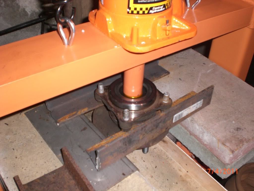

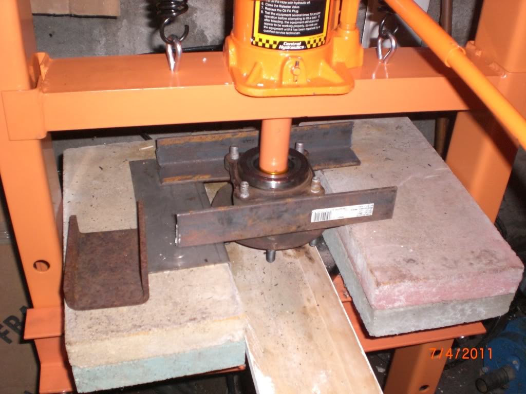

    For those that wondered how to separate that wheel bearing.
    Home made wheel bearing puller in action. Made out of two angle irons 1/4 inch thick. Total cost about $20 in material and few hours of grinding. Few hours because I thought making one out of 1/8 inch thick steel will do. Well it did not so I had to redo the whole thing with 1/4 angle iron :D

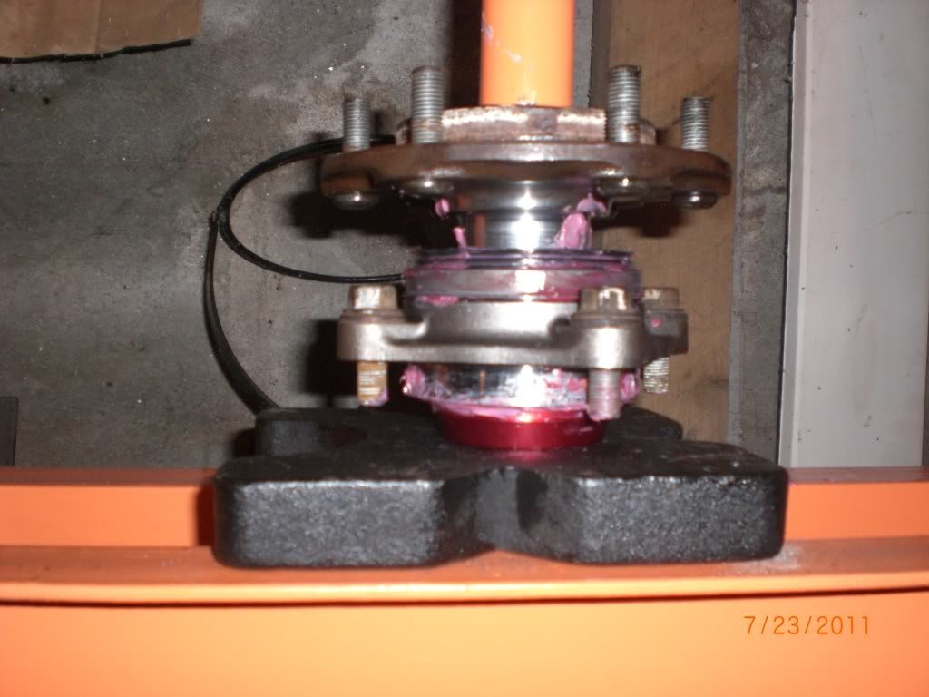

    Despite the massive heat, my driver side bearing is now in. :)
    Picture of assembly. Pink stuff is grease, red ring on the bottom is Aluminium spacer for pressing bearings. Its good to rotate bearing while you press to make sure rollers inside are not binding anywhere. Take it slow while pressing as not to damage the bearings. My son asked me "when you know bearing is fully pressed?". You really dont but Seal should be flat to hub and bottom bearing race should be 1 mm - 2mm above the hub.

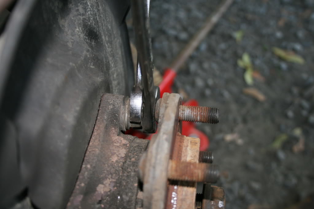

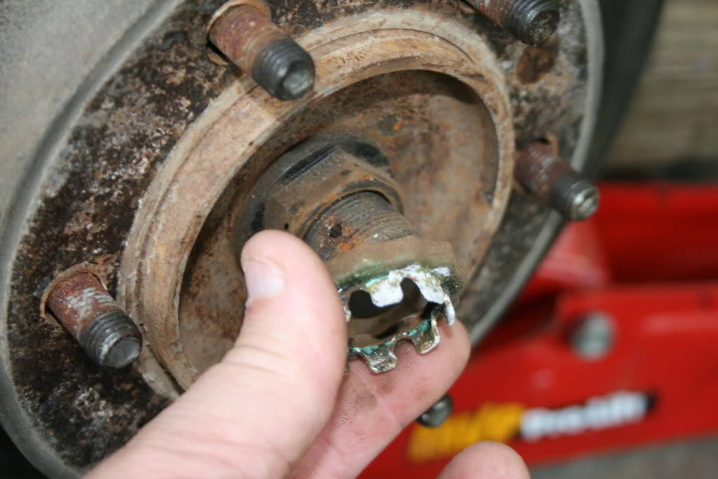

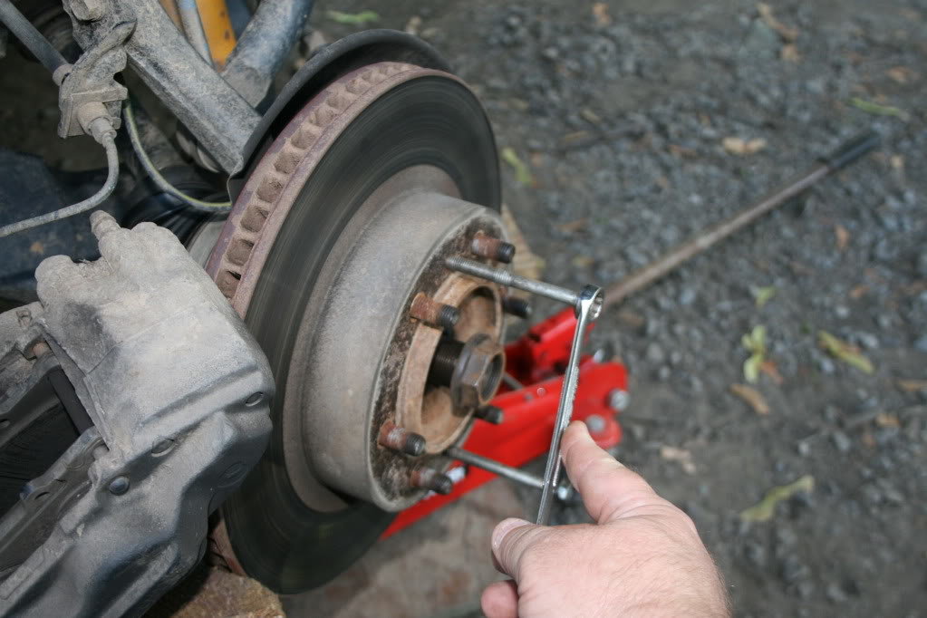

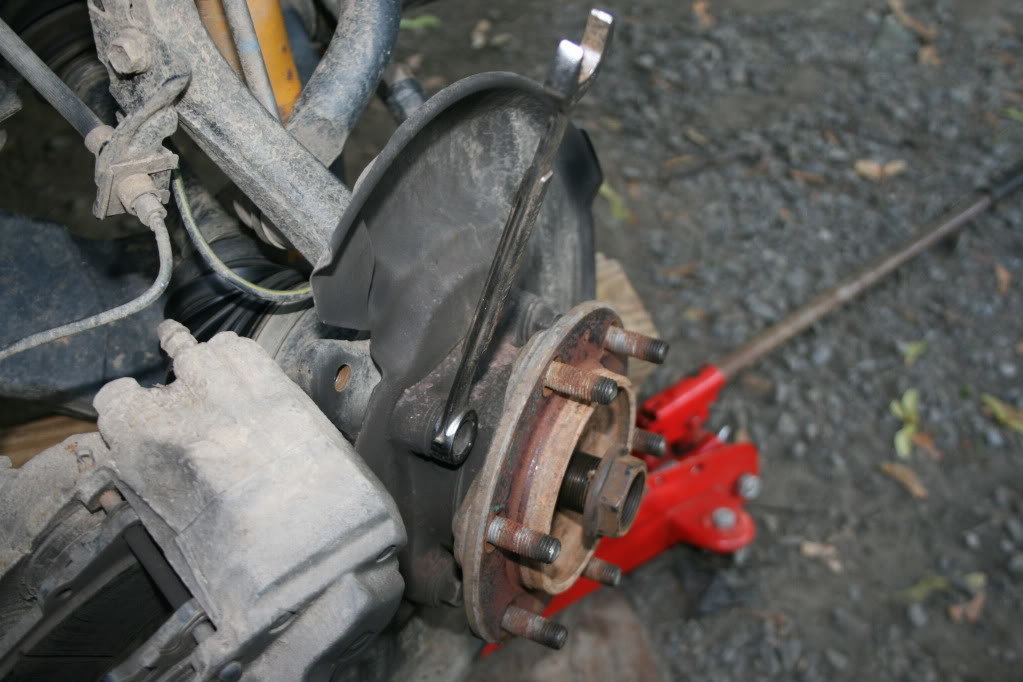

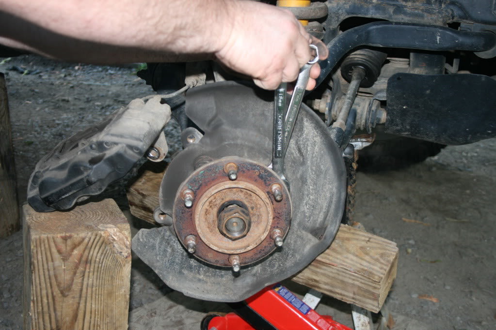

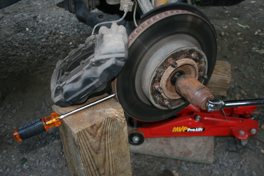

    Great photo! Thank you! I did my passenger side bearing Thursday (took a few days in this heat) lifted truck on first day, removed old bearing/hub then next day installed new one. I was not in any hurry and did it outside in the heat of the evening. (About 80-85 with high humidity)

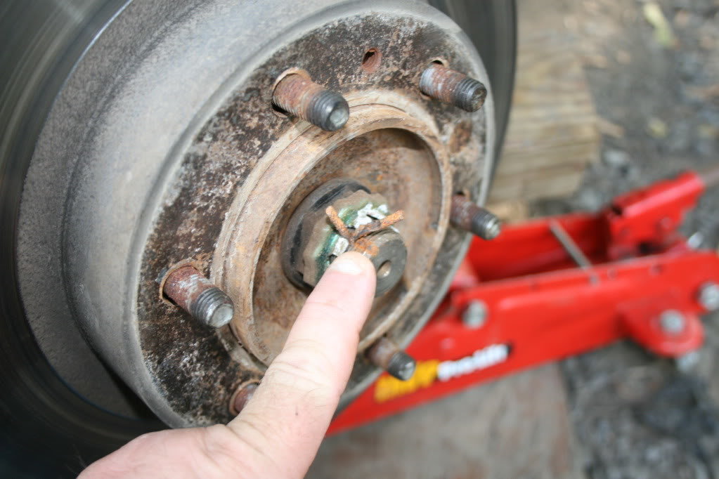

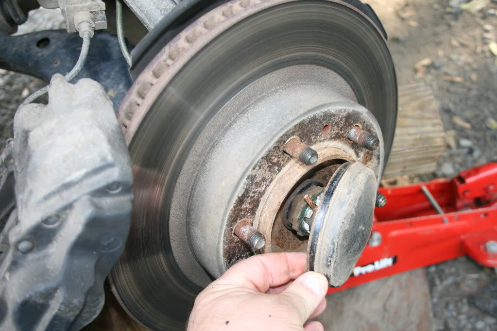

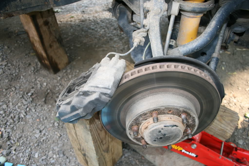

    Remove the 2 bolts that hold the brake caliper assembly. (17 MM)
    Remove the center cap.
    Remove the cotter pin.
    Remove castle bolt lock.
    Now to remove the bolt, put a screwdriver in the rotor fins to keep it from moving while loosening the bolt.
    Now thread 2 bolts into the holes on the rotor to pull the rotor off.
    Loosen the 4 hub bolts. (17 MM)
    While loosening these 4 bolts, allow the bolts to push against the wheel studs to help pull the hub out. I put another open end wrench in between and loosen the bolts. This does all the work for you.
    And now its out!

    great write up rich......
    thanks for all the pics.....

    Thank you, I only wish I took photos of the install. I guess you just reverse it. lol
