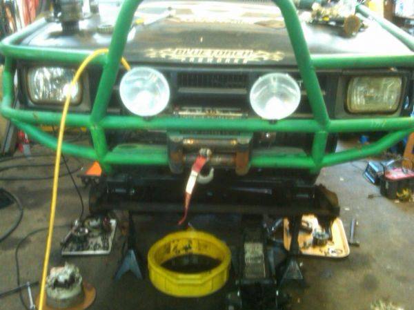

    I stopped by a buddy house who has this beast
    and borrowed 35mm, 36mm, and 1-3/8". Ill mess around with each and find out which fits best then post it. Also grabbed his Snap on torque wrench. Gotta love friends with shops :D

    Here's what I found yesterday
    More pics in my build. When I'm done Ill throw some up over here.
