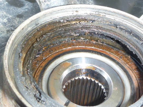

    The one FSM is incorrect. I noted that in the OP last week and provided a supplement FSM with the correct torque. You use the first to disassemble and the later to assemble.
    Nope...it's just plain wrong from what I remember.
    :woot:
    Ill throw some pics up over here when I'm done it all. I'm 95% done demo and ready for most of the new parts. Drivers side was much cleaner when I removed it tonight. Looks like these seals held
    These not so much
