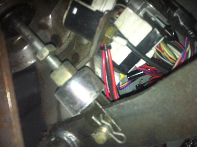

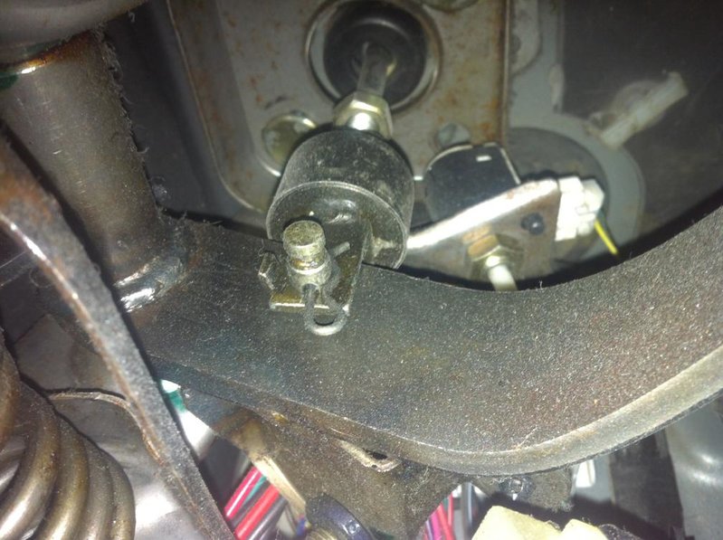

    I'm still having trouble shifting my truck into first gear after coming to a complete stop, shifting to neutral, and releasing the clutch pedal. So, I decided that I'd adjust the clutch pedal a little bit to make sure that the it's getting fully engaged.
    I discovered three things when I did that.
    1) The entire push-rod assembly fell out of the master cylinder onto the floor of the truck. I had assumed that this part was supposed to be captured and couldn't be pulled out.
    2) I only have about 3 threads left that I can lengthen the rod by. This makes me think the clutch doesn't have long to live.
    3) That push-rod assembly bends when I depress the clutch. This can't be right, right? See photos, but it bends as pressure is applied to the pedal. The bend is right at the adjustment nut.
    Dammit, why can't I post pictures? Links here:
    https://www.flickr.com/photos/41661692@N06/15781763956
    https://www.flickr.com/photos/41661692@N06/15781764276

    I'm bumping this for another day.
    Does anyone know if that rod is supposed to bend like that?

    Doesn't look bent. Looks like it pivots

    It's bending. The metal adjusting rod coming from the master cylinder attaches to the piece that straddles the clutch pedal in a plastic bushing. The plastic bushing is actually breaking from the flexing/bending.

    The push rod is after market. It came with a new clutch master cylinder that I bought at auto zone.
    When the rod came out I was actively in the process of adjusting the clutch pedal, so the linear spring (yes, I did that mod) wasn't attached to the clutch pedal. Ergo, the pedal fell, but I don't think that's relevant given that I was adjusting the pedal anyway.
    Perhaps I'm missing something, but to adjust the clutch pedal I back the lock nut off, unhook the linear spring, remove the R clip, push the clevis pin out, and slide the whatever-the-hell-it's-called that is at the pedal end of the push rod off the pedal. I twist it in the appropriate direction and re-assemble.
    Metal is not bending. I should have taken a picture of it while I had it out. One end of of the push rod goes through the firewall into the master cylinder. The other end is threaded and goes into a plastic bushing inside the whatever-the-hell-it's-called that is at the pedal end. It's the plastic bushing that's giving and bending.
    As to clutch wear, I think I must be near the end of the life. There are only about 3 or 4 threads of the push rod left in the adjustment end. However, I think I'm losing some throw, given the bend. If that rod stayed strait I think it would push further.

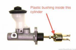

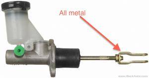

    Let's try this.
    I think this would be a better design than I have installed. It's all metal.
    The one I have on there now is more like this:
