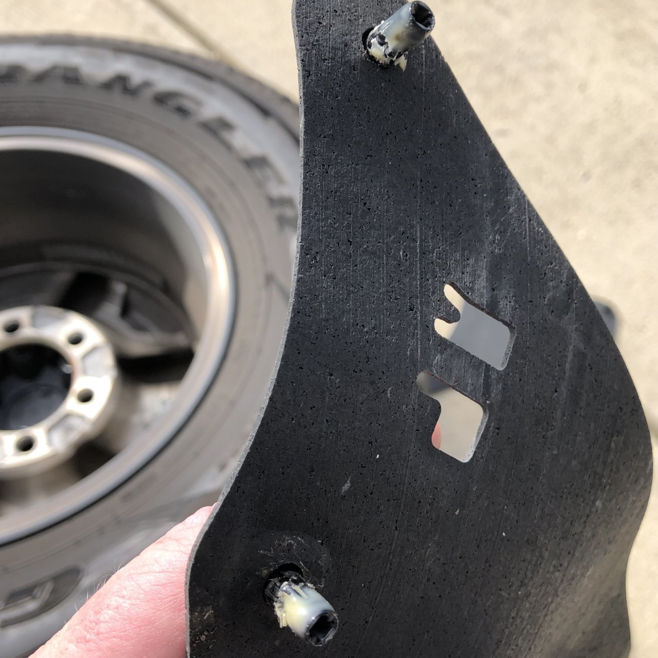

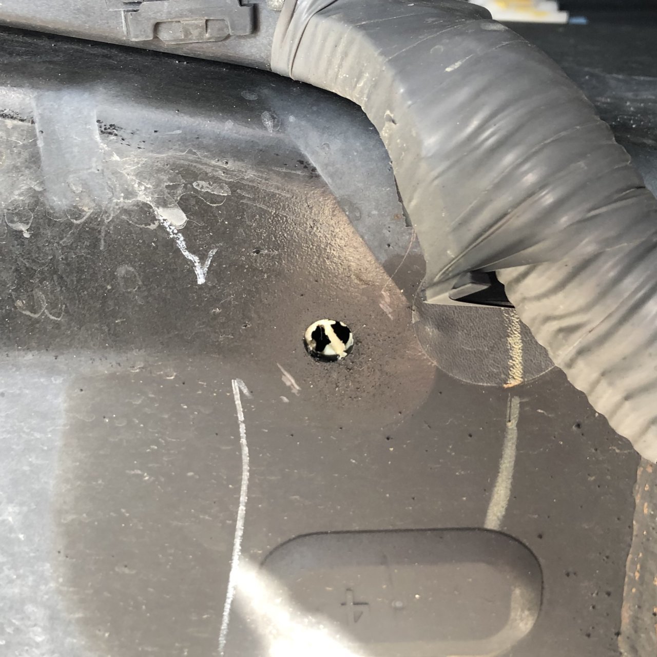

    I can confirm, at least my 2018 is coated with some sort of wax-like goo that looks like congealed fluid film. Here are some close-up pics of the holes and pins from the splash skirt on the front drivers side fender well...
