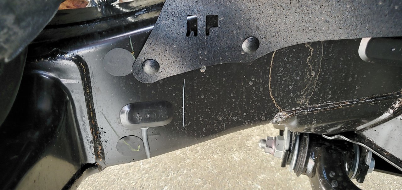

    I noticed my frame rails looked hazy after a car wash a few weeks ago. I wondered what it was... thought it was soap residue, but wax makes sense now.

    The coating this time around is different than before. It's a heavy grease/wax like Fluid Film. Before it was more a rubberized paint.

    Mine's an 18 no wax substance found, which is why I coated it inside and out with 3M Cavity wax. I also did the inner rockers, inside the doors, behind the fenders, bedsides, inside the tailgate, and cab floor pans

    Looks like ye olde cavity wax like I think I found on my 2020s frame. It's a start. Theres a ton of dry frame under there, I think I'll still coat it with something.

    Mine is getting CRC coating February 3rd. They do the inspection and then notify Toyota who then will arrange the CRC coating. I was told dealerships can only do 3 or 4 trucks a week and they will have my truck for 2 days. They have to prep the frame and make sure it is completely dry before they can apply the CRC. I was told they schedule trucks when the material comes in designated for your Tacoma. Good luck.
