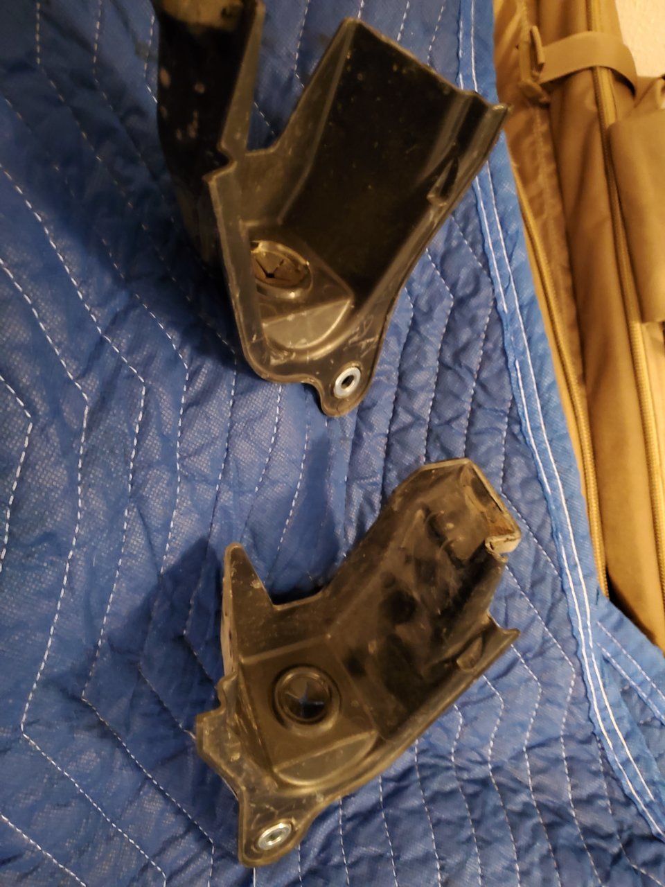

    For those with 2017 and 2016 this is the plug they put in (I had to take mine off when installing my rci crossmembers) I did peek inside the frame since I had it off and mine is waxed in there

    Yup right where the brake lines are bolted up on the frame. It's not water or dust tight but to keep debris out

    Where can we purchase said plug?

    My 2019 has these. If you look at the end there is s hole that a hose fits in. You can soak it clean by spraying a hose in there. Then it all comes out a plug on the bottom that allows stuff out but not in. Then you can insert your fluid film or woolwax hose in there and fill the bitch. Next summer repeat.

    Yep, I saw that pic and thought and thought "huh, those look familiar." I stuck the 360 degree spray extension in there and went to town when I FF'd in October.
