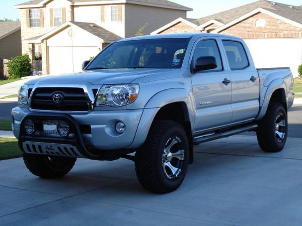

    About the tires...no, they won't look too small at all. You get a bit of height going from the 265/65/17 to the 265/70/17. I actually have 285/70/17 and the height is fine. Also, if you look at moraink's rig, he's running the same size you are and his rig looks sweet:
    The shop guy might be somewhat correct...with the spacer, you'll probably get 2.5" because you have a double cab...with the coils, you'll get the full 3". IMO, it really is no big deal. Stick with the spacers. Here's my rig:

    Thanks for the comps! The 2.5" is really a guess after the truck settles a bit. You're probably a lot closer to 3". Per ToyTec, the 3" lift kit with spacers and AALs will level your truck. The AALs are actually supposed give you around 2.5", since the rear sits a little higher stock than the front. With the kit, you'll be level, so don't worry.
    I actually had a shop here install it for me since I was too lazy. I think all you really need to do is compress the coils, and you're fine. A couple of other items I did add were the front differential drop kit and rear shims from ToyTec. The drop kit will help when you get the alignment done. The shims are supposed to cut a little of the vibration, I think.
    The steering was fine with the stock wheels and tires, but when I got the bigger tires, I started to drift left. The alignment shop said I needed some UCAs, so I ended up buying some from a guy on craigslist - they were brand new for $550. Honestly, I think you'll be OK without the UCAs...just get the alignment folks to get it the best they can - you'll be missing a bit of margin on castor, but they can get it so your tires won't wear out funny. You really won't notice too much drift and it won't be swirly either. Just get the UCAs when you get some cash later.
