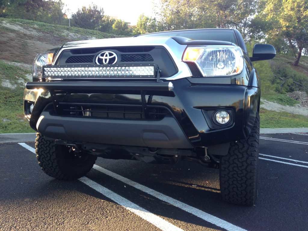

    Jeff,
    I was wondering how you did that!!!
    I want to mount a LED light bar up...I remember your old Tacoma before the Tundra...you had a LED light bar on a N-Fab sort of mount...how did you do that one? I was thinking of doing the 30" in the bumper but really dont feel ike cutting it up.

    I used a defiant light bar, I have had one on both Tacomas. They are solid and 100% bolt on, no cutting. vabasa8e_0f43ff29e34b6ba10f3e2603146a587d3efb4414.jpg

    Haha they are pretty haggard. Considering I am no fabricator and my tools are limited.
    It's basically a piece of 4" x 2" U channel 6160 aluminum from McMaster. I cut it to 1 inch pieces. Then cut a triangle out in the center and bent it back to follow the contour of the fire wall. Attached some some small supports to the area I cut out. Then attached it to the truck using an existing hole and some toggle bolts. I need to snug up the bolts so I will grab some photos when I do that.

    Yeah that is what I am thinking! That is a E Series light right? What length fits to the tabs or did you have to modify it?

    That is an E series.
