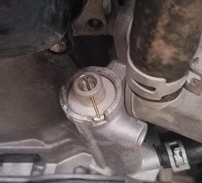

    With the new cooler being in series with the OEM, the ATF t-stat has to open before you’ll see any benefit from the coolers. The temp at which it’s set to open is pretty high for most of us. Around 205*f for mine. If you pin yours open to test you’ll see the result quickly, maybe more cool than you want. :)

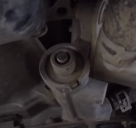

    Where is the ATF t-stat out of curiosity?
  12. May 26, 2021 at 11:44 AM
    Skydvrr
    Skydvrr IG: @kalopsianick
    Sep 13, 2017
    #229889
    12,653
    Nick
    YMH
    Black '17 OR
    Passengers side of trans. Towards the front. Cylinder looking thing with a button lookin plunger about the same diameter as a pencil eraser
    SR-71A[QUOTED] and vicali like this.
  13. May 26, 2021 at 11:59 AM

    Gizmo looks like:
    Pinned:
