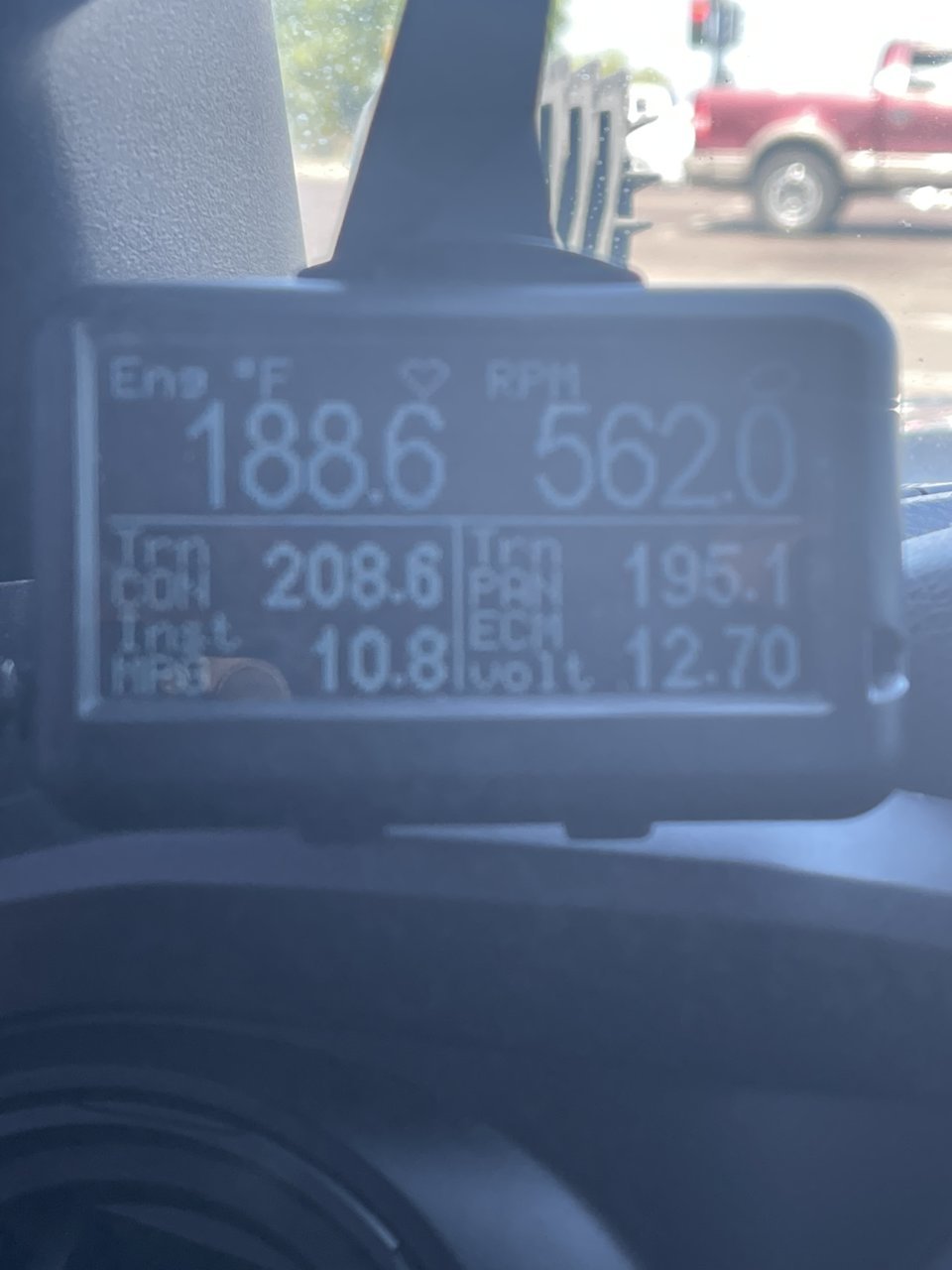

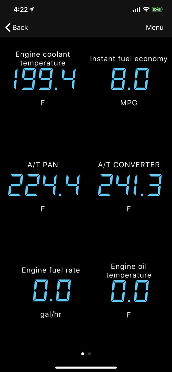

    Dude empty I can hit that temp EASILY. That's wild. I can hit ~250* pulling a hill empty, very easily

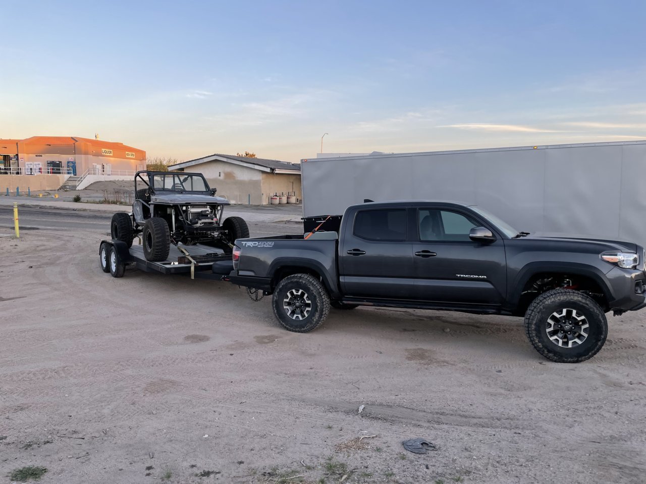

    Damn, I have a scan gauge 2 and this is close to the highest temp I’ve seen. I took this right about the top of the climb. I saw a temp of 228 at the highest. Rig weighs about 3000 lbs, trailer about 1800, I have about 400+ lbs of armor, and my bed is loaded with 300lbs camping gear including the 14 gallons of water and some fire wood, 2 people in the truck me 145lbs, wife 135lbs. This was in the morning of warm day and I was pushing the rig hard attempting to keep up with my bro and his Cummins towing 12k. When I towed my rig to the rubicon trail from Rancho Cucamonga, Ca 1000 miles round trip, I might have saw a temp of 230 ish but it was nice and cool.

    That's so crazy to me, I never tow anything haha.

    Dang pretty weird how different they are. Mine without towing runs about 200. I’ve seen about 230 while out Off-roading on a hot day going slow with the ac on. What’s the outside temp when that reading was taken? I have not modded the factory cooling whatsoever. I do have the tow package with the factory cooler just FYI, also have no lights or anything blocking any factory airflow.

    Thats a serious pull. That last leg over Cajon is a bit steep. I assume you took 395 to Tahoe, so you pulled that load over Sherwin, Deadman pass, Conway Summit, and Devil’s Gate along with some lesser passes along the way.

    Actually took the 5 freeway most the way so up grapevine, I’ve only been there 2 times in the past 6-7 years so I’m not familiar with those names. I had brakes only on one axle on the trailer at the time and my brakes were getting Hot in traffic coming down the pass.

    I've been monitoring my temps as I was getting ready to swap a 4454 into my truck and wanted to see before and after temps.
    Towing my SxS up an 8% grade floored in 3rd gear got me up to 231 @ 90 degrees as I topped the hill.
    Typically in normal, just clicking off miles mode, I usually am around 190-200, with the occasional rise to 220 or so in traffic.
    I haven't towed yet with the new cooler, so I will see how it goes. I am unpinned as well.

    Part of me wishes I went with a true cool. I have a mishimoto. I took this pic as I got off the freeway today. I think the dash said 102*

    That looks pretty good to me, maybe the 208 is a touch high, but mine will be about there at the off ramp too.
    How are you getting it to 250? Power braking it? You fat? Just lucky?
