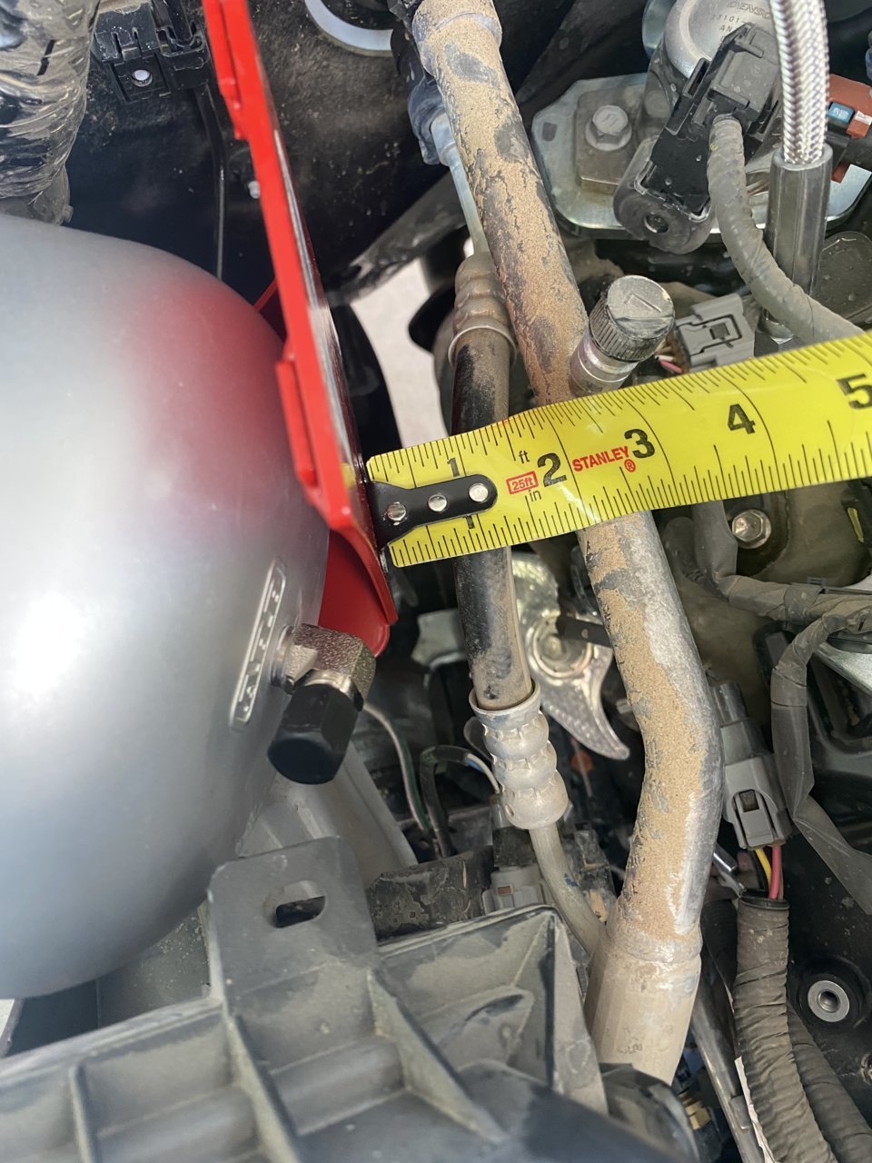

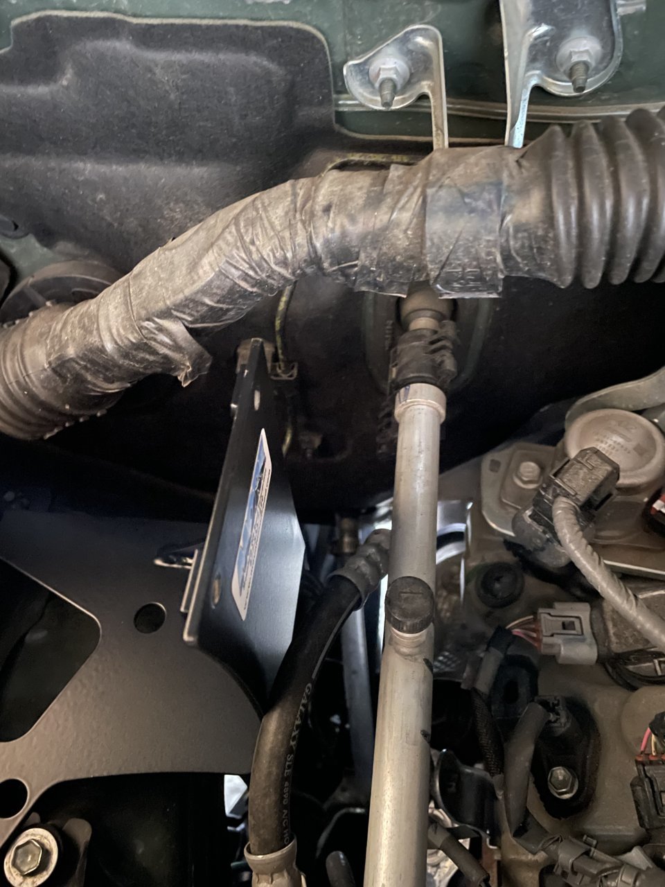

    Got the mount from rogue off-road. The support from the firewall didn’t line up but some bending with a vice grip and repainting it since I scratched some paint off and call it good.
    I got it for a reasonable price so eh hopefully someone buys this off me I can cut them a deal I don’t care just would hate for it to go to waste. Perfectly good mount.

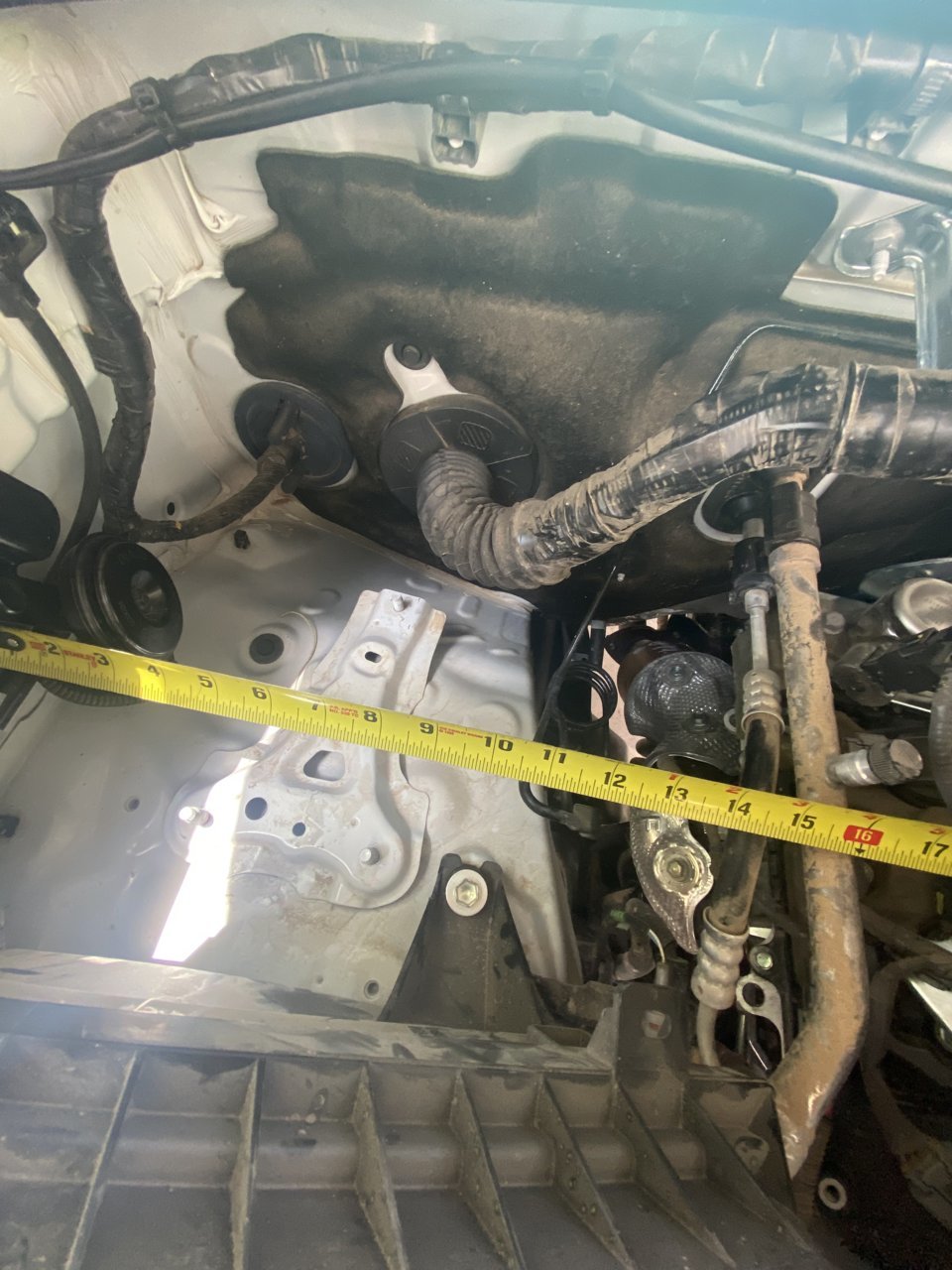

    The Rogue looks legit, and definitely solved you spacing issue!
    The MORE bracket is a great bracket and a solid way to mount the twin. But as TheIncredibleTaco found out, there are some variations in hose lengths/placement from the factory.
    If you are on the fence about buying it from him, do a quick measurement of your space. If you have 14” from inner side wall to AC line, you should be good.

    Right I wasn’t running the tank anyways. I thought of adding a box to hold the air hose and things to preserve cab space but whatever.
    I don’t have a pic of my final setup (can take one later) but here’s the more bracket and how it was hitting. Maybe that was a slight manufacturing quality control issue when moving to Mexico while working out the kinks. It still works just takes up a little more space.

    I believe the one Rogue carries is called GTFO. I just tried fitting that on my 22 with similar issues with firewall support bracket. Once it lined up, it pushed the mount forward towards the intake, which limited the placement of the ARB filters. It was nice and easy, just wished it fit.
