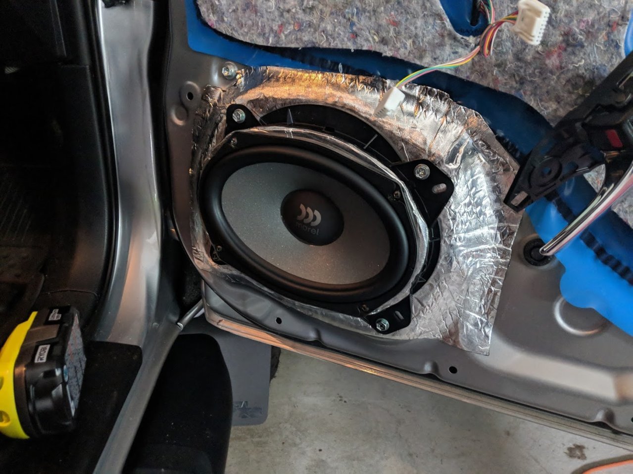

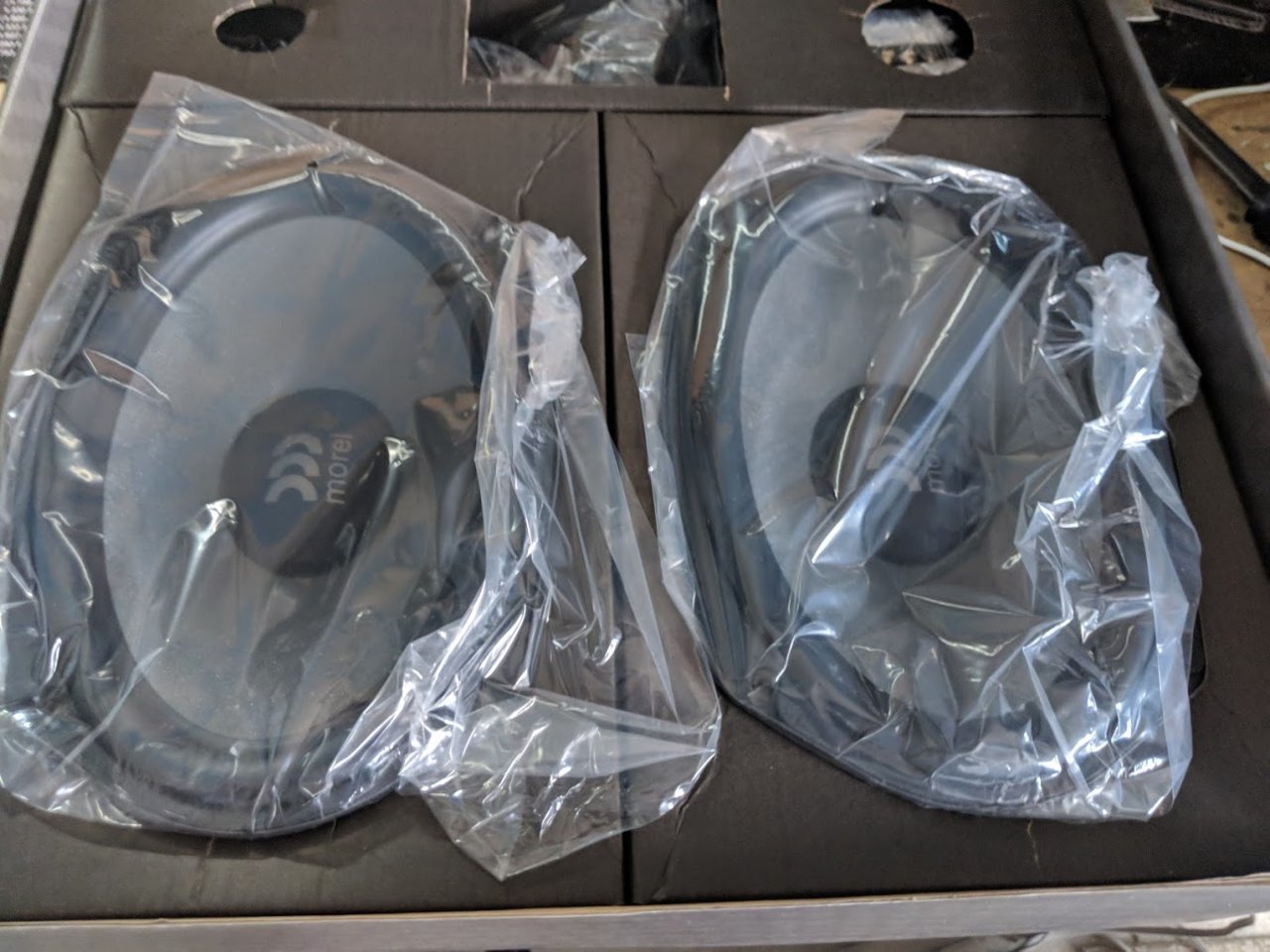

    Just a quick hit on these: They are on sale at Crutchfield for $299.99. These speakers are pretty highly regarded and are an amazing value at this price point. The Crutchfield "what fits my car" says they do not fit for the 2016-2018 3rd gen Tacoma, but they absolutely do. If you are going to go the amp route on your truck, this is a great set of speakers. Fill those door holes up!
    The adapter Metra 82-8146 is what I used. I spoke via chat with a service rep to make sure that the proper harness/adapter was added to my cart (for free), because the website will not add the free things to your cart if the what fits my car app says the speakers do not fit.
    I have the 6x9 drivers installed in place of the PPI drivers I had, not hooked up to their proper crossovers yet, but being powered by an Arc Audio XDi 850.5, and they sound great so far. As soon as my tweeter adapters come in, the tweeters will go in the OEM spot on the dash, everything will be put on the proper crossovers with new wiring.
    I installed the speakers with the windows down, and there is clearance/room-no issues.
    The one thing I do not like is the connection terminals. They could have done a better job on these, but it's not a deal breaker at all.

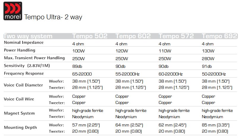

    https://www.morelhifi.com/product/tempo-ultra-2-way/

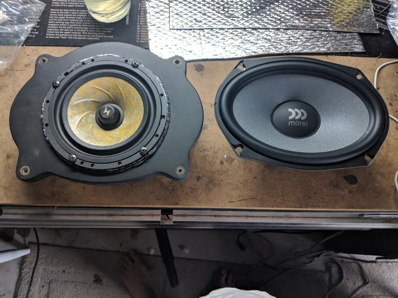

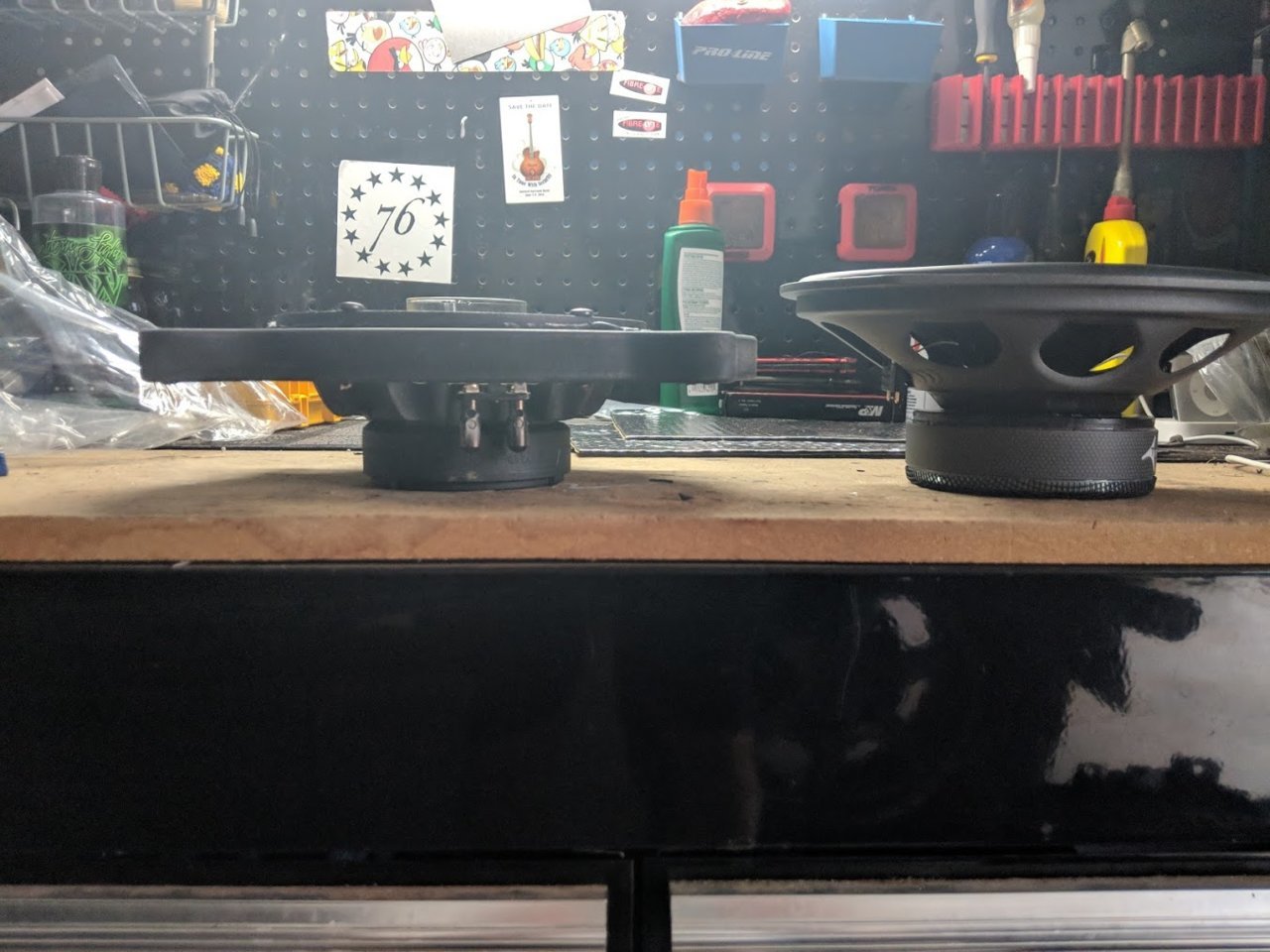

    Keep in mind, I have not installed the tweeters yet. Also, these need to be powered. Here is a comparison of the speakers I removed to the Morels:

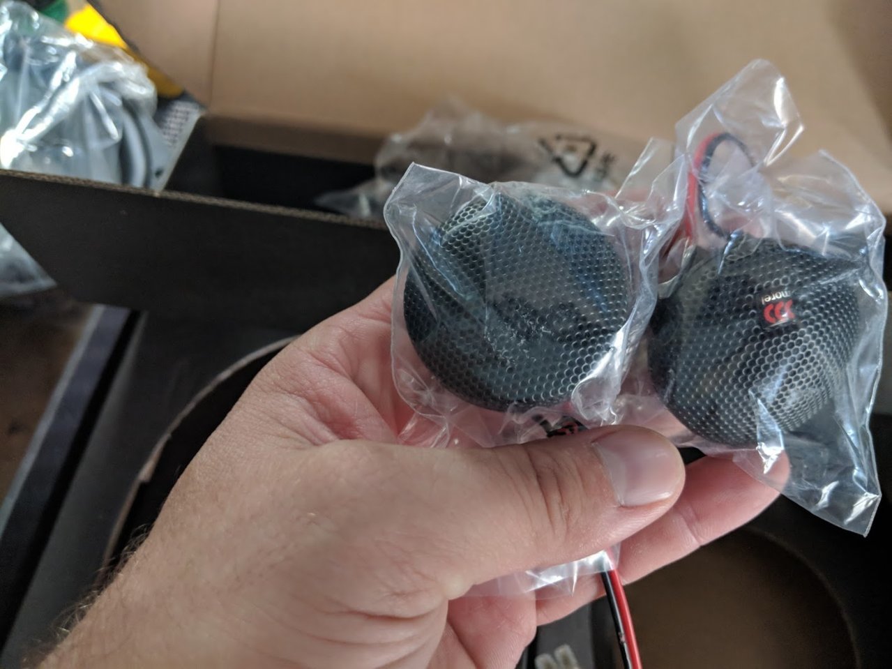

    Tweeters:

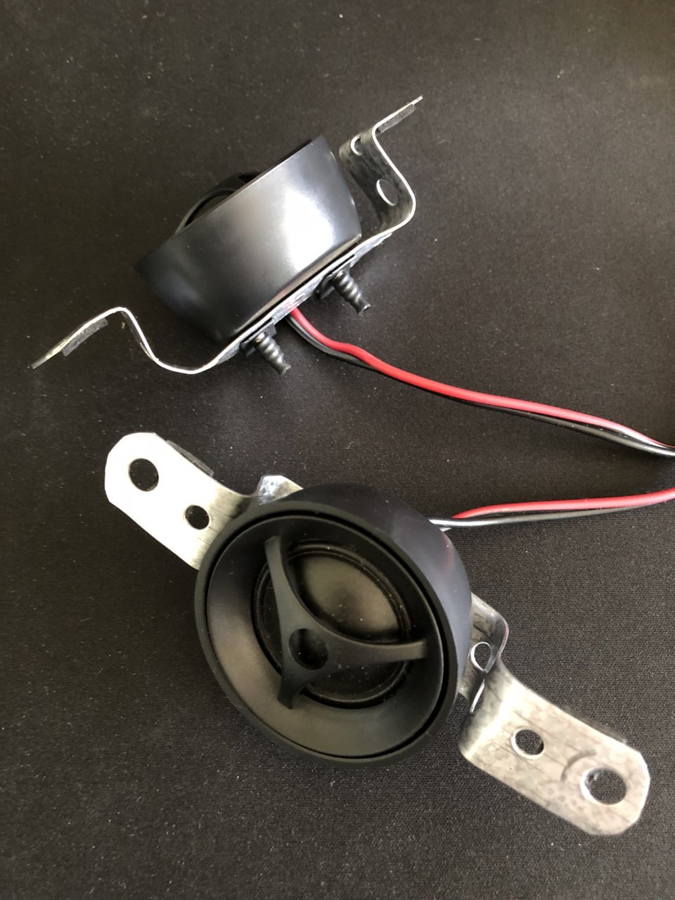

    As a temporary install for the tweeters you can pick up some pipe straps from your local hardware store:
    I used #8x1/2” sheet metal screws through the strap and included screw clips to secure the tweeters to the straps.

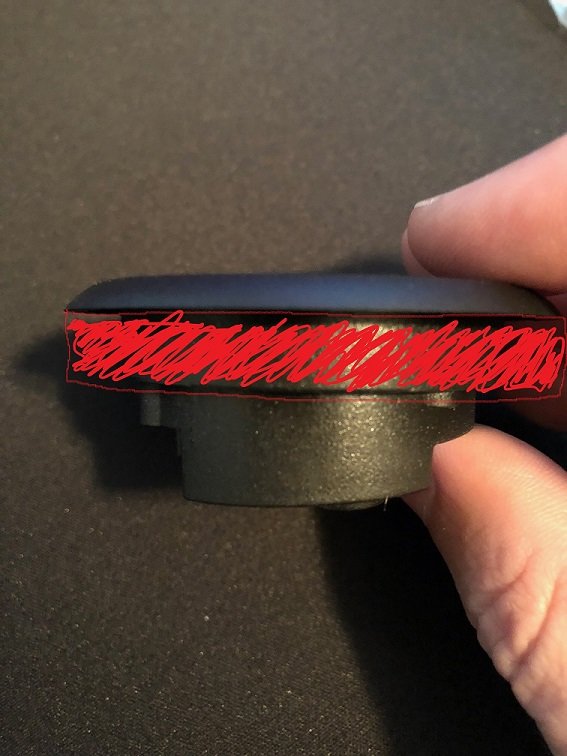

    Hey Ron,
    Did you come up with a strategy to mount your tweeters? I bit the bullet and ordered the tempo 6x9 components ...
    I have thought about using the smaller tweeter cup to surface mount it to the sail panels, or use the round flush-mount ring and create a small ring spacer to offset the needed space behind the sail. Not sure how it would look but that may be something that could be more easily 3d printed :)

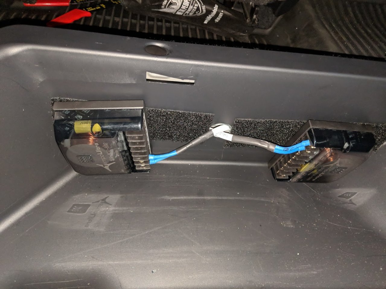

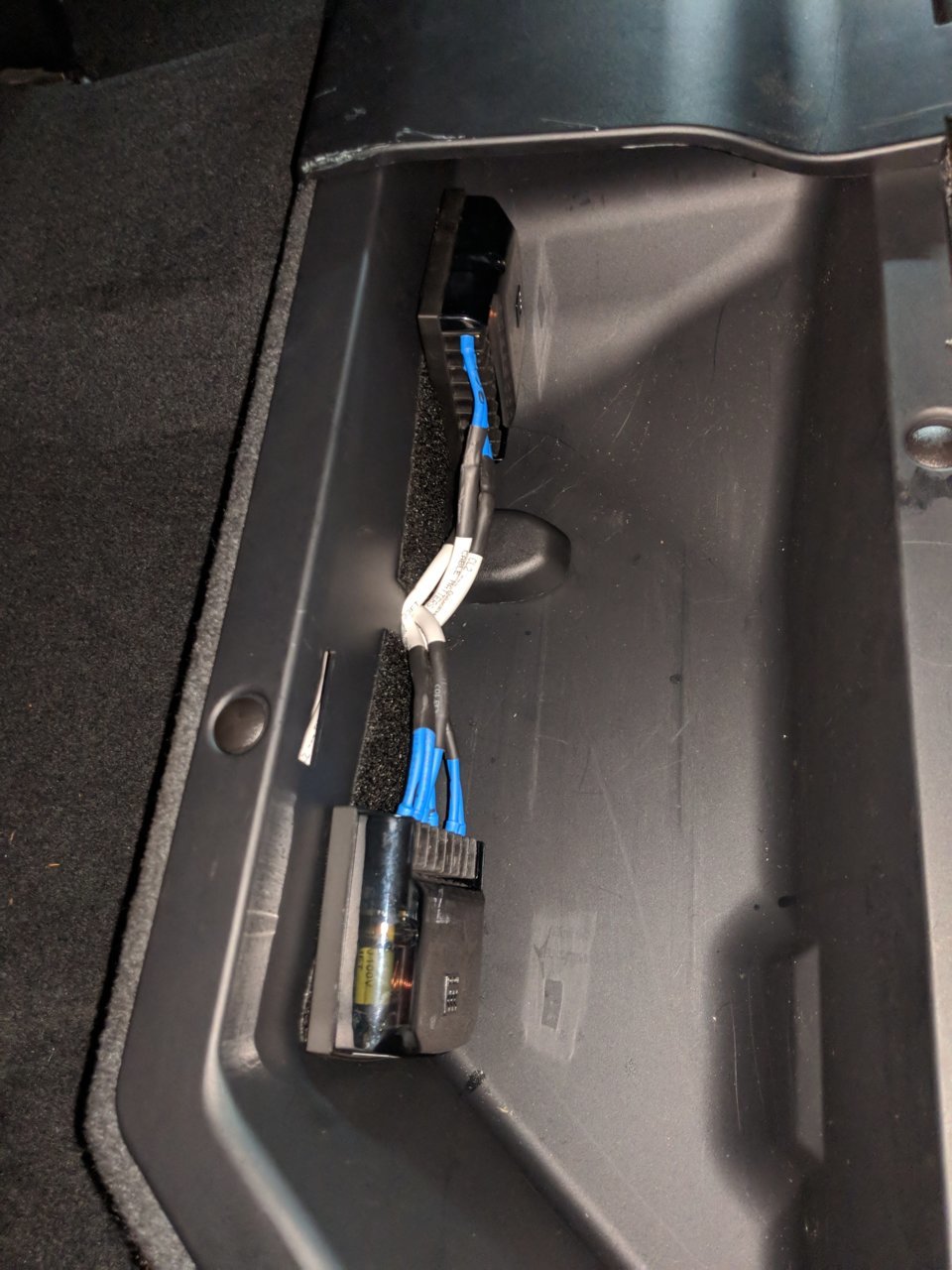

    I'm putting the crossovers in the driver side under rear seat storage compartment.
    They're not big crossovers by any stretch, but I really don't want to put them in the doors, and want to have easy access to them to adjust the attenuation of the tweeters.

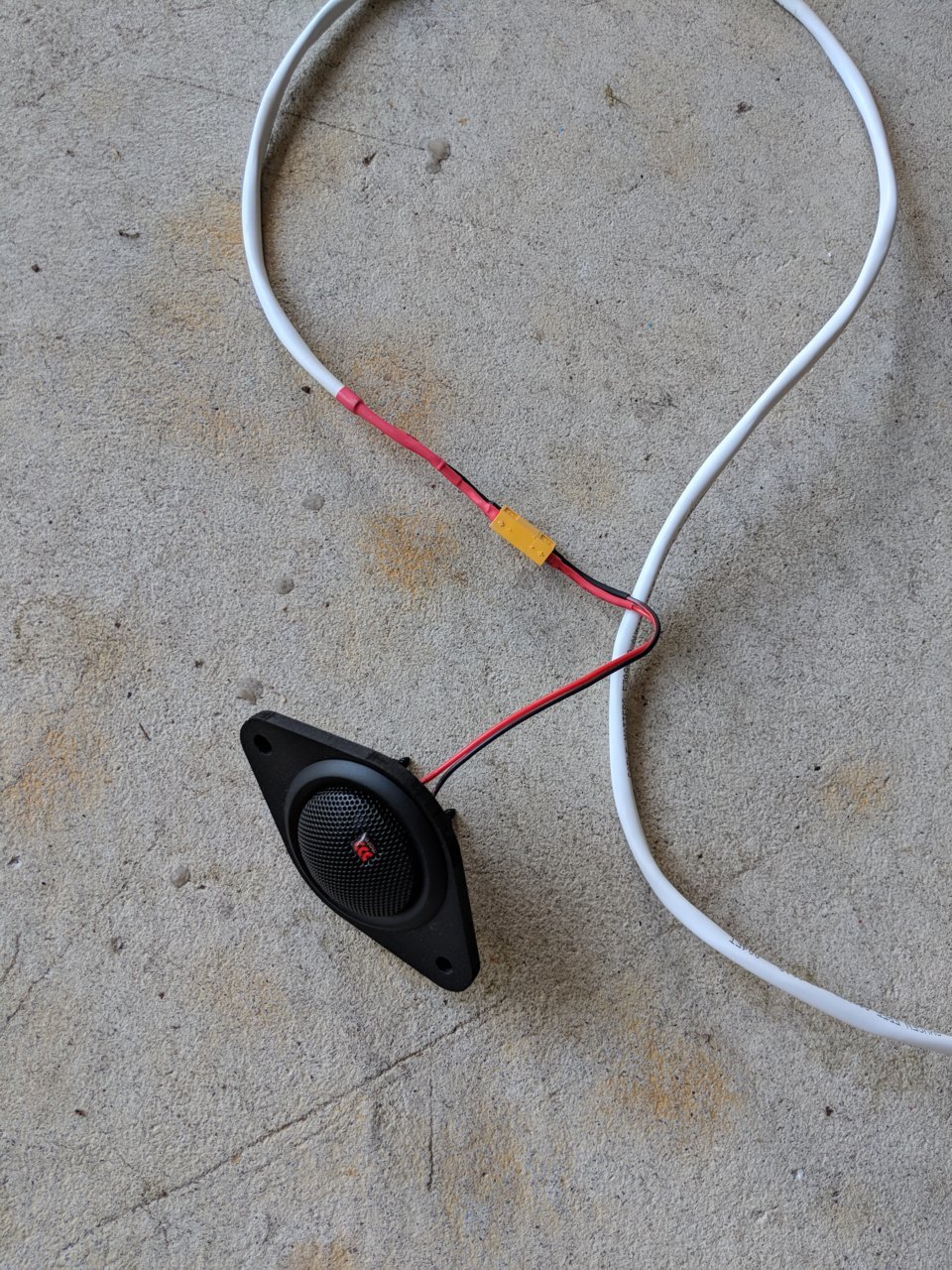

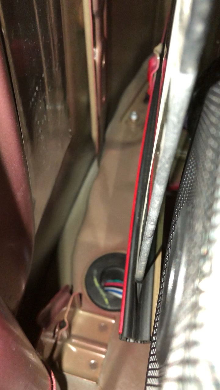

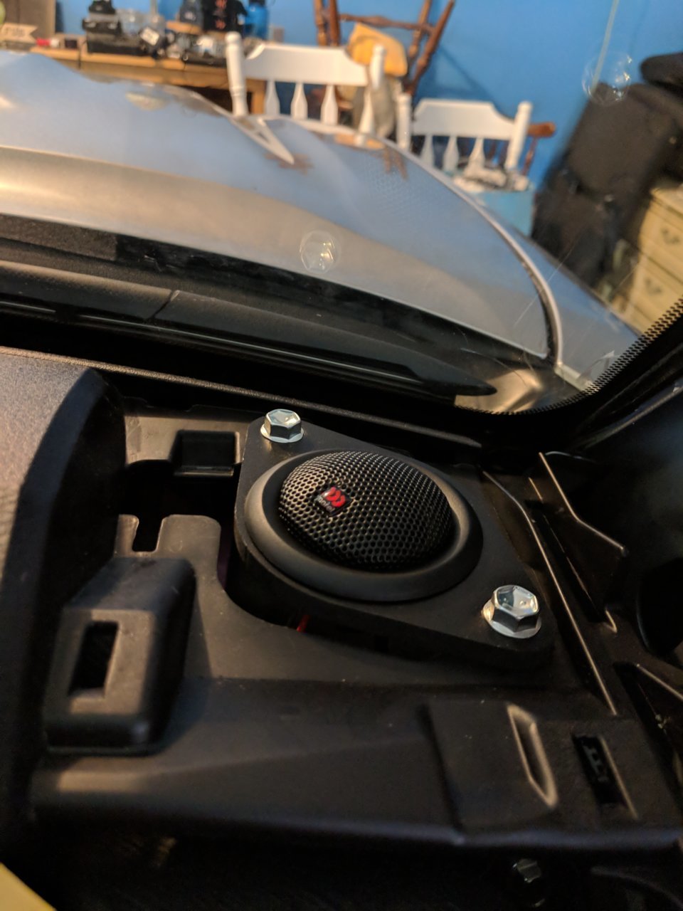

    And we are all installed. The doors were WAAAAY easier than I thought they would be. Everything is on the proper crossovers, everything is working, and everything is louder than I really need it to be, which is not a bad thing.
    I'm probably going to put Tempo Ultra Integra coaxials in the back and get rid of the kickers.
    IMG_20180829_162323.jpg IMG_20180829_162330.jpg IMG_20180829_172648.jpg IMG_20180829_172651.jpg IMG_20180829_172637.jpg IMG_20180829_180906.jpg IMG_20180829_202026.jpg

    I'm assuming you ran a new pair of speaker wires from the components in each door to the crossover in the storage compartment? Essentially bypassing the stock speaker wiring...

    Crap..i just read your link... appears you did run new wires through the door jam. Thanks!

    Yep. Brand new wiring for the dash and front doors. To the crossover, crossovers to the amp.
