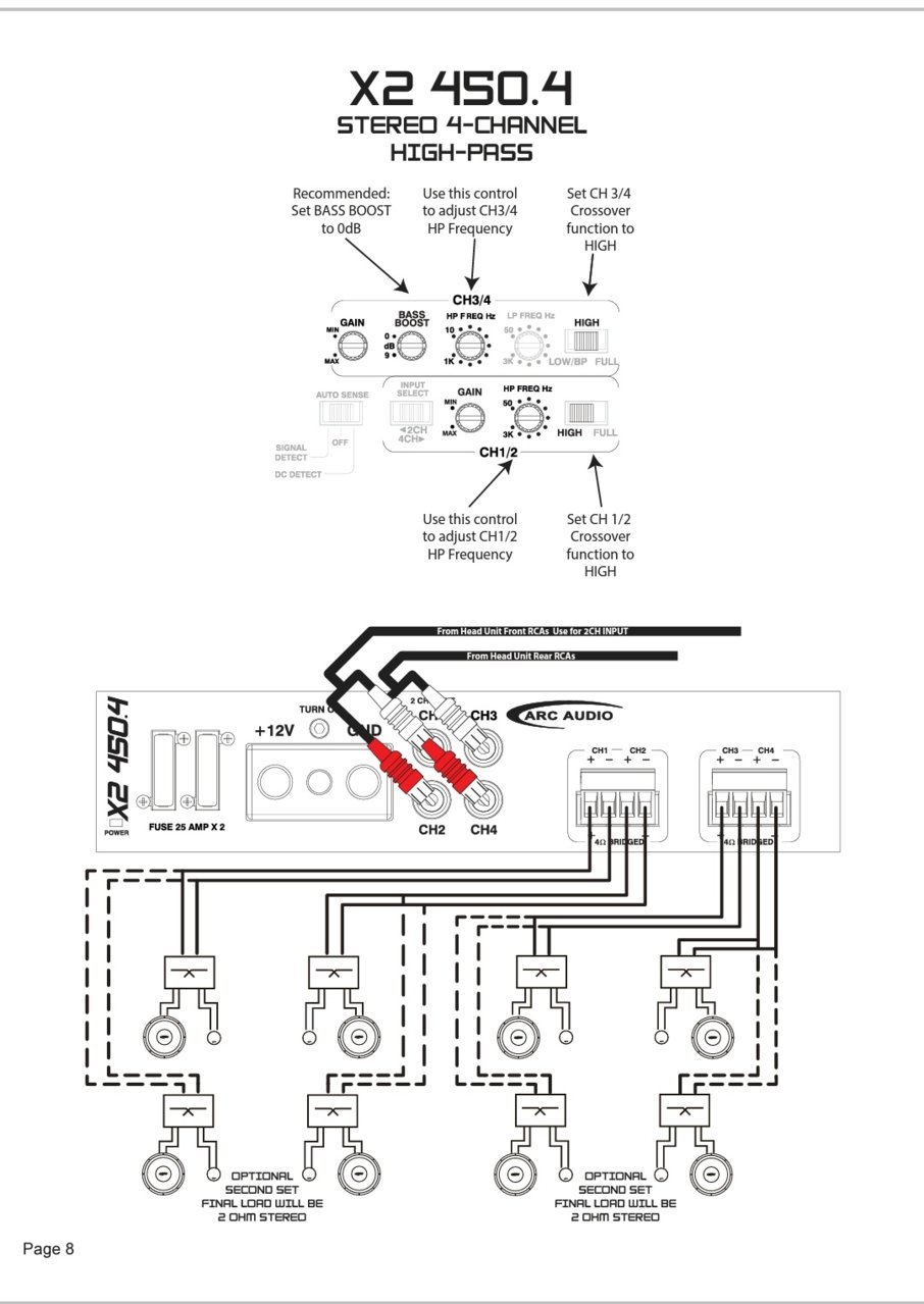

    Hoping I could get some assistance here. Long story short, I had a local audio shop install the Morel Tempo Ultra 692s in my truck this week. They are running on an Arc Audio x2 450.4 amp. I have them running on the passive crossovers as well. The shop configured the amp to run 4 channel stereo high pass. They also told me the kept the gain on the low side. Their explanation was that it was to help break in the speakers. I had a sub installed as well, however it sounds decent. Due to the sub filling in most of the lows I was unaware that the result of the amp tuning (my assumption) is that I have absolutely no mids/bass from the component woofers. I'm nervous to try to tweak anything on the amp as I have very little experience with car audio. Another thing of note is that I have an access cab with the crappy headliner speakers that I pointed out to the install tech prior to installation and yet they still ran those to the rear channel inputs on the amp. I intend on reaching back out to the shop but work is consuming most my time right now. My thought is to switch the front channel from 'high' to 'full' and let the passive crossover do its job. I just don't want to make any expensive mistakes.
    Thought I'd post here to see how you guys are/were running your amps to power these things. Screenshot_20220205-191920.jpg

    Don’t touch the gain. I would hope they gave it back to you with that set. If you’re unsure how to tune that, take it back.
    As well, leave the High Pass Filter on. That will prevent any frequencies that the sub should play from going to speakers that shouldn’t try.
    What you can check is the Filter Frequency. Would probably be set to 80Hz. If it’s too high, that would show up with what you’re describing. Don’t set it below 80Hz, to protect the Morels’.
