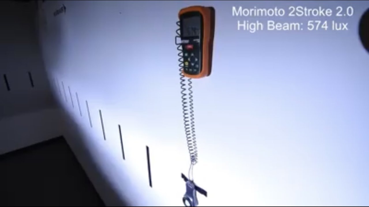

    Proud to announce the arrival of these bulbs in stock and to our many dealers worldwide.
    - The best output of an LED bulb, based on proper optical design and hotspot intensity
    - No additional glare over stock
    - Fits H11, H9, and H8 sockets without modification
    - Smallest base design
    - Ultra reliable PCB / active cooling design
    https://www.theretrofitsource.com/h11-led-headlight-bulbs-morimoto-2stroke.html

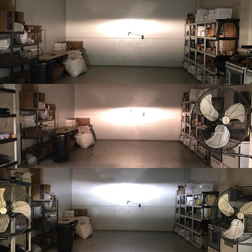

    Prefer videos?
    2Stroke 2.0 vs 2Stroke 1.0 vs Diode Dynamics SL1
    2Stroke 2.0 vs stock Tacoma highs/lows
    Thoughts?

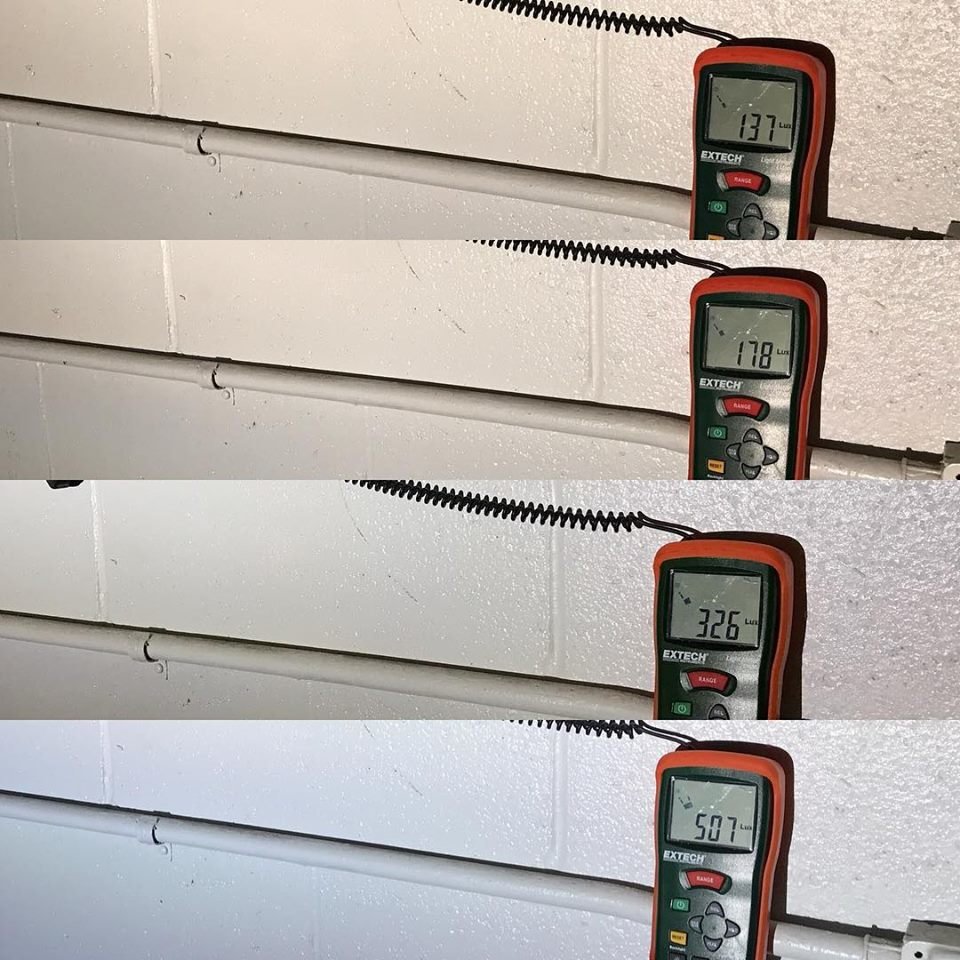

    The second video in the OP shows exactly the output of a 2016+ Tacoma with 2Stroke in both low and high beams. It's pretty solid!

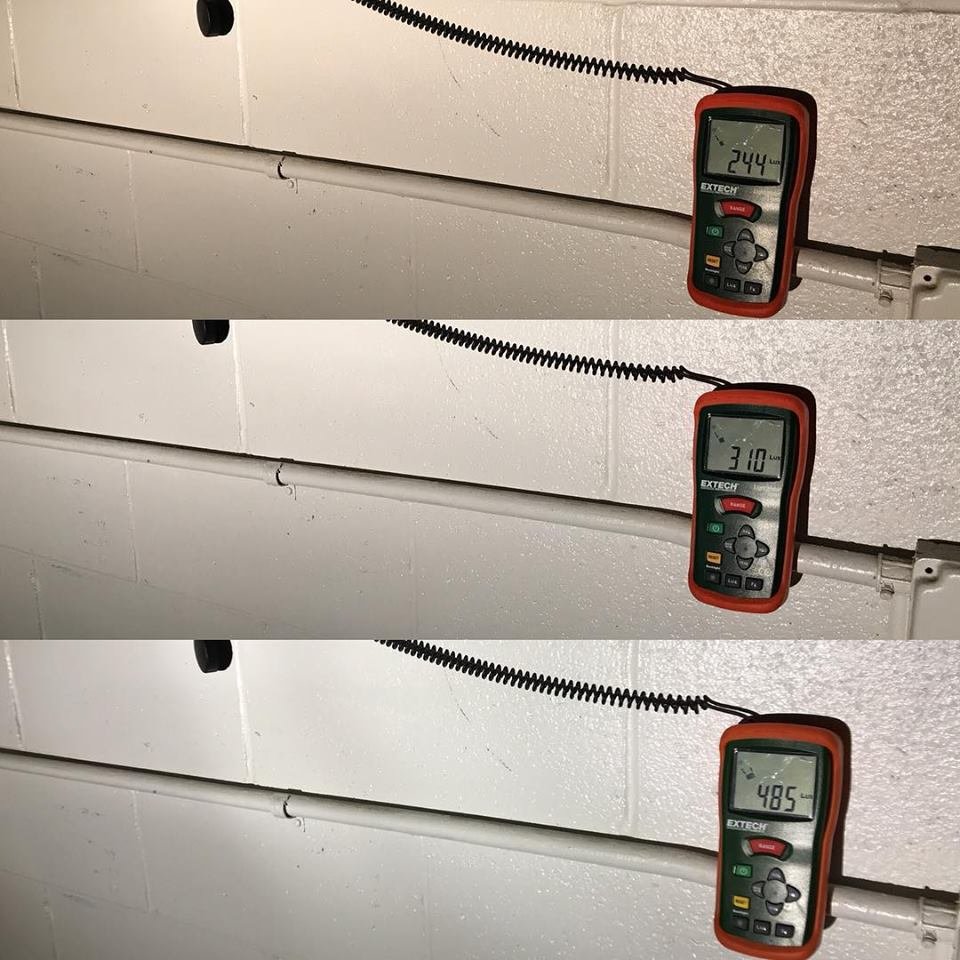

    Another shot from LightWerkz doing independent testing:
    Stock H11
    H9 Conversion (Halogen)
    2Stroke 2.0
    35w HID
    42451815_1982080721815434_49482775845981_a86b2e464f0c67772569d9623d2b3007e8965ad8.jpg
    12TRDTacoma and ChadsPride like this.

    That's actually a 4runner projector, but close enough. Still doesnt touch a legit HID setup!

    The second video above is a 2016+ Tacoma headlight. The LightWerkz comparison is the 4Runner side entry.
    Correct, they're not as good as HID, nor as involved to install. :)

    Opt7x is a dated LED. The diodes do not try to mimic a halogen filament other than rough approximate position. The result will be loss of beam pattern, loss of hot spot, and loss of distance projection, aka throw.
    Fortunately the 2Stroke 2.0 H11 LED diodes are not aligned in the orientation shown in the OP, as that would be very poor for an H11. Clicking through the link they are appropriately aligned in parallel with the length of the bulb rather than perpendicular to it and you can see the diodes more closely resemble a filament shape than the Opt7s which will improve performance.
    @TRSAndrew the test results in the OP video and the above tests performed by LightWerkz are not accurate, they are both using an Extech LT300 which is a standard light meter, which while it is a nice meter, it is unable to accurately measure LED light and will produce inaccurate results for LEDs. To measure LED light you need to use an LED calibrated meter like the Extech LT40 or Extech LT45, other LED specific calibrated equipment, or higher end full spectrum equipment. You can check it out on Extech's site.
    The Extech LT300 is good for measuring incandescent light though, but the numbers seem off in these readings, an H9 should be 65-70% higher output than an standard H11, so it seems odd that it is only coming in at 30% higher. They could be using a high efficacy H11 bulb, or the light sensor may not be appropriately positioned, or the side-entry TR4 projector could just be that bad.
    It is worth noting that the 4Runner side entry projector is more favorable for the bi-directional LED design, as the LEDs are aligned in the direction of projection and directly back into the projector bowl to reflect forward, vs the rear entry Tacoma projectors where the LEDs are facing perpendicular to the direction of light projection. The perpendicular bi-directional light source does not illuminate the rear upper portion of the housing like an omni-directional light, which helps with hot spot and distance projection.

    We use the same meter here. Admittedly it's not designed to be the end-all technical definition of what a certain bulb is capable of, however it is perfect for relative comparisons.
    Since we're using the same meter at the same location, the same distance, the same environment, and using the same housing, it can still be confirmed that one is better than another given all other things are constant. Agreed?

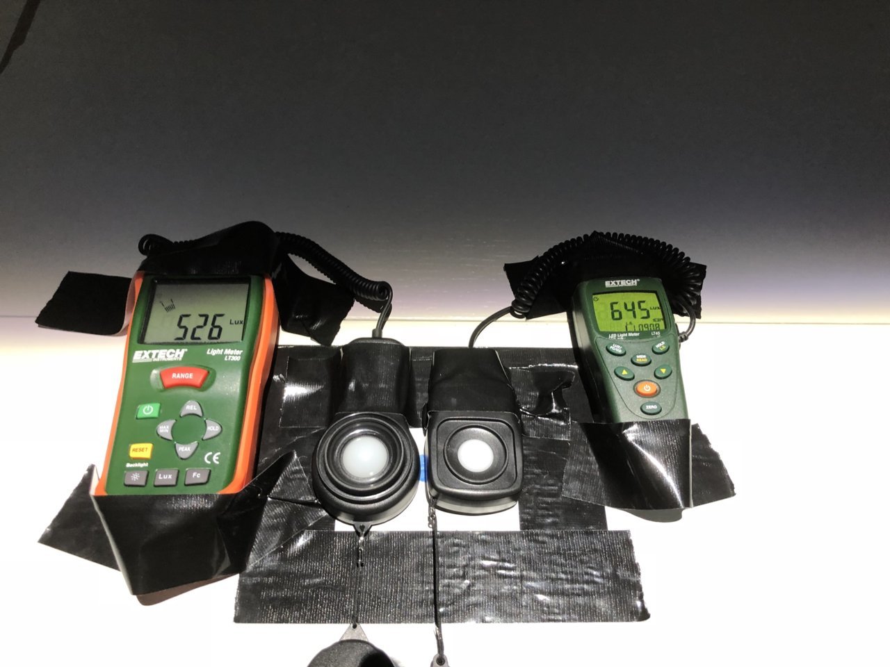

    While it may seem that all things are constant, in the view of the meter they are not. The standard lux meter operates on the assumption the light spectrum slope is constant between sources, because all incandescent lights have almost identical relative linear slopes. But the spectrums are completely different between LED and incandescent. A standard lux meter will sample a small number of points in the light spectrum and apply a spectral sensitivity curve fit on the assumption that the spectrum is a linear incandescent slope and use this to calculate total lux. But the LED light spectrum is very different potentially throwing off this calculation depending on where the sampling points are measured in the spectrum, and what the LED spectrum curve looks like. Margin of error might be small or it might be significant, but the point of taking a measurement is to have accurate credible data.
    Measurements I've taken using a digital spectrometer to show spectrum differences:
    (Anything past 700nm is just IR and not factored in lux.)
    A meter like the Extech LT45 allows you to calibrate the meter based on the light source and LED color for accuracy. I use an Extech standard meter, the Extech LT45 and a full digital spectrometer, the later having an advantage of not having to set anything or worry about light source composition because it measures the full spectrum, I'm not sure what I would measure HID with otherwise.
    Anyway, apologizes for the thread derail. But as a lighting company who specializes in LEDs, I would recommend you invest in an LED meter for accurate measurements, especially in product demos. :)

    In the grand scheme, it's a perfectly presentable comparison.

    In the grand scheme you are off by roughly 22.5%, which is a very large margin of error. If you take my advice, this could actually help you.
    Measuring an LED headlight in a 3rd Gen projector:
    Extech LT300 (standard meter) vs Extech LT45 (LED calibrated meter)

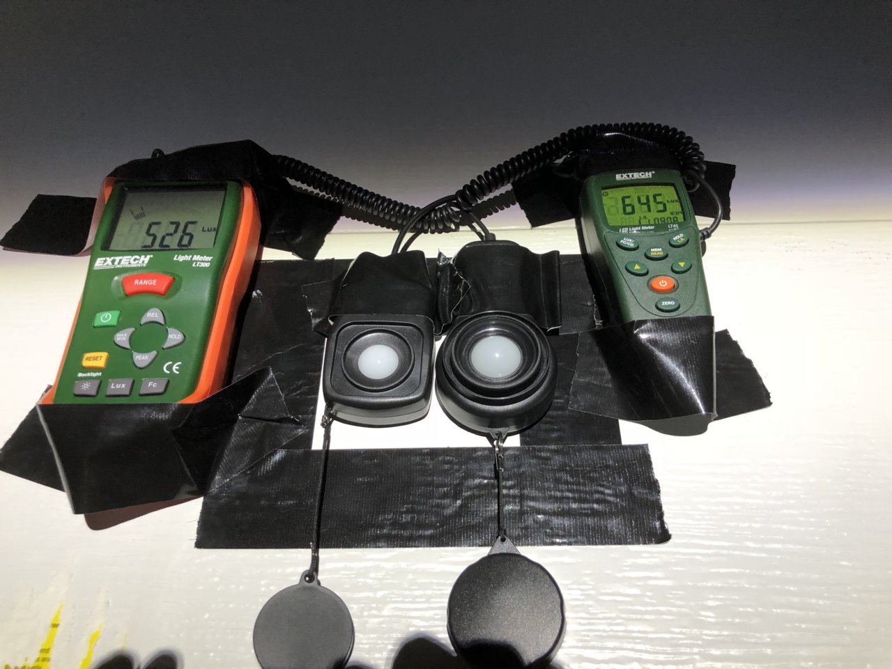

    And just to demonstrate it isn't the placement of the photo detector, I swapped their position:

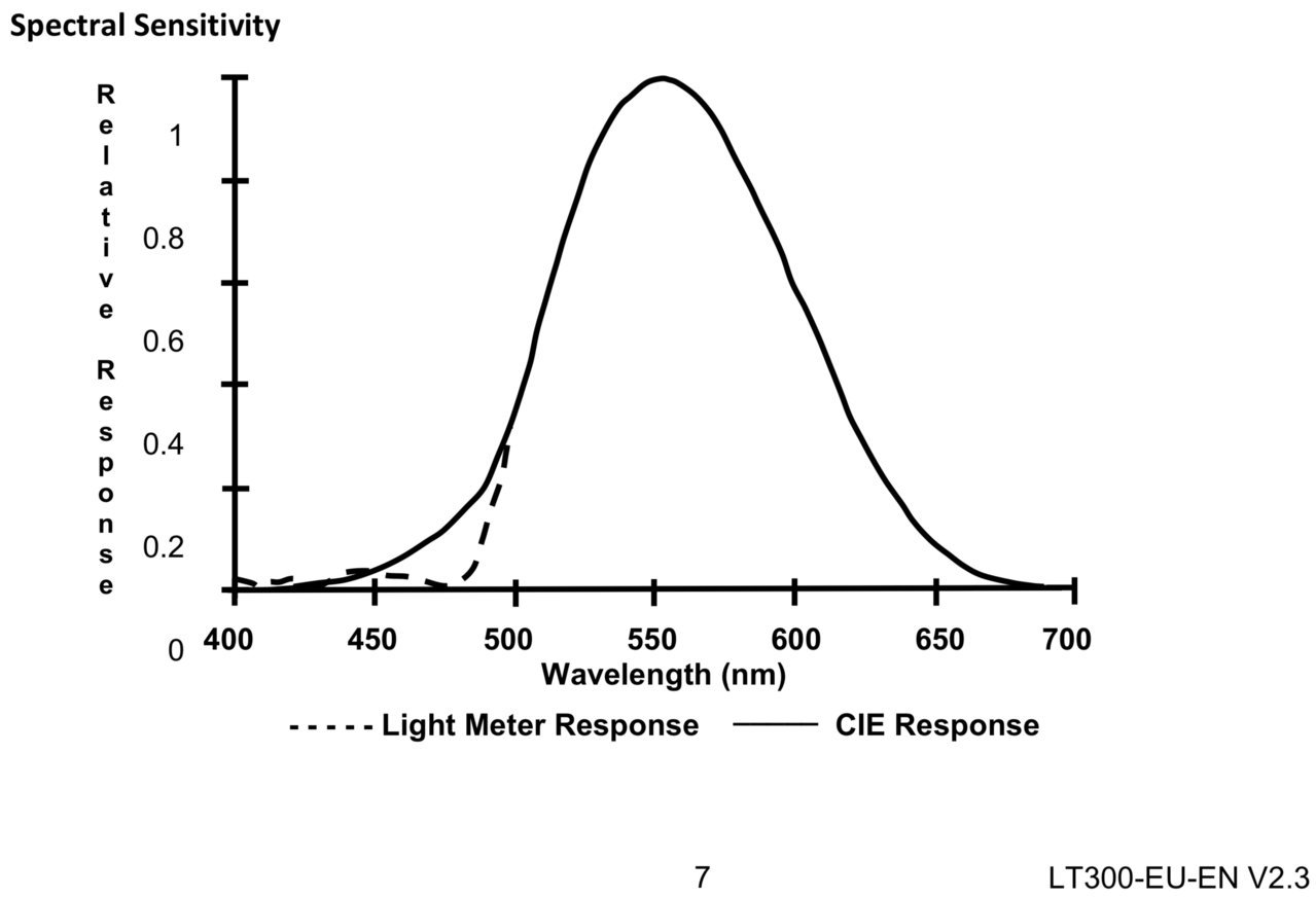

    You can see the spectral sensitivity spec chart from Extech for the LT300 below, and see that it the meter response is deficient in the short wavelength spectrum. If you compare that deficiency to the spectrum profile of your Morimoto XB fogs I posted earlier, you can see that you are missing out on including a non-trivial amount of light output in the measurement from the short wavelength high amplitude spike. The LT300 is calibrated to light sources of 2800k as it is for incandescent lights, if you are measuring a source significantly outside of that color temperature, it will be inaccurate.
    Use this information for your benefit or disregard it altogether, but it is important to use the right lighting tool for accurate data which I would expect of a lighting company and their independent testers.
