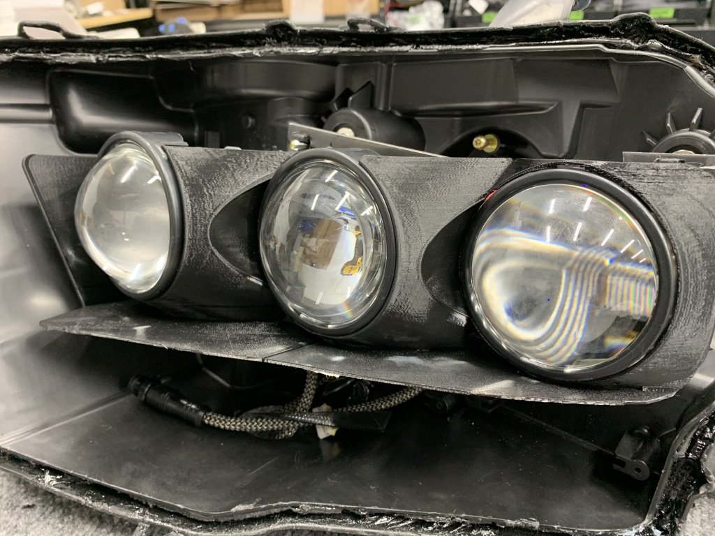

    I've used them all. Here is how I would rank them
    Tuned RX350
    5.0
    Mled
    4.0
    Bi-lens LED
    mini's (h11, d2s, etc)
    I choose the Mleds because of the simplicity(less parts) and there was limited space in the quad reto.

    Exactly. And having 3 will make up for that:D
    Now when it's mentioned "LOWER" performance, it's not super drastic. All lighting has came a long way so it's splitting hairs.

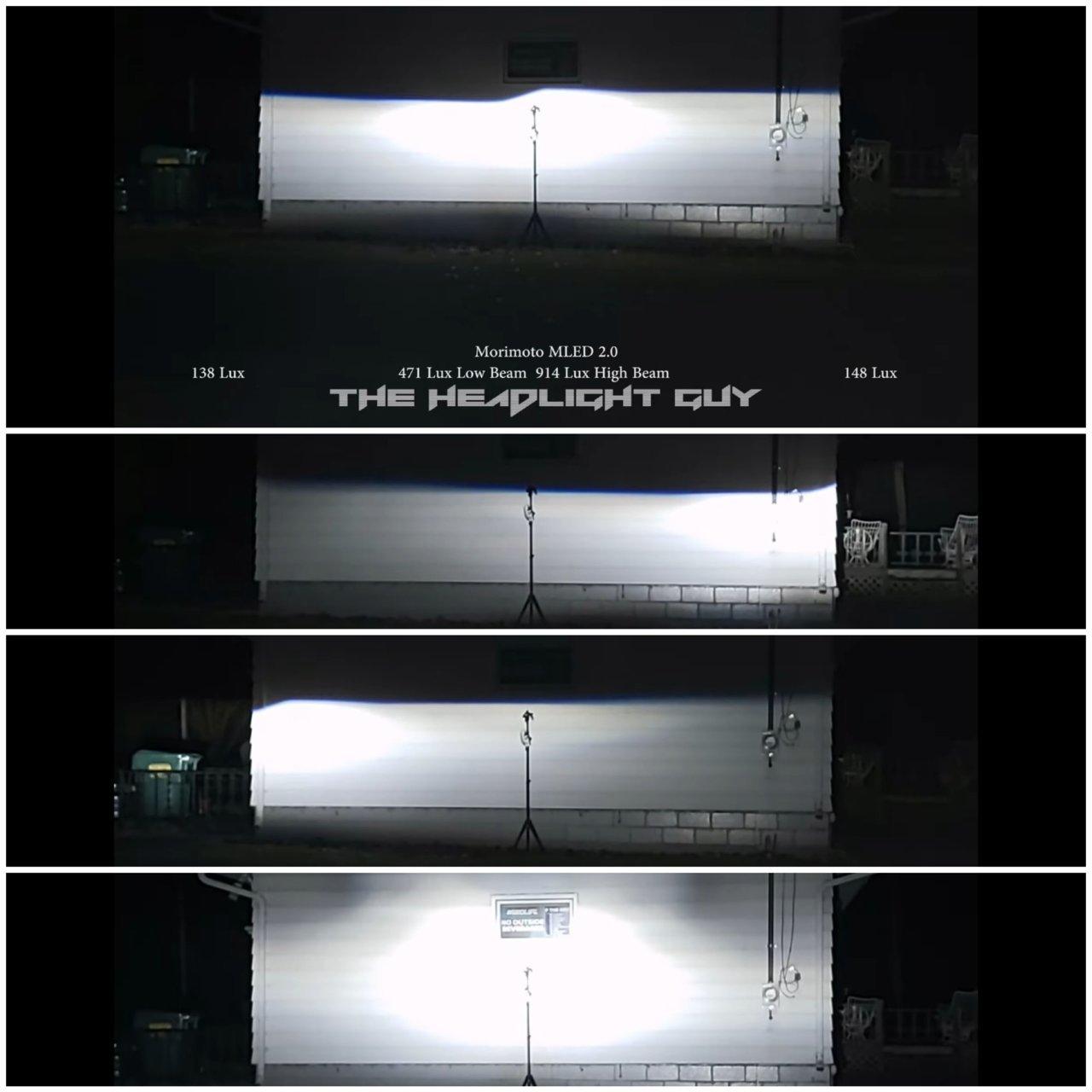

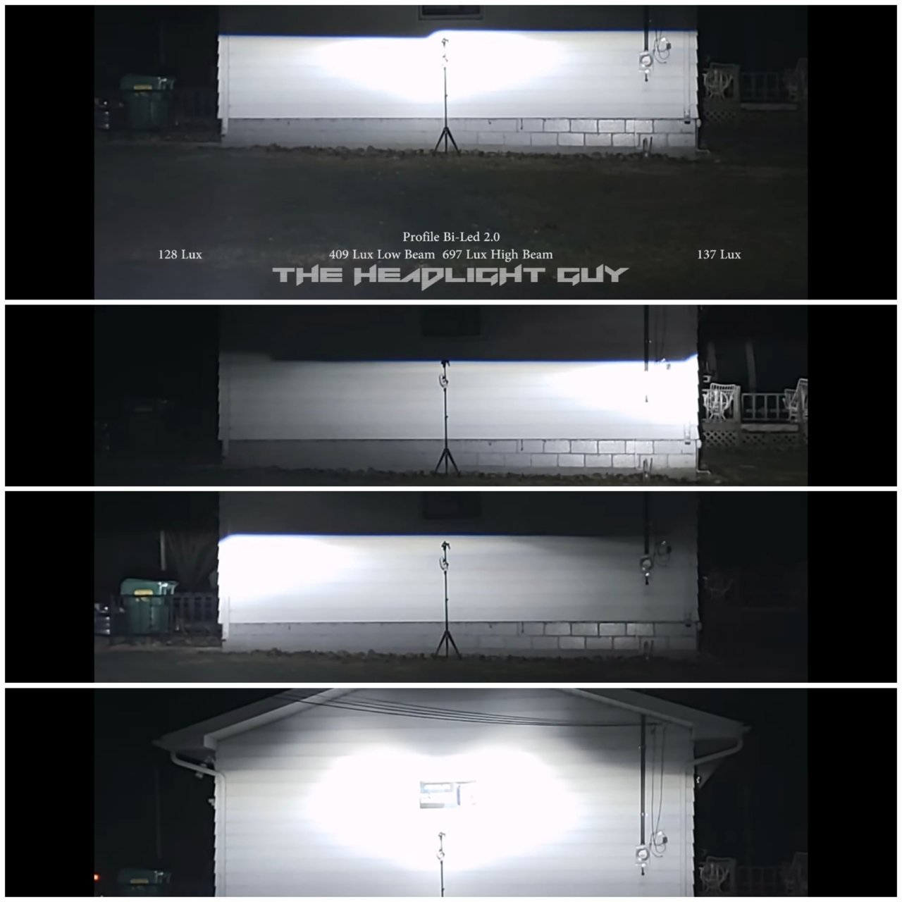

    https://youtu.be/eDc5htdy8rk
    The headlight guy on youtube did a nice comparison of all the popular projectors. I have decided to go with an LED one but still up in the air between morimoto or profile. Morimoto step is too drastic for me still. At distance it gets pretty significant but their light output numbers are better. So it's a toss up. My new set has been delayed for some time now due to being laid off for so long. Just started a new job and now I'll be spending the next few months playing catch-up on bills. By the time I'm ready there may be more options out there lol my goal is to frankenstein these headlights into something really unique. I would like to rip everything out and replace. Goal is an amber strip for drl and turn signal function. Upgrade the projector that's in it already for the Morimoto or profile projector. Take out the high beam bowl and put in another projector or pod that's a dedicated high beam (probably Morimoto mini hb projector) and delete the turn signal reflector and put in those small rigid sr pods for another aux light. But again who knows when that will be. Almost $900 in parts alone lol and my truck could definitely use a rear high clearance bumper before new lighting.

    I ended up going with the Morimoto MLED 2.0 and they completely blow my old Morimoto D2S 4.0 projectors out of the water in terms of brightness, the casted light in the foreground, and projection of light in the distance. I could not believe the difference. The only thing that's annoying is that I'm running a stiff 700lbs spring so it's kind of distracting to see the edges of the cutoff bouncing around in the distance or off of traffic signs.
