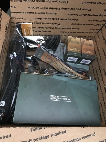

    Got a box of goodies yesterday at The Retrofit Source. They're local, so I stopped in and brought a box home. Thanks @TRSJimmy for the help. Now I just need a free afternoon to get everything installed.
    Went with the XB fogs and the 35w, 5500k HID system. The 5500 bulb is supposed to be a close match to the light color of the Morimoto XB fogs.
