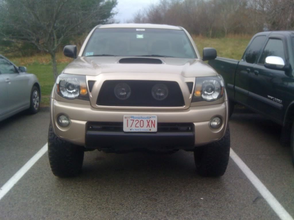

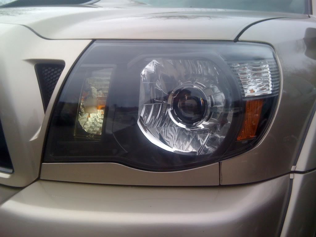

    here is my setup
    morimoto mini ds2 with 6000k morimoto hid
    install was easy just took my time and used 2 sets of lights to make a perfect set,

    i got the last set of gatlings from nate last week, they gatling supplier is not longer making these, so this set was from the discount pile, they had a couple issues, but you will really have to look to see. my shrouds did not click in they were big, so that could be the other problem, so i mounted them as far back, so it worked fine for me, i epoxied them and let them sit, they cured then i put everything back together once they sealed up, then baked them one more time to gas them off and they are all done and look awesome, i am so glad i did this mod.
    now here is the question, between steps on the projector, what is a good measurement?
    also i have 35w ballasts in right now, but have 55w ones too, should i go with the 55w or the 35w?

    i think i am set up pretty good, i will take a pic tonight and post it for so input. the question i also have is how high should i be set up, i have a 3 inch lift with 33's i want to make sure i am in a good area. after i take some pics tonight i will get some measurements.

    here is a crappy phone pic
