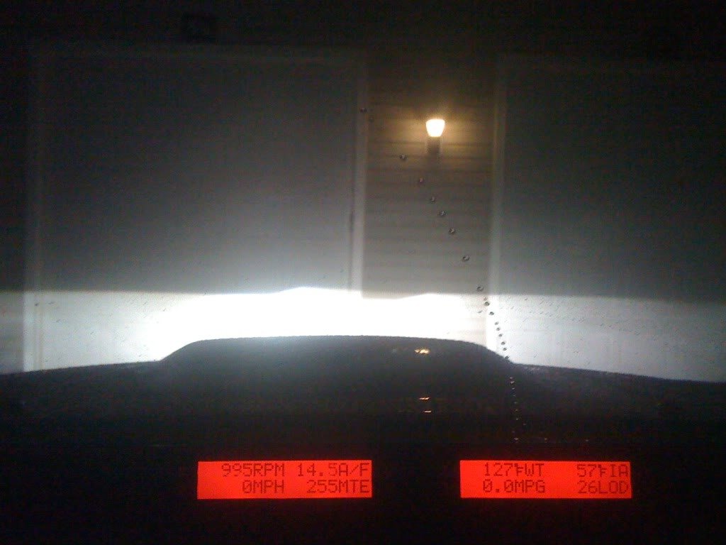

    Okay, I finally got some pictures done. See my gallery. I did the BHLM and the Morimoto mini's at the same. Also put in a color matched grill, then later a grill craft.
    I'll do a DIY post sometime soon, don't have time today.

    hey mark,
    awesome job, it looks killer all blacked out like that on a black truck,
    the driverside light needs to be turn counter clockwise, and you are all set bud, it looks sick

    Looks good man. From the output picks, looks like you need to adjust the passenger side down.

    Yep, I did, had a little rotation problem and fix it as best I could without taking the things apart again, and then turned the passenger side down a bit.
