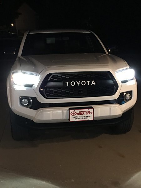

    Good question. The Morimoto 5500k is spot on once it warms up. I originally had the 4500k bulbs but the 5500k is a better match. The Morimoto bulbs will work with the XD harness.

  5. Jun 5, 2017 at 2:16 PM
    #85
    toyguyic
    toyguyic Well-Known Member
    Apr 12, 2017
    #216029
    241
    kdog
    Iowa City, IA
    2017 Tacoma Limited White
    TRD Pro Grill, Lo Pro QT, Morimoto HID
    SilverII and rnicholls like this.
