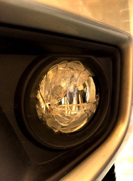

    Took a rock through my stock fogs.
    Installed the XB's. Love 'em. Then installed my Retro's.
