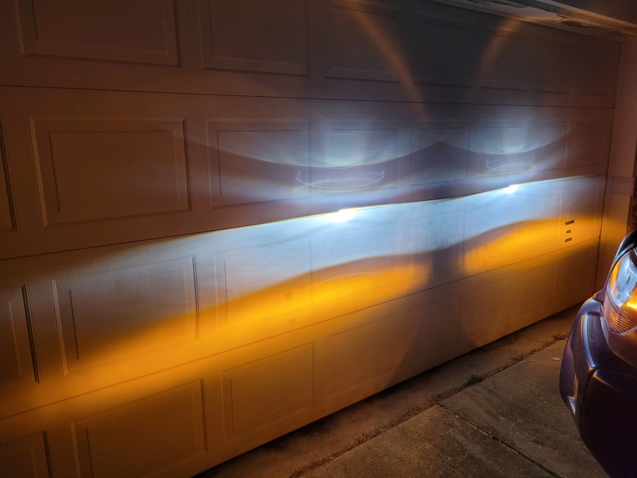

    Close up view of the output along with my KC G4 fogs. Seems mine were aimed quite a bit off to the left, got them partially adjusted, but still need to bring the driver side further back to the right. Getting to that horizontal adjustment screw is a pain.

    Note just how pathetically bad the uplight calibration is. Those vertical uplight boxes should sit seamlessly right ontop your low beam hot spots, just like OEM. But that separation at only a few feet from the wall easily tells the lights have beyond horrible manufacturing tolerances or are designed by a company that has no clue what they are doing. Unsure if these lights are produced by Morimoto's usual headlight supplier company of CoPlus or if they are another supplier, since Morimoto doesn't actually design or manufacture any products and just resells rebranded goods under their own brand name. But that wall shot should elude to serious design quality issues.

    Compared to this Youtube video: https://youtu.be/2qmjEhmmVI0?t=435
    The photo posted looks defective.

    I can tell you the uplight is incorrect on mine and that video is wildly inaccurate in overstating the performance claims, as typical for an HR video trying to sell product with misleading advertising.
