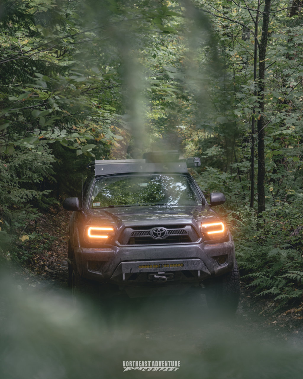

    605634BD-04F5-4648-858F-D5D3FCE5F4CD.jpg mine arrived today!!!! went with amber DRLs

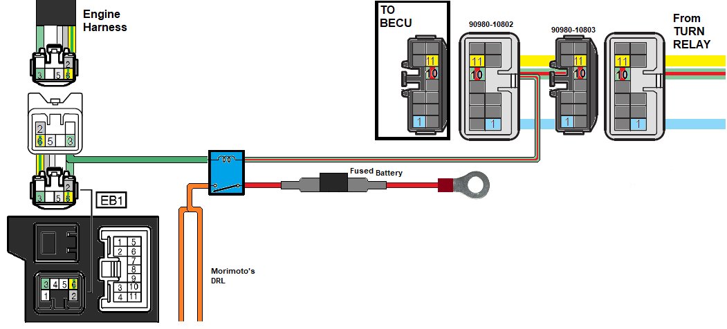

    Where are you guys tapping into for the DRL connection?

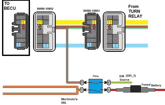

    So discovered today that the DRL on the Morimotos do not turn off even when you turn the selector on the headlight stick to off. Whilst I run with them on most of the time anyway it's not that big of a deal but I would imagine they should be a lot more plug and play than they are. Any way to rectify this so they actually operate on and off with the DRL switch?

    It would be a bit complicated.
    DRL's on a '13 are tied to the TURN signal circuit and Body ECU (turns them OFF when LOW beams are selected)
  11. Dec 15, 2021 at 9:42 PM
    #71
    caribe makaira
    caribe makaira Well-Known Member
    Feb 13, 2011
    #51121
    11,786
    Caribbean, Puerto Rico
    05 PreRunner TRD Offroad AutoTrans
    Hood Struts, My version Fogs always ON, Map & Overhead Light Mod,
    This be it:
    T-tap the DRL harness wire at the Body ECU. (connector 1M_slot 10. Green wire with red runner)
    Fixxxer likes this.
  12. Dec 16, 2021 at 9:08 AM
    #72
    Fixxxer
    Fixxxer Well-Known Member
    Nov 15, 2012
    #91236
    578
    Port Angeles
    '13 TRD Sport DCLB Super White
    ARB Front/Rear Air Lockers, Nitro Gear 4:88's, Hutchinson Rock Monsters, SOS Concepts Front Aluminium Bumper, UpTop Overland Alpha XL Roof Rack, ARB Snorkel, AVS Rainguards, Redline Hood Struts, Weathertech Mats, Flyzeye led's, MESO Molle Rack, Meso LED Dome Light, K&N Air Filter, UNI Filter Mod, Bosch Wiper Blades, Snugtop Sportster Reinforced Canopy, Viper 2-Way Remote Start, ARB Twin Compressor,
    I'll give that a try. I appreciate your input and help, thank you.

    Harness for a no cut (3m T-tap) install:
    Terminals are 2.3II/090 type

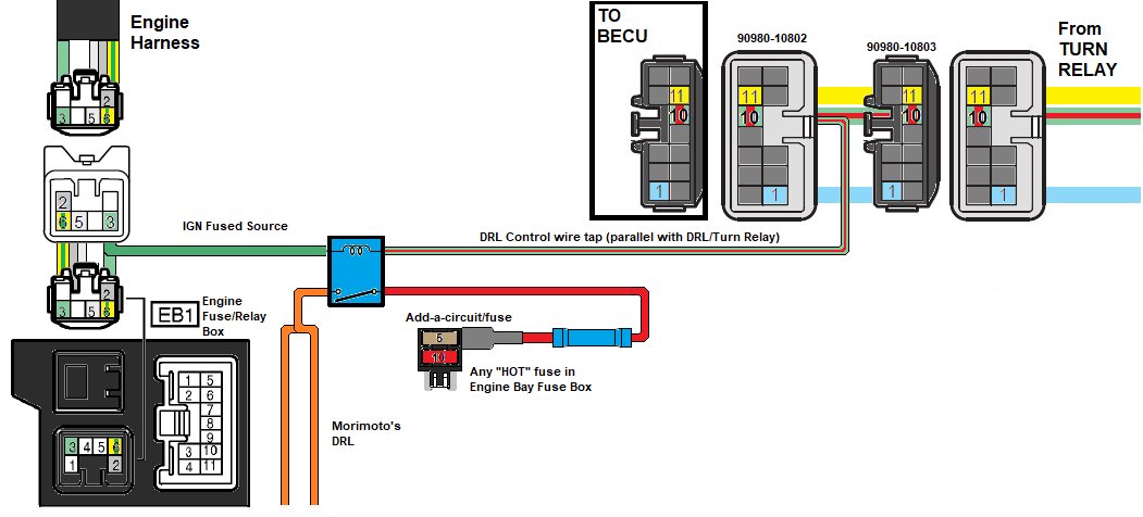

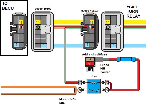

    Another version:
    Only one wire from cab to engine bay.
  15. Dec 16, 2021 at 8:36 PM
    #75
    caribe makaira
    Feb 13, 2011
    #51121
    11,786
    And the overbuilt version:
    or

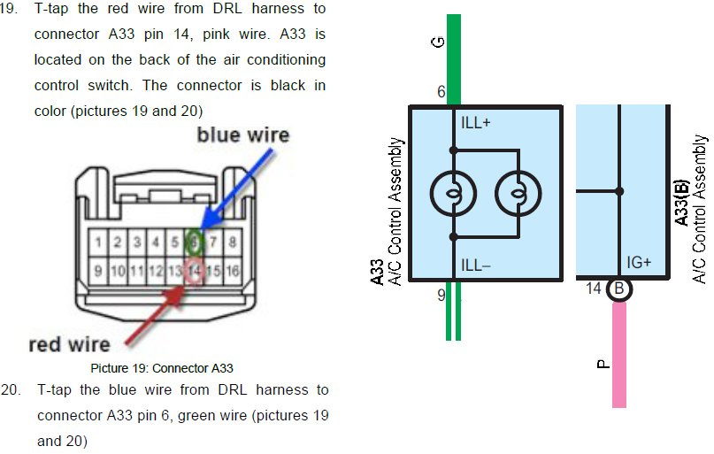

    Have you verified it's the headlights that make them dim? or the parking lights?

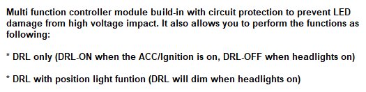

    Reading the install instructions, it shows they are tapped into the A33 (A/C connector) IGN and DASH (Parking circuit) illumination and not the low beams.
    It probably is a misnomer, the headlights part. It should read parking lights.
