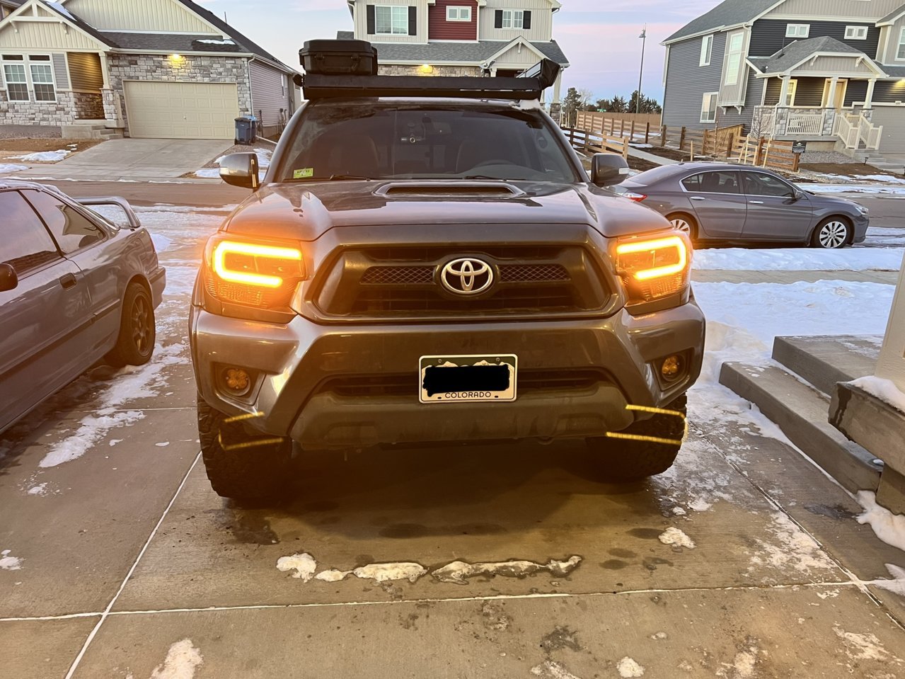

    Broke down and bought these. My lights were trash and I needed new ones. I know the OEM upgrade is better but these really updated the look of the truck.
    Install was simple. You’ll break a few plastic tabs probably but that’s to be expected. I tapped the wiper blades for my DTRLs and used a 5amp fuse. They send a 7.5 but they sent the wrong fuse tap type.
    Anyways, pics: The glare is exaggerated by my phone camera. There is some but it is minimal and after aiming them no one is flashing their brights at me.
    I also disabled the factory DTRL by cutting the green/red wire on the M1 harness. Didn’t like having 2 and the heat from the DTRLs on my factory lights melted the housing. Blinkers and parking lights still work.
