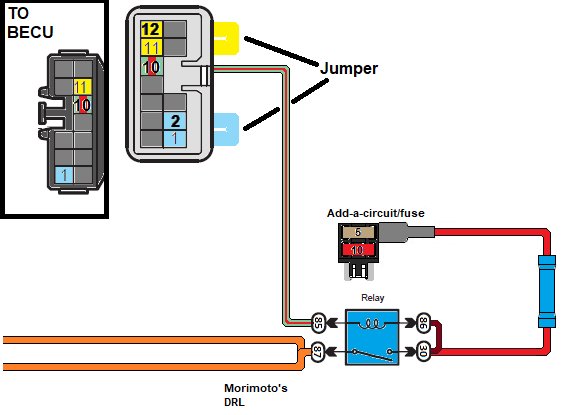

    @kimopods, If you need to have the front TURN signals NOT do their DRL function:

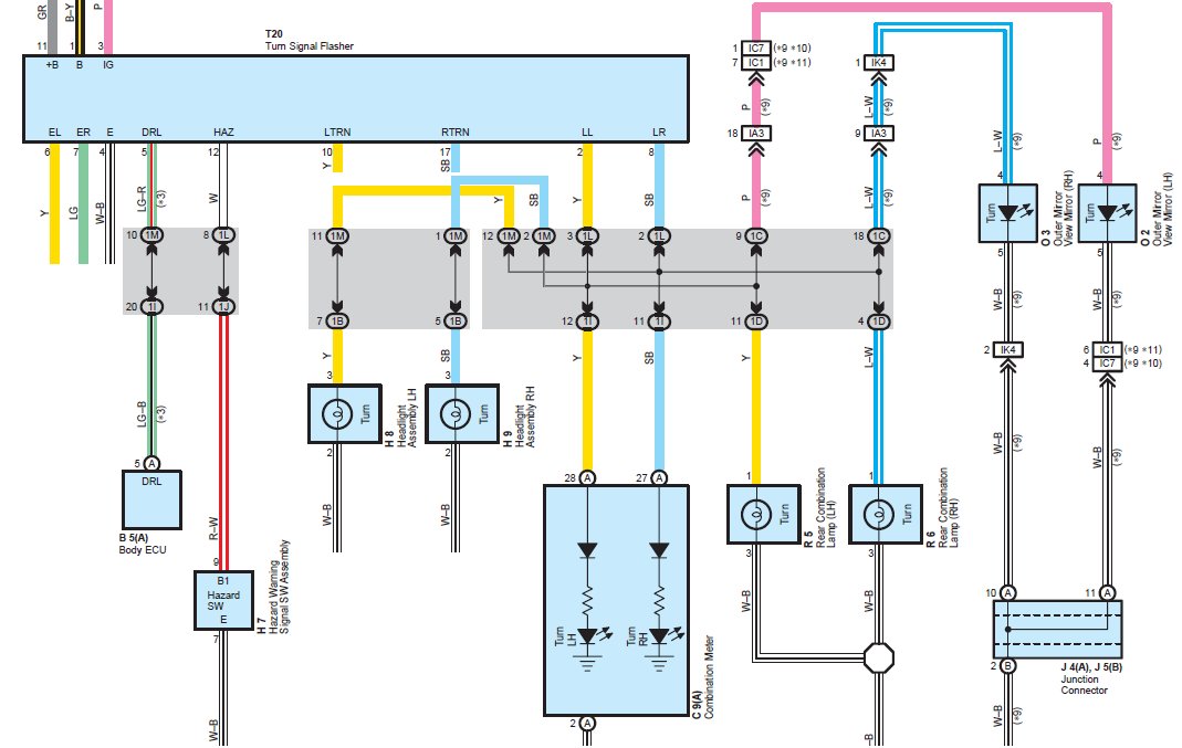

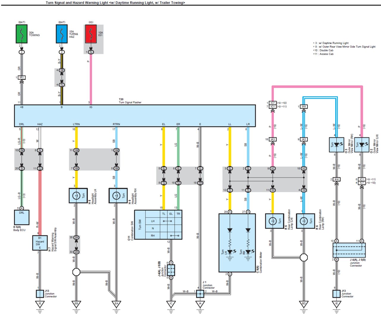

    Hmm I know this is the wiring diagram, but which part shows where you dont have to cut the green/red wire? I'm kinda an idiot, sorry!

    The part where the relay DRL input doesn't get to the front TURN lamps due to the jumpers bypassing the DRL signal from the relay.
    Or this:

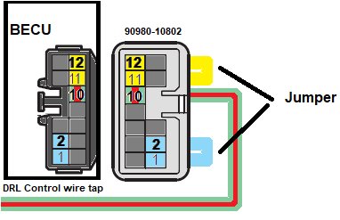

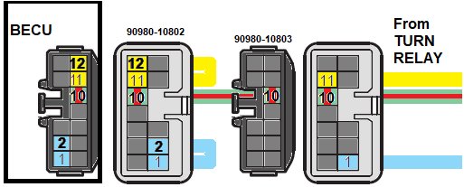

    @evolx, You'd go from this:
    to this (simplified view):

    Ah ok, good to know about the jumpers. If it bugs me enough I'll fix the cut I did last night :lalala:

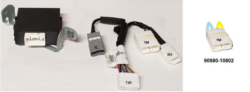

    1M from the harness would NOT be used.

    so i would just need a jumper for the 1m harness and do not cut the green with red tracer wire in slot 10?

    Correct. Some tape to secure the removed 1M.
    But you still require the added relay to activate the DRL's on the Morimoto's. That would be tied to pin 10 on 1M, like post #101.

    and the added relay would be wired as displayed in post #73?

    Yes
    or Keep everything in the engine bay area and only run the DRL wire to the Cab (BECU)

    would the body ecu be in the same area where the 1M harness is located? behind the interior fuse box?
