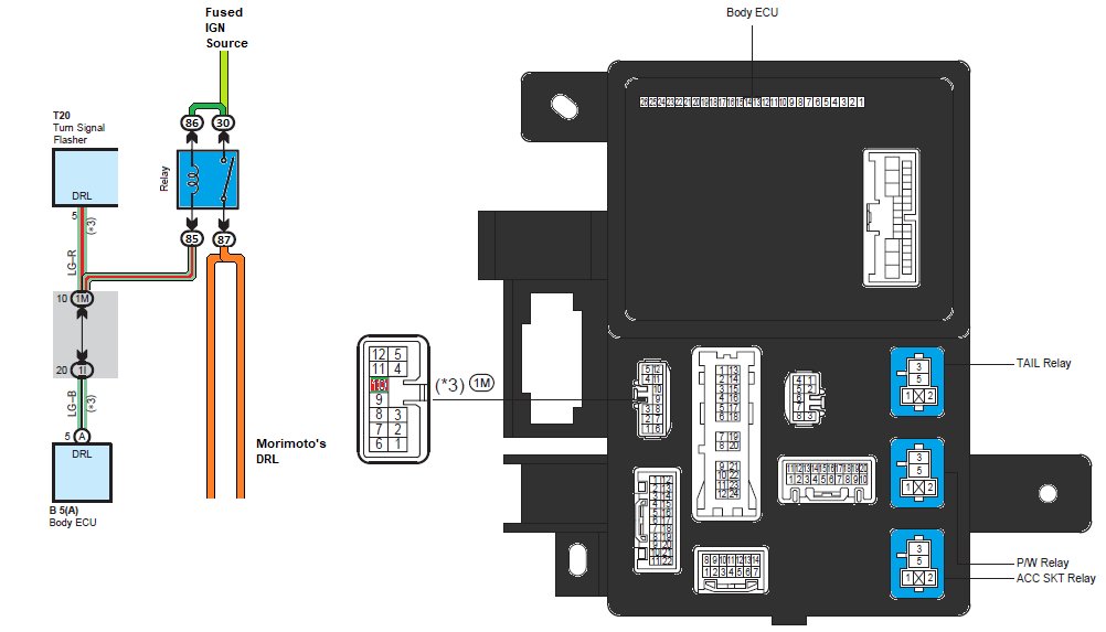

    Update on the DRL's. I wired them up so.they operate using the factory turn switch on the steering column.
    I followed the schematic provided by @caribe makaira (thank you for the extra help too).
    Easy, worked out perfect. Just remember they won't work if the parking brake is on...:rolleyes:

    That Parking Brake release is a doozy...:D

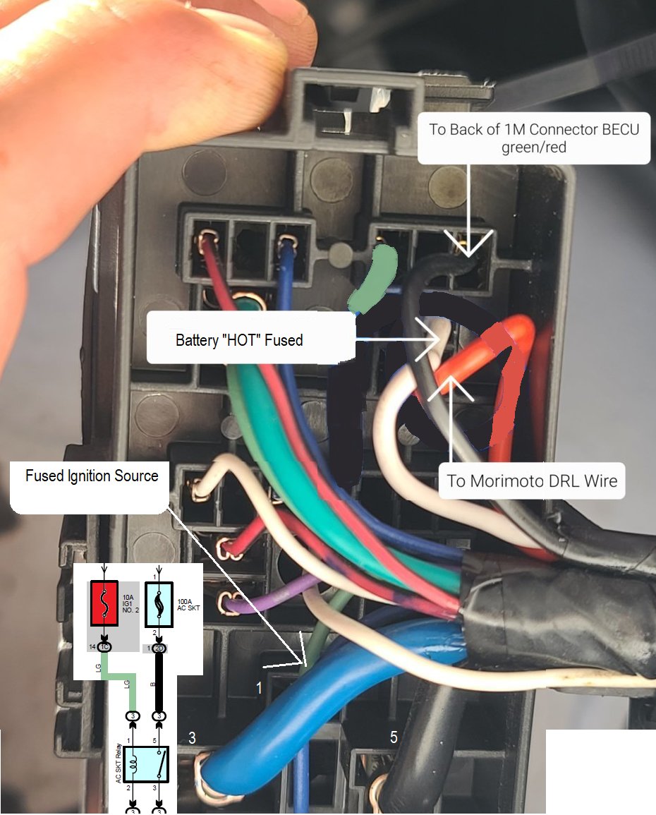

    Another option:
    1 lime green wire is fused IGN source.

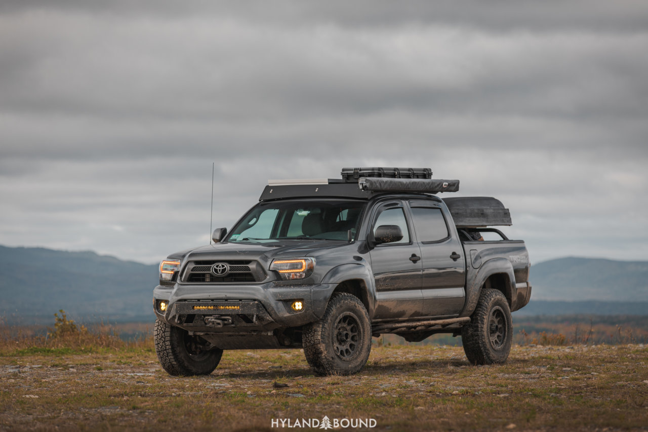

    Still loving these lights after a year of them on the truck.
