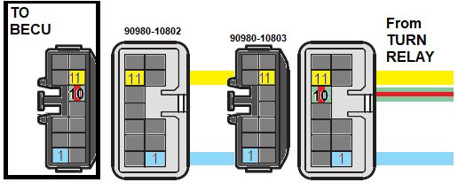

    I'm getting ready to install and want to disable OEM DRL. I want to run the Mori relay/fuse to cab fuse-box like the instructions; to go stealth if need be (just unplug and put stand alone fuse back in).
    I ordered M1 from dealer. Would I just do the stand-alone jumper, plug into BECU, and leave OE M1 disconnected?

    No.
    You need to do this:
    Or just sever the #10 wire and insulate/tap it.

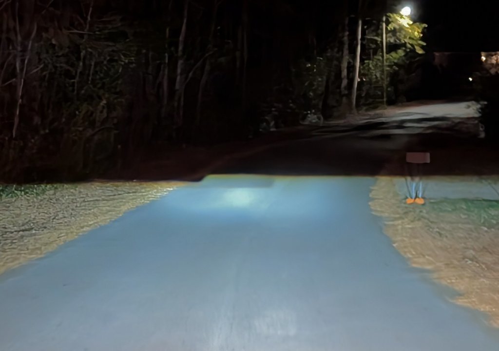

    Just the XB headlights. On a modern car, the entire beam pattern is as bright as the 2 hot spots. The non-hots spot areas get real dim on an open road. For reference my driveway is steep, so this is almost like pointing at a wall.

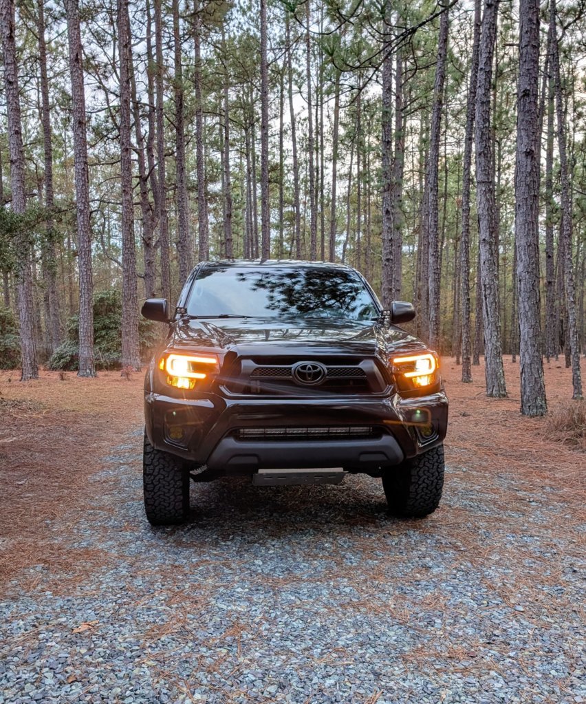

    I love the way these look on the truck and the overall light output is pretty good, although not great. But the stairstep in the beam pattern is extremely distracting when driving and I find it really obnoxious. I don't see why they couldn't have made the beam cutoff evenly straight across. This is definitely a ding against them in my opinion. Everything else about these lights is very nice.

    The stair step is there to reduce the chance of blinding on-coming traffic. You'll notice it tends to step near the painted middle line on a two-lane road. All projector headlights that I know of have this feature.
    Tacoma13_NC[QUOTED] likes this.
