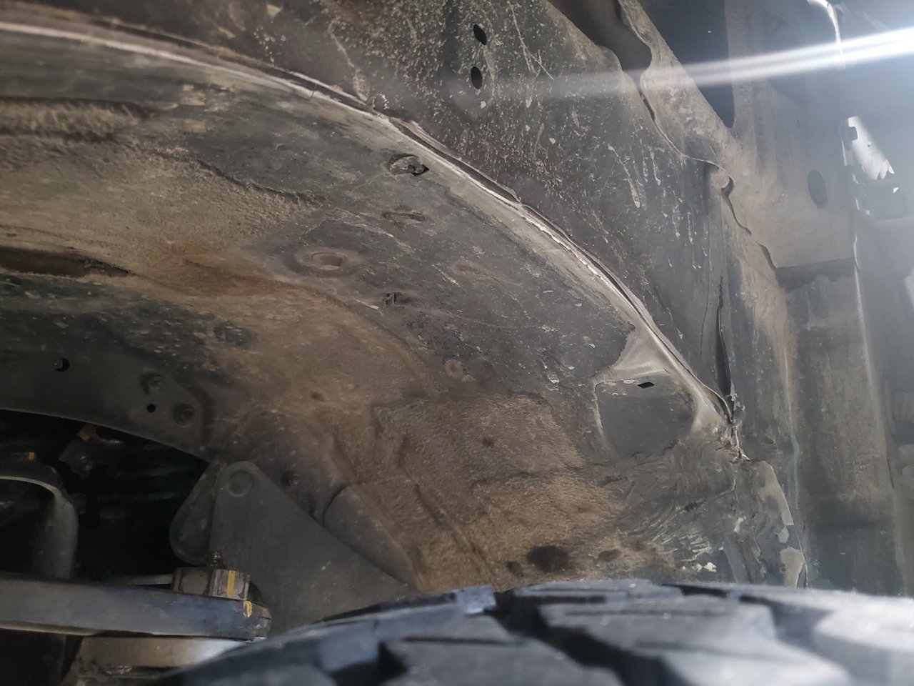

    Update, 35s do not fit without tubbing or using a bumpstop spacer (wack). Tires cram the entire inner fender and firewall to the point of bending the whole inner fender and cracking it.
