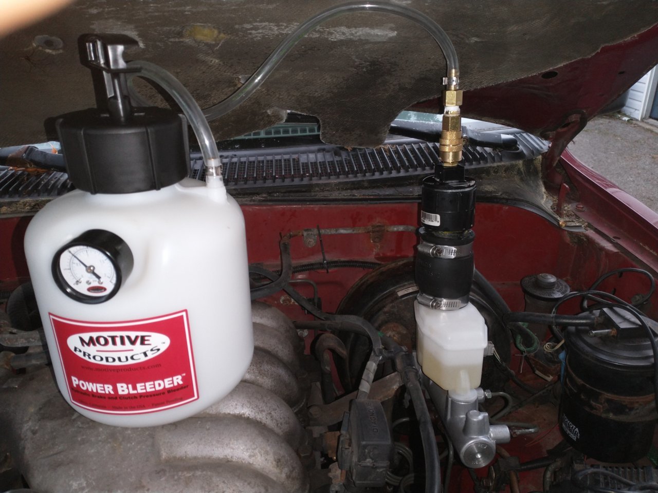

    This thread is old but I wanted to share the adapter I rigged up out of some 1-1/2" abs pipe fittings and a flexible pipe sleeve, it holds just over 10 psi with no leaks and didn't cost a lot...I had the brass fittings already.I may try it at 15 psi...IMG_20220627_193350.jpg

    Very clever! I would think you would want a tube that extends into the reservoir (concentric to/within the rubber sleeve) to avoid the possibility of spilling fluid when you disconnect? At this rate, is there any advantage of the motive system over a $10 garden sprayer from Home Depot (that’s what I’ve used in the past)?

    I haven't actually used this rig yet so yeah, I may need the tube you describe.Did you use the Motive universal adapter with the HD sprayer? Did you miss not having the pressure gauge?

    It worked a charm! Pumped it up to 15 psi after putting a quart in, bled the 2 rears and the proportioning valve,then pumped it up and did the 2 front calipers. It took 3/4 of a quart probably because I thought "It can't be this simple" and bled more that required....up and down twice, when most of your major joints are titanium/ceramic that's something you pay attention to. Here's the splice that I put in, passenger side front.IMG_20220628_121015.jpg IMG_20220628_121004.jpg

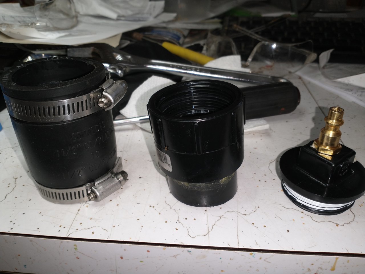

    It was just made from off the shelf 1-1/2" abs fittings about 2" of pipe glued to a threaded adapter that accepts a clean out cap/plug, that I threaded to accept a 1/4" threaded hose adapter after drilling a hole innit (size? beats me!) I used a off the shelf 1-1/2" rubber pipe sleeve that I trimmed a bit so the hose clamp wouldn't slip off the reservoir's lip. I added brass M type air tool fittings just because it's quicker to install/remove and 'cause I had them....I don't think it will fit the clutch reservoir, no room to work in and the diameter of the inlet is smaller, I think. This is a one trick pony. Toyota calls these an "SST" (special service tool), another one to add to my collection. ;)

    Here's a photo of the parts, I think I can cut the sleeve in half, avoids having too much fluid trapped up there.IMG_20220628_131044.jpg
