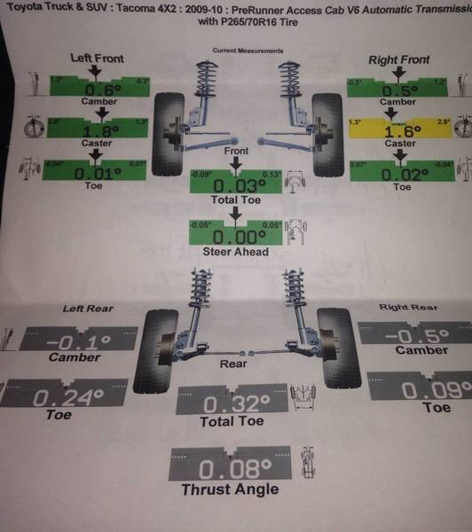

    I have the MM 951 on my truck. 16x8 with 4.5 backspace. Lately I have noticed vibrations occurring at 50-60mph. Before you say, "Get your truck aligned--that's the issue", I had it aligned when I got my leveling kit/lift on a few months ago and the alignment specs came out fine (see picture below). The right caster is slightly off which isn't a concern (from what I understand). Although, I've read in a couple other places where people have had issues with MM not balancing correctly.
    I'm at a lost here. I'm wondering because they "aligned" the tires as if they were 265/70/16 that it caused it to be messed up. My tires are 265/75/16. I don't know if that makes any difference.

    Interesting thread, I have the same wheels/size. Even the same set up as the OP for the most part. Haven't had any issues with vibes. Did have a bit of a wandering feel in the steering when the 5100's went on but just had the alignment redone and it drives so much better now. No more wandering feel. Tow was out a bit on both sides.

    I had the vibe when I had the rims first put on (pre lift)--was aligned then--on par-- but it was minimum so I thought nothing of it. Then I got my lift and got it realigned for obvious reasons. Had the same slight vibe. Now it seems to be worse.
